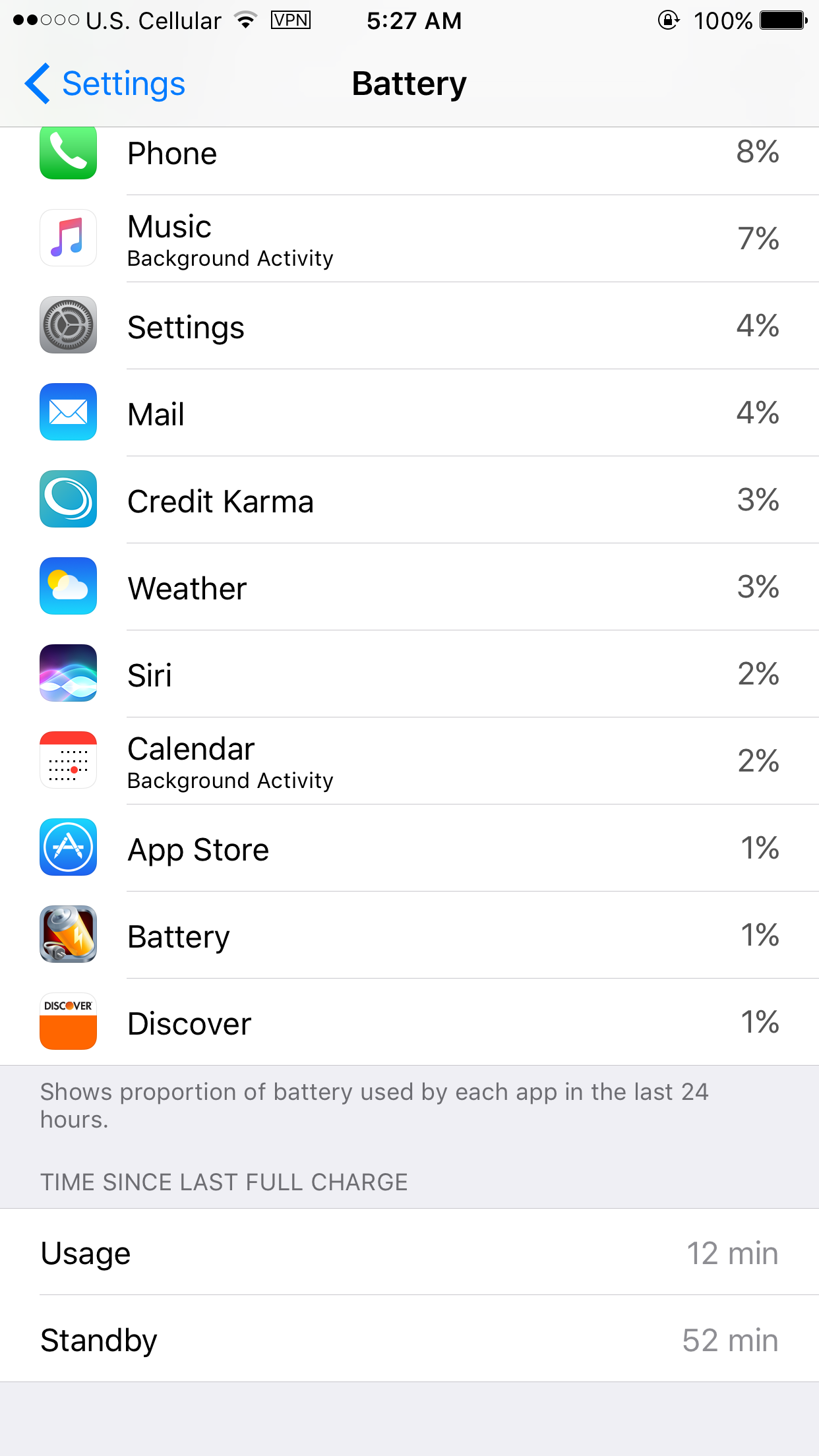

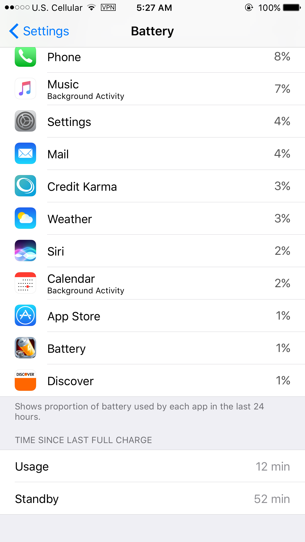

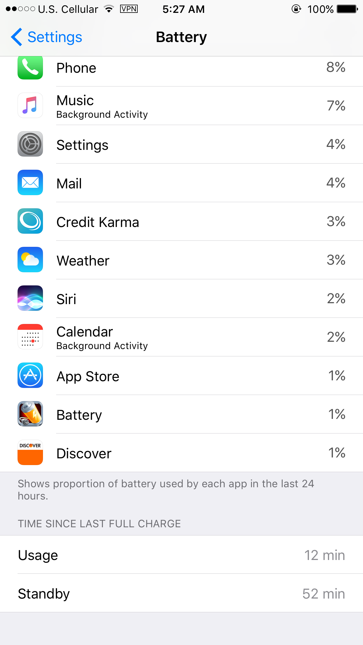

I have purchased a used iPhone 6S that seems to be getting HORRIBLE battery life. I am used to the 6+, so I understand I have unrealistic expectations. But this seems really bad - I can run it to 70% with 1.5-2 hours of light usage. Yesterday, the phone shut off at 82% charge and would not power back on until plugged into a power source. Then again at 60%, and again at 13%. I brought it to the Apple Store, they ran diagnostics stating that it didn't quiiiiiiite fail the test, but it's (and I quote) "right at what I would call that diagonal line, close to the threshold of failing but still passing" and they denied a replacement. I have 2 days left on the 1 year warranty. I have a feeling they just want me to fork over the $79 for battery replacement. Hmmph. They reinstalled the firmware on the phone and said that will likely fix it. If it shorts out again with plenty of capacity left and my warranty is over, I'm going to be quite an unpleasant person to deal with when I return to that store. They had better cross their fingers.
[doublepost=1474597830][/doublepost]I watched one episode of CBS' Survivor, background app refresh off, Bluetooth off, under half brightness. I went from a full charge, to currently 55%.
59 minutes usage, 59 minutes standby
How is that not failing? Huh?
Actually, since composing this post it is now 52%.
Update: 1 hour 7 mins usage - now at 44%. I can literally just watch it run down.
Update 2: Restarted the phone, and it went up to 50%. This battery sucks.
