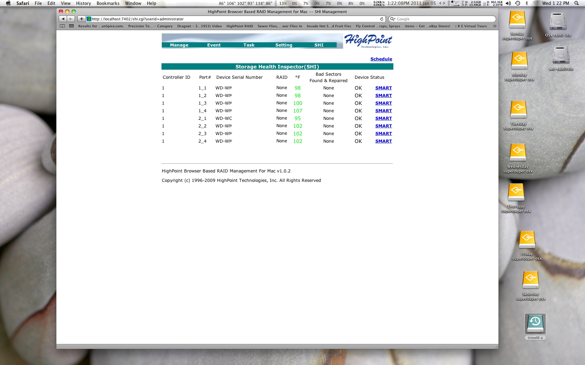

to illustrate the sans digital i have this one in black
I add a good card the rr2314 for a hundred bucks has 4 slots.
http://store.sansdigital-shop.com/totr8baysato9.html
http://store.sansdigital-shop.com/totr8baysato2.html
so 305 I drop in a pair of good fans for 40 bucks I am at 345 for 8 drives. that I run as a tm and 7 clones sun to sat. each drive is stand alone the clones are 1.5tb caviar blacks they clone my osx plus main file each night about 900gb. the tm is a 3tb western digital hdd. so I have 7 clones and a tm for backup. in the macpro I have 2 raid0's one is a pair of caviar black's one is a pair of wd re4's. I also off load to a nas in another site once a week.

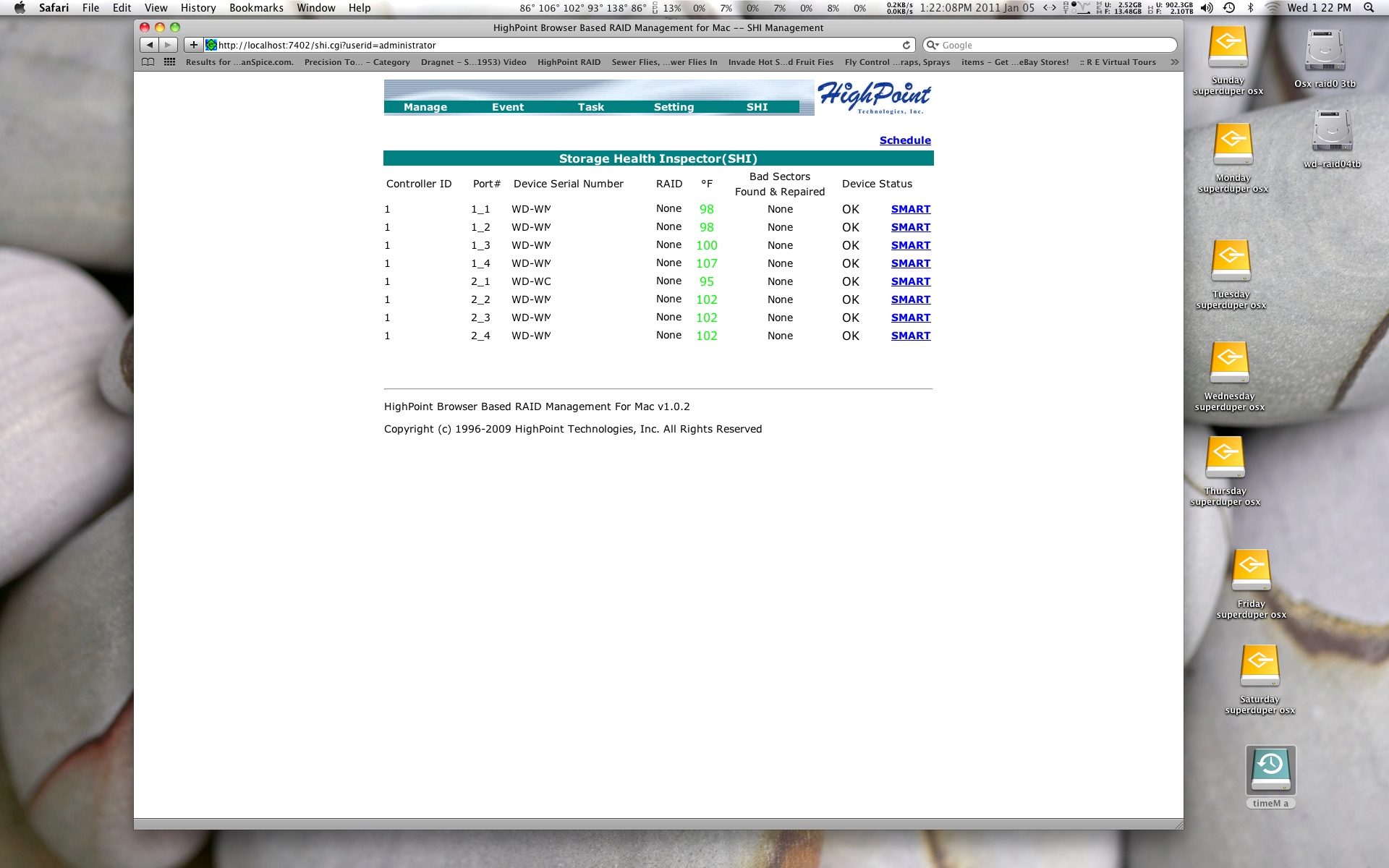

Those are good prices, but it does need to be mentioned that they're Refurbished IMO. And No, I don't have a problem with refurbished gear (makes getting a proper UPS feasible for users that would run without one, or a unit that's under specced for their needs). 😉
As per the RR2314 however, I don't trust Highpoint's RAID products at all (not much different for simple SATA/eSATA products either). Whatever you do, do not try to run RAID 5 on it as it's a software implementation (does not address the write hole issue associated with parity based arrays). This means you will get burnt if you do (matter of when, not if).
