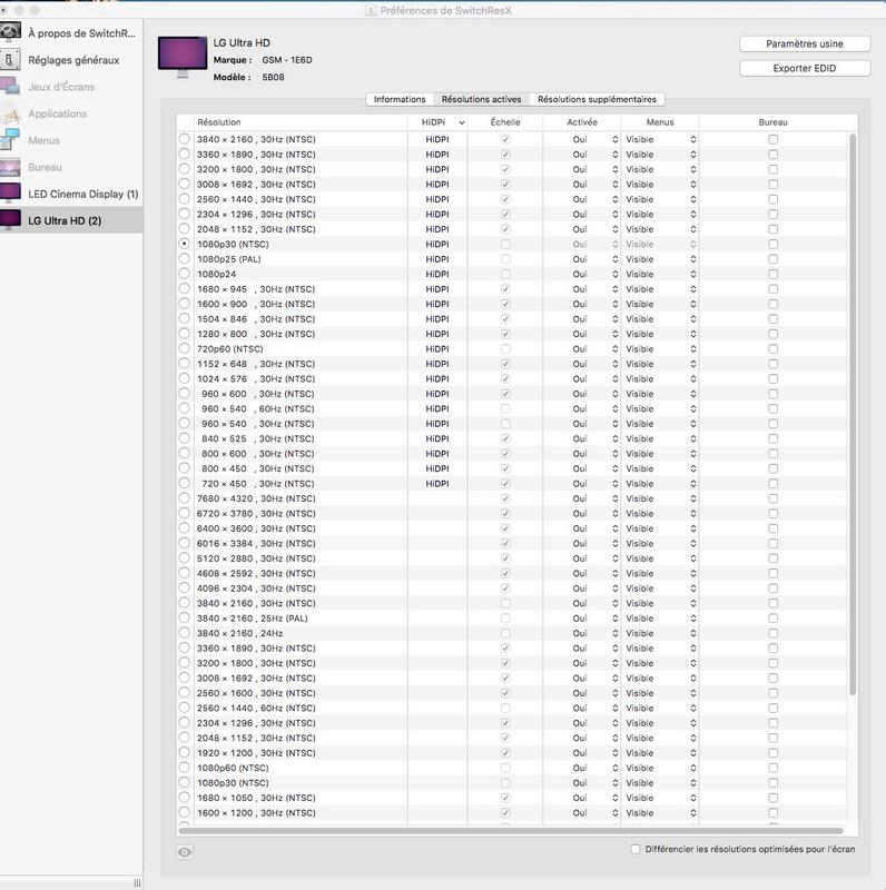

Upgrade to 10.13.6 this morning , my RX580 8 GB no longer support 4.4.4 @ 60Hz via Display-
port adapter to HDMI (Club 3D CAC 1080 DisplayPort 1.4 to HDMI 2.0 HDR)
Apple downgrade the RX580 with the new update , now I only have 4.4.4 @ 30Hz .

Try SwitchResX yet?
After 10.13.6 update, my RX580 automatically revert to 3840x1080 8bit 60Hz output, but I can re-select back to 3840x1080 HiDPI 10bit 144Hz without any trouble. (I did that via ResXtreme)
Try SwitchResX yet?
I tried ResXtreme , I will try with SwitchResX ,thanks.

Try SwitchResX yet?

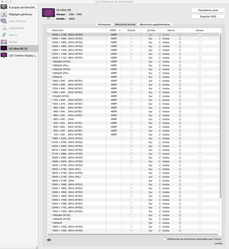

I tried with SwitchResX and ResXtrem 60Hz @ 4k HiDpi is no longer available since 10.13.6.
Before update :
After update, 10.13.6 , AMD RX580 8GB no longer support 4k @60Hz :
Seem Apple downgraded AMD RX580 8GB @ 60Hz :

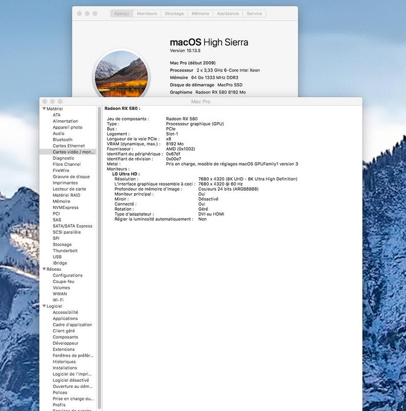

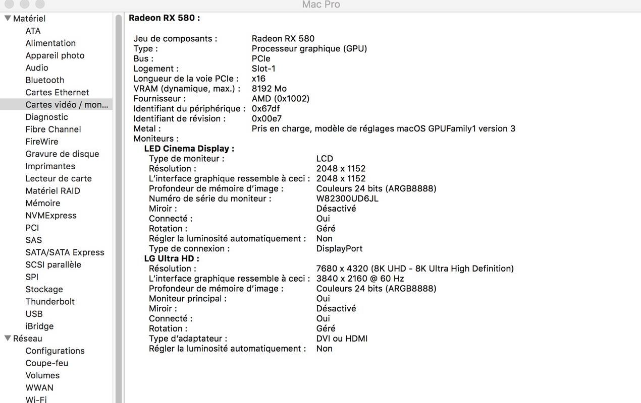

Your display is showing up as an 8k display, rendering as 2160p?
It's not just 4k you seem to have lost 60Hz refresh on. It's also plugged in via an adapter (my french isn't... existant)?

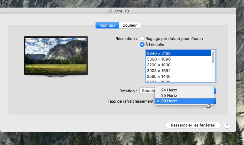

Right , I lost 60Hz ,
I can have only 30 Hz @ 4k via an DisplayPort adapter to HDMI (Club 3D CAC 1080 DisplayPort 1.4 to HDMI 2.0 HDR) while before the update I had 60 Hz @ 4k.
I use this adapter because it's the only way I found to resolve ''black screen'' and ''flicker screen'' issus on my 43'' LG monitor , same issu with my new LG 65" (Oled Tv).

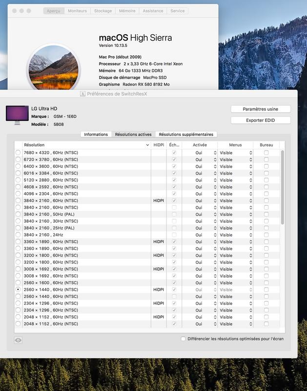

Back to 10.13.5 ,as you can see I have now 4k @60 Hz :
Edit : To have 4.4.4 resolution, I have to enable "Ultra Deep Color " on my 43" monitor or my oled tv, but since 10.13.6 the new AMD drivers no longer support this function; I do not understand this downgrade but on the other hand this is not very surprising from Apple (eg. RX570).

So if you plug the display in directly, aside from the issues, do the 60Hz options and 4:4:4 colour come back? I'd still like to know why your display reports as 8k physical resolution, when it's a 4k panel.
