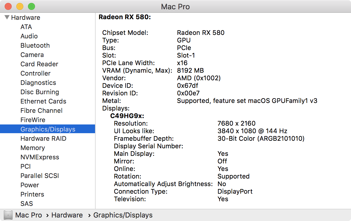

10 bit is fine. Since I can render my desktop at 7680 x 2160 @144Hz, bandwidth is not an issue for 7680 x 4320 @ 60Hz as well.
That issue sounds like cause by the compatibility of the HDMI 2.0 active adaptor.
