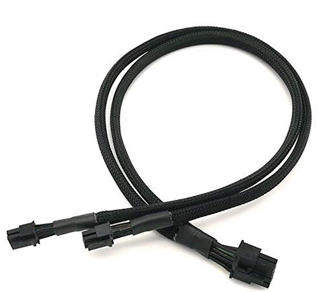

How are you powering the RX 580 ? 2 X Mini 6 pin from the motherboard to 1 X 8pin to the GPU ?
Are you using this power cable ?

i am using this cable https://www.ebay.co.uk/itm/Dual-Min...e=STRK:MEBIDX:IT&_trksid=p2057872.m2749.l2649
and when i use both cards the rx 580 works like a butter .

i am using this cable https://www.ebay.co.uk/itm/Dual-Mini-6-Pin-PCI-e-Male-to-8-Pin-Graphics-Card-Power-Cord-for-Mac-Pro-18AWG/233229541399?ssPageName=STRK:MEBIDX:IT&_trksid=p2057872.m2749.l2649
