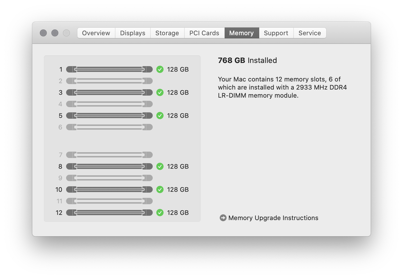

With six DIMMs, Apple suggests using slots 1, 3, 5, 8, 10, and 12. They correspond to channels F, E, D, A, B, and C - that's six channels, i.e. 384 (um, actually 432) bit wide access to memory.
Adding another six DIMMs enables no more channels, but now the processor can switch between DIMM 1 and DIMM 2 in each channel. (This is the same idea as dual rank modules.) Presumably it can issue a command to DIMM 1, then toggle over to DIMM 2, and then return to DIMM 1 where the command has completed.

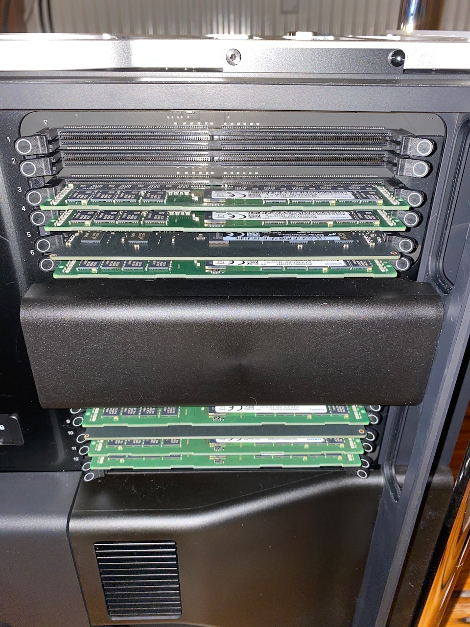

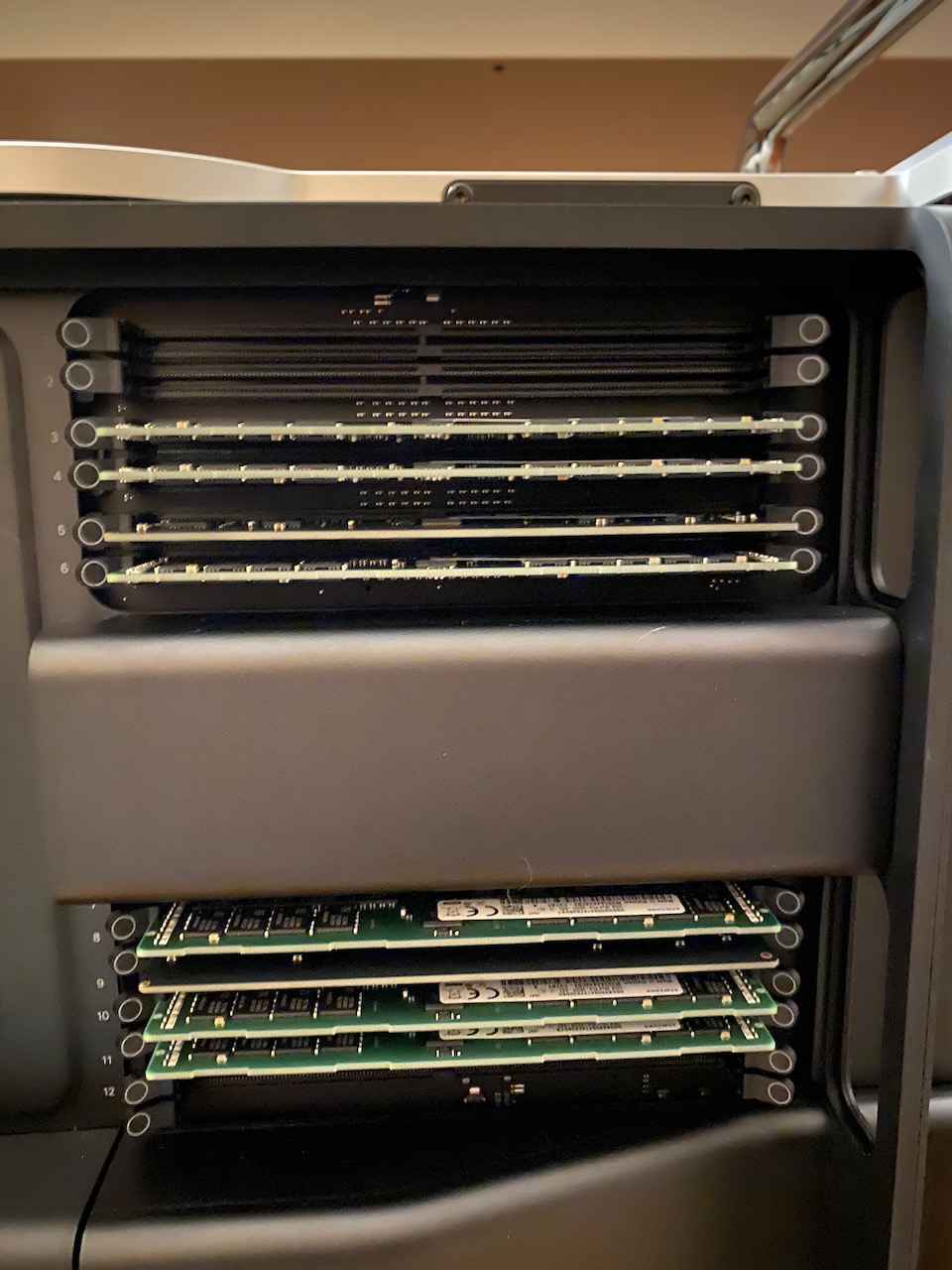

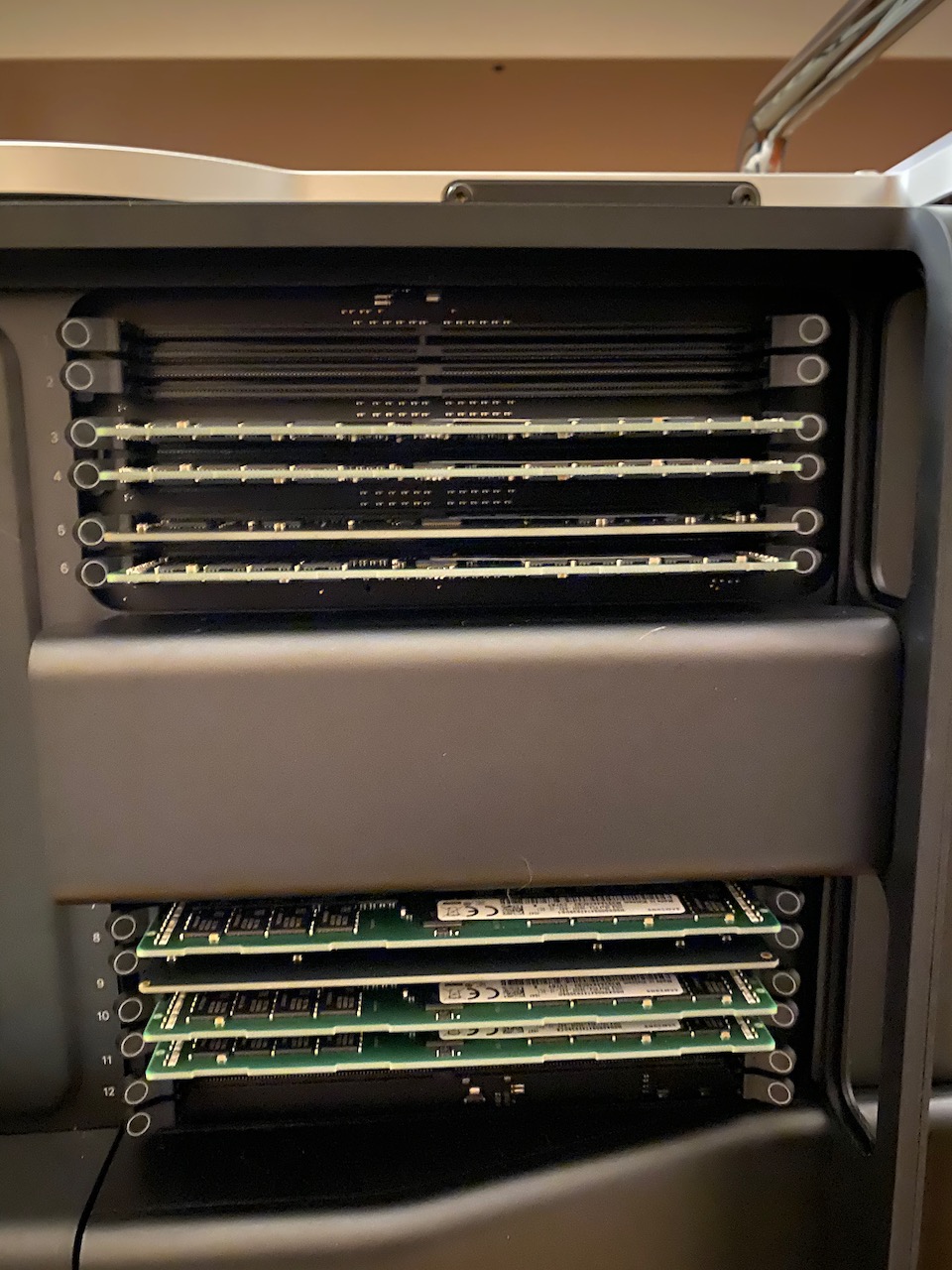

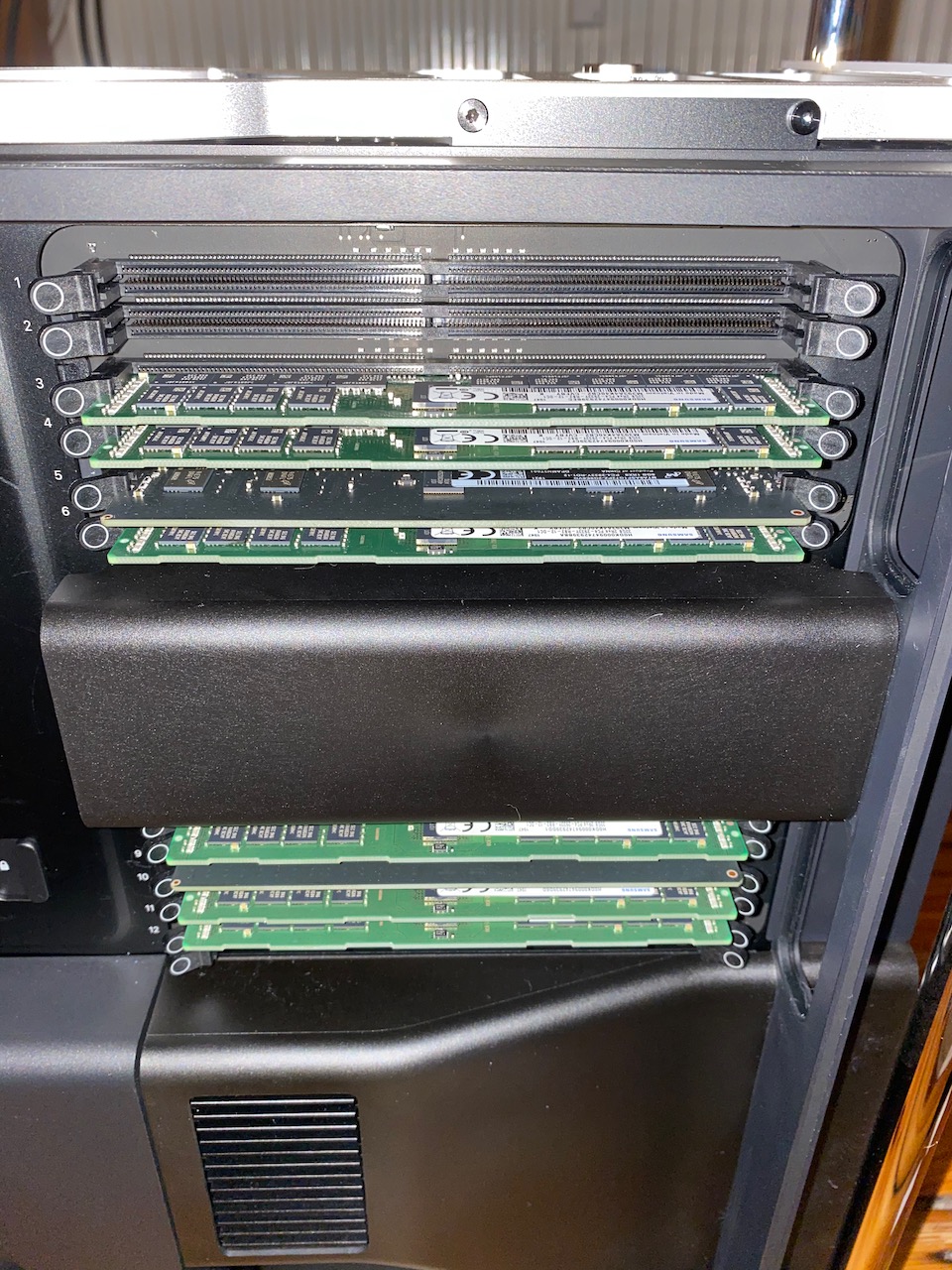

I tried again to insert two of the old 8 gb sticks together with the new 6x32gb, and again, the orange light of doom was blinking, so the sticks weren't loose but I made some other mistake.
The green ones are new, the black ones original.
I started with the small 2x8gb in Channel 1 and then distributed the others in channels 2,4,5 like the manual suggests.
What am I doing wrong here?
I'm considering getting an additional 2x8gb to fill all slots but first of all I can't seem to find fitting 8gb 2933mhz dimms, and secondly, I'm wondering if they will work together at all.
Honestly I also think that 192gb are enough for me, but well.
Reactions: tommy chen

Are you mixing LR-DIMMs and R-DIMMs in the same System ? That's not permitted .
The physical installation looks OK .

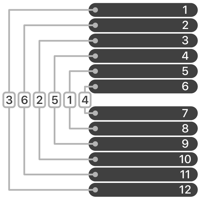

Here's Apple's advice on installing different size modules in the same System :
Installing DIMMs of mixed capacities
If your DIMMs are different capacities (like four 16GB DIMMs and four 32GB DIMMs), they must be installed according to these requirements:
Install DIMMs in order of the channels.
Install DIMMs in identical pairs for each channel.
Install DIMMs in order of smallest to largest capacity.
Use only R-DIMMs or only LR-DIMMs.
How to install DIMMs of mixed capacities
Find out which slots to use for your DIMM configuration.
Starting with the lowest capacity pair of DIMMs, install your DIMMs in identical pairs from smallest to largest capacity in order of the memory channels:
Channel 1: Slots 5 and 8
Channel 2: Slots 3 and 10
Channel 3: Slots 1 and 12
Channel 4: Slots 6 and 7
Channel 5: Slots 4 and 9
Channel 6: Slots 2 and 11

No I’m not mixing LR with R dimms, except if the Apple dimms that came with the system were LR dimms, which would be strange- I don’t know how to find out if they are or not?
My understanding is that they use the LR dimms only for very high configurations.
yea thanks for that post, that was what I used to place them as well..
Try putting the 32's in slots 1, 3, 5, 8, 10, and 12. Then put two 8's in 6 and 7.
Also, 32's in slots 1, 3, 5, 8, 10, and 12 with the four 8's in 4, 6, 7, and 9.
