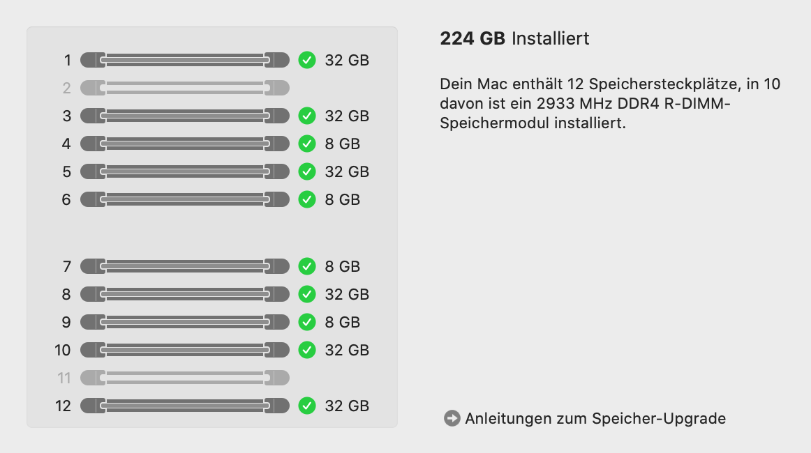

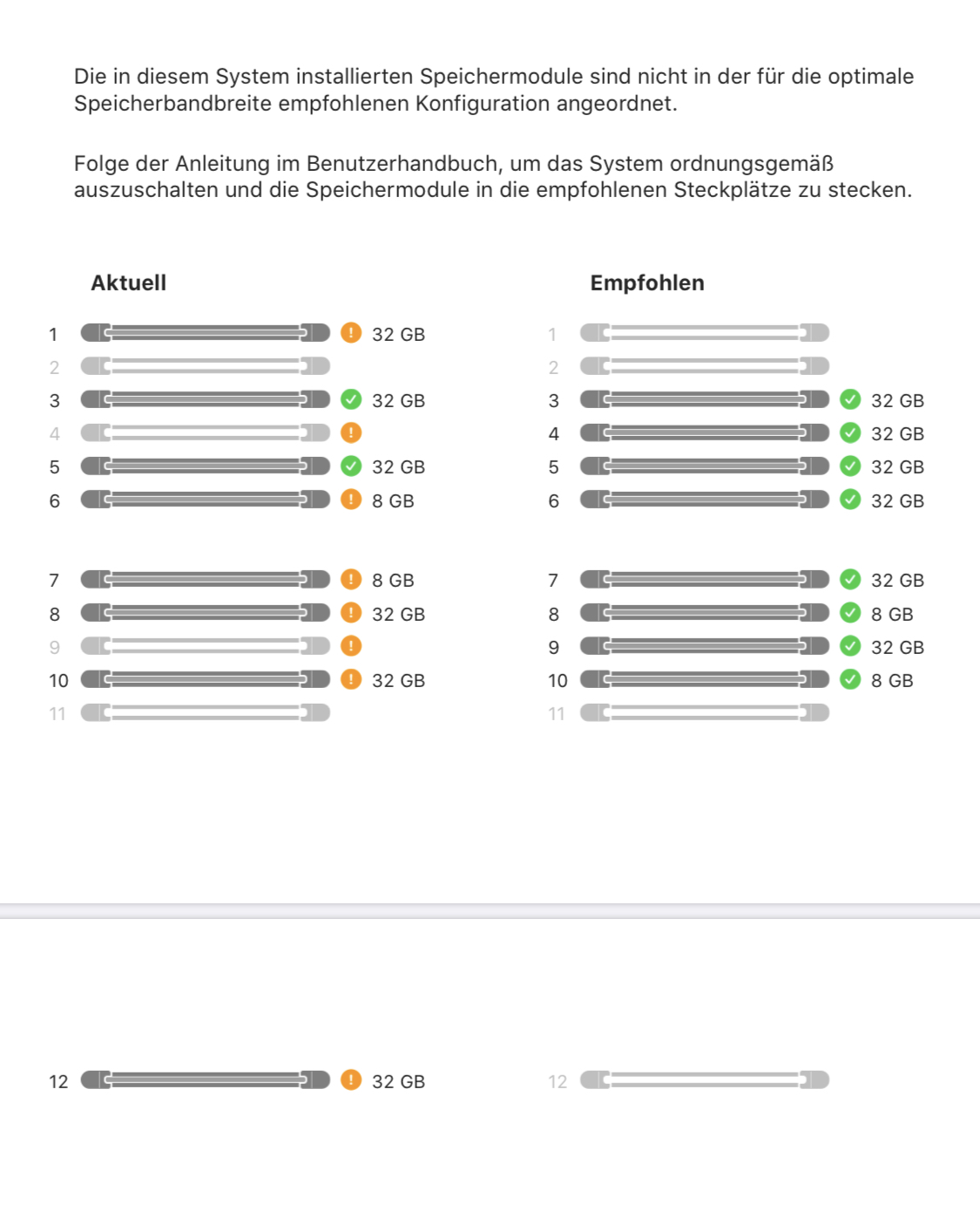

gonna try it out and report back!Try putting the 32's in slots 1, 3, 5, 8, 10, and 12. Then put two 8's in 6 and 7.
Also, 32's in slots 1, 3, 5, 8, 10, and 12 with the four 8's in 4, 6, 7, and 9.
You're a hero!gonna try it out and report back!

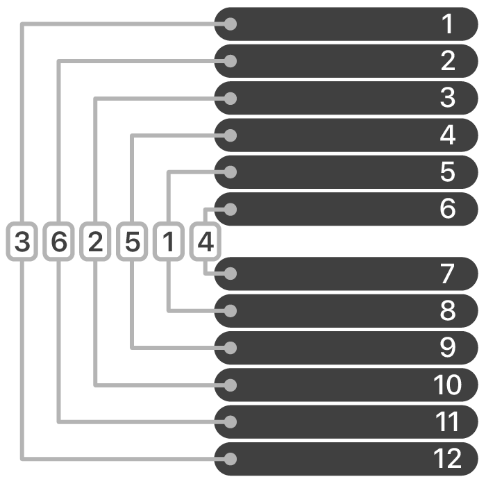

Oh my, I found that this diagram comes from Apple. It seems that the doc writers and the engineers (e.g. "About This Mac") have different ideas about "channels".
SoooooTry putting the 32's in slots 1, 3, 5, 8, 10, and 12. Then put two 8's in 6 and 7.

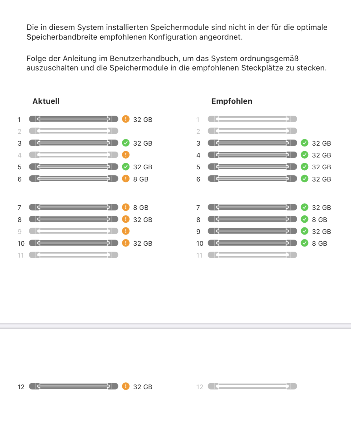

Well now I went ahead and tried 8 dimms as you recommended and it booted but gave me a warning that the configuration was not optimal. Then I followed the instructions given by the system and after that the orange light came back and it wollner boot at all 😒Sooooo

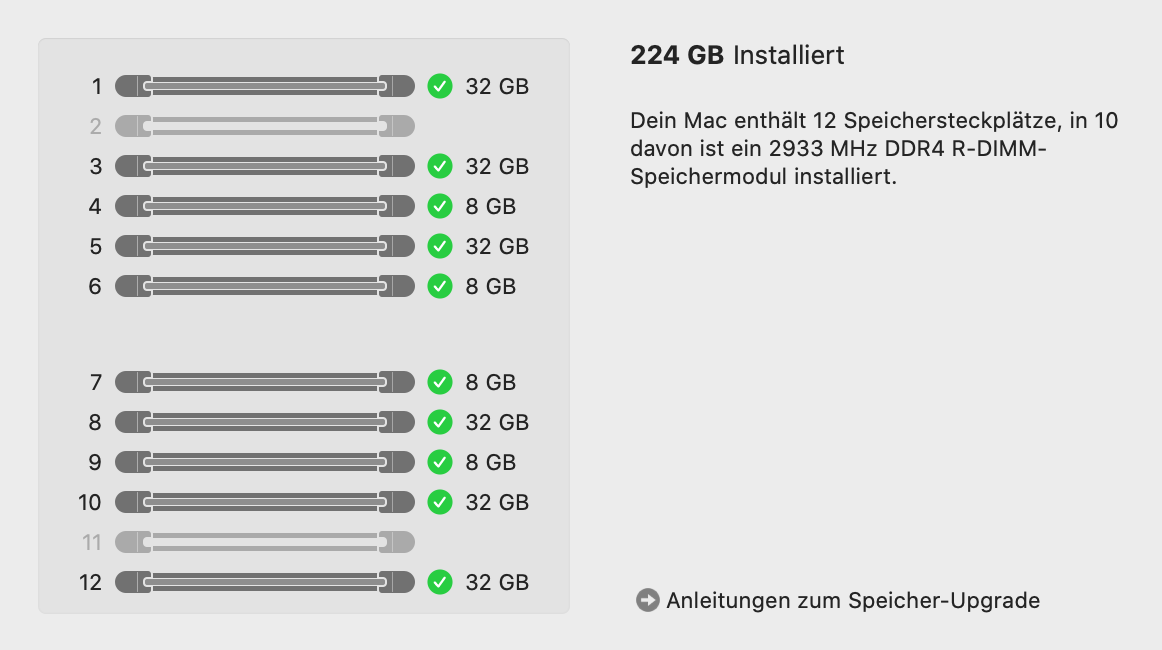

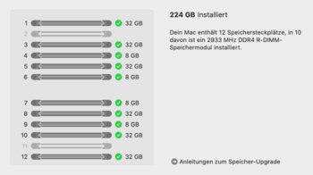

I tried the 10 dimm config that you suggested, aaaaaand as opposed to what you'd expect, it actually worked!
I didnt try the 8 channels yet, but guess that would also work. Will try that out next.
What's interesting though is that with 10 dimms, my geekbench multicore score went down from 15600
to 14156.
So the non-6channel confic slows down the CPU quite significantly as it seems.
I guess I'll try 8 dimms and if the results are equally bad just gonna stick with 192gb for now and sell the 8gigs. Or someone tells me what new 8gig dimms to buy and I'll go to 12.

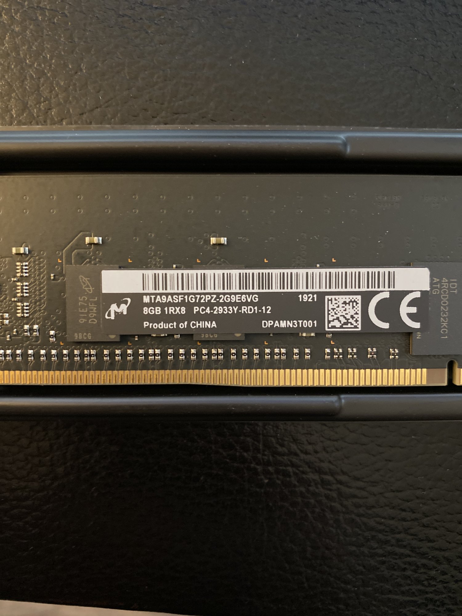

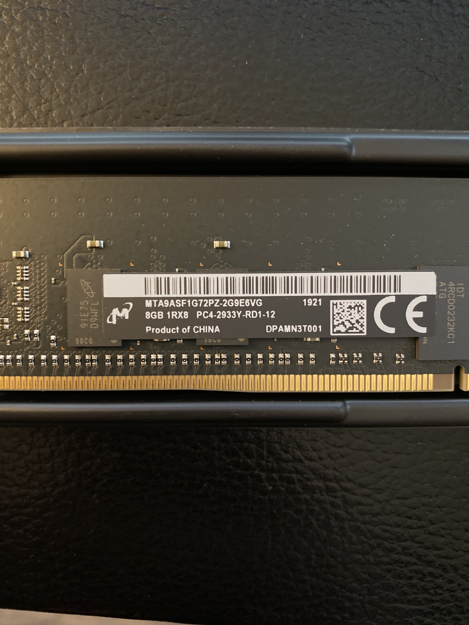

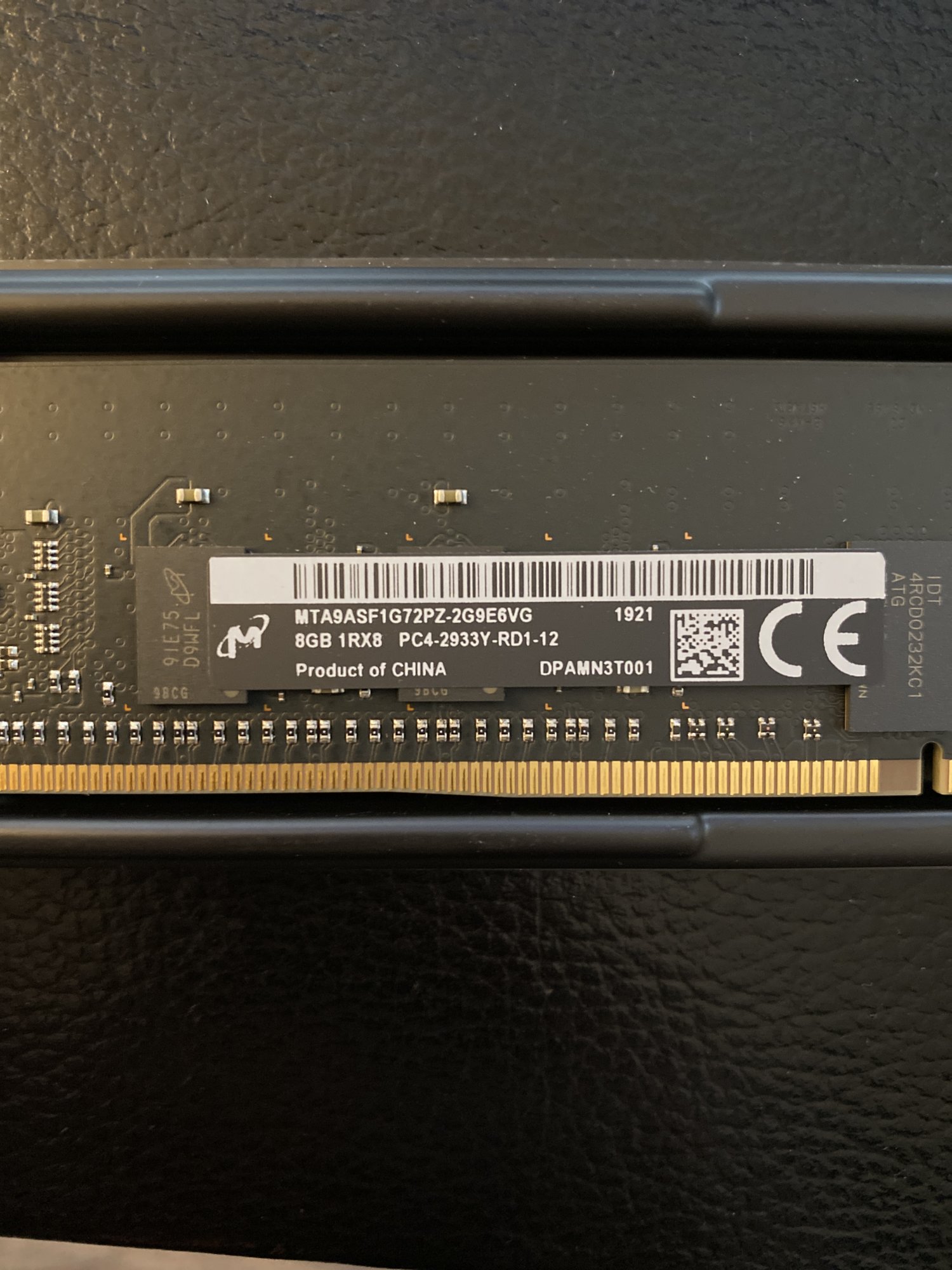

How to find out what the pre installed dimms even are?View attachment 885829
The Apple RAM is apparently just bog standard Micron running at CAS22, while the 3rd party stuff is CAS21. I wouldn't say buying Samsung is cheaping out - it just seems like a waste to pay a lot more for essentially the same chips.

Just don't mix the x4 and x8 in the same channel. You should be fine then.Just received the remaining 32Gb RAM sticks. 10 are x4 based (NEMIX) and 2 are x8 based (Crucial). My plan is to install the x4 first and leave the x8 for the last channel. Thoughts?
_great advice and i made sure not to...Just don't mix the x4 and x8 in the same channel. You should be fine then.
