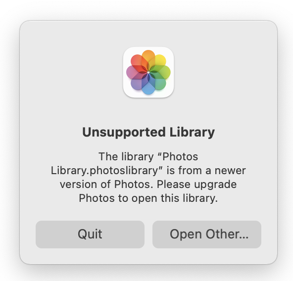

links are directly from apple servers so it should be safe to use. Note that I opted for beta 6 since you can create a usb installer with it where with beta 7 it fails to do so.
It will break your Photo Library thou...
good to know! hmm I never realized! don't use photos much on my Mac. but mostly iPhone and iPad so it shouldn't be an issue in the short term until we get back external monitors in the next beta hopefully.
