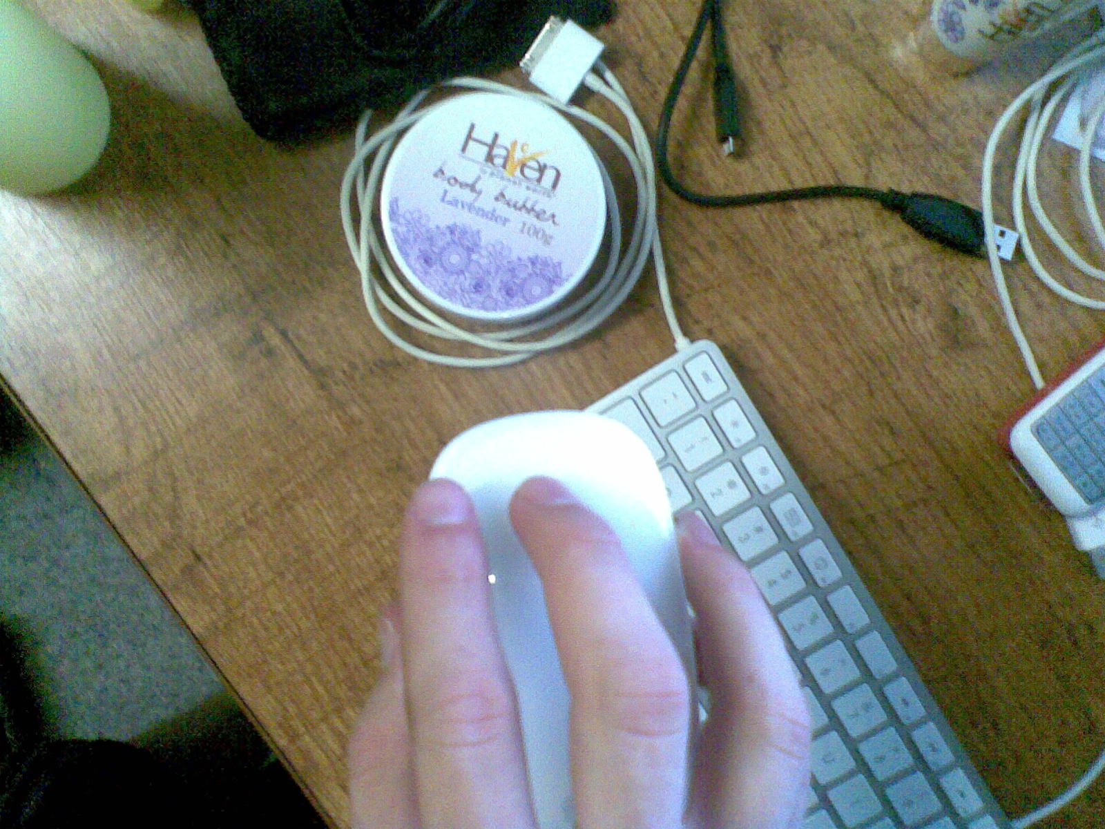

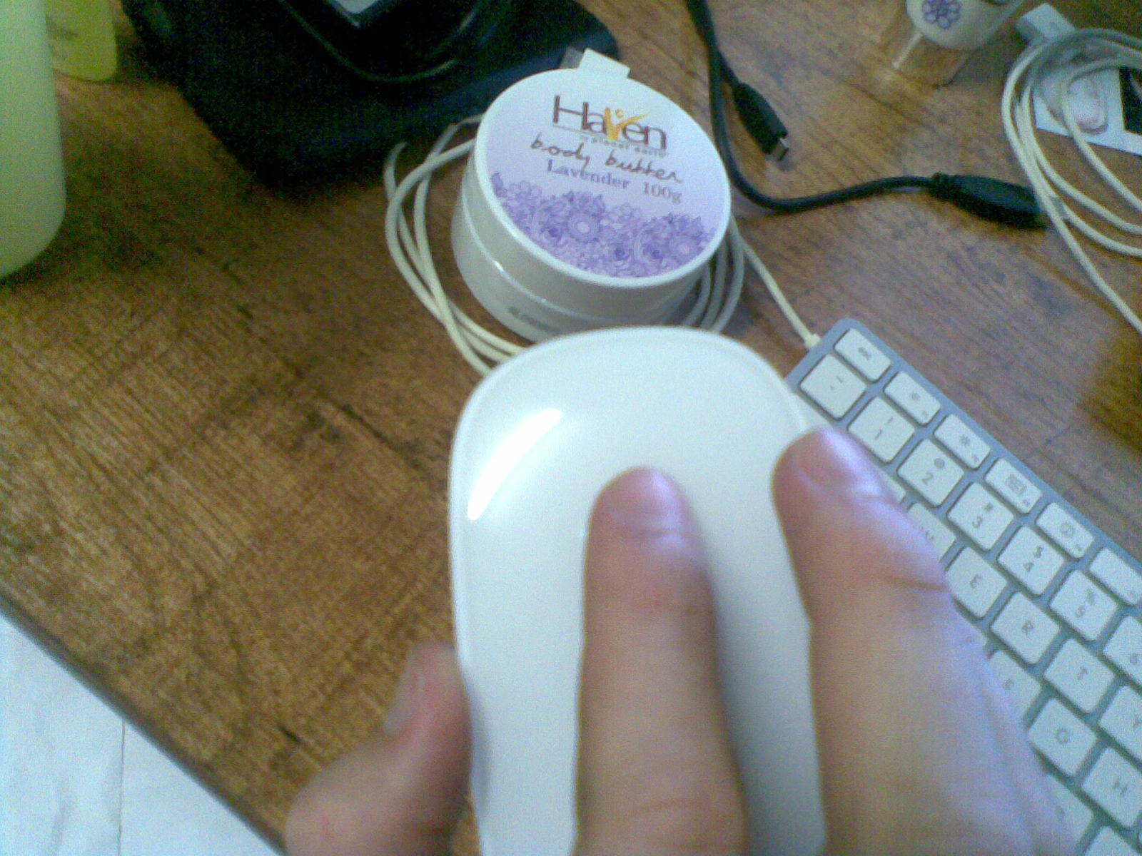

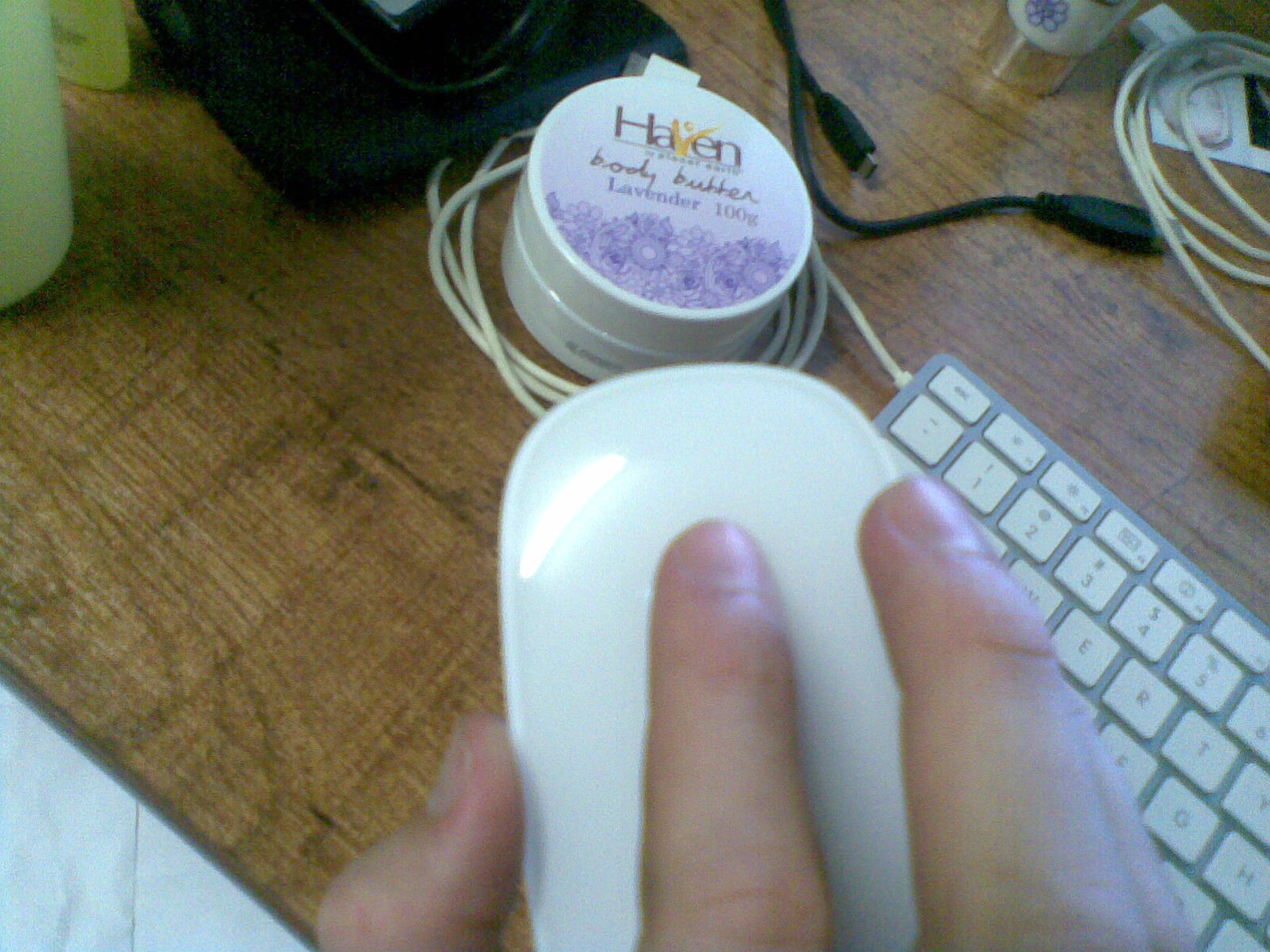

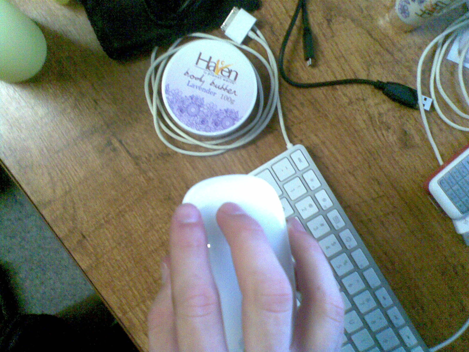

the pictures below are how i hold the mouse left tip tap on the left side, right tip tap on the right side. you REALLY have to position your "middle" finger (the finger in the middle) right in the middle. 😕
Yeah, I noticed live gesture pics it up sometimes also, but the gesture doesnt get performed. Thats kinda the reason I decided to scrap tiptap.

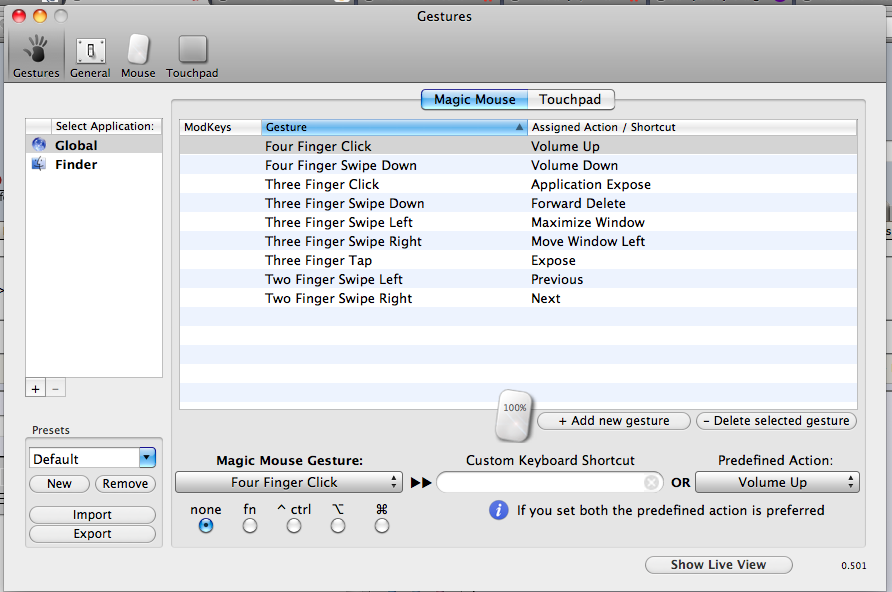

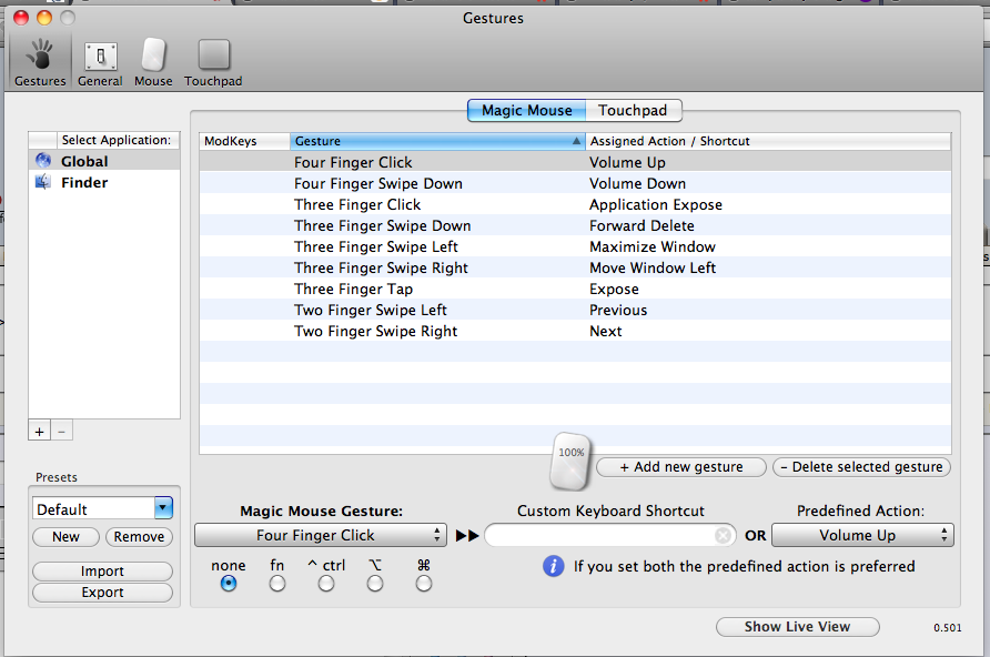

So I've got my gestures added but I'm confused about one thing...
I set up the two finger left and right swipe to continue to do next and previous in all apps but it only works for iTunes when it's running and will do so no matter which app is in focus. How do I get it to work for all apps? Do I need to remove these gestures and if I do so will the default gestures still apply?
Maybe try this instead of setting it as the predefined actions of next and previous??
