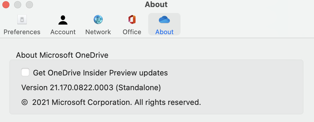

For me, no need to manually download OneDrive from the MS site, I just quit OneDrive and restarted it.
It took a little while before OneDrive was 'ready', but in that time it had automatically downloaded a new version of the application.
Previously I was running v21.160.0808.0004 (I think, from my memory!!), now the app has auto-updated to v21.170.0822.0003.
I have added my corporate accounts and all seems to be working OK.
UPDATE: I should add, I am using the standard release channel, not preview or beta release.
