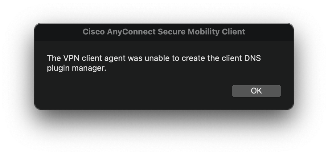

Anyone managed to get Cisco's AnyConnect VPN v4.9 to work on Big Sur Beta 4 (20A5343i)? In my case it finishes the installation successfully, but right after "updating preboot", it starts popping up this error and it never stops until I uninstall the app. Funny enough v4.8 worked with no problems. Also, the same 4.9 version works flawessly with Catalina.
Also, disabling SIP didn't have any effect, either.

Hi guys,
I am also keen to know, as I must use it for work when working from home! I have no other choice but to use 4.9,as the IT staff from work controls this. Even if I installed 4.8, it would then push out 4.9.
thanks
Cisco's AnyConnect VPN does use a kext if I remember correctly. So that obviously will never work on Big Sur, unless they change their implementation.
@samwa3. Then why does version 4.8 work, while 4.9 does not? Are they doing something different?
Reactions: arsradu
Sorry then it's my bad, I only had the newest version to test. Maybe the earlier version somehow works even when the kext is not loaded correctly.
@samwa. No problem. Hopefully, at some point in time 4.9 will work. Otherwise I will not be able to upgrade to Big Sir. Thanks for your effort on my behalf.

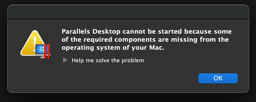

I've been gone through my Apps since I installed the Public Beta yesterday and I've had really good results.
I've looked at the list (and added an item--QuickBooks Online Mac App) and some of the ones listed as not working seem to be fine for me...

Not Working:
  • Parallels Desktop (Says missing OS X components)
  • Network Utility (Says it's now depreciated)
re: Parallels -- See this (and earlier, similar posts) to get it working. You may need to update to v. 5.1.14, though.
For the umpteenth time; the App store version DOES NOT work for most people. If you have ever used Parallels Pro, or you are running your VM of BootCamp, it will NOT work. The App store version is not a solution...
Yep, Parallels Desktop for AppStore has some limitations.
But we ca use it as a temporary workaround

  • Parallels
    • (1,2,t,y keys NOT Working) - use Keyboard macro in preferences
    • Beta 3 - not loading due to version check - use shell script or terminal:
      SYSTEM_VERSION_COMPAT=1
      open /Applications/Parallels\ Desktop.app
    • Not working on Beta 4 - looking for driver
