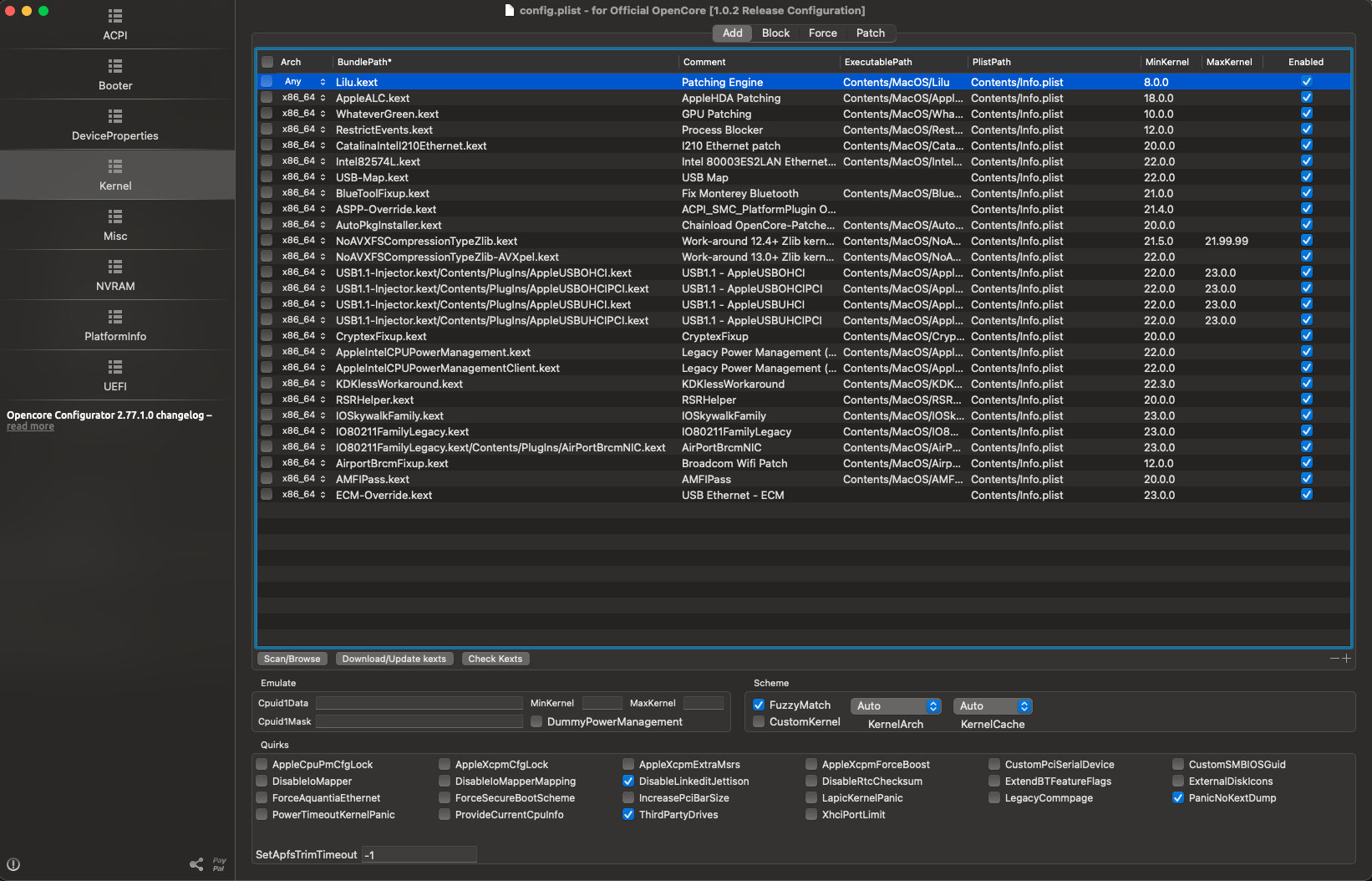

if you're referring to the kext solution, it appears that it's not listed in my plist so unfortunately that won't work for me.
