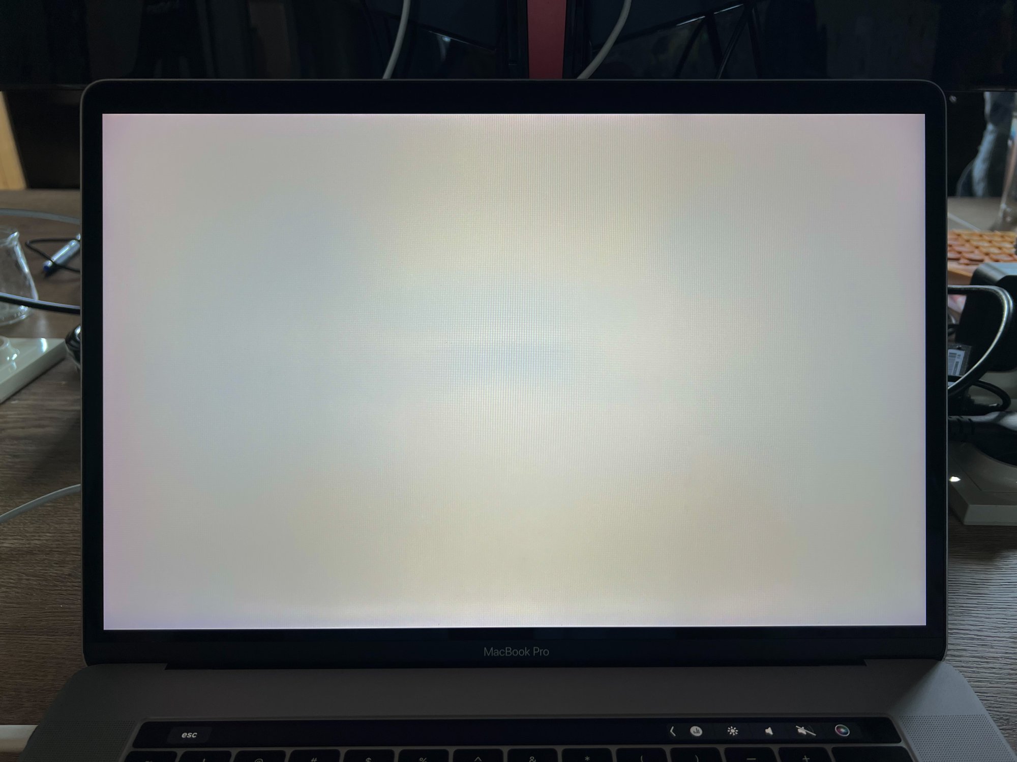

I also have this issue on my Macbook pro 15" 2019 model.
Still under Apple Care, will make an appointment with Apple Support later.
This is my second display replacement with the issue. Two blotches across the centre of the screen and now a large blotch appearing to the left.

I have a 2018 and I have the same problem. Apple does not want to fix it for free, but I think it should. This seems like a manufacturing defect. Probably a glue or something they use to make the panel.
I have a 2018 MBP 15" and have a similar blue splodge pattern on mine.
If it was image retention or burn, it wouldn't always be blue, and some of these patterns are similar to others.
It was a corporate machine and a few other people have the same.
I recently got a 2022 M2 Air, not noticed anything so far, I mean perhaps there's a slight slight blue small area to the left but hard to notice it. I'll keep an eye on it though. My thoughts were a glue getting cooked bad by heat over time.
Having scrolled through the thread I see quite a few which look very similar to mine, like a large € shape on the left and mirrored on the right almost with an eye on each and a line between them forming in the middle...
I have a macbookpro 2017 and have the same bluish spot in the center of my screen. Its very faint though so not sure if its worth having the screen replaced
I recently bought a used MacBook Pro 15" (2018), and everything is fine except for some blue spots on the screen. They are very faint and hard to see with the naked eye, so I increased the contrast in an editor to make them more visible. From what I understand, there isn't a definitive explanation for why this happens. My guess is that it's due to pressure. If you carry your laptop in a backpack and the contents press against the screen, these marks might eventually appear.
