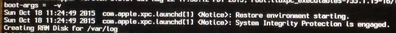

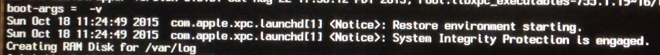

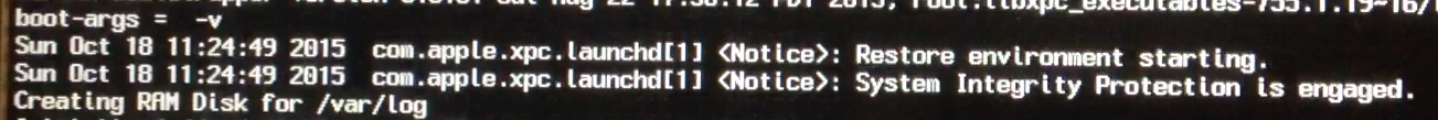

Sorry for not having glimpsed this earlier, but it seems like the problem is with disabling SIP:
Current boot.efi doesn't disable SIP on legacy method. I disabled it via restore partition and install media booted in no time into GUI (and enabled Bluetooth wich it never did before).
With this method, the installer boots to the target media on first restart, and fails as all occurrences of boot.efi are the original ones. I'm replacing these boot.efis right now and see how it proceeds. Maybe we can skip one step.
Good call, Sko.

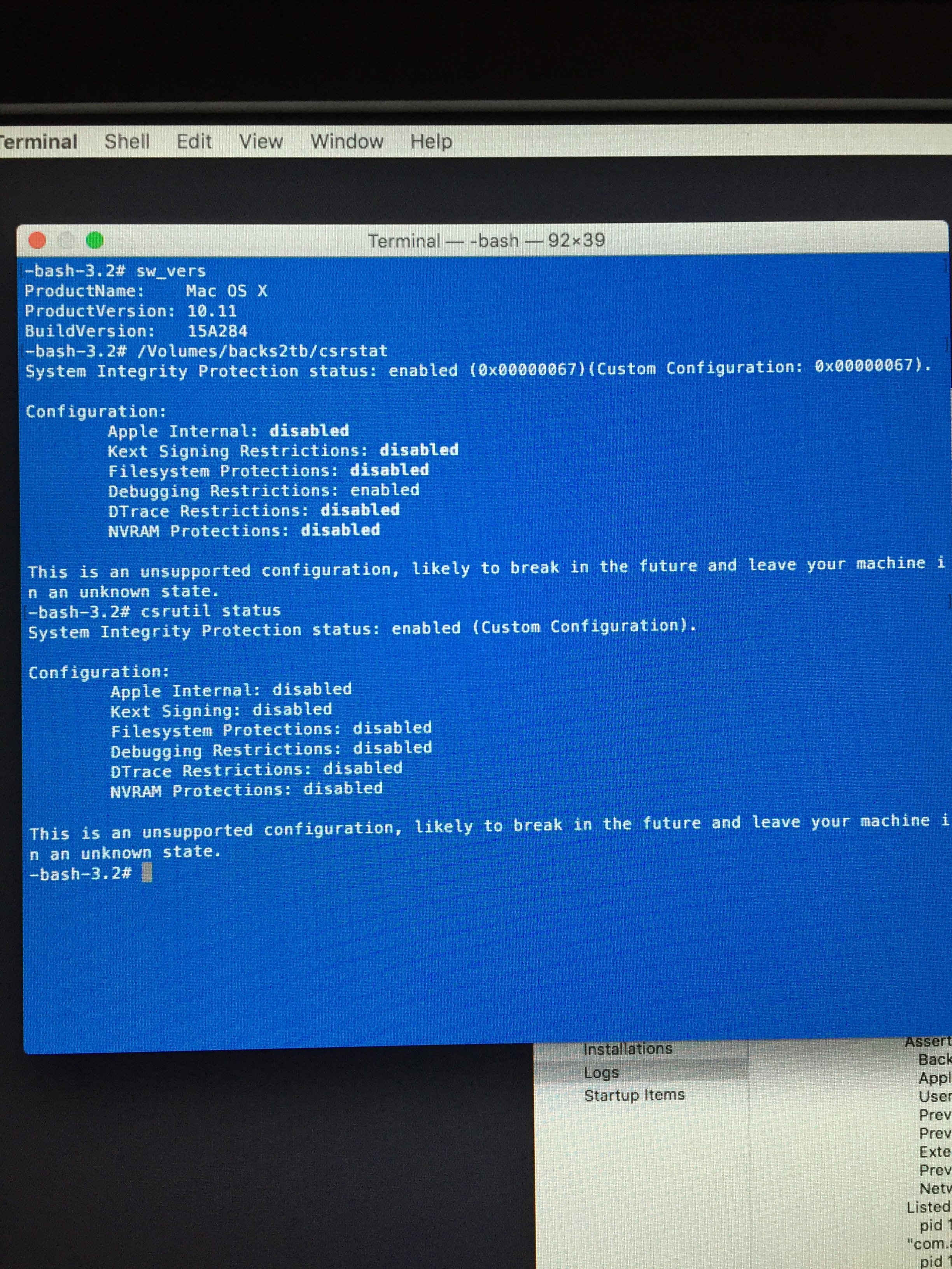

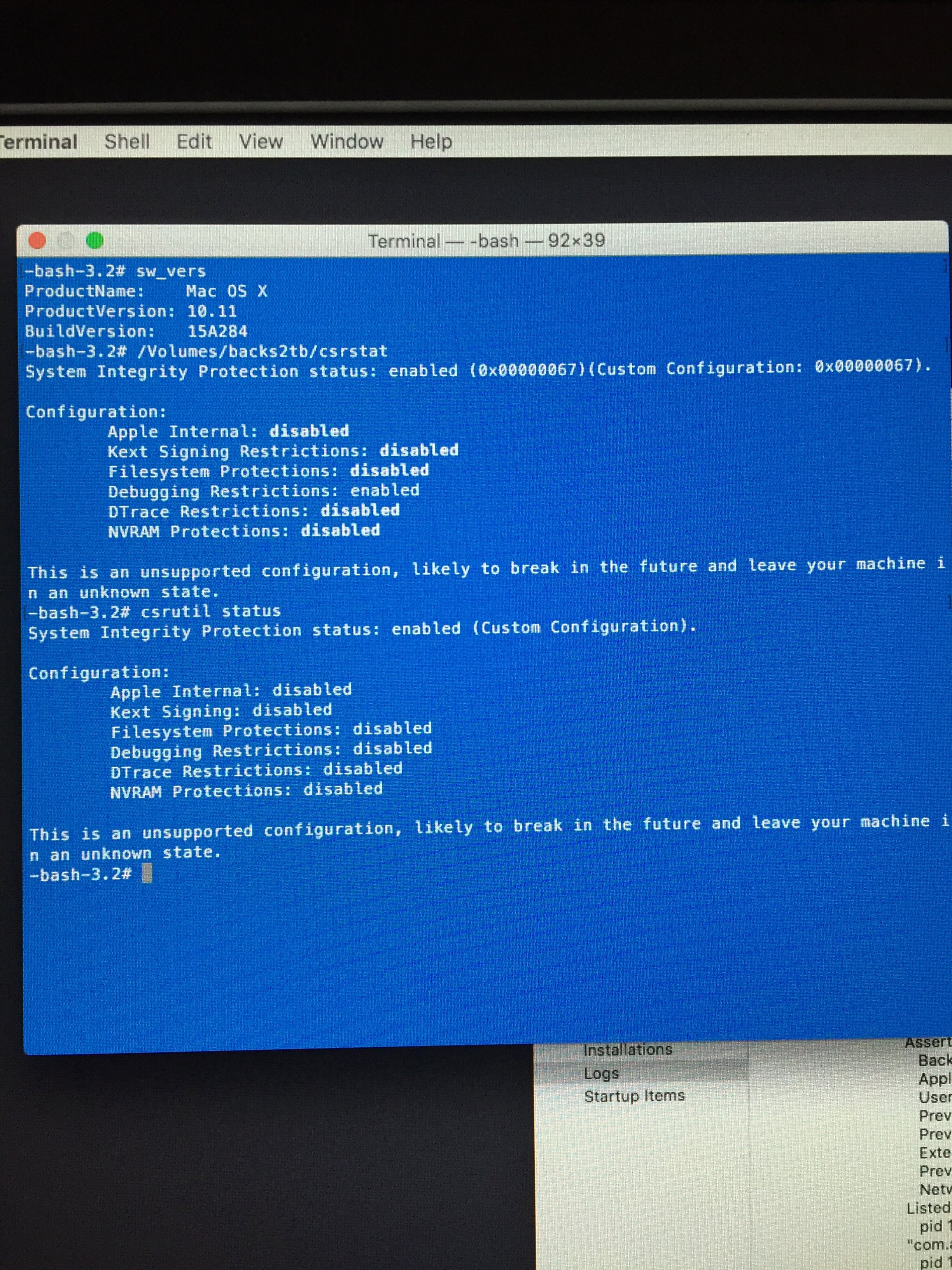

I dis-abled SIP from within the 10.11 Recovery, and slipped straight into the legacy installer (already had commit f1526943 added to it) <s>
Attached is cli output from both Pike's csrstat and csrutil while inside the 10.11 Recovery environment (booted after testing the installer, which was booted after booting the Recovery environ to disable SIP)

Tested 70f77b1a86590bdce100b5eda2f7cd574d47be1e on MBP2,2:
· legacy Installer (Hennesie-Guide) - boots into the Installer-GUI, install starts, but Kernel Panic after 2 mins.
· createinstallmedia Installer(*) - boots into the Installer-GUI, install starts, but Kernel Panic during part 2 of the install.
· transferred OSX - boots into Desktop, but Kernel Panic shortly after.
(*) createinstallmedia-Installer: Apple-native created via Terminal-command, all 3 Boot.efi in ./IABootFiles , /S/L/C and u/s/i386 replaced. Both PlatformSupport.plist as well as OSInstall.mpkg not modified.
I'm a bit lost, reading NVRAM only gives this:
Code:
Marvin:Entwicklung sko$ sudo nvram -p
Password:
bluetoothInternalControllerInfo    %06%82%ac%05%00%00 ]%00%17%f2%a2%b1%f3
fmm-computer-name    Marvin
bluetoothActiveControllerInfo    %06%82%ac%05%00%00%00%00 ]%00%17%f2%a2%b1%f3
SystemAudioVolumeDB    %c8
SystemAudioVolume    %08
LocationServicesEnabled    %01
csr-active-config    %80%00%00%00
IdlePML4    %d0%da%ce%0e%80%ff%ff%ff
Shouldn't there be more variables? I tried the better part of today to solve this mystery, but I guess it doesn't matter anymore now that installer detection works.
For these you use:
nvram 4d1ede05-38c7-4a6a-9cc6-4bcca8b38c14:IASCurrentInstallPhase
nvram 4d1ede05-38c7-4a6a-9cc6-4bcca8b38c14:IASInstallPhaseList
nvram 8D63D4FE-BD3C-4AAD-881D-86FD974BC1DF:boot-info-payload
