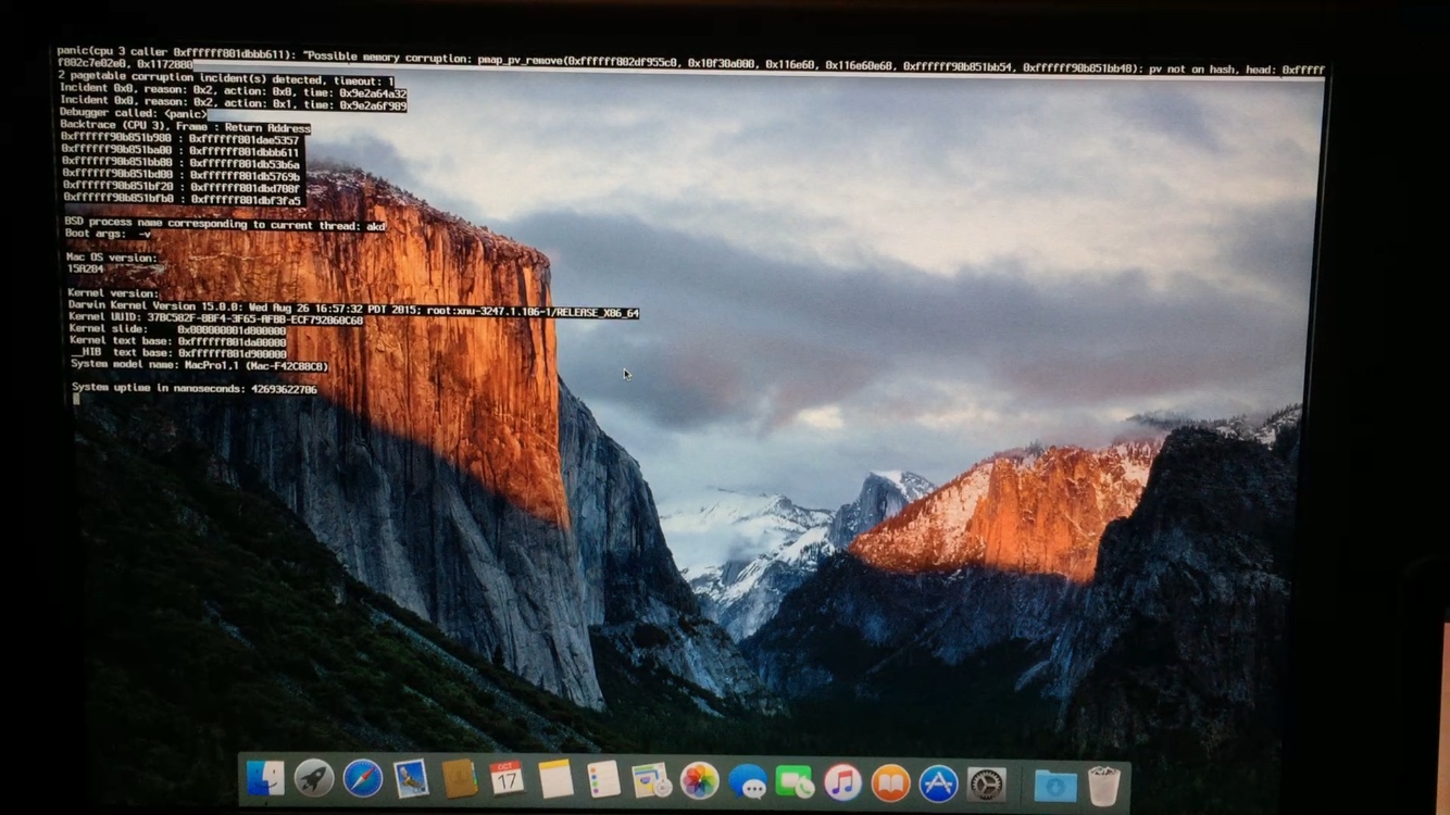

Is anyone experiencing continuous kernel panics? Even under Yosemite, as soon as I use the new boot.efi my Mac goes nuts..

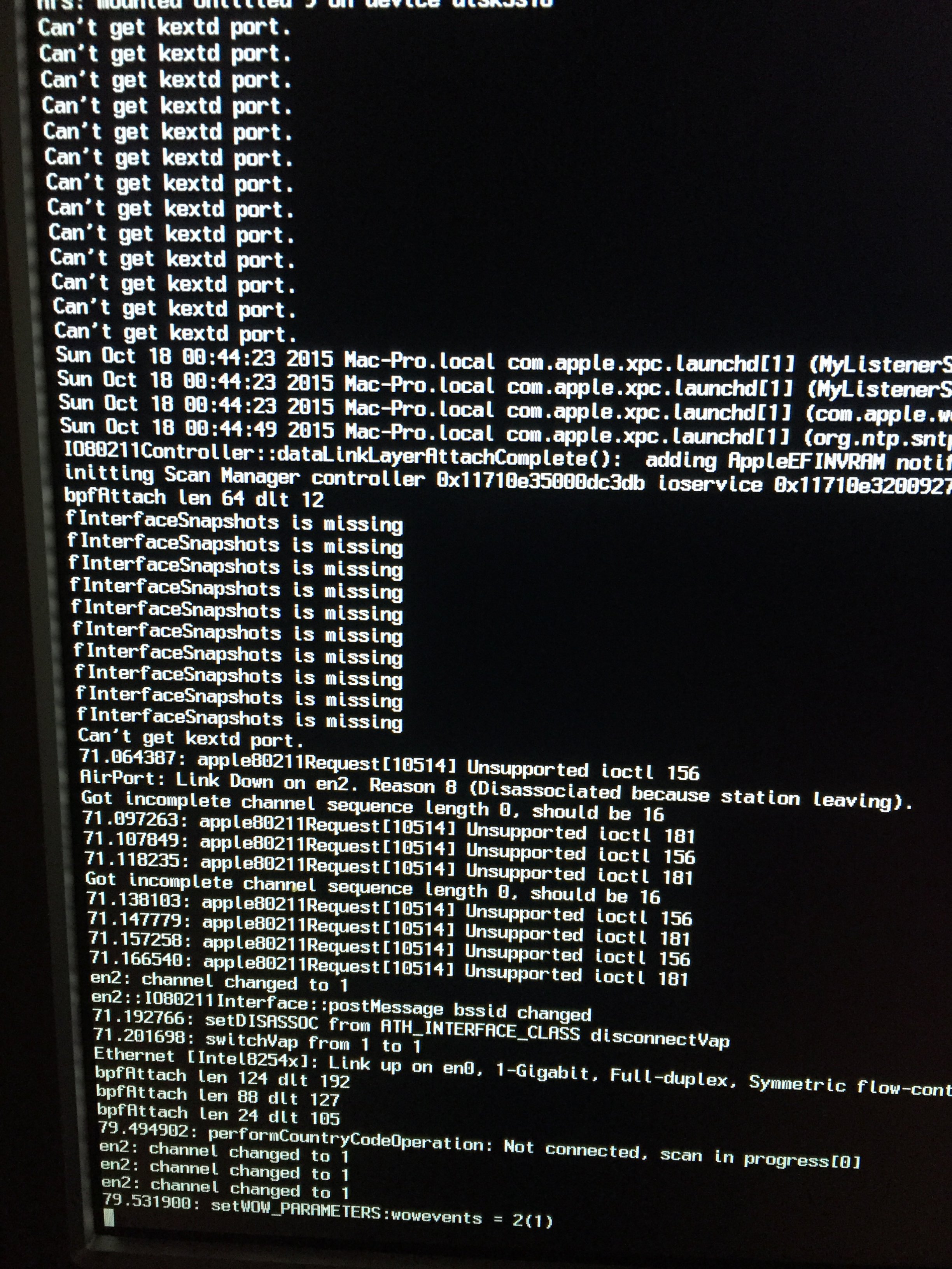

o.k., so I created a new legacy installer by starting with a clean copy of Install El Cap.app
imaged BaseSystem.dmg, deleted the S/I/Packages symlink, copied the complete Packages folder over to said, copied BaseSystem.dmg and BaseSystem.chunklist to /, extracted the kernel to S/L/Kernels, and replaced the three .efi with that compiled from commit b744c92e
I did not modify any .plist, nor did I mod the Distribution located in S/I/P/OSInstall.mpkg

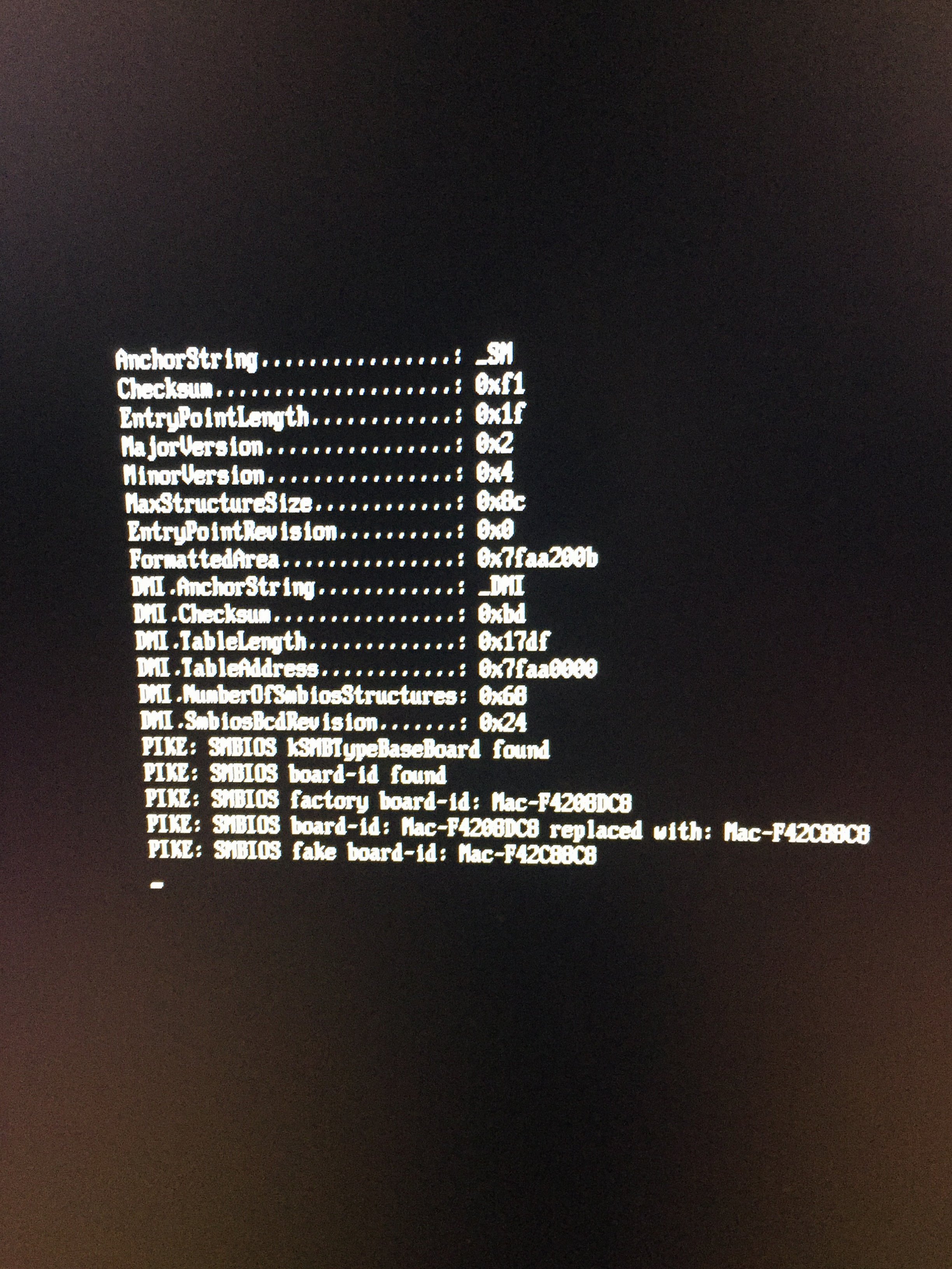

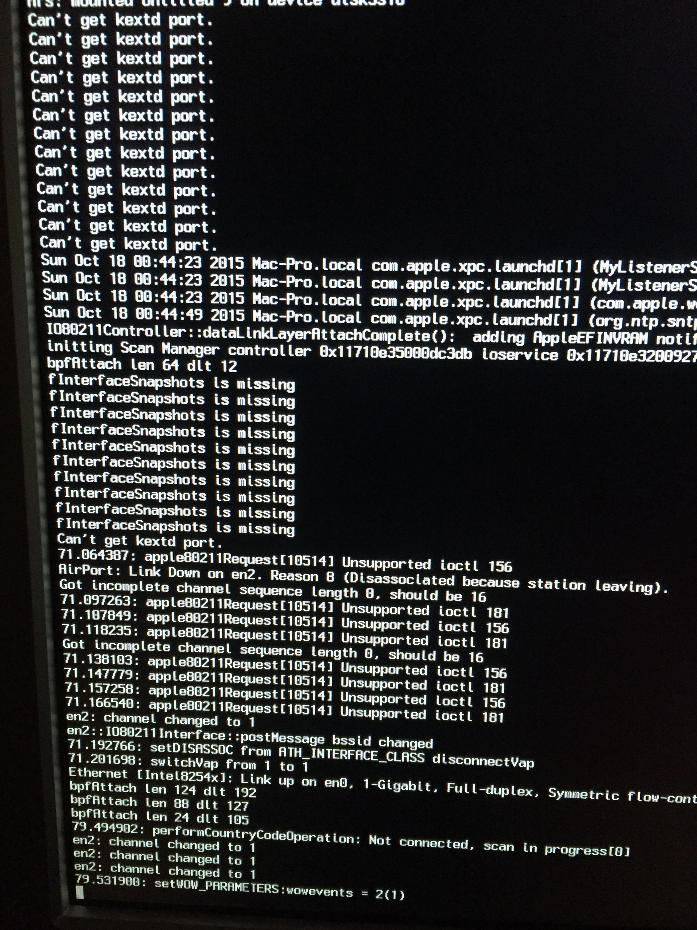

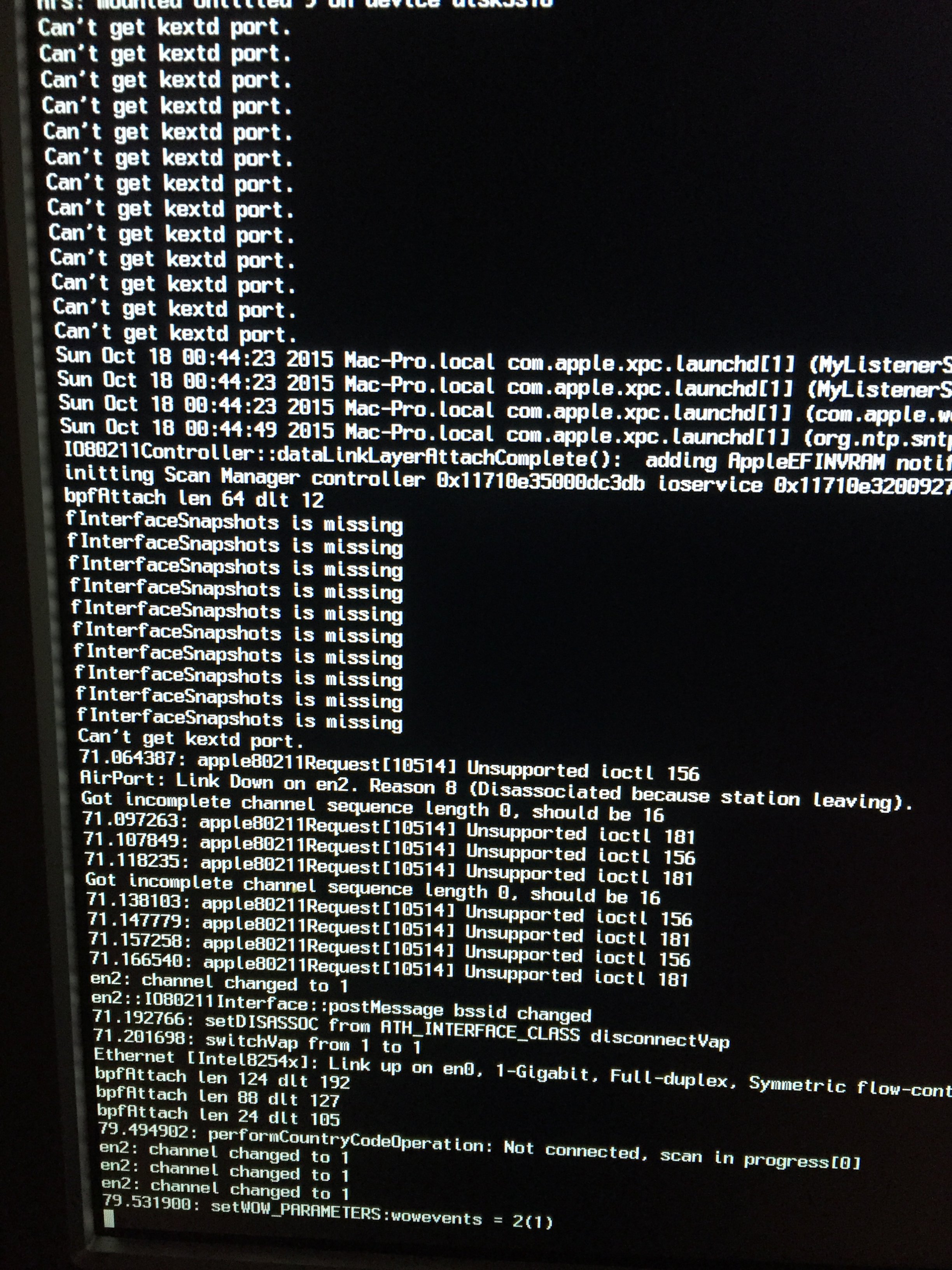

Same results as before: "Waiting for DSMOS" (attached output was one minute prior to the "Waiting for DSMOS" hang/stop point).
It seems to be the AirPort card, but I just don't have the attention span to remove it, now, to see.

Thank you Peter but unfortunately this doesn't solve my problem.
Forgot to mention that that was a clean installation made on my supported rMBP.
I don't know, maybe there's something about my configuration that the new boot.efi doesn't like?
I'll try the 2.1 without the board-id replacement and report, that's the only thing I can think of..
EDIT: 2.1 panics too, but after a lot of time, compared to 3.0

Try boot argument: -pmap_pagetable_corruption_deassert and if that doesn't help then recompile for Yosemite (see line 17 in StdAfx.h) and then use that for your Yosemite installations.
p.s. Add a (link to) the output of kextstat
Also. Since the KP list akd – AppleWatch/iPhone simulator related framework daemon – as the current thread, what version of Xcode do you have installed?

Pike, FYI, each kernel panic has a different active process, and right now I've only installed El Cap and Server.app.
On the other HDD, (Yosemite) I compiled and used the latest commit of the master branch with no issues.
Now I've launched memtest with max n of cycles.. Maybe some of my RAM isn't perfect..

I tried to remove my Airport card, but one screw sits so tight I'd have to remove the mainboard to get it loose and while I haven't done that in a while and could use some practice, I won't do that.
Is there another way, maybe 'unmount' the airport card from the device tree early in the process?

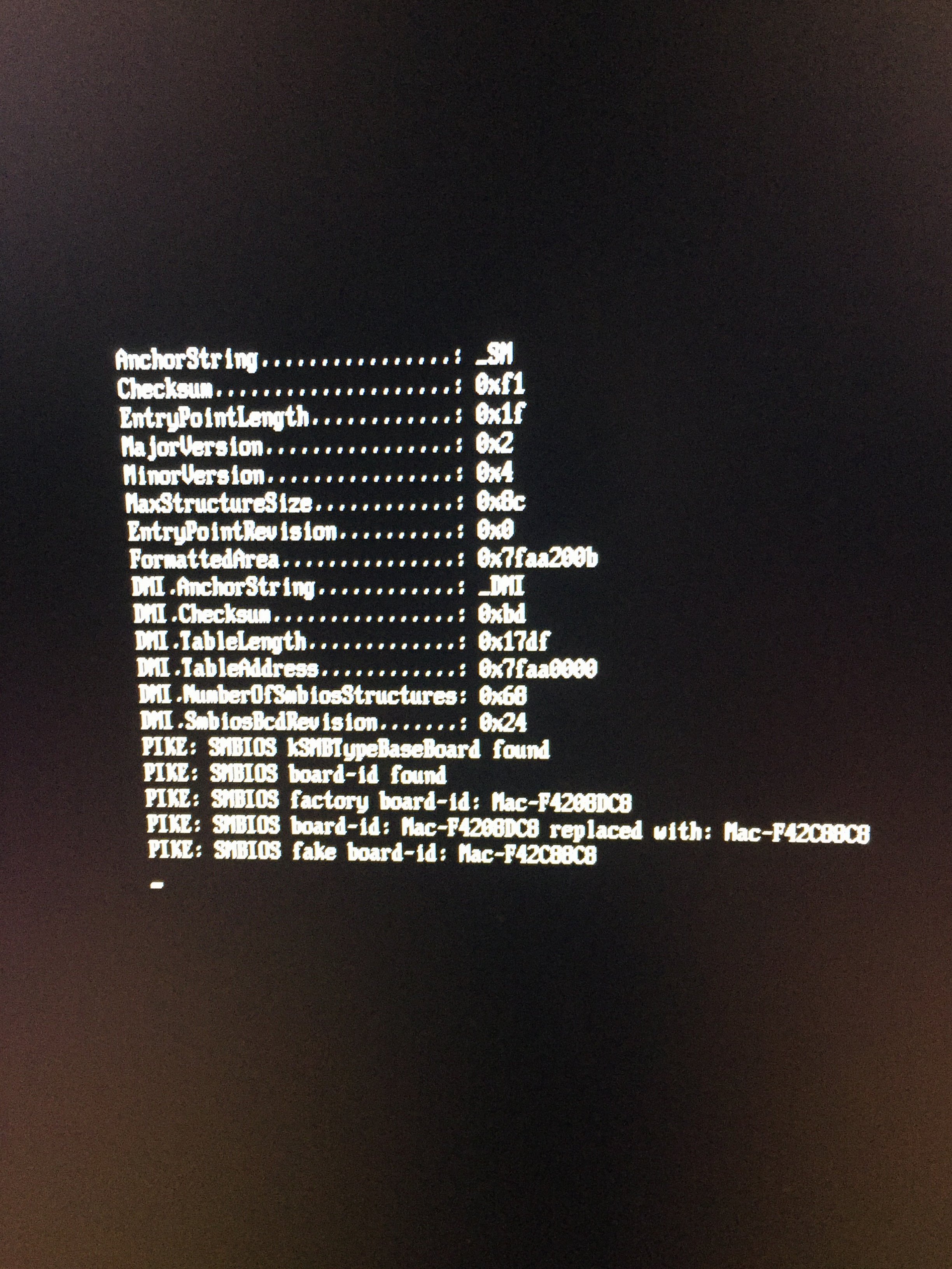

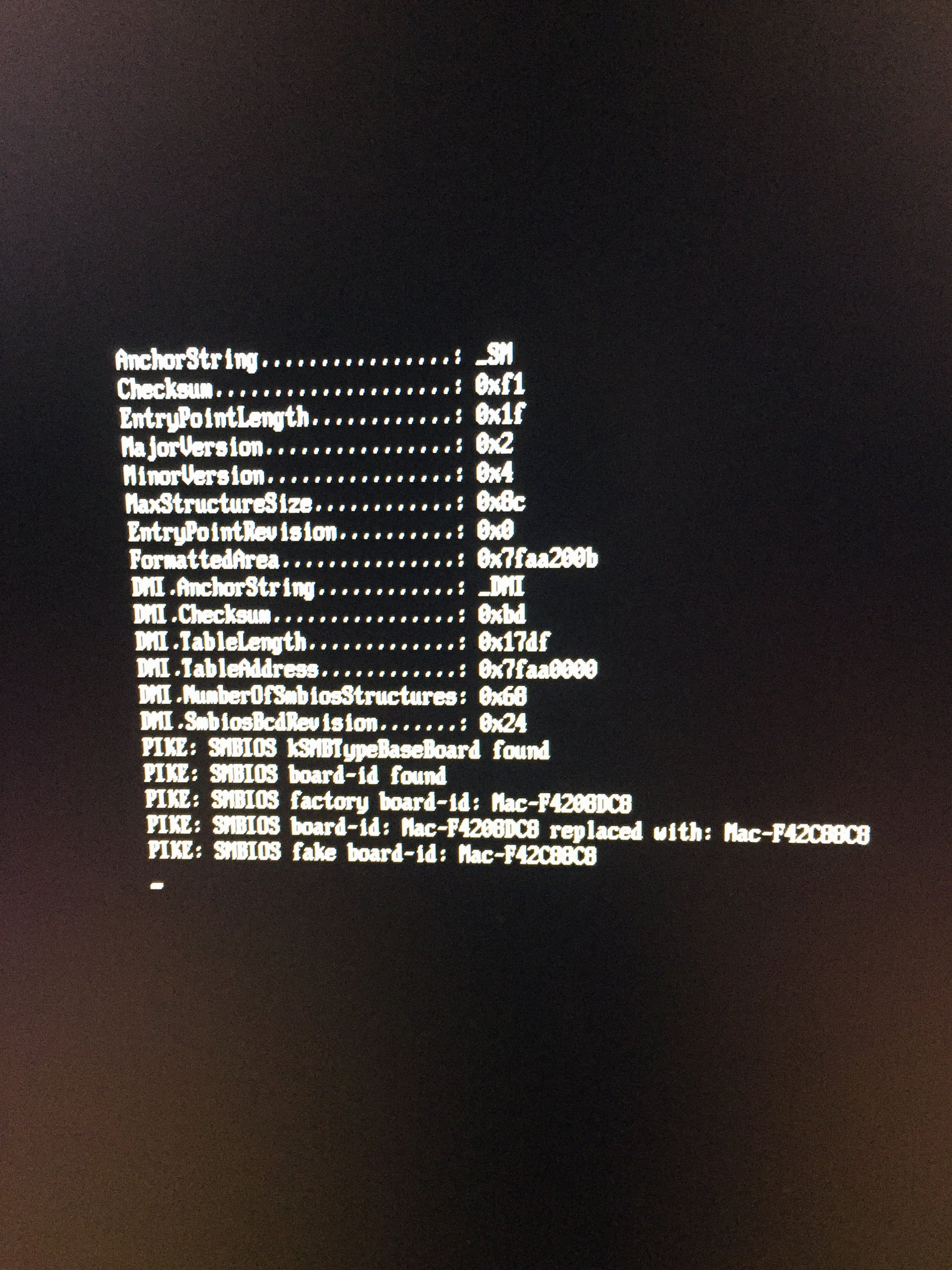

Changing the board-id in the boot.efi file changes the "Hardware UUID" as I expected, but what i did not expect is that the new "Hardware UUID" is already in use by another user's system, as i was unable to activate some software for this reason, as the "Hardware UUID" was being used for unique system identification by the developer, as I believe Apple recommend. The "Hardware UUID" is also used by Apple for various system identification purposes that conceivably could be a serious problem... It might be an idea to make a boot.efi release available without changing the board-id and hence the "Hardware UUID", as I believe the only purpose of this change of board-id is to enable initial installation through the App Store?
No. The board-id is not involved. What you are seeing is the result of the addition of the 'system-id' property, which was missing in all versions of Tiamo's copies of boot.efi, and the one I made for Yosemite. This change changed the IOPlatformUUID aka Hardware UUID in the System Profiler, but now it is exactly like Apple is doing in their versions of boot.efi
You can check this by booting into Yosemite and witness a load of zero's before your MAC address (because that is basically what you had back in the days).
