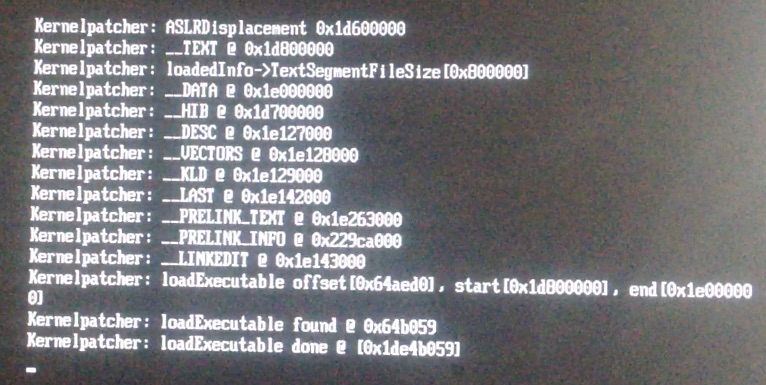

Unleash debug output.

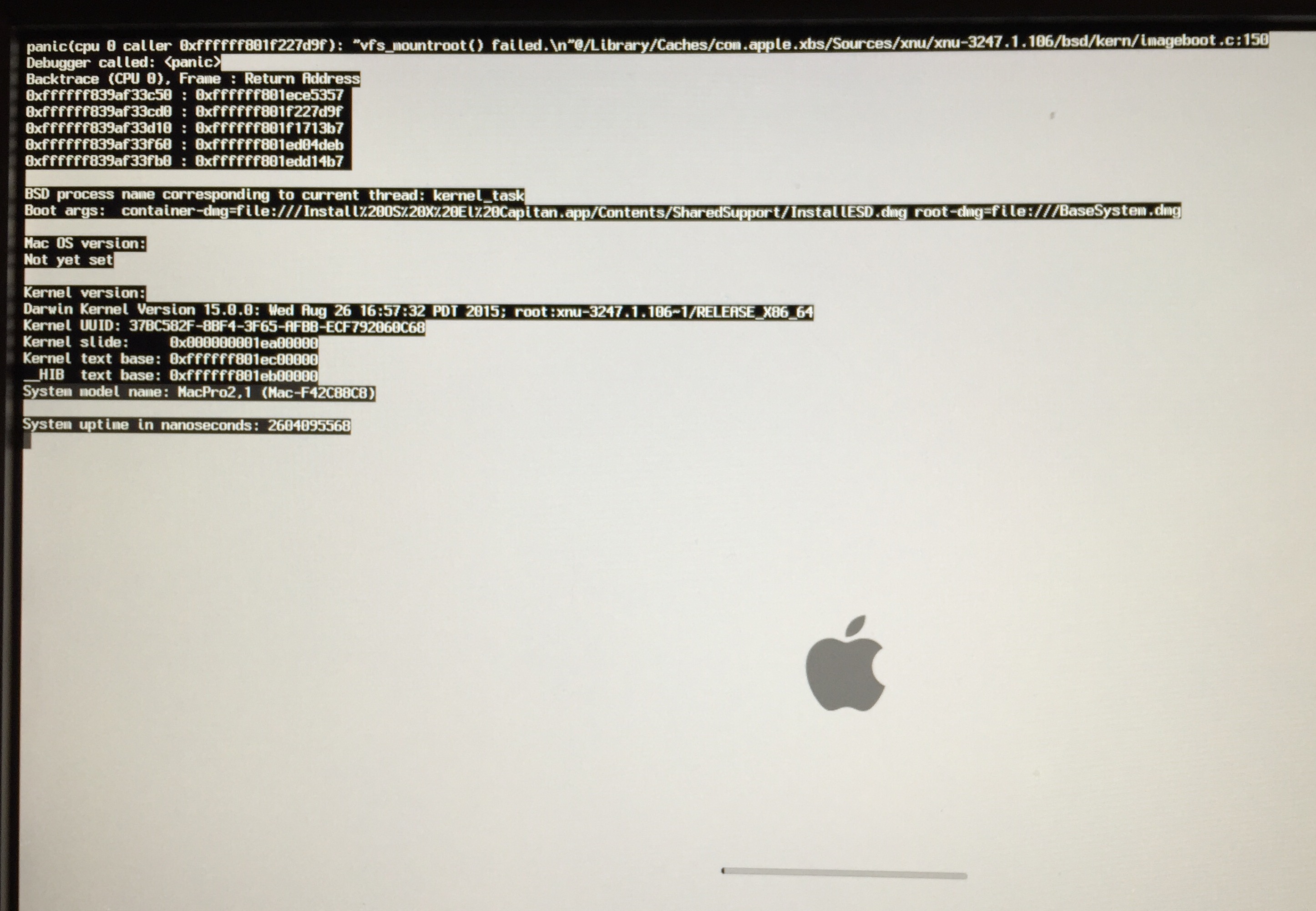

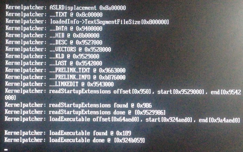

Commit 09ba6c...

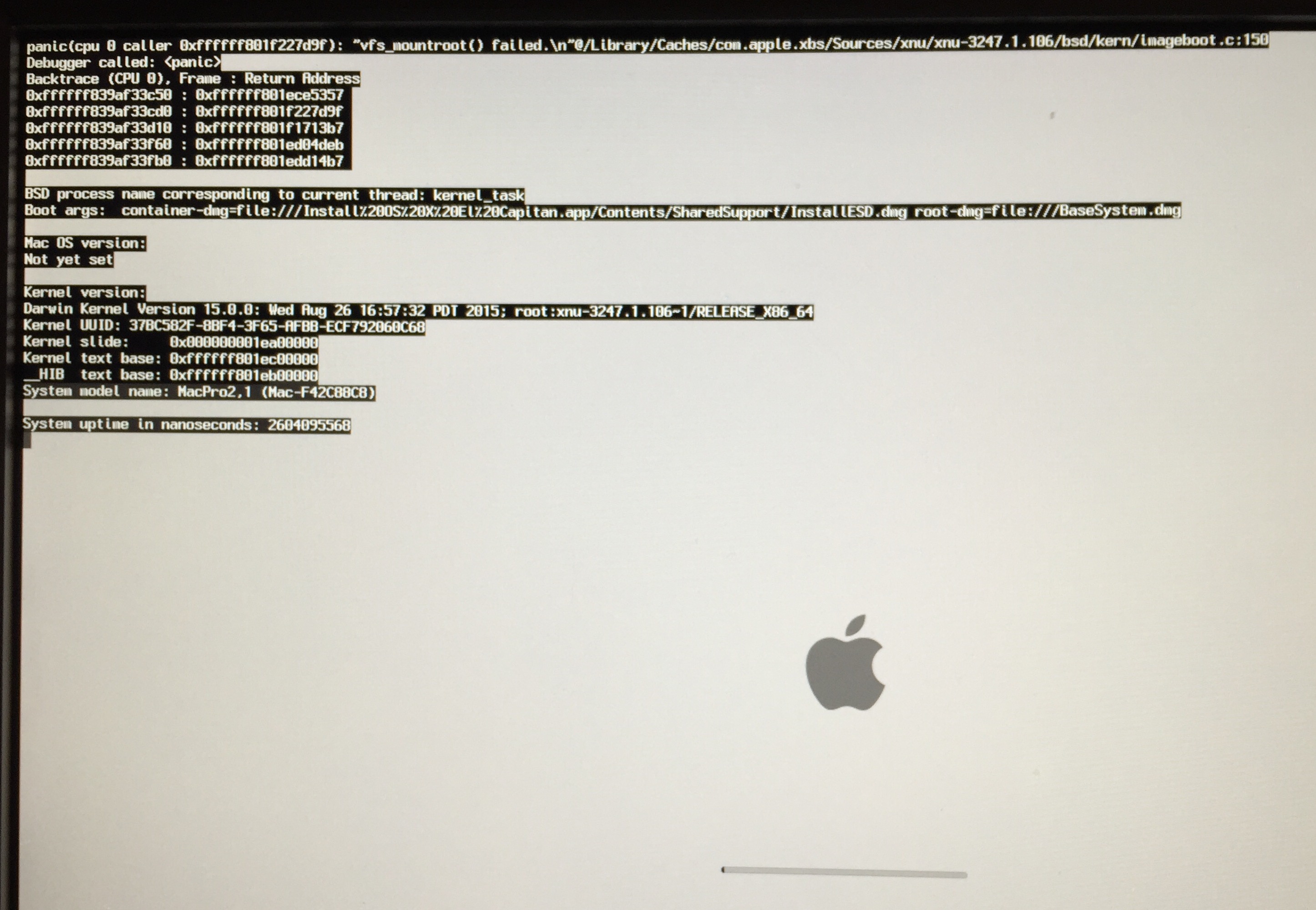

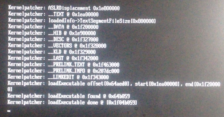

(bootarg slide=0, "createinstallmedia" usb installer, OS X 10.11.0)
Debug output attached. By the way, we're looping through error messages saying root can't be mounted.

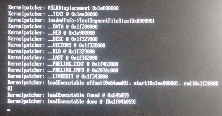

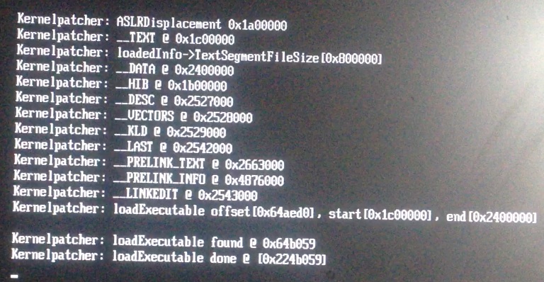

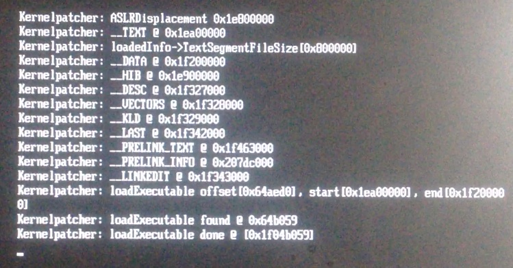

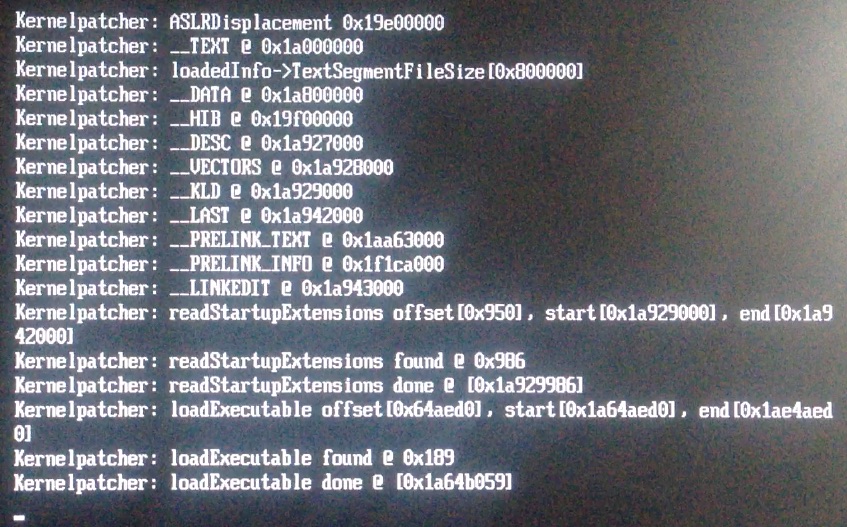

Commit 09ba6c3
Booting ok into installer GUI for legacy and official.
Reactions: Pike R. Alpha

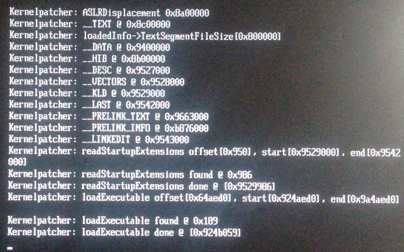

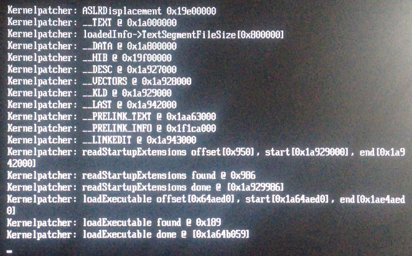

Unless it skipped my attention before, this time, however, it says "loadExecutable found @ ..." That sounds kind of hopeful to me.
Yup. It certainly does. The new commit will be faster, by skipping to the desired offset. Output address will now be 0x189 (again).
Edit: To all testers; thank you for testing my changes!
Edit-2: Stupid me. Had an error in the second search pattern. Should be fine now.

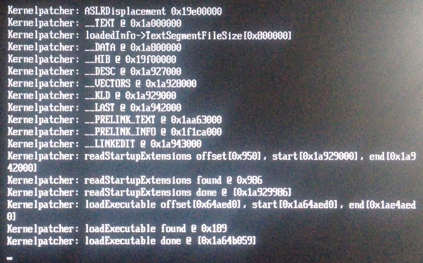

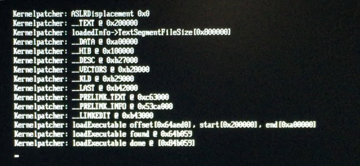

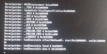

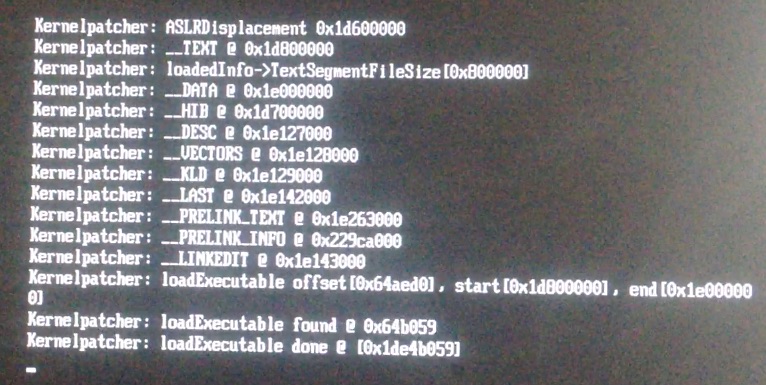

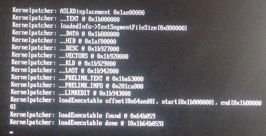

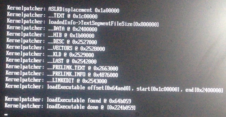

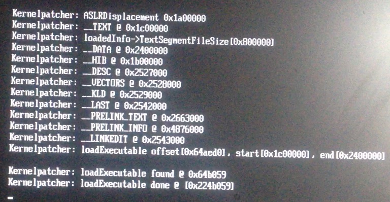

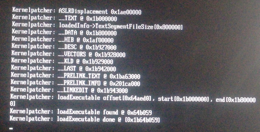

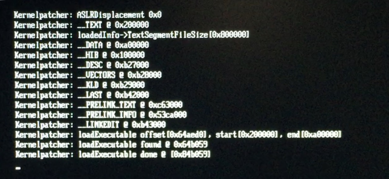

Commit bf0b21a
debug output

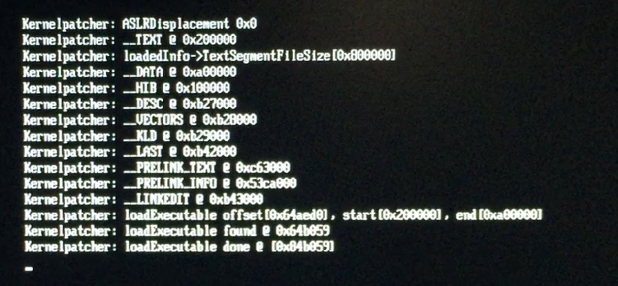

Commit bf0b21a
debug output
Hehe. Finally!
Thank you guys!
Special thanks @splifingate for his excellent help.
The main problem was that I failed to notice the difference between an 8 and B. Boy does that suck. So much time wasted. Sorry about that!

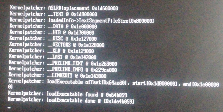

Commit 8f70eff boots every environment, legacy, official, recovery and live. Waiting for black edition to put on my main drive with 10.11.1 on it.

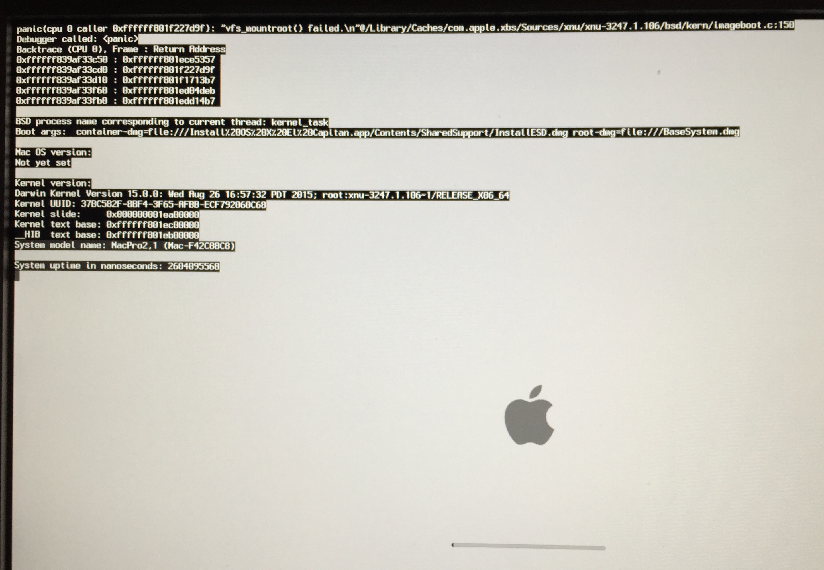

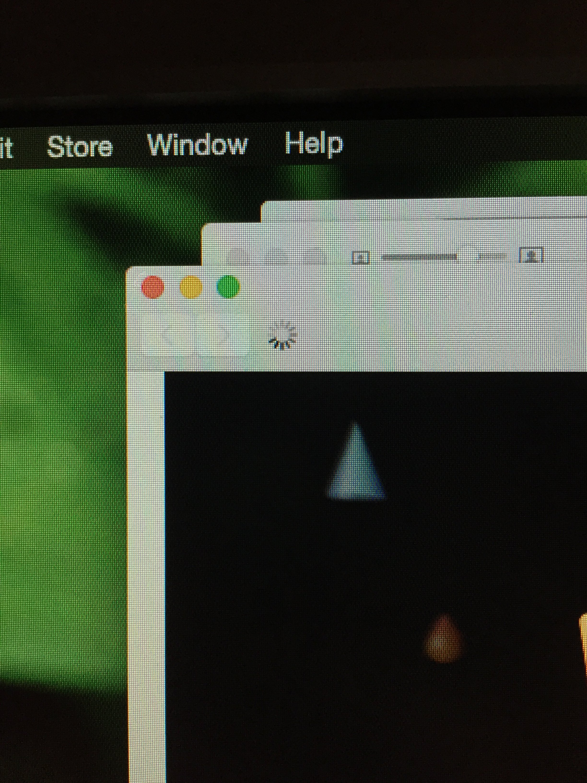

d/l of 10.11.1 from app store from within both Mavericks and Yosemite fail somewhere at the tail-end after downloading the entire 6GiB app. … seems like an iClod/account prob (later).
All other instances successfully boot, except createinstallmedia, which throws a kp early in the boot (attached)
Successful use of csrutil booted into 10.11 Recovery HD (though I don't know who to believe, with all the enable/disable crossover).
And the app store download and 'createinstallmedia' method used to work, right? Works with v3.0?

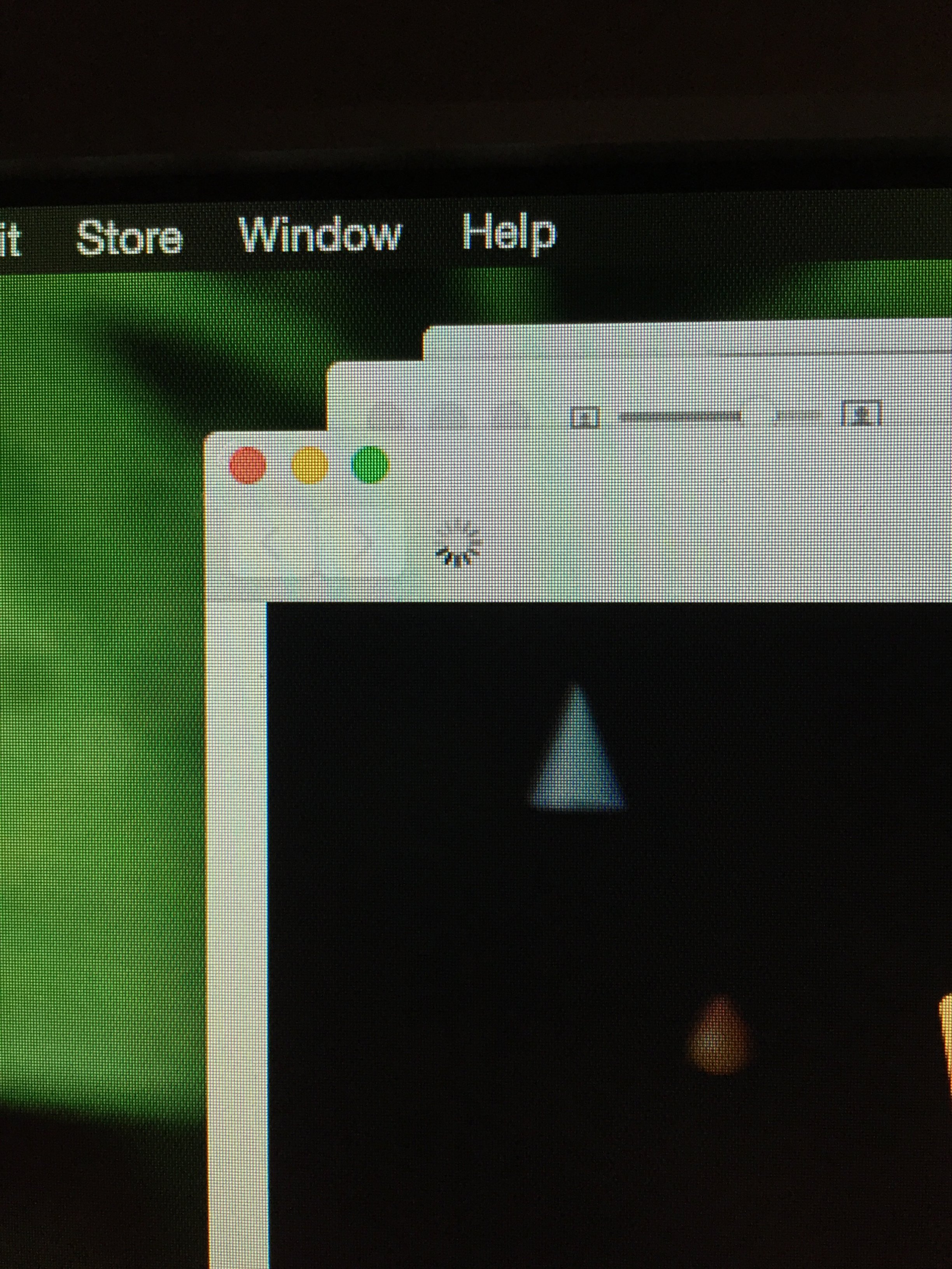

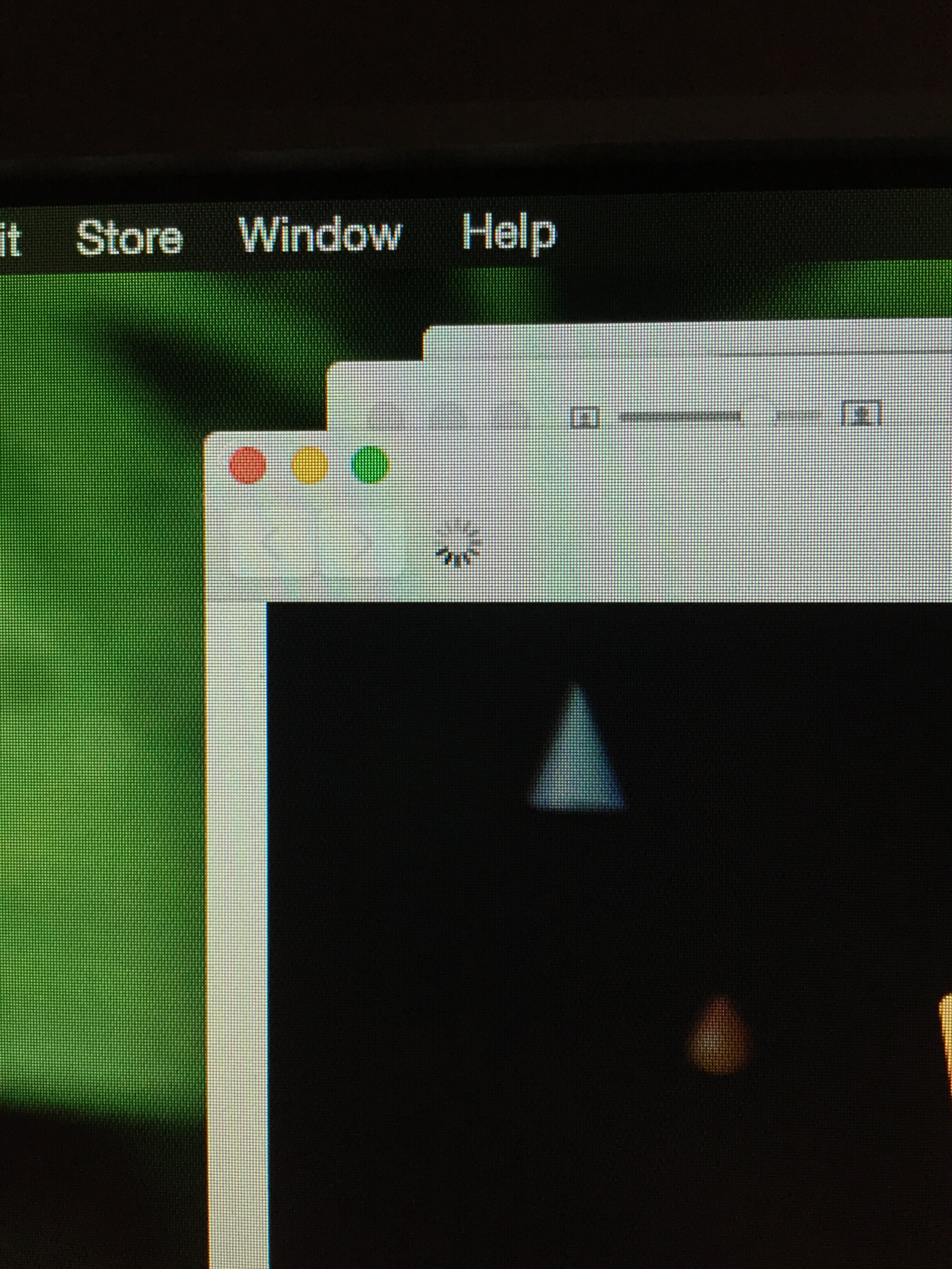

d/l of current ElCap .app from app store in both Yosemite and El Cap currently just wait indefinitely with the spinner in the app store
[edit]

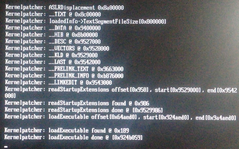

I have pulled commit 8eb2a259, and set DEBUG_KERNEL_PATCHER = 1, and re-enabled verbose for personal diag.
Also, App Store > Menu > Store > 'Check for Unfinished Downloads...' gets me from just a spinner, to the actual download (progress bar, etc.). Paused for one boot into createinstallmedia...
