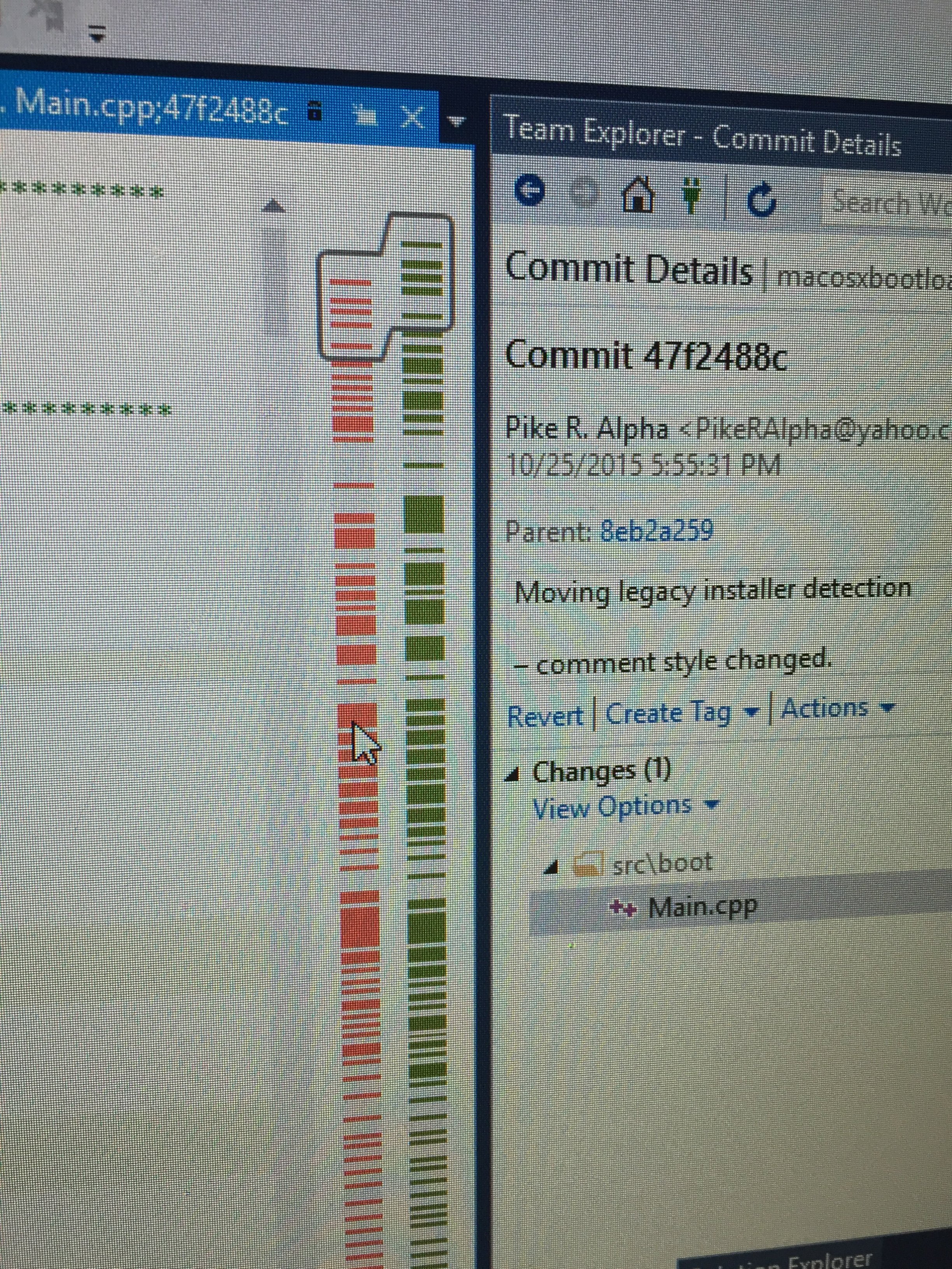

@splifingate,

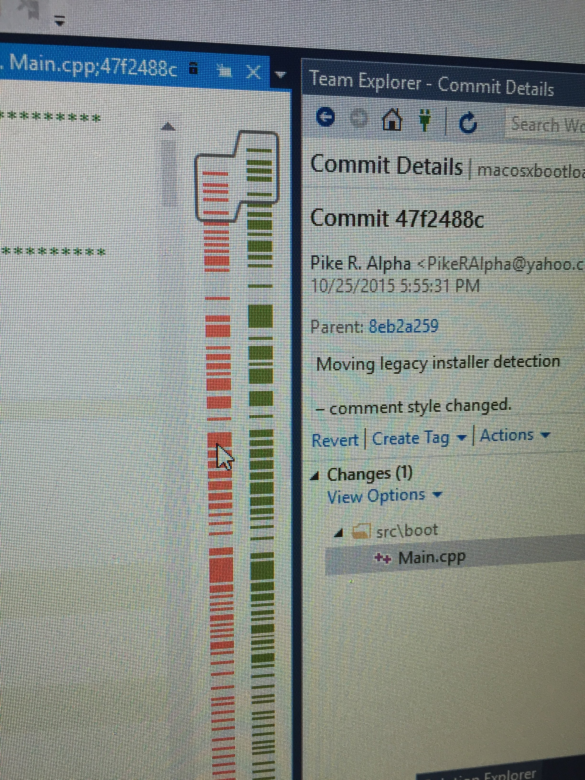

I took care of one of the compiler issues that you reported.
I also moved the legacy installer detection, so this has to be re-verified.
Look what Peter said. Debug is broken.
That, and me not having unsupported hardware, makes it almost impossible for me to fix this problem.
@splifingate,

mheh . . . that sure is a large load of code adjustment 😉

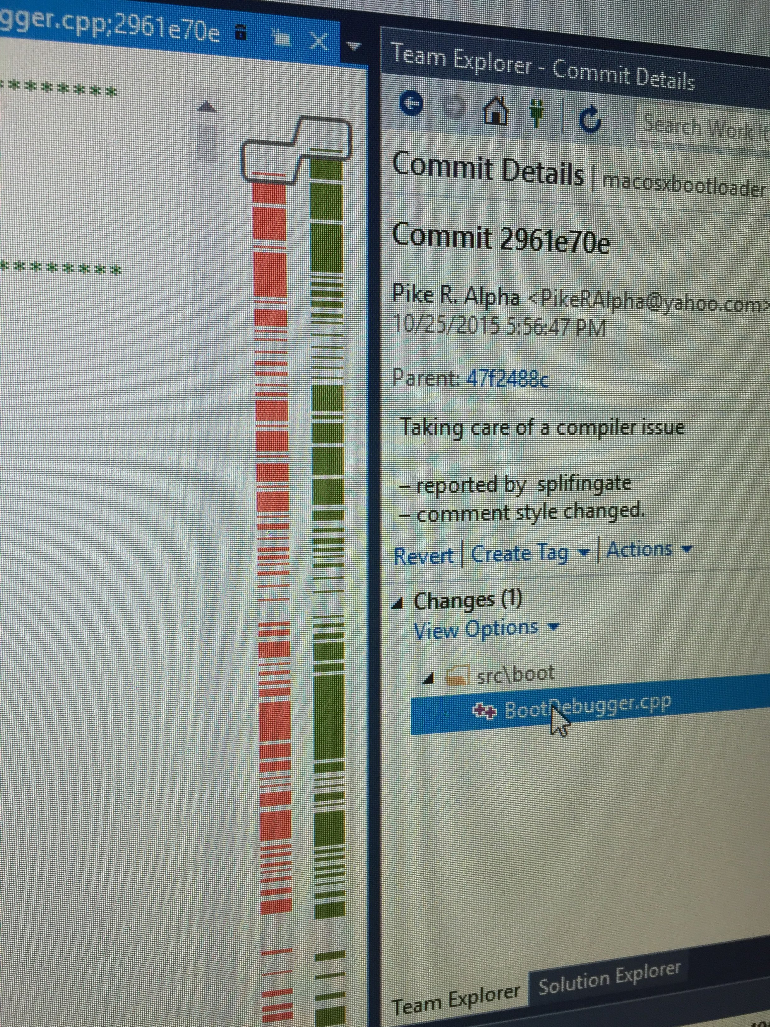

I just updated an EL Cap install from createinstallmedia from 10.11.0 > 10.11.1, and it failed because of the .efi replacement (still have yet to fixor that).

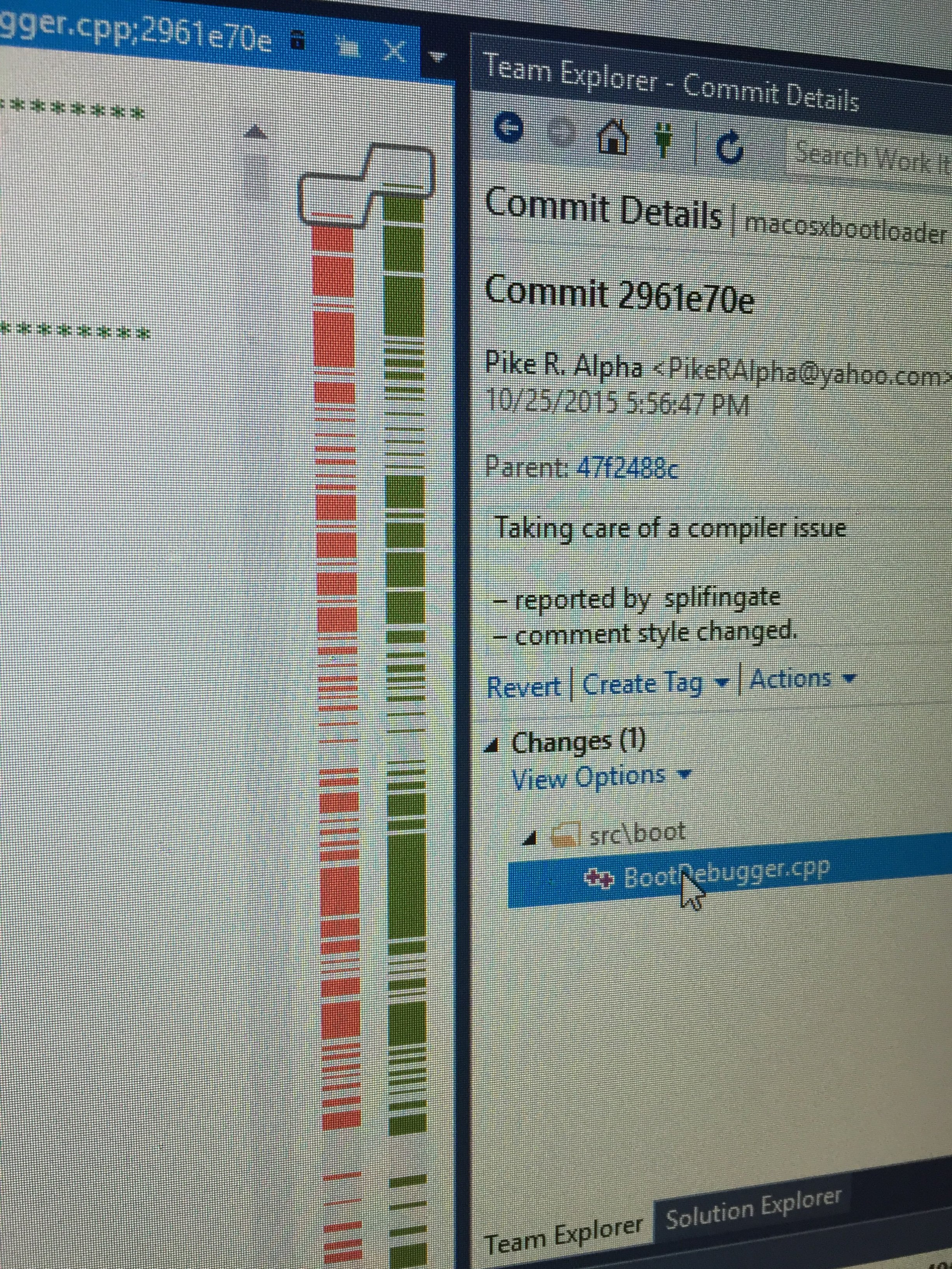

Attached is commit 2961e70e for others' use
I am in the process of placing said into current, and 10.11.1 installations (if I can actually get all the server shares to synch).
First is re-placement of legacy .efi's...
[edit]
Boot into legacy environ successful--everything performs, as it did earlier (and, as expected).
btw, Pike: code analysis on commit 2961e70e produces no errors, warnings or messages
b-btw, successful boot into 10.11.1 El Cap produced from 10.11.0 createinstallmedia, upgraded to 10.11.1 internally, using commit 2961e70e (I have debugging, verbose, and black active).
[/edit]

@splifingate,
Thanks, Pike & Peter. Got it working.

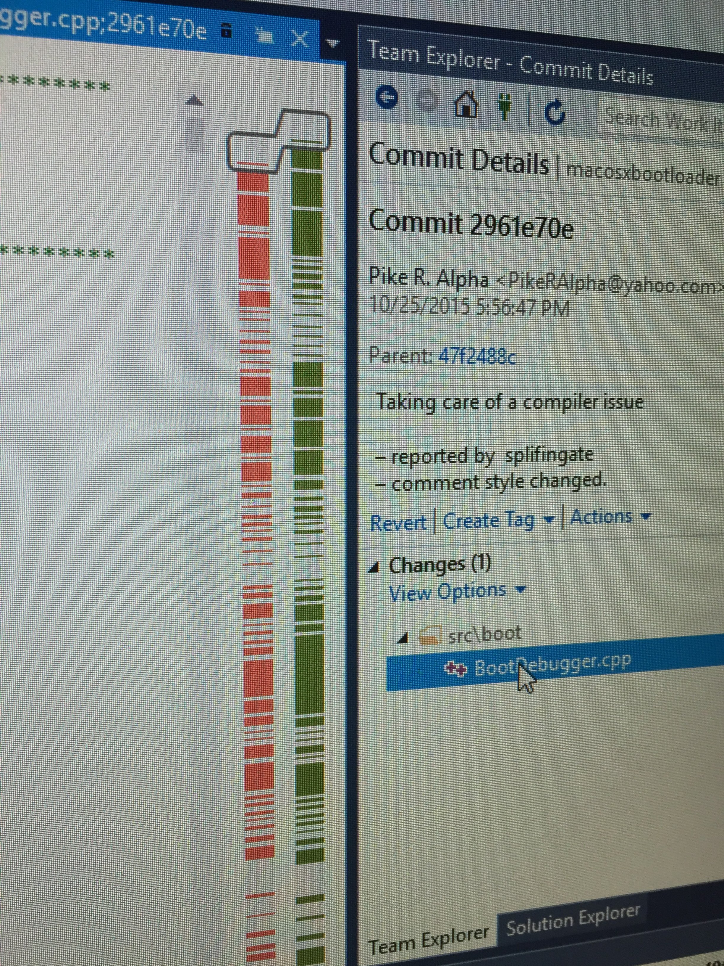

Commit 2961e7, boots to installer GUI using stick created with "createinstallmedia". No time to create and test on a legacy installer tonight, but maybe someone else will? Attached is commit 2961e70e75b9e43719cd4f2248fdda4edb0202bb boot.efi build.
Taking care of a compiler issue. Black and grey boot.efi.
Oops! I've just seen that splifingate and randyoo compiled the same thing while I was doing it. Oh, well. Here you have a choice of colours.

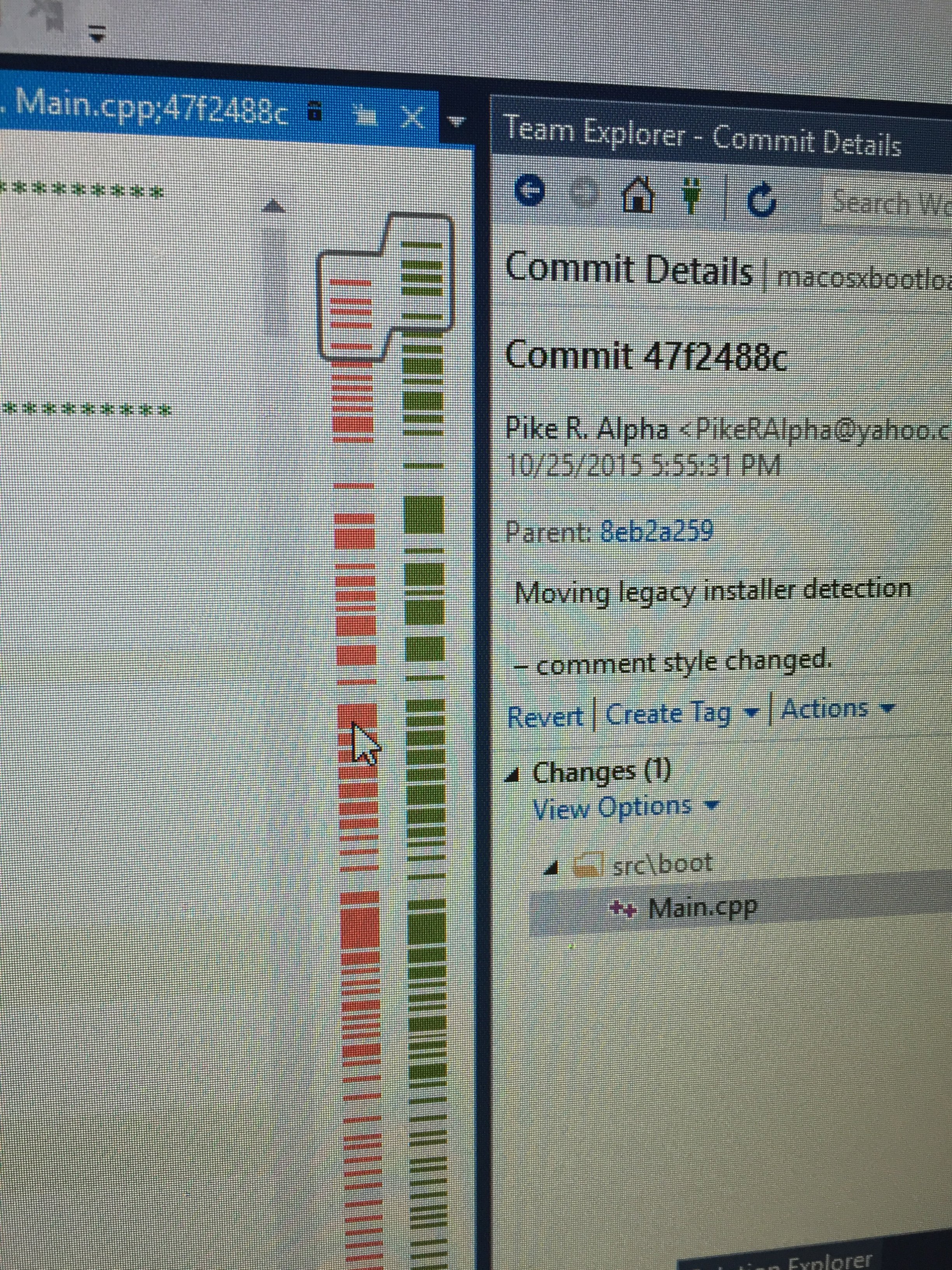

Pike, I meant to share this with you yesterday when I saw it, it made me think of you: http://imgur.com/NaDrX1e
If there's anything I can do or try to help fix the debug compile, just let me know

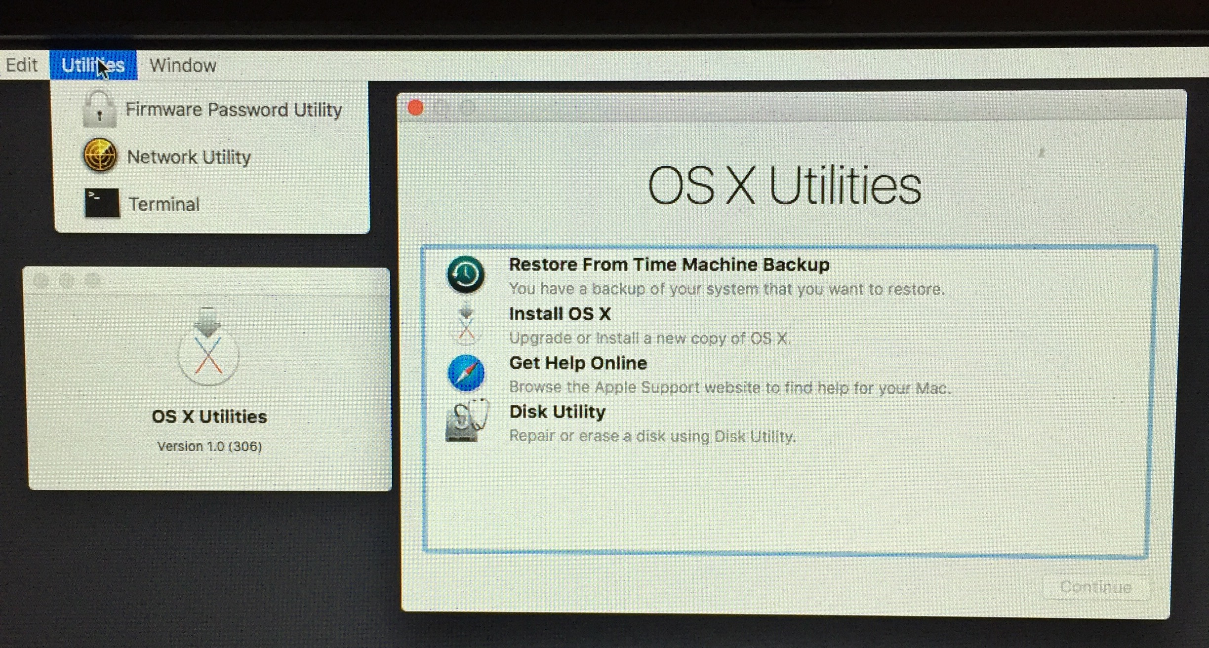

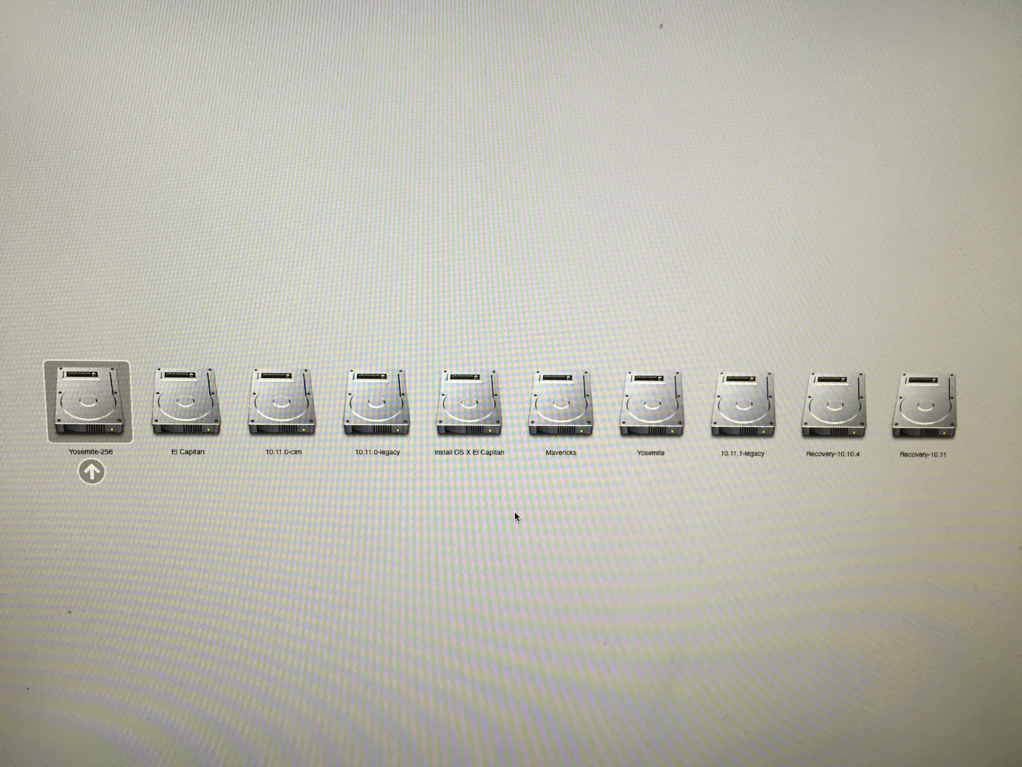

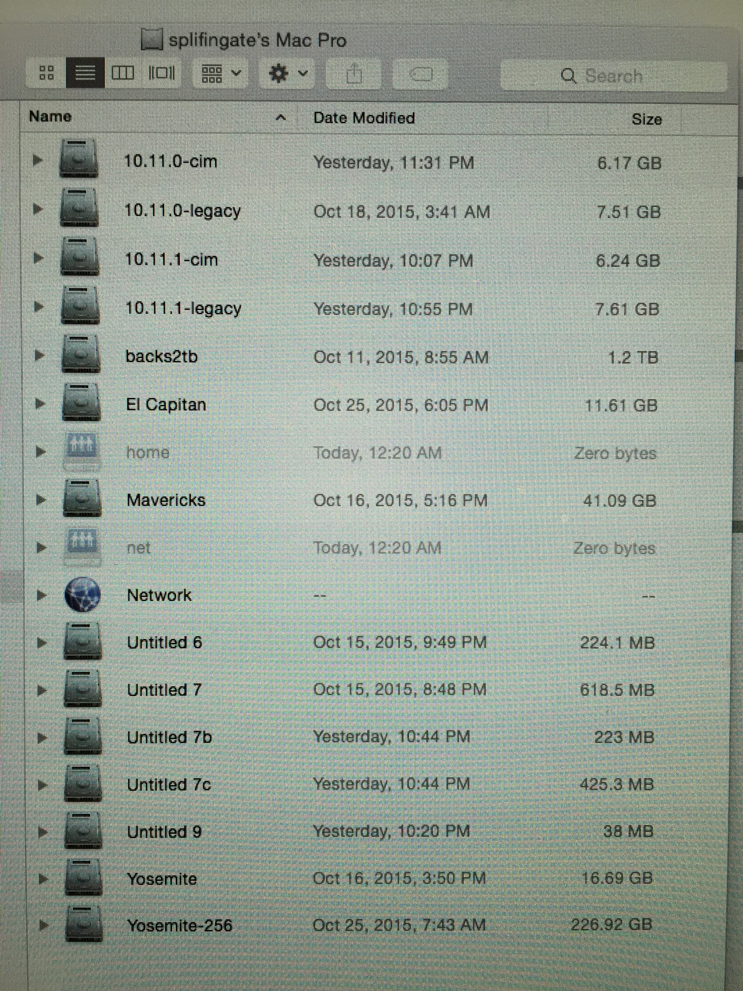

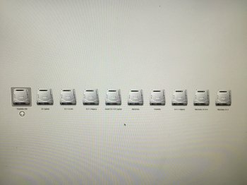

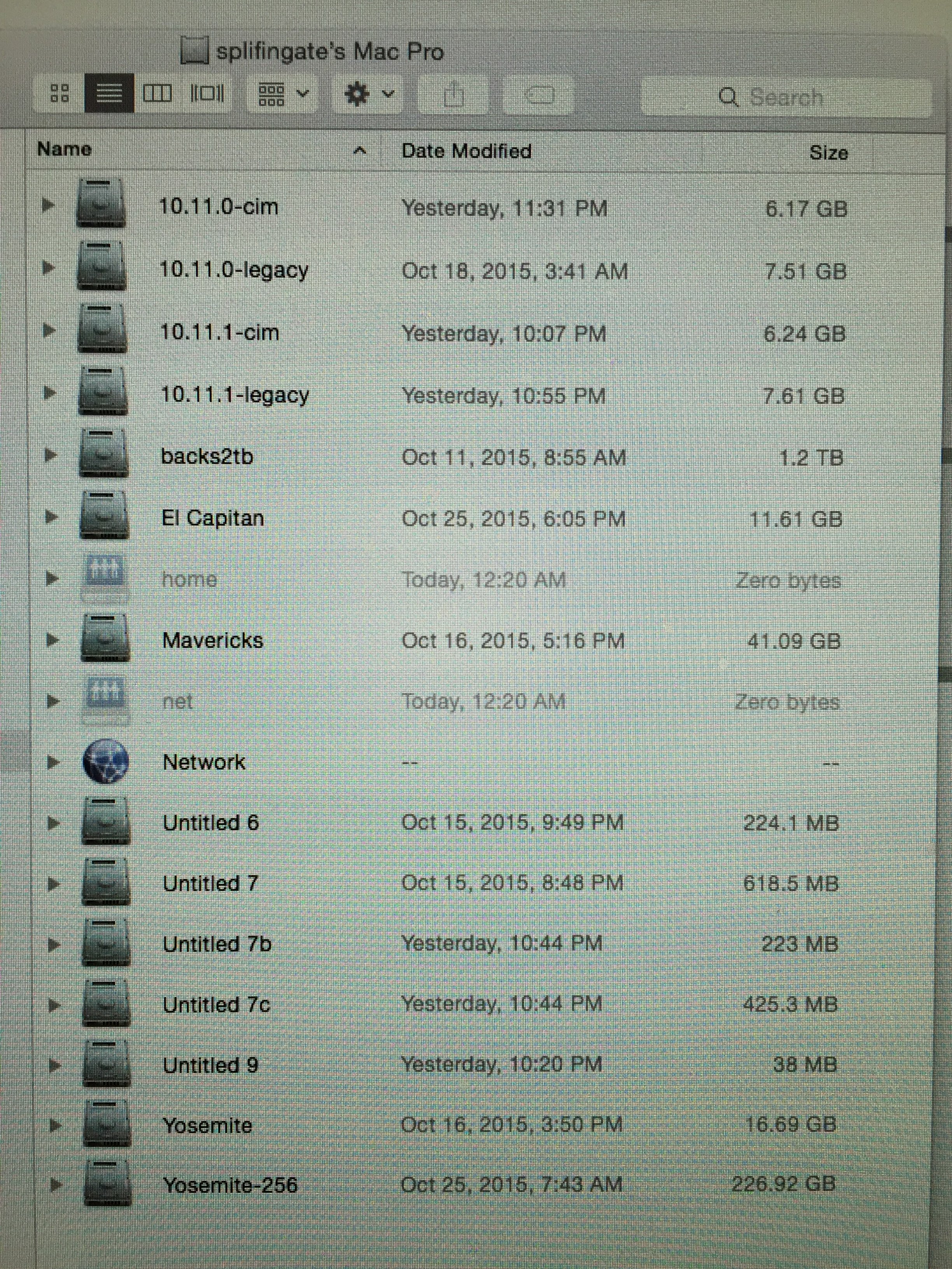

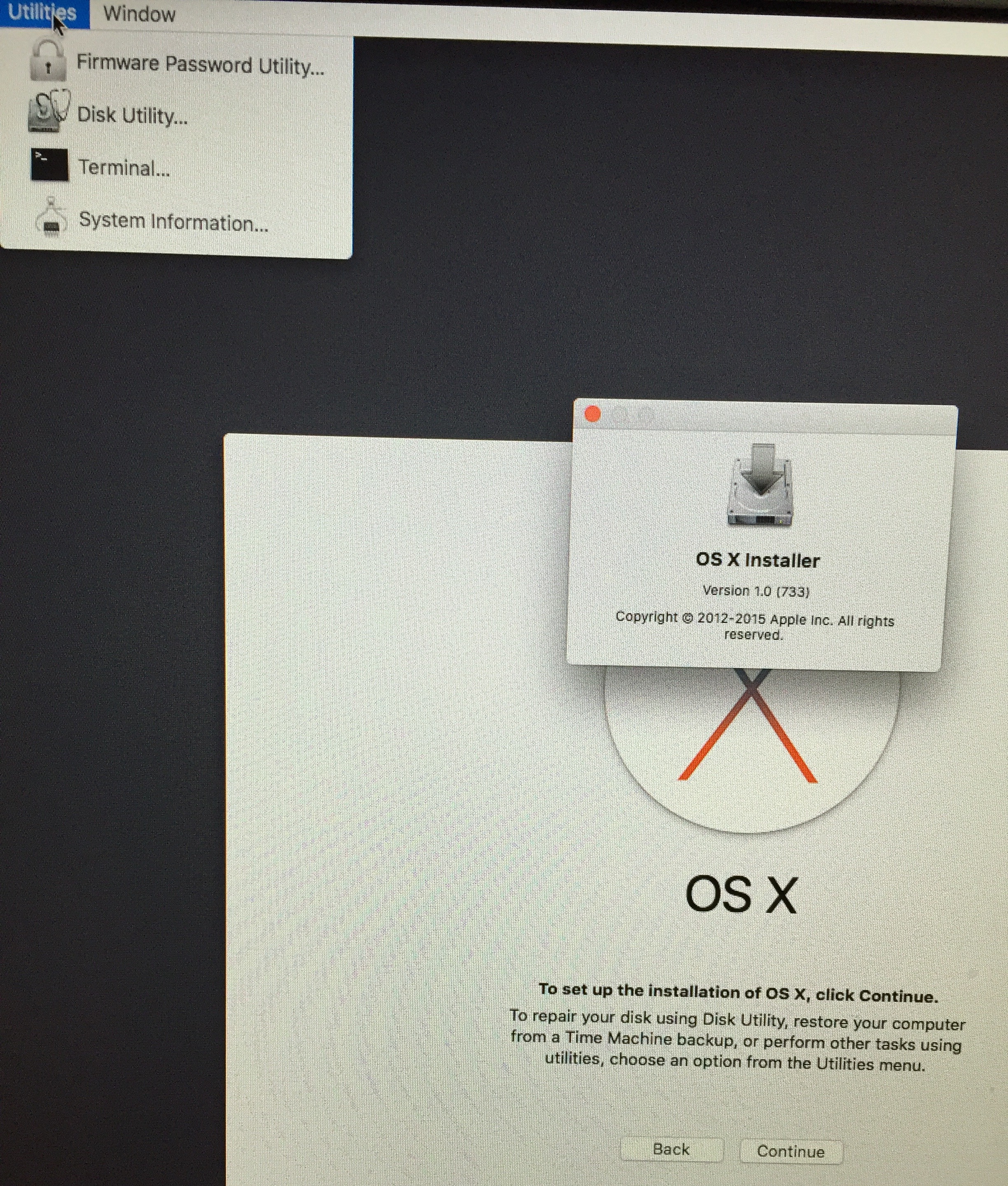

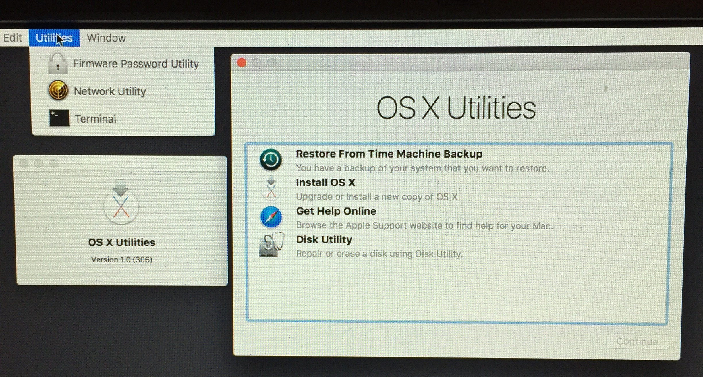

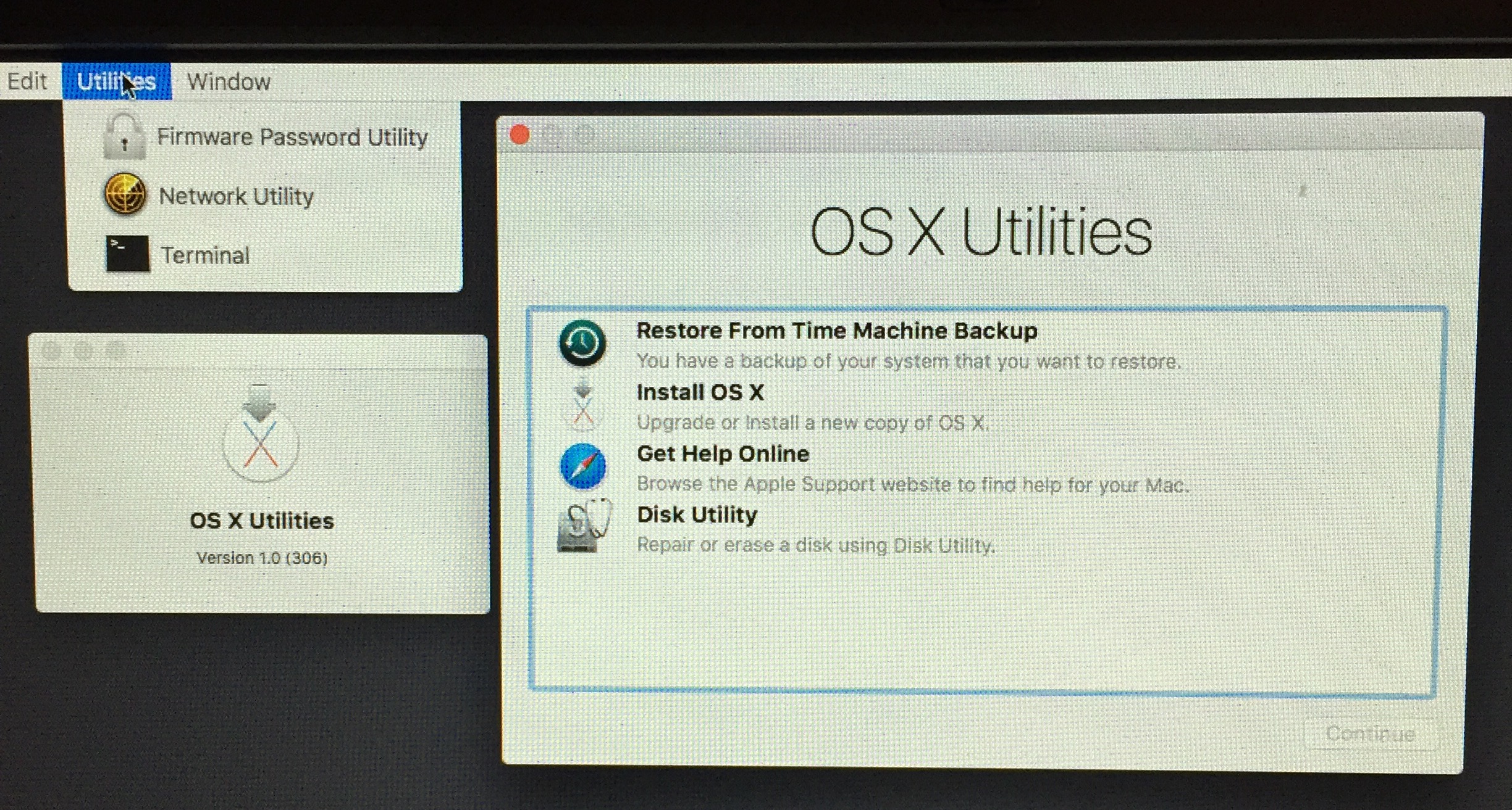

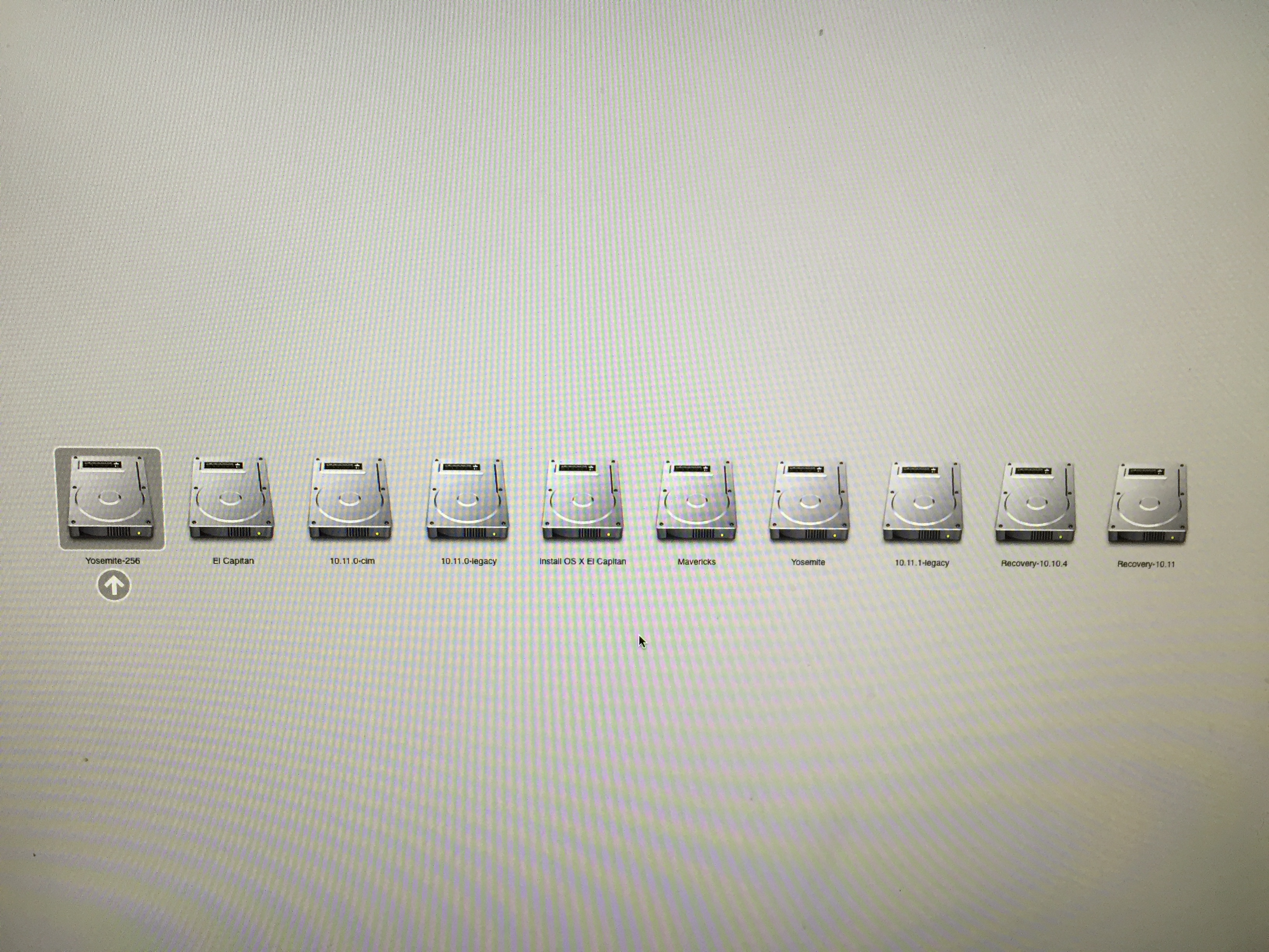

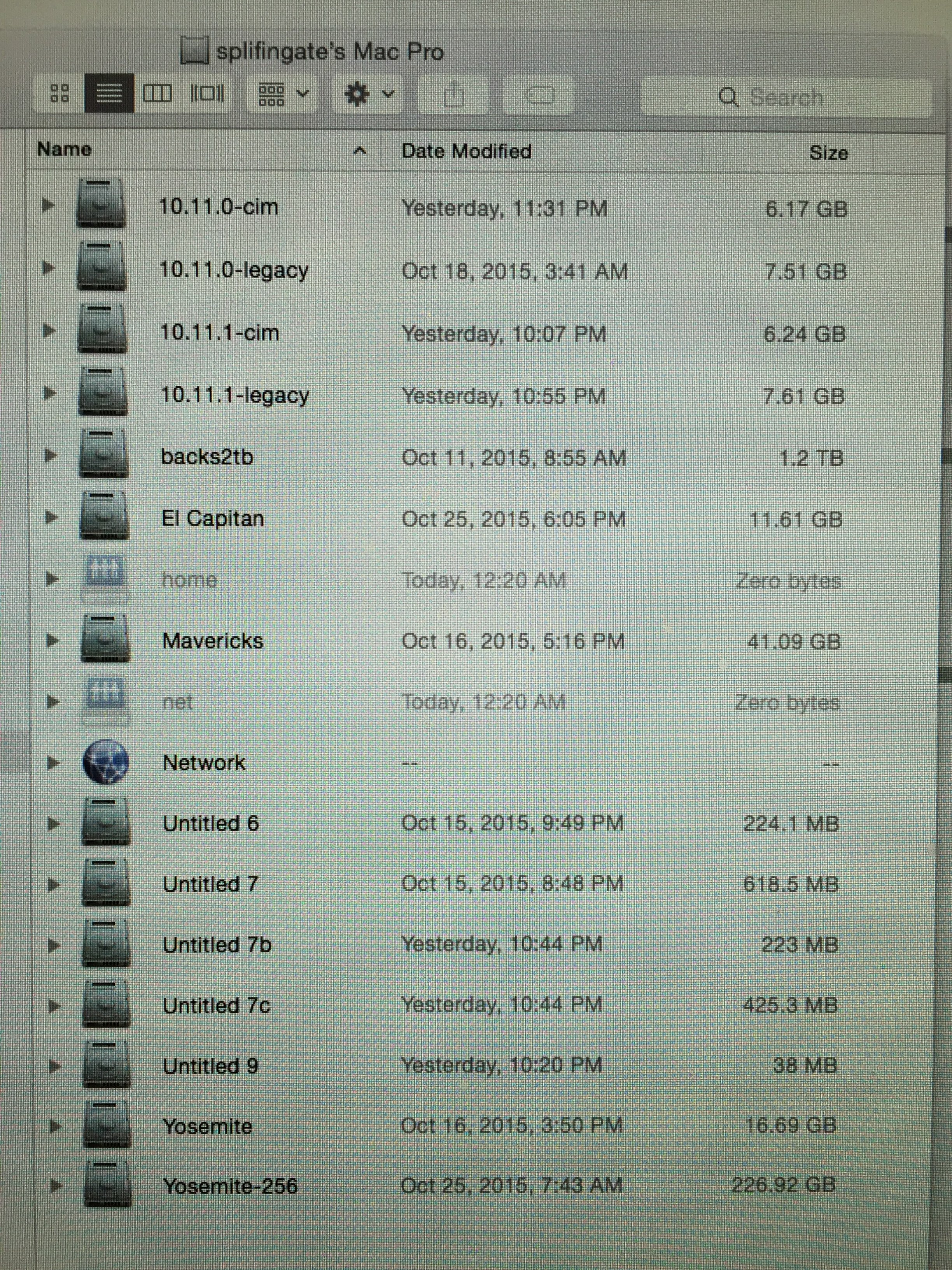

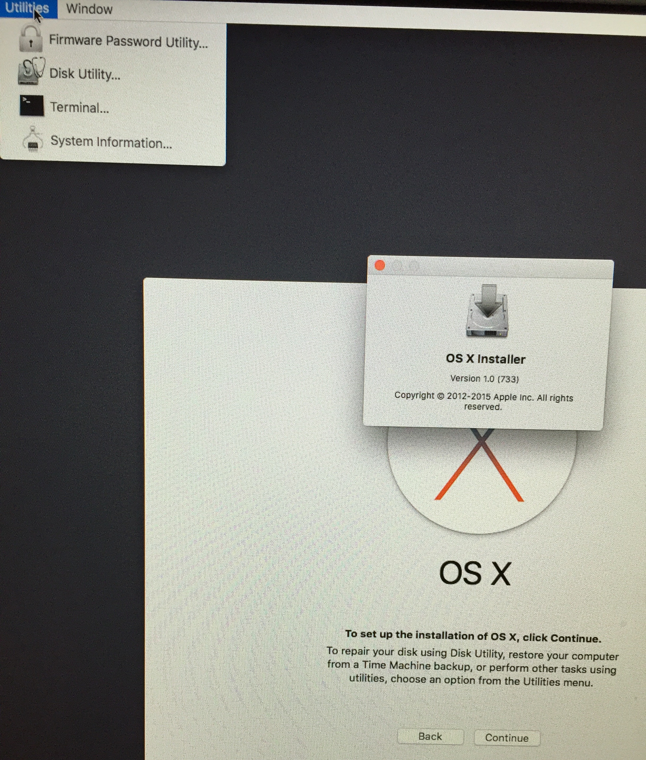

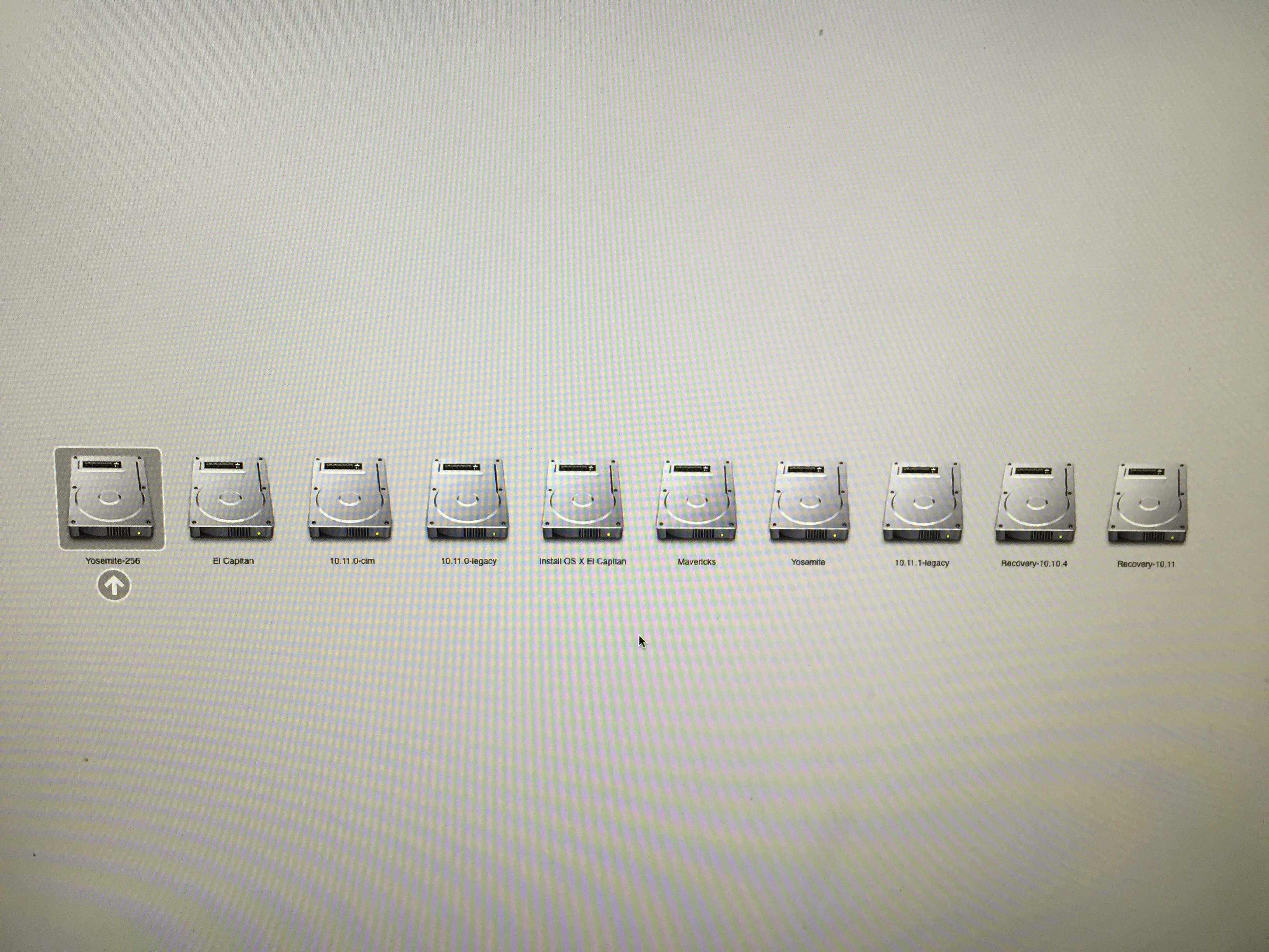

o.k., I created new partitions for the 10.11.1 createinstallmedia, and 10.11.1 legacy (as seen in the first attachment).
In each of every partition, I only replaced the boot.efi's with commit 2961e70e

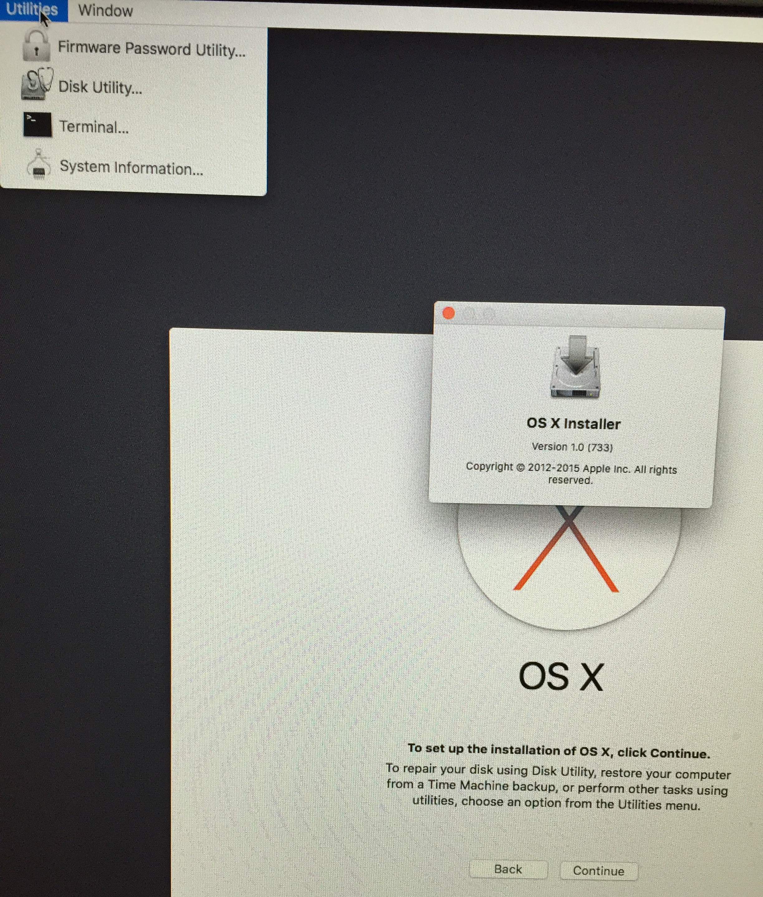

Boot into: 10.11.0 createinstallmedia, 10.11.0 legacy, and 10.11.1 legacy, drives me straight into the installer [Version 1.0 (733)] as seen in the second attachment. "System Information..." is present in menu > Utilities

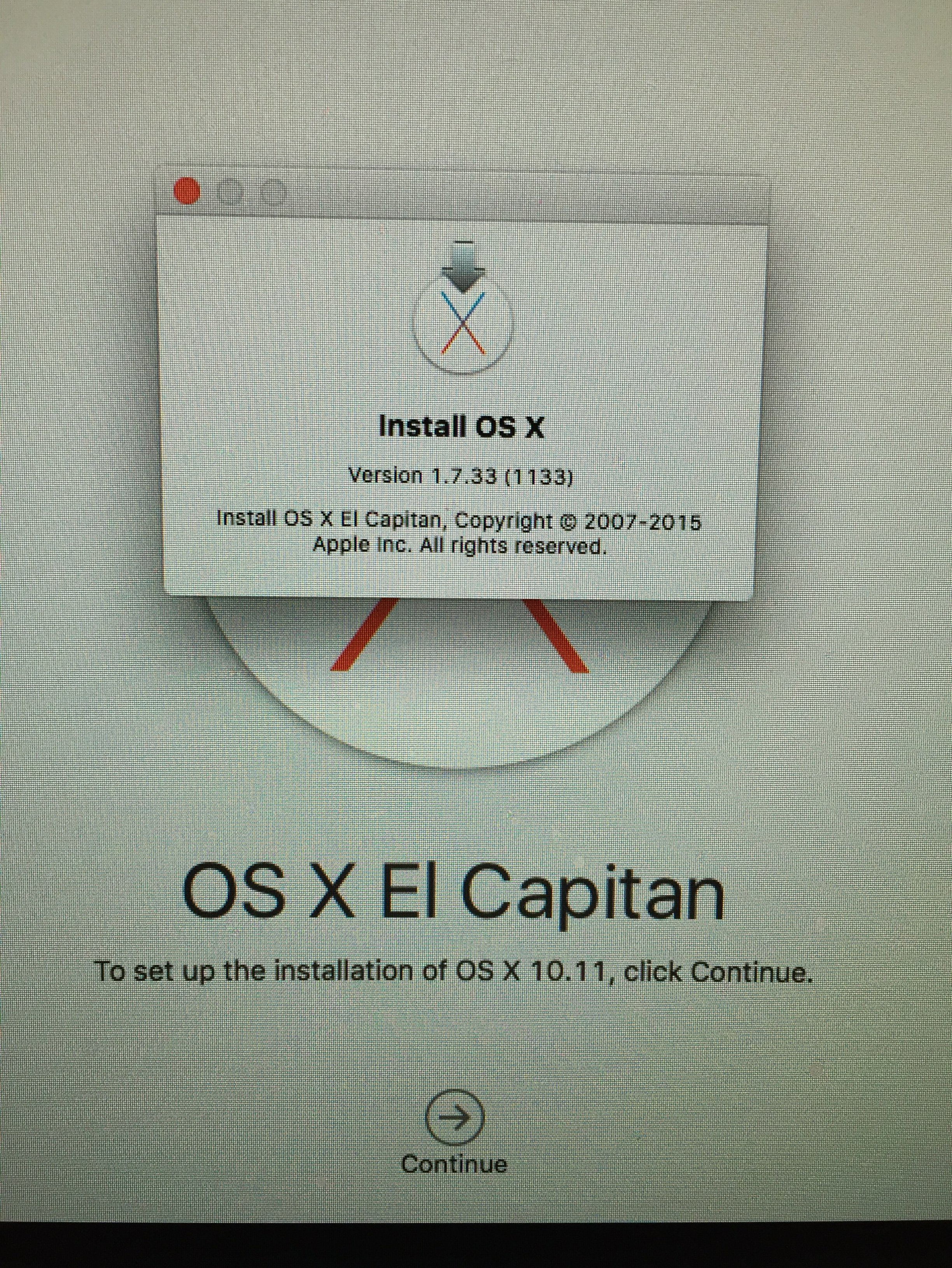

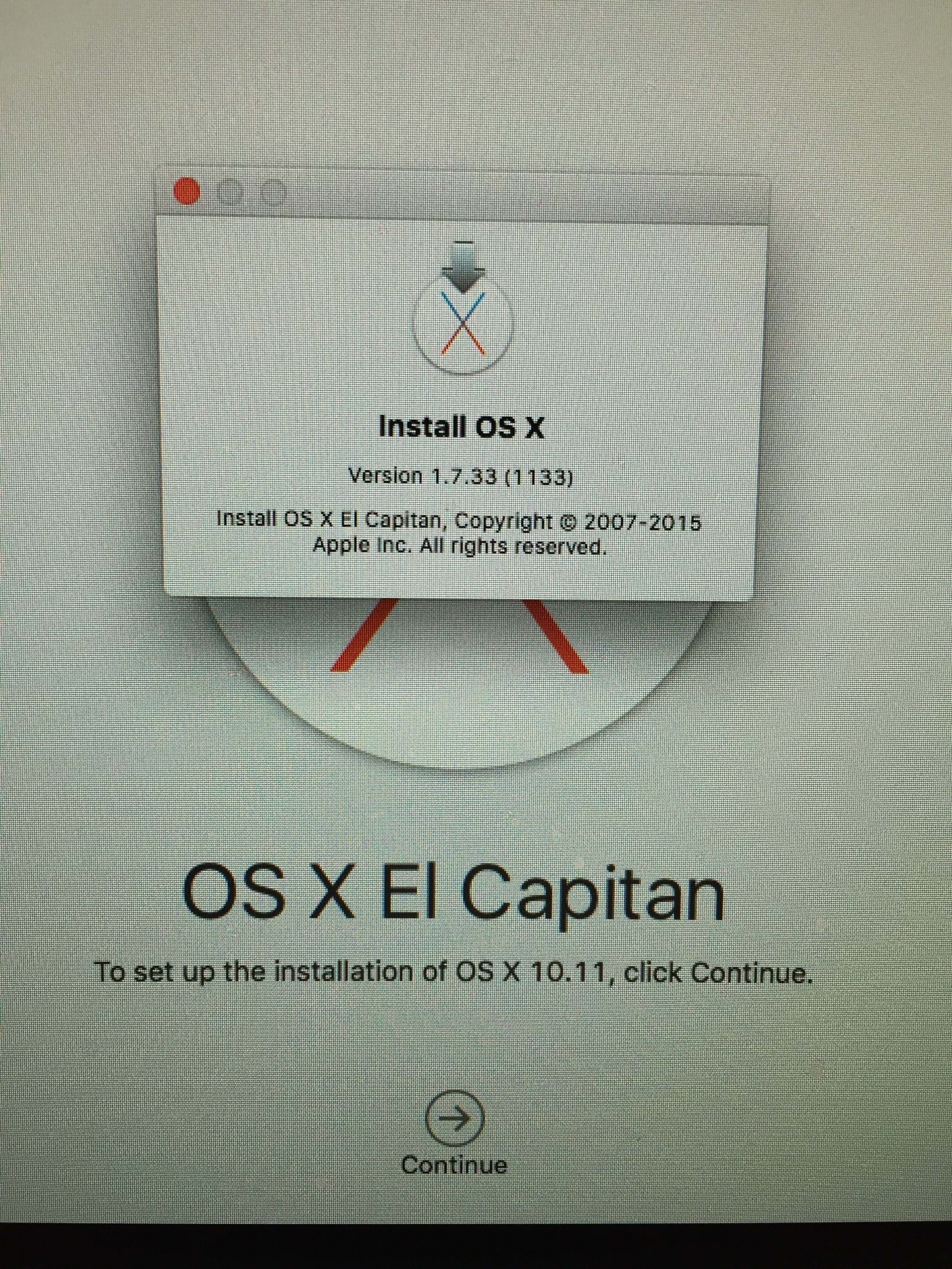

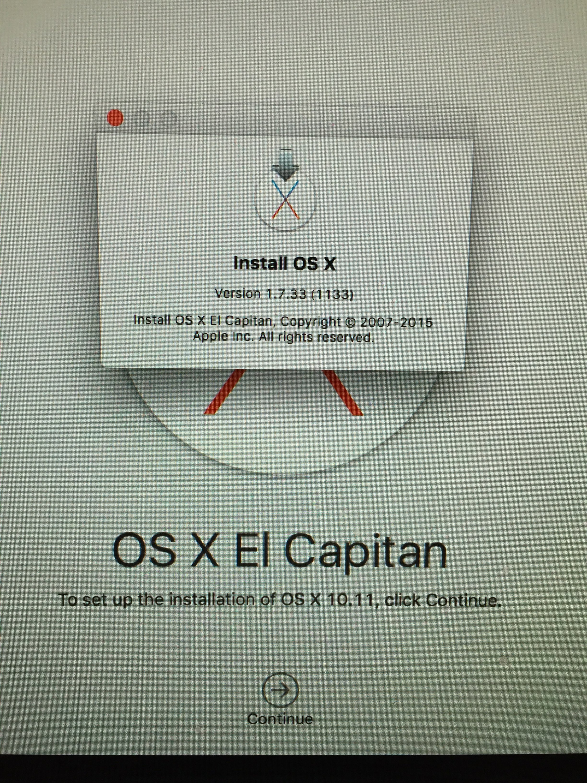

Boot into 10.11.1 createinstallmedia (named '10.11.1-cim', though it is labeled as "Install OS X El Capitan" on Option-boot (see fifth attachment)) takes me to 'OS X Utilities' (Restore, Get Help, Install, Disk Utility) as seen in the third attachment. 'System Information...' is missing...
Selecting "Install OS X" from that, takes me to the installer, as seen in the fourth attachment.
Odd thing is that this installer is newly versioned [Version 1.7.33 (1133)]!
I have successfully re-booted into both the 10.11.0 and 10.11.1 createinstallmedia environments (using commit 2961e70e) multiple times with no corruption to either 'Install OS X El Capitan.app'.
That being said, I must admit to not having performed an installation from either.
Successful boot into working (daily-driver) Yosemite installation using commit 2961e70e is resounding, as is the same for El Capitan (which I updated internally to 10.11.1).
Just a few things for all'y'all to chew-on in the interim...this 'ol body needs some rest....
