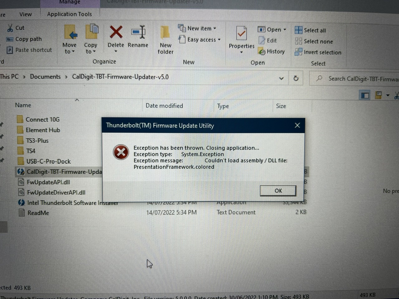

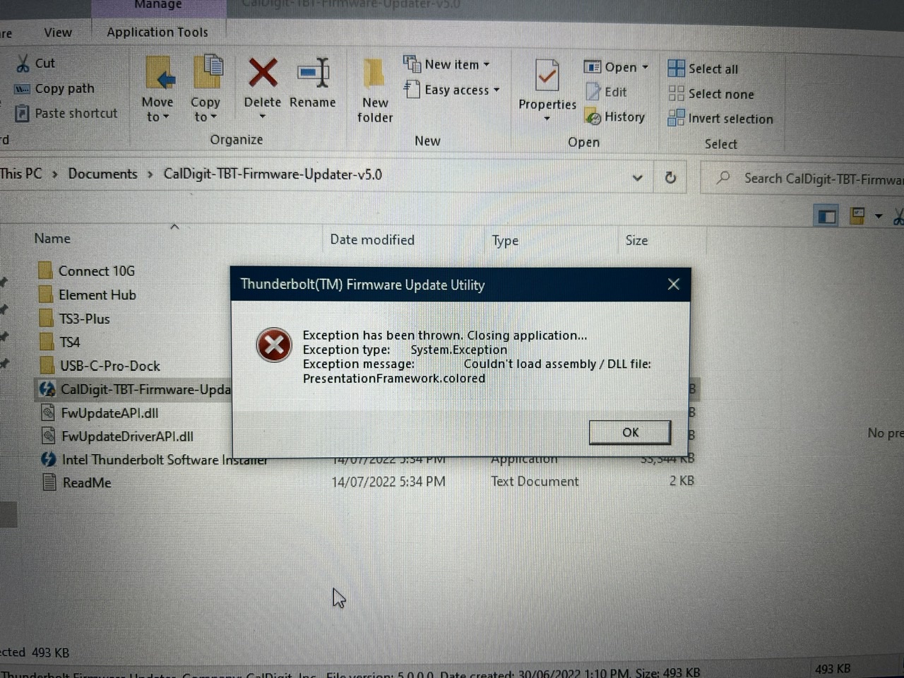

Has anyone successfully updated the firmware on their dock? It’s unbelievable Caldigit don’t have a macOS firmware update tool, and I can’t for the life of me get the Windows tool to work either. This is the error I’m getting.
You may need to install the .net framework to make that error go away. The update ran fine for me on a 2019 16" MBP running Win 10 in Boot Camp.
That was my thought as well, and I did try that to no avail.
I might have another look around though since Microsoft’s .NET frameworks are a total mess.
