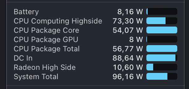

Hi, I recently bought the TS4 to use with my macbook pro 16" 2019, I went for that one as it was the only one that gave 98W of charge, but when I have been using the mac under load I have seen that it never exceeds 88.64W of charge, I wanted to know if it has happened to you or my model is faulty. Thanks

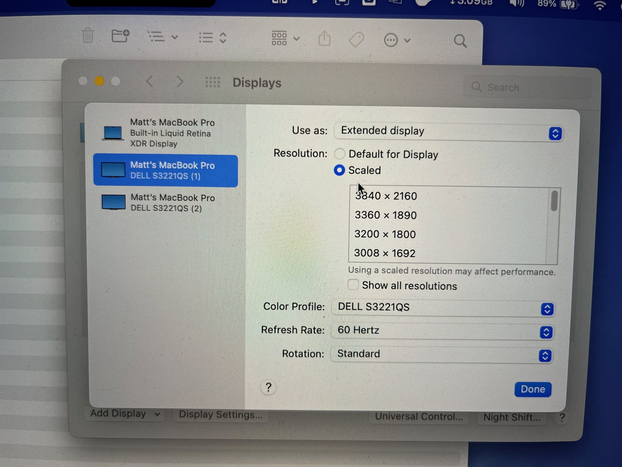

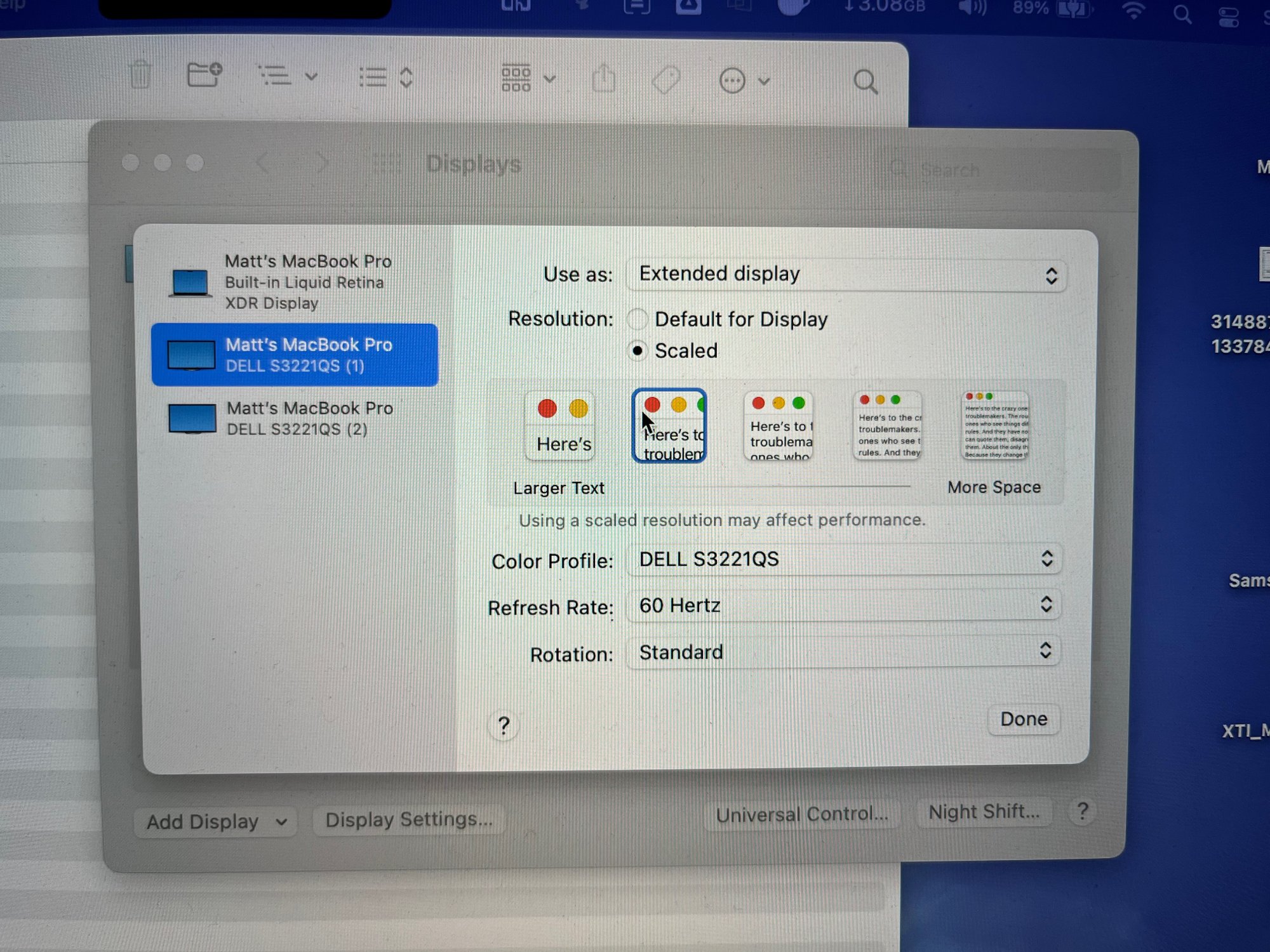

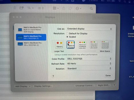

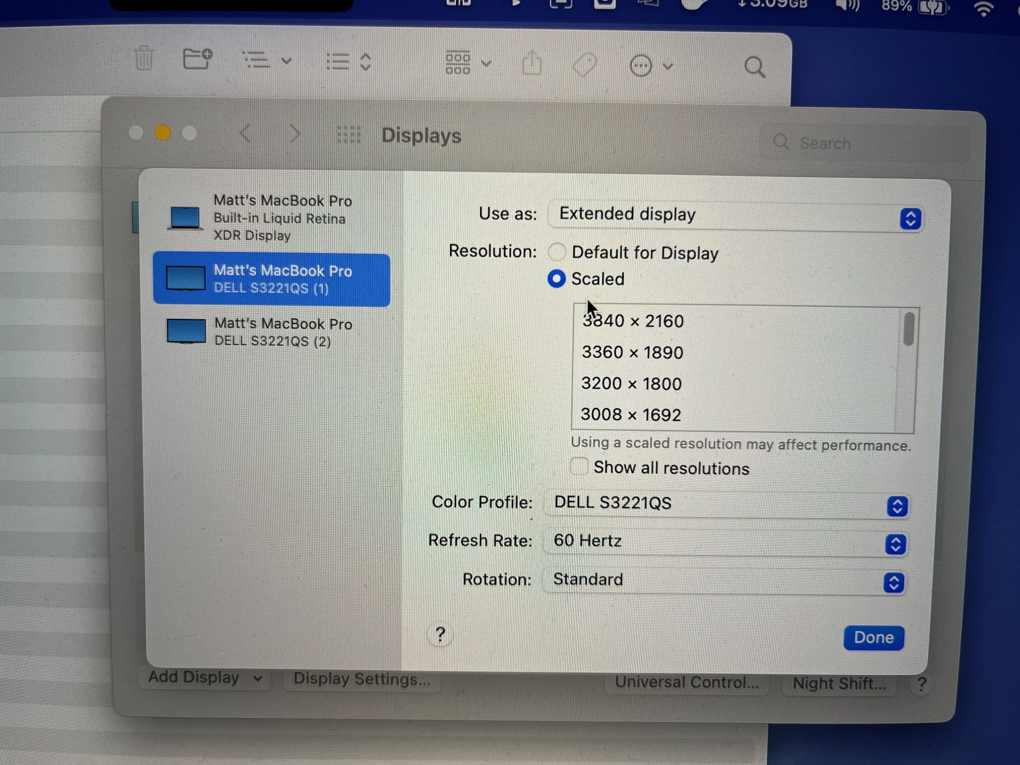

I just bought the TS4 and connected to my MBP M1 Max. I figured I could use the DP connection and one TB4 port for two Dell 32" 4K monitors at 60Hz. I wanted to keep the 2nd Tb4 port available for an NVMe SSD. After trial and error with a variety of different cables and adapters, I was finally able to get them both to work at 4K@60Hz, but with one weird issue. I am not able to get Apple's Retina (I think it's called) Thumbnail Scaling feature in the display properties to work properly. The monitor connected to the DP connector on the TS4 will only display the traditional long pick list of available scaling options and resolutions. Holding down the Option key and clicking the "Scaled" radio button doesn't help. Anyone else see this issue?

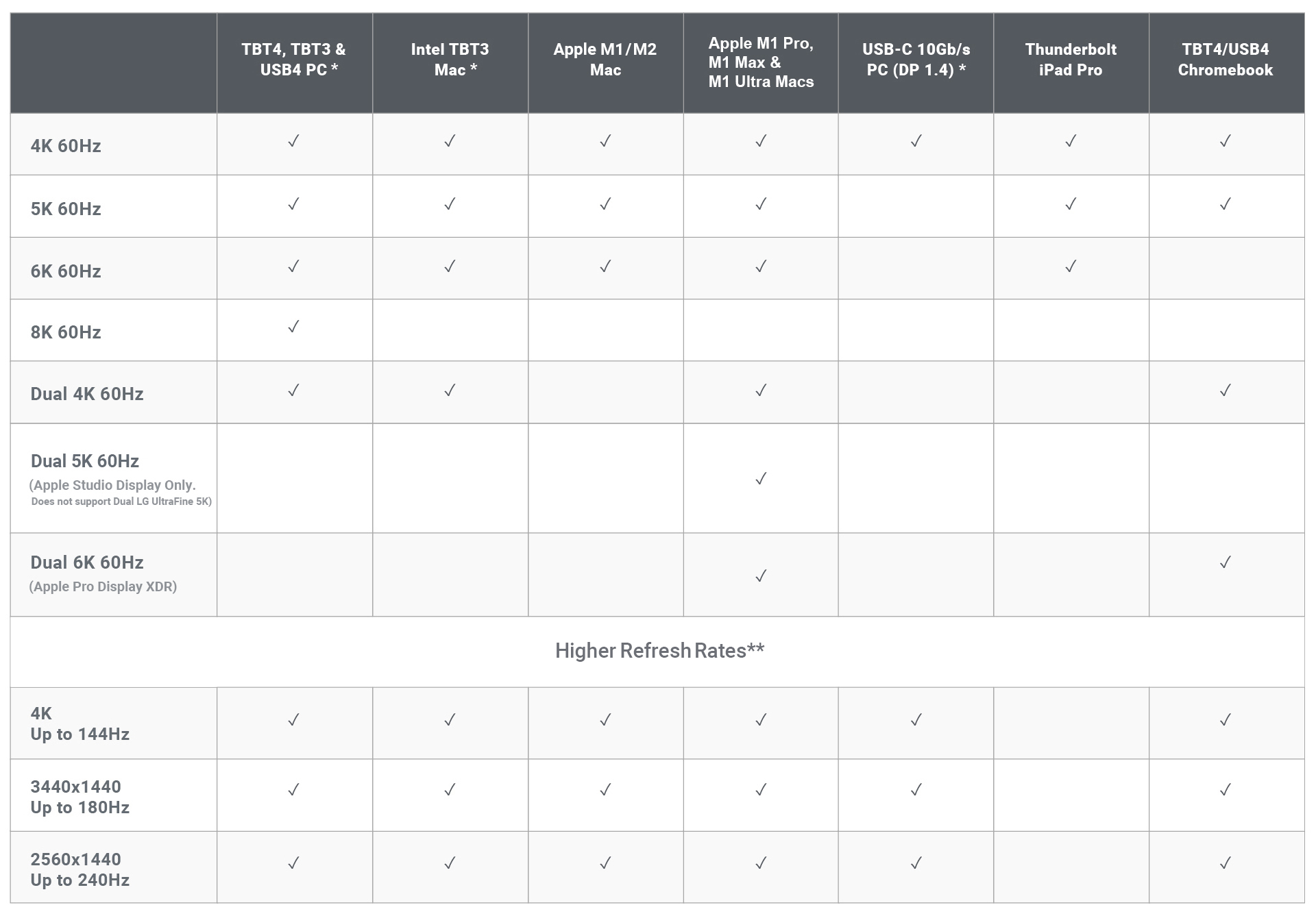

There is no option like 4K + 5K via dock!
4K + 4K
5K Studio + 5K Studio
6k XDR + 6K XDR
They didn't mention 1080p and 1440p. Does that mean the dock doesn't supports 1080p + 1440p?
I think they didn't mention 4K + 5K because they didn't want to make a huge chart with every possible combination and type of display.
That chart doesn't make sense - it doesn't explain why some of the options are not supported.
Why can't a PC support dual 5K or 6K if the Thunderbolt controller supports two displays and the GPU supports DSC?
Same for Intel Macs?
What about 8K for Intel Macs? Is it because no 8K60 DisplayPort displays existed when they made that chart? We know Macs don't do HDMI 2.1 or support DisplayPort to HDMI 2.1 adapters at full bandwidth but they can do 8K60 using 4:2:0.
What about USB-C for PCs? A USB-C connection should allow up to 8K60 with DSC but only if there's 4 lanes of DisplayPort. The TS4 dock connects with only 2 lanes of DisplayPort when connected as USB-C but that's still enough for 5K60 with DSC but you may need a MST hub to convert two lanes of HBR3 to four lanes of HBR2 as required by the Apple Studio Display.
I can't figure out why the chrome book can support dual 6K60 with the dock but not single 6K60 or dual 5K60.
