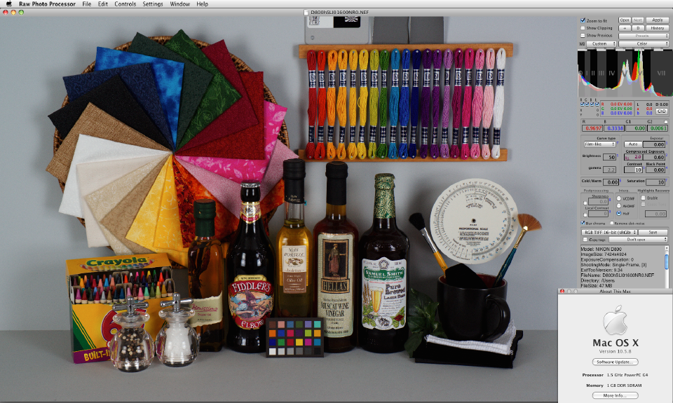

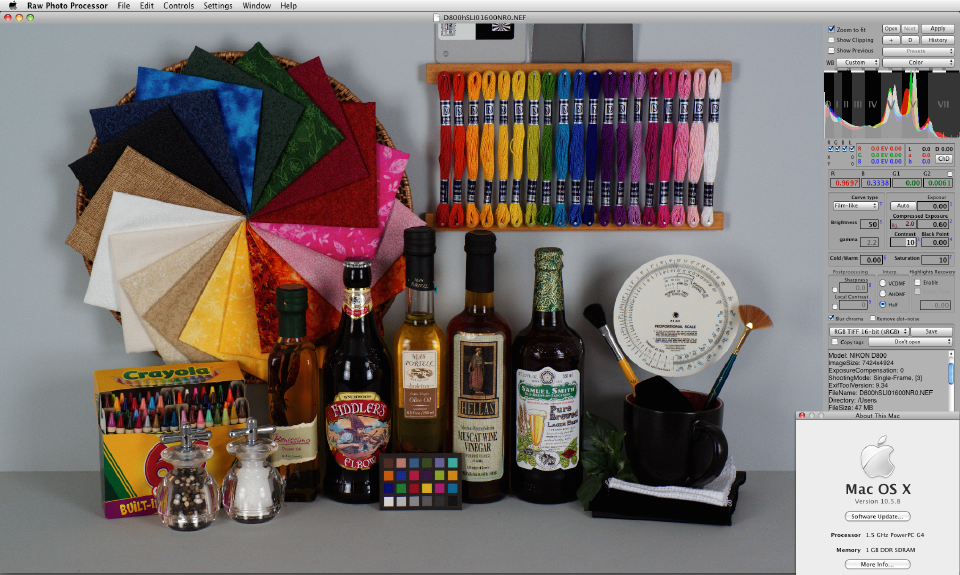

Just for the kicks, I took D800's 49.5 MB RAW file and tried to convert it to 16 bit TIFF (sRGB) with the help of RPP converter that I mentioned before, using my highly tuned Mac Mini G4 1.5 GHz. (SSD drive, lots of unloaded components/services etc.)
* Opening the RAW file alone took 1 min. 06 seconds!
* I've spent around 5 minutes trying to figure out the optimum settings for just this one shot. Still not being happy, I gave up after about 5 minutes. Long wait times were getting on my nerves.
* Saving 16 bit TIFF file using highest quality interpolation algorithm took another 5 min. 20 sec.
Ouch! I wouldn't call this a productive workflow. ;)

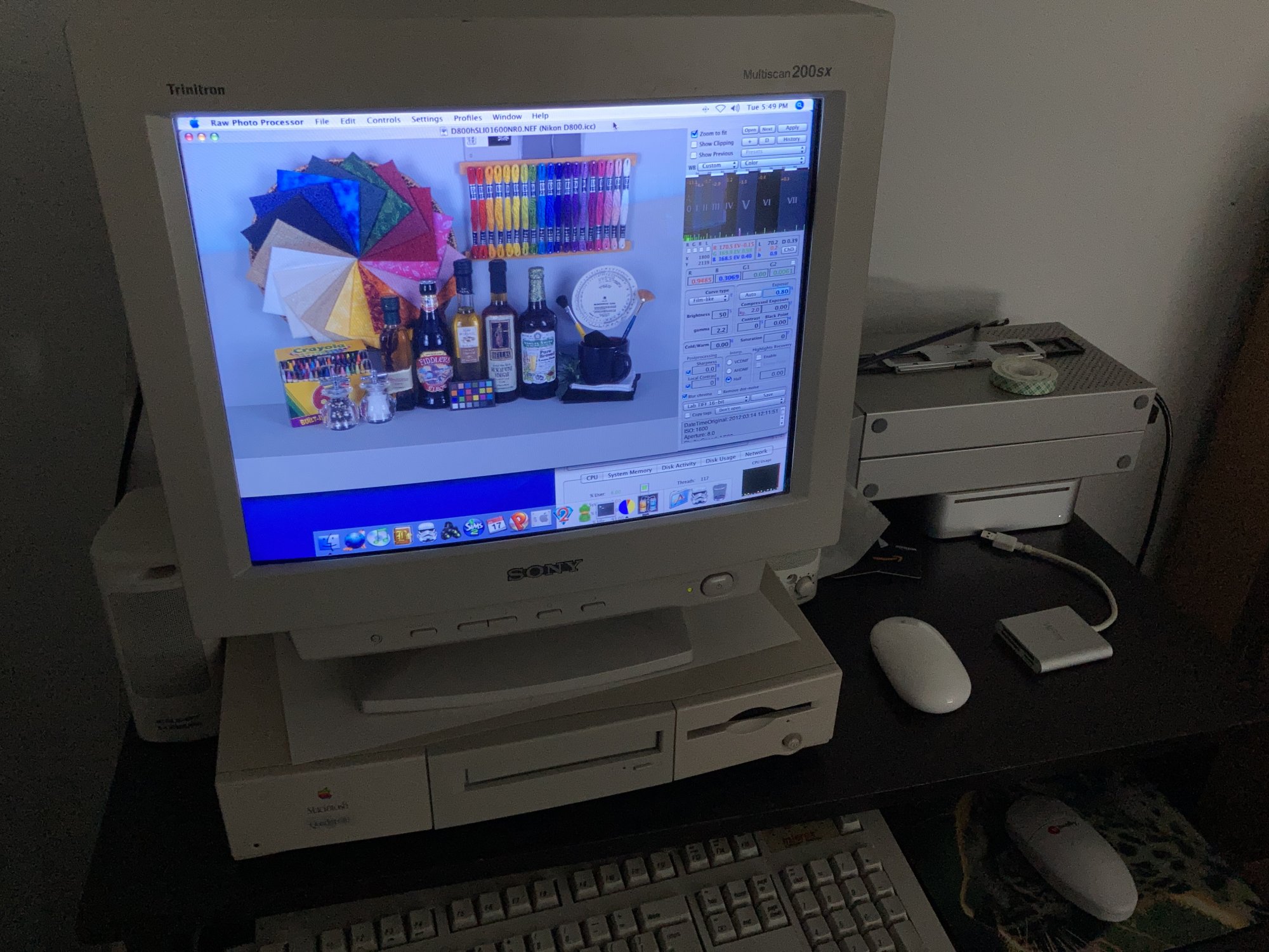

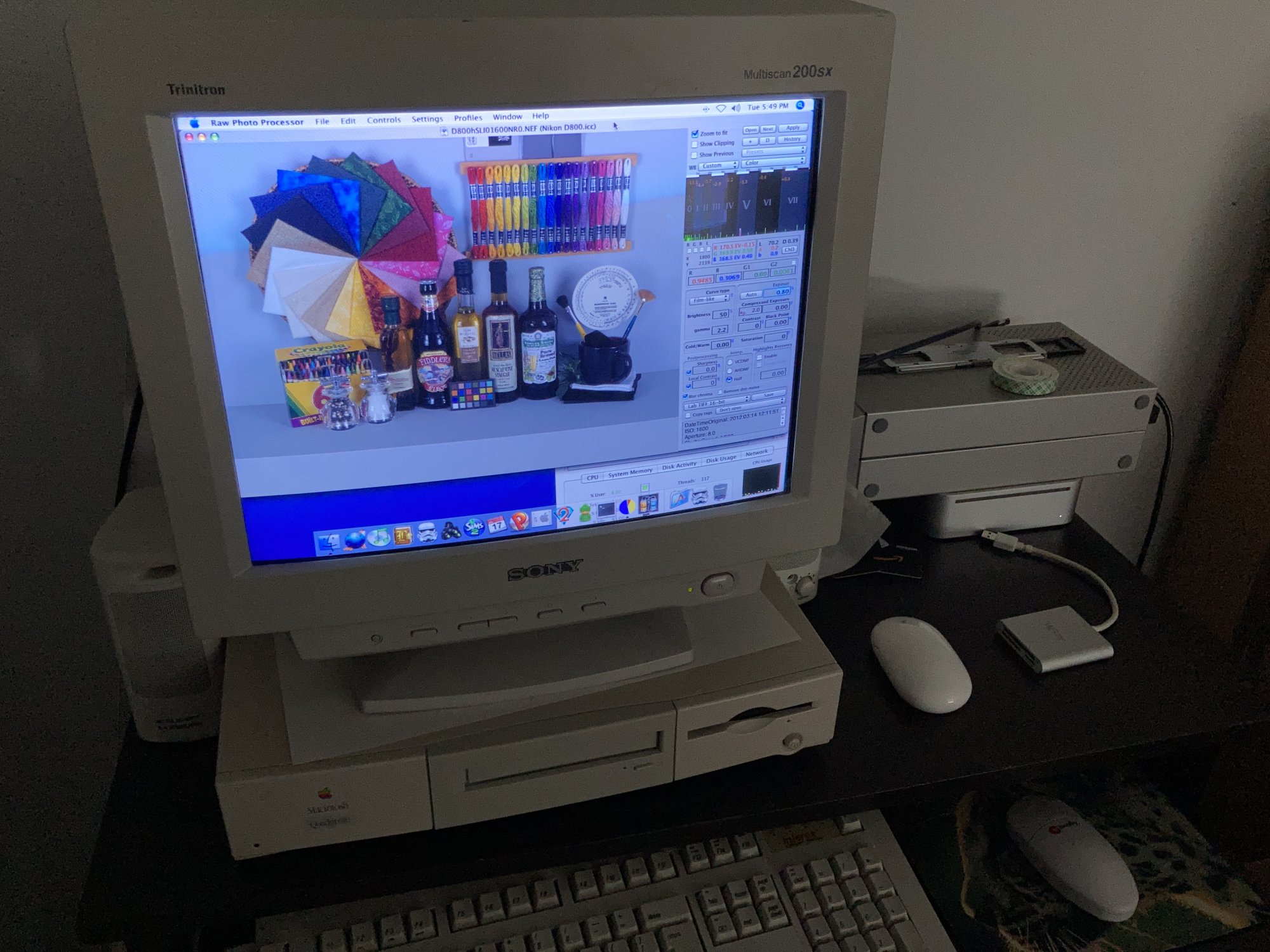

IDK what anybody is complaining about. I think my G4 mini is my new photo workstation with all the tips I’ve gotten here.
Ok, I’ve been using the mini and trinitron for scanning film, light Photoshop edits and preparing some images for print. It actually works fine if you consider the context of what was normal for that time. I certainly didn’t have a 20+ megapixel camera in 2006.
I pulled a .CR2 from my Canon Rebel. It’s about 12.2mpx.
It took 24 seconds to open in RPP. Adjustments took maybe 14 seconds. Converting to 16bit RAW TIFF takes just less than 2-minutes.
The .NEF brought the system to a damn near halt. 1GB just isn’t enough anymore. Soon we are going to have to start adopting systems that could conceivably reach the 32-bit ceiling of 4GB. RPP was using 680+MB on its own just to open that one image.
I did the Camera Profiling with the Macbeth card in the picture and had absolutely no trouble. Very straightforward process for Russian kludge machinery.
Actually, you've "profiled" that one particular scene, not the camera. Profiling camera takes more than underexposed ColorChecker 24 in unevenly lit scene ..

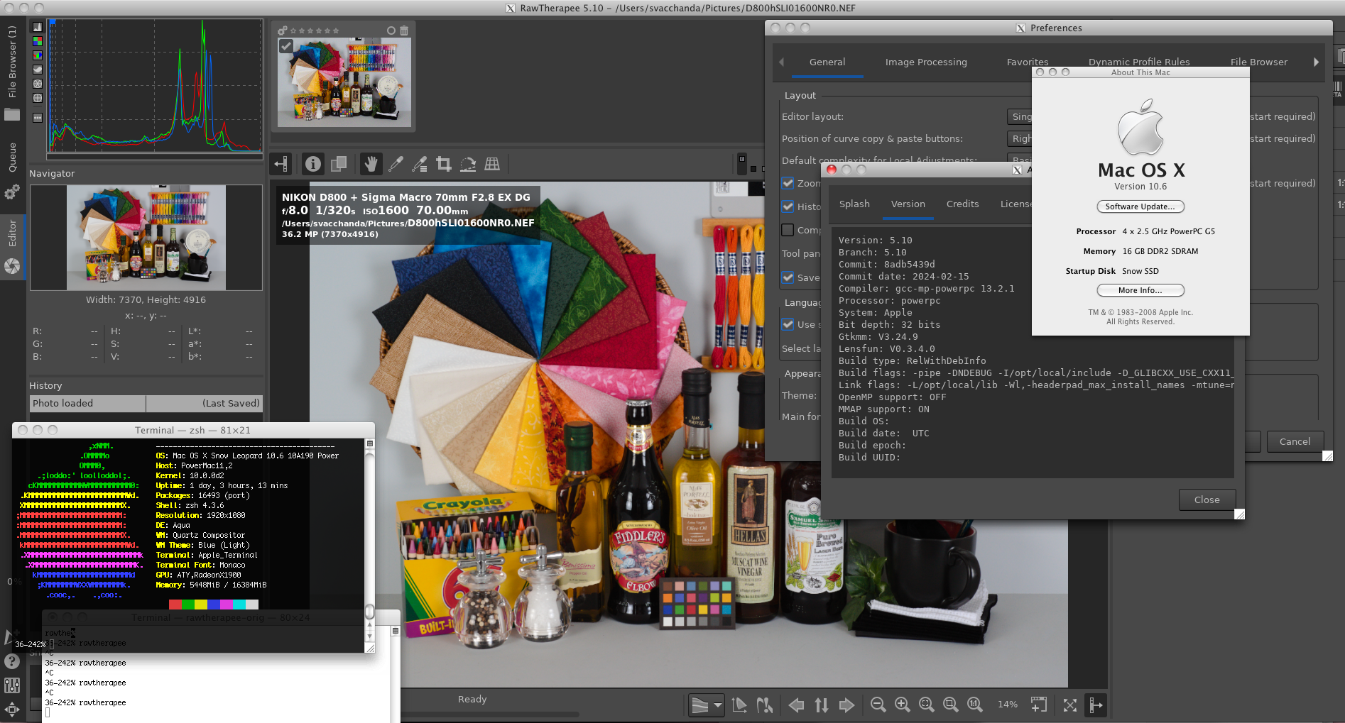

It’s not something “I say”, I have recompiled it a dozen of times trying to debug the gui, but here you go, you can try yourself:
So, you did it? Congratulations! Looks nice.
Is it PPC only or UB? Have a compiled one for the mortals?
* I was interested in it because it has (had?) chromatic abberation correction in floating point.
Since gcc does not currently support universal builds, it will be non-trivial, considering a number of dependencies. If by universal you mean ppc+ppc64, then here there is also an issue with ppc64 part (it just won’t work by default, and fixing it seems to require quite some work); if you mean ppc+i386, then cross-family builds are likely to be even harder and perhaps completely untested.
So I would say this is not even planned. (It is perhaps also not worth the pain for a user: why would one need to run the same binary on different cpus as opposed to just building natively on either?)
I wanna get 5.10 working, so that we do not need to have two versions for different archs. Once that is done, it will likely get merged into Macports.
If anyone would want a binary for 10.6 ppc, I can share that (as usual, with use-at-your-own-risk clause). My 10.5 setup is broken since I nuked libgcc when trying to get ppc64 sorted in a reproducible way – and well, I cannot reproduce what I had ever since LOL. (To be clear, ppc on 10.5 is trivial, but I see no point in that, I prefer 10.6; ppc64 would be great, but that is not so trivial.)
