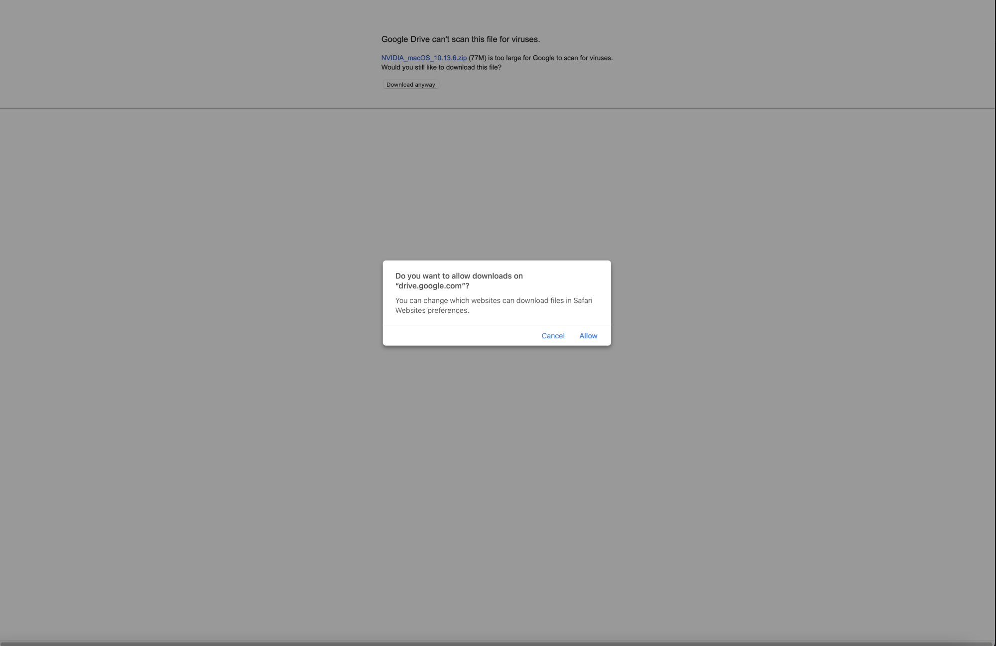

Hi FullerFun,
The URL to your the Google drive with the GPU & CUDA Driver combo zip file that you uploaded is not working anymore.
Is it please possible for you to upload it again ? (I actually just need the CUDA Driver that you got because NVIVIDA still hasnt updated this CUDA driver on their official website more than 2 years after the issue arose as i get a message saying "the certificate has expired" when I try to install it).
Many Thanks,
Mike
Many Thanks,
Mike
