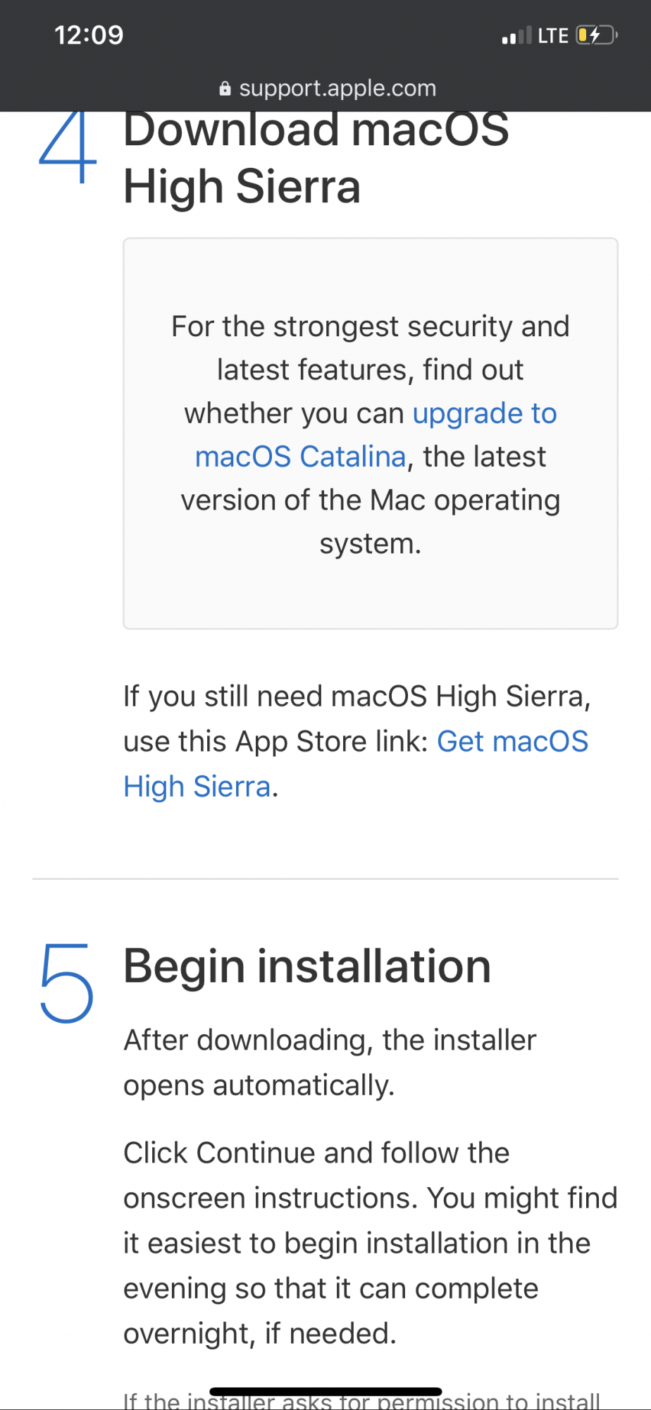

Try downloading the Low Sierra (10.12) installer using this link:
Download macOS Sierra
(I believe this is a "direct link" and will immediately download a .dmg file to your Mac)
Open the disk image and you will see a "pkg" file.
Double click that and see if the installer opens.

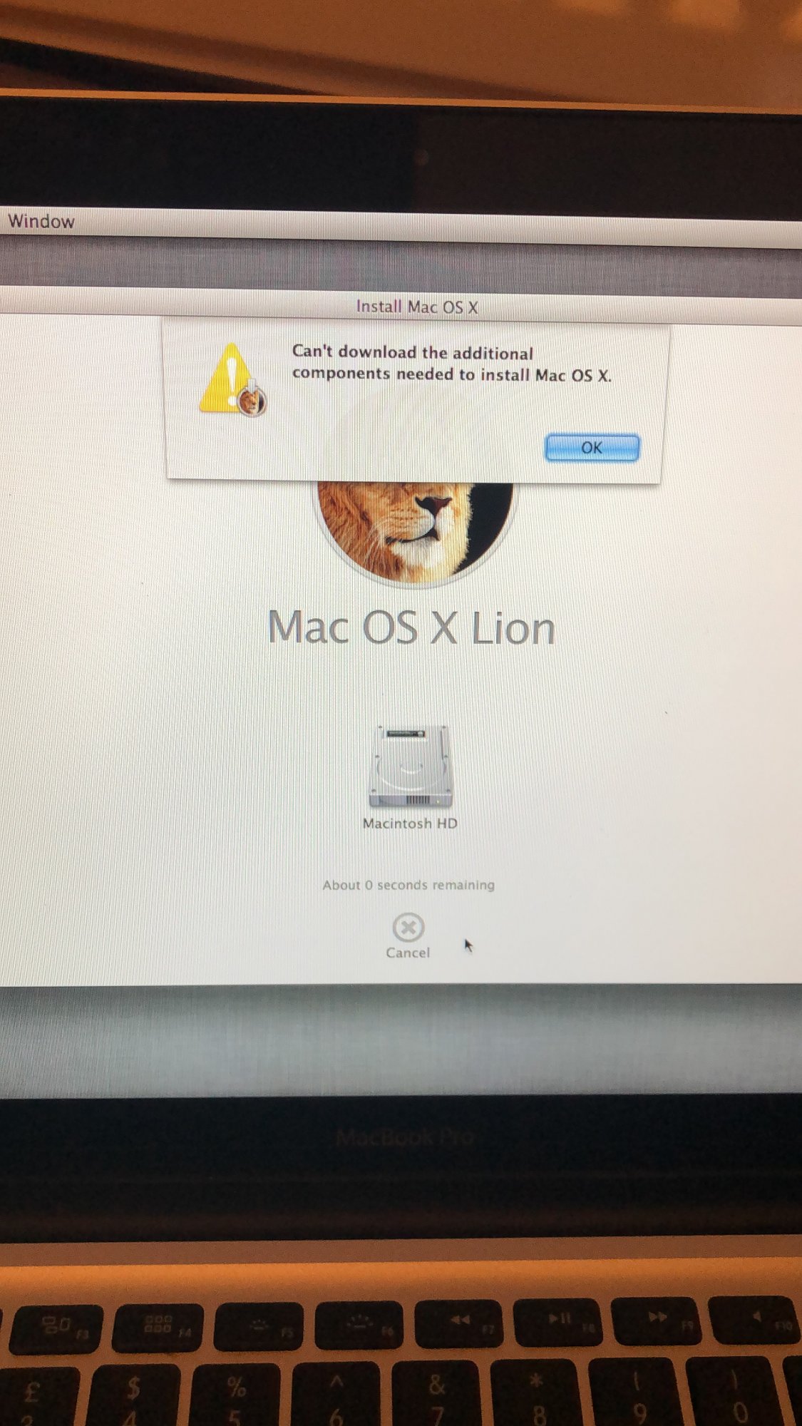

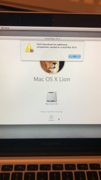

Hey any way i can get a download link? ive tried everything. I bought this macbook pro 2011 from someone who screwed me over.I erased everything and now it gives me the message of addition components etc...
Since this thread isn't from 3 years ago, like most, I thought I'd offer my experience fixing this issue, in case it's helpful to anyone else.
I was attempting to wipe my MacBook Pro from late 2011 clean. I received the "additional components" error message, which lead me to this thread. Recovery start up offered me Lion, which would have been a few steps backwards.

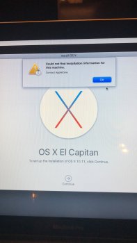

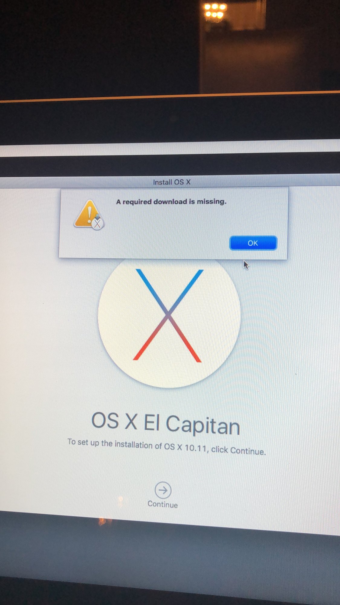

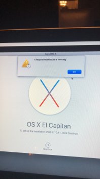

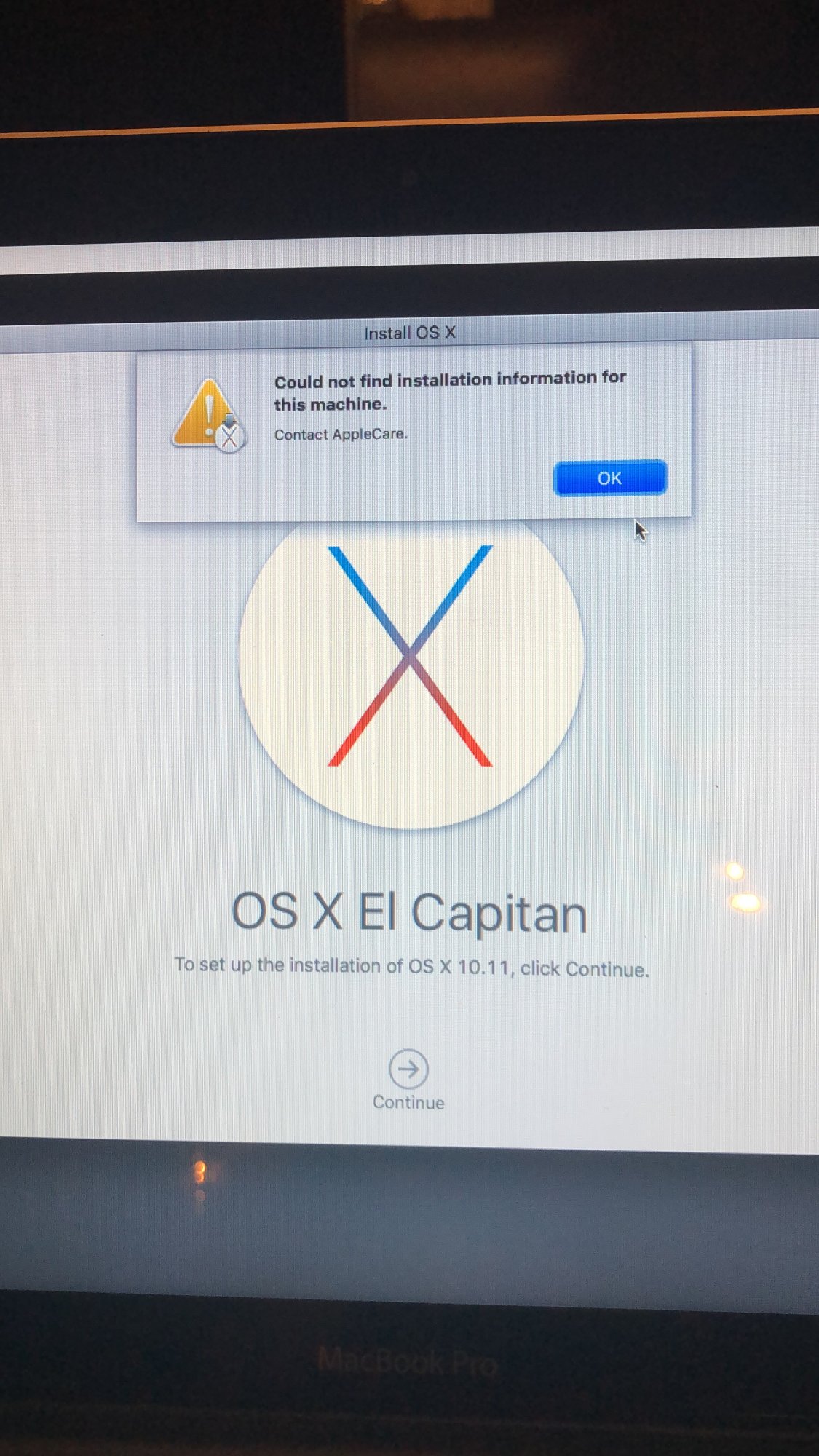

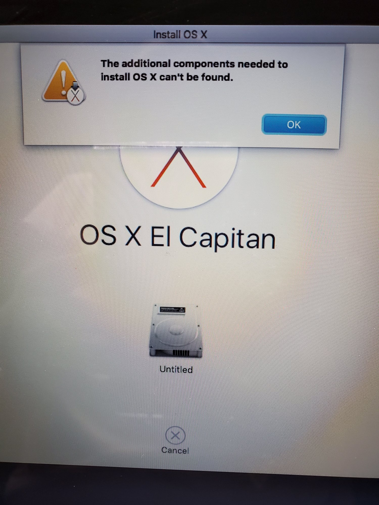

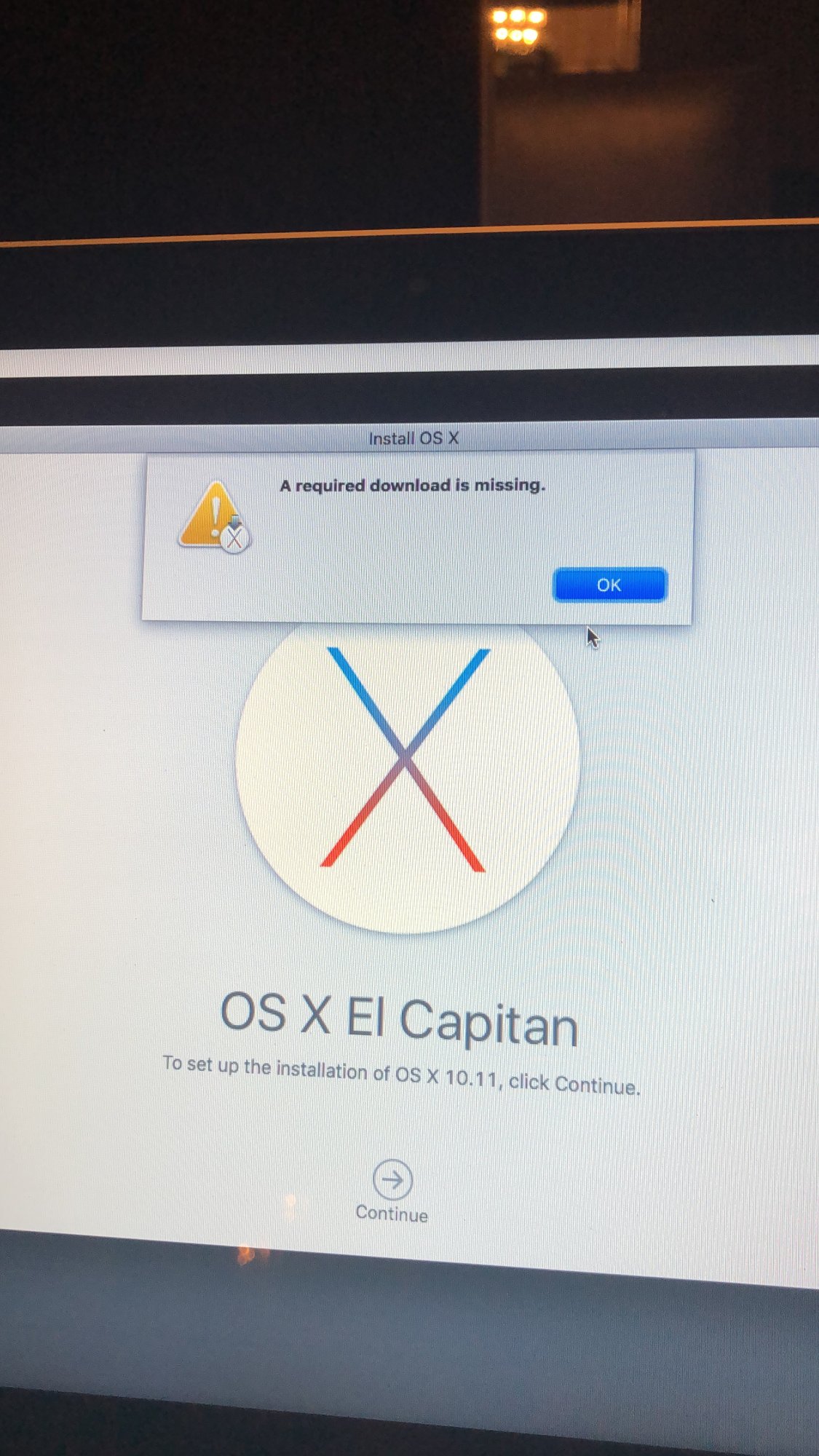

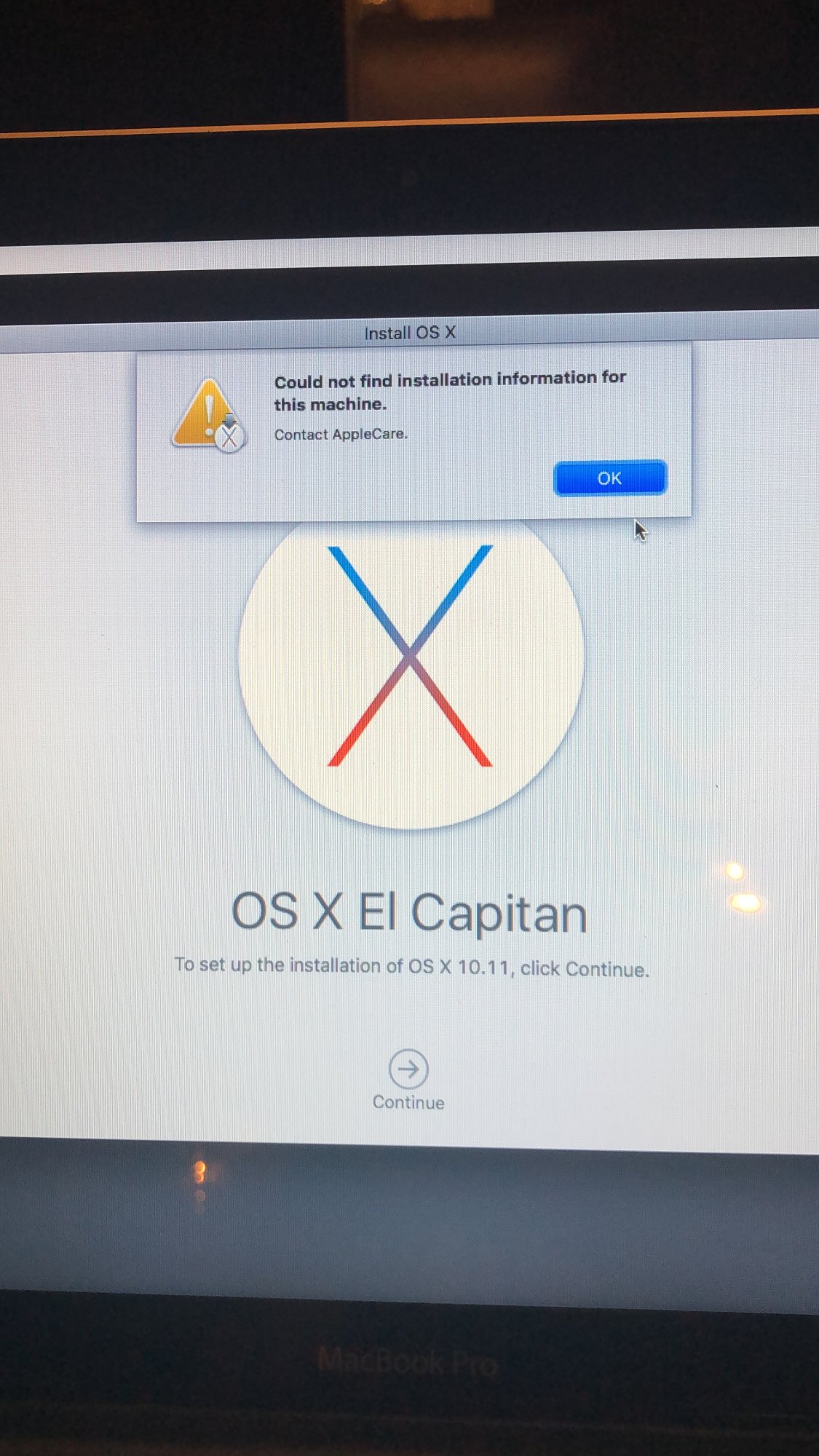

Can someone please help me on this. I’m not very techy, but one would assume wiping a laptop should be straightforward... I’m just got a new MacBook Pro and I’ve sold my late 2011 pro and I’m trying to wipe it for the buyer but keep getting the same error messages above. I have had this one (the title of the thread) as well as “a required download is missing” and “could not find installation information for this machine” - can someone give me a fix please? All I need is to have the laptop in the setup mode as if it was new so I can give to the buyer.
i’ve attached screen shots of the errors.

Same predicament over here. I am getting the Mac OS X Lion for all the options Command (⌘)-R, Option-⌘-R, and Shift-Option-⌘-R ending up with the same error you are receiving. Bootable USB doesn't work either.
