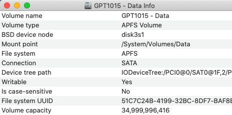

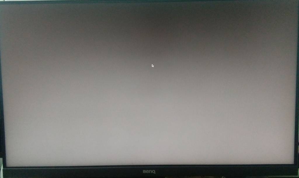

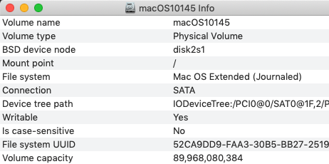

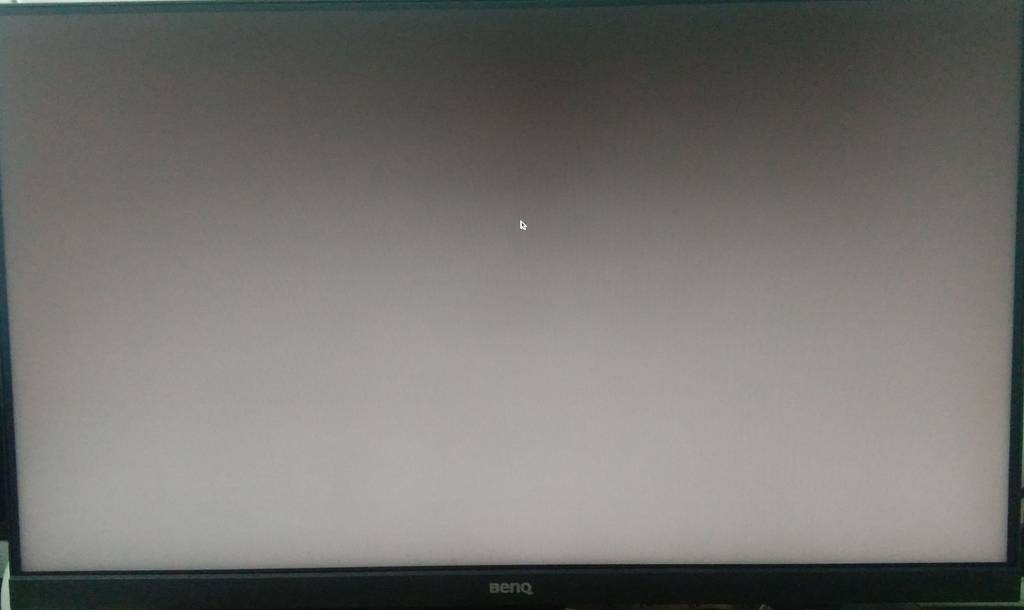

I install it to MBR HFS+, and copy /System/Library/Templates/Data/* to /
It can boot to mouse cursor with gray blackground before first time setup login UI.

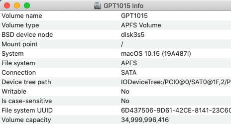

I think it's system partition read-only issue, if we can make it read-write, it may work on HFS+ now.
We need HFS+ System partition to be Writable=Yes.
10.14 HFS+ System, Writable=Yes
10.15 APFS System, Writable=No
10.15 APFS Data, Writable=Yes

Dev. Beta2
10.15 19A487l

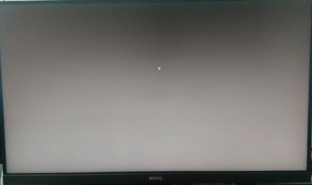

View attachment 843611 View attachment 843612

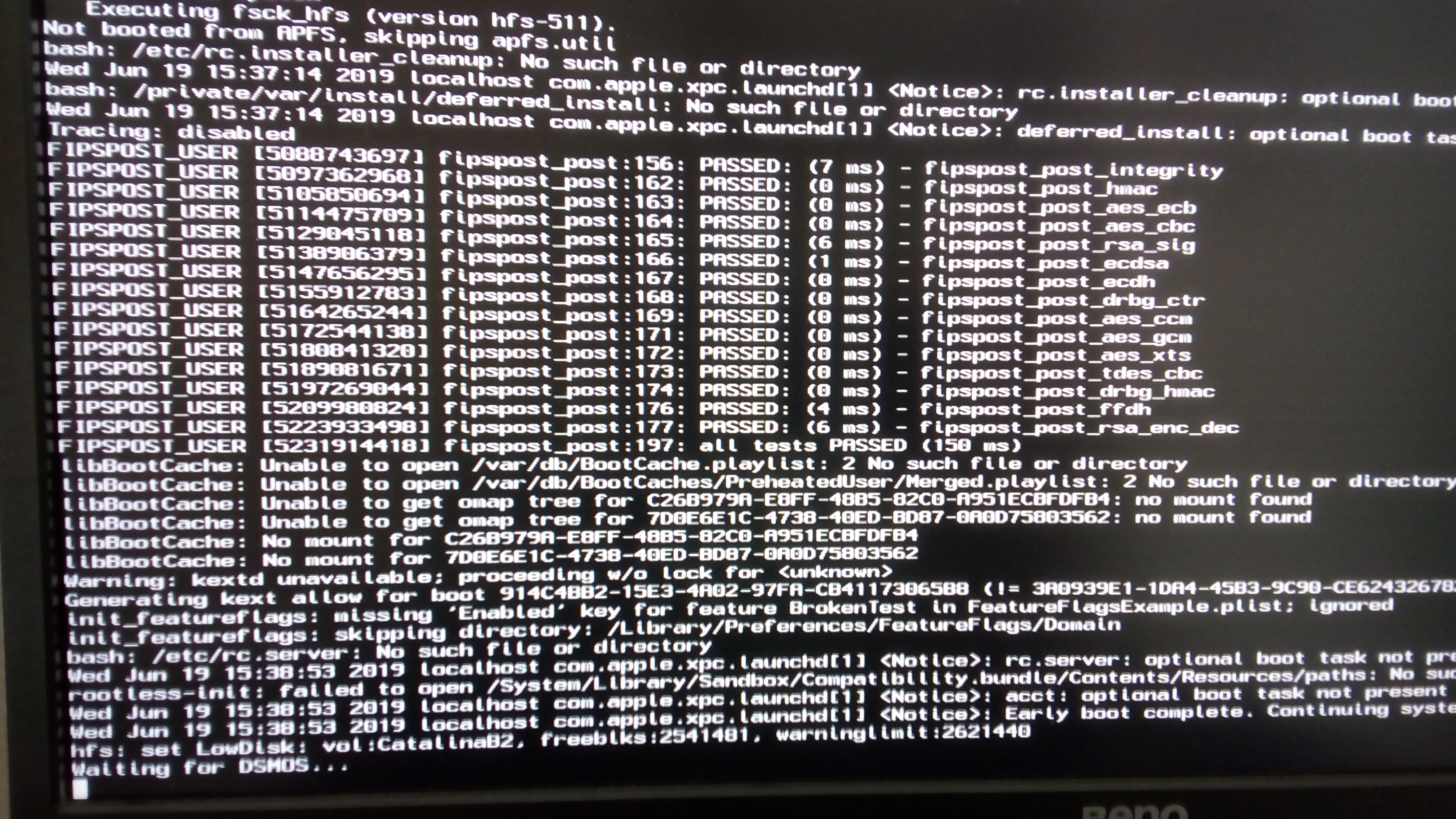

Merging the two APFS container (System and Data) and then cloning to HFS+ i got this
"Waiting for Dmos..." without any KP ....
some little steps foward in booting from HFS+

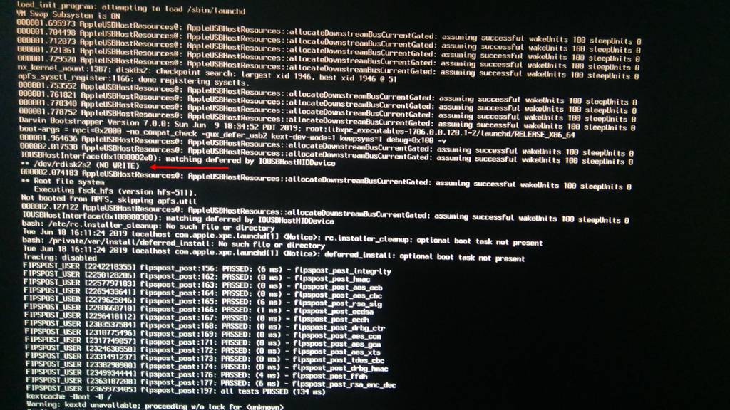

I've tried right now from a supported real Mac an HighSierra 10.13.6 HFS+ official (App Store) updated installation, I have one only installation inside an internal disk with EFI partition on disk0s1, it's totally working in RW and I get exactly from verbose mode (-v) this line at each boot:
** /dev/rdisk0s2 (NO WRITE)
I guess it is a standard verbose line present in any HFS+ OSX installation.
So I'd exclude that is the issue of Catalina HFS+ for not booting.
The kernel mounts / read only, it’s up to launchd to remount it read/write. This is normal behaviour, so don’t let it discourage you!

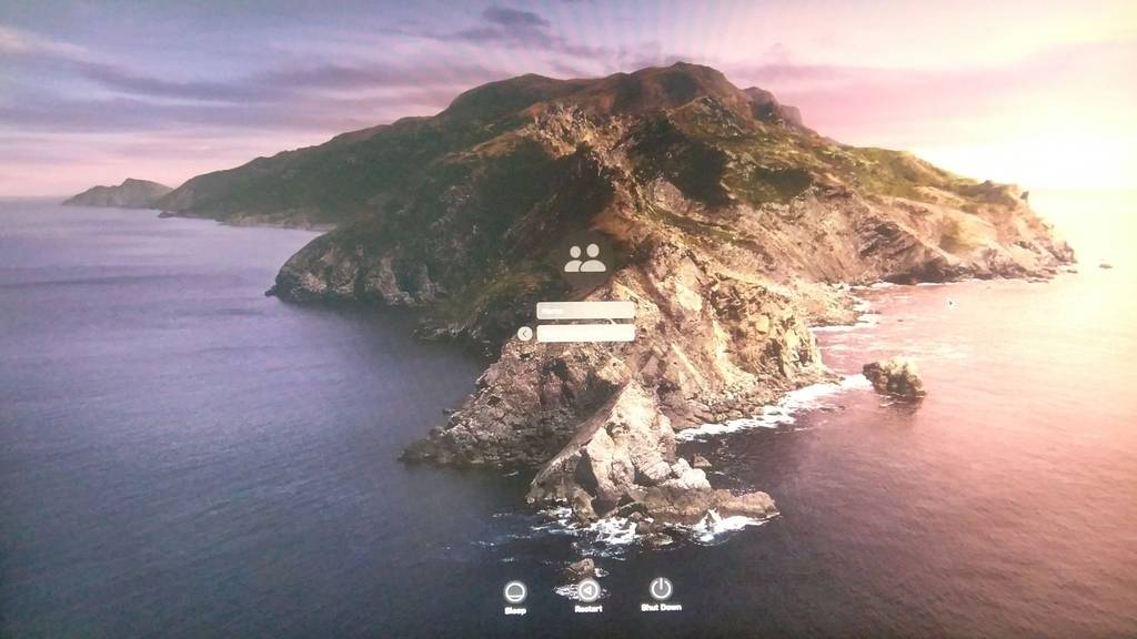

When I upgrade from 10.14.5 to 10.15 db2, I can reach to login screen without any user information on 10.14.5, and can't login to 10.15 db2 as below.
It seems can't connect to user profile on 10.14.5
When I remove /var/db/.AppleSetupDone, I can reach to mouse cursor with gray blackground before /System/Library/CoreServices/Setup Assistant.app start.
So, now my problem is, it won't start the "Setup Assistant.app".:(

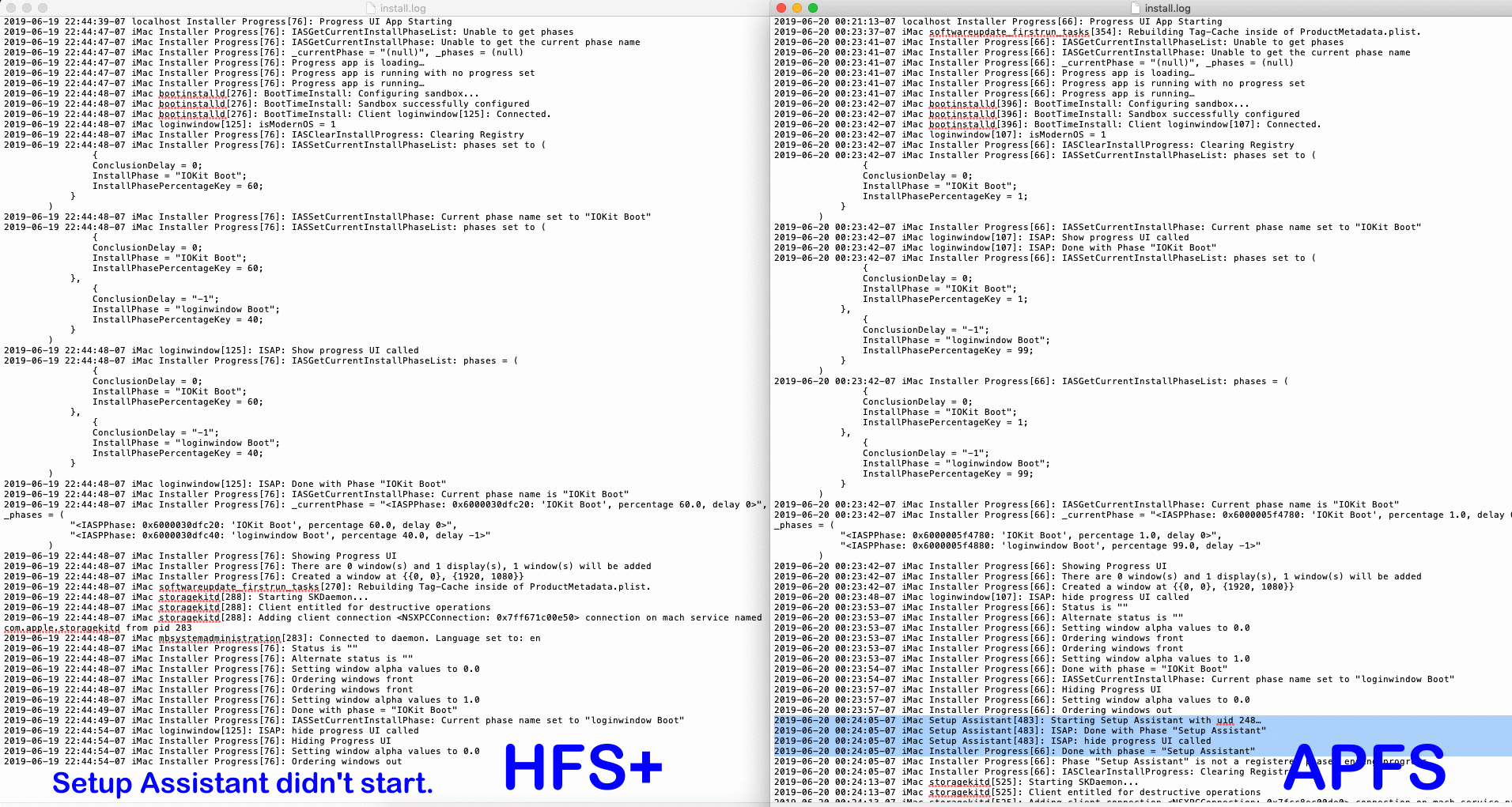

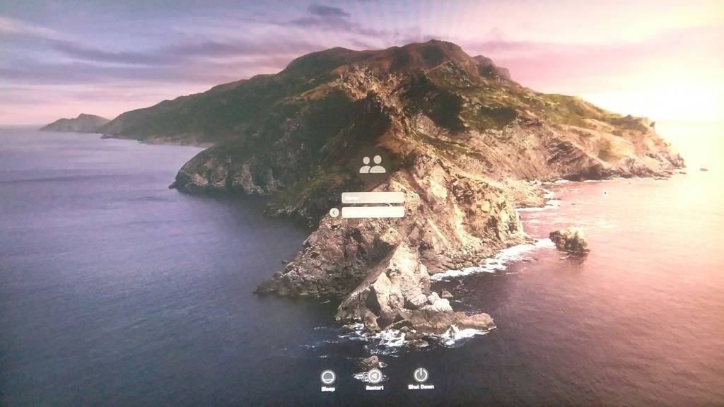

After some more test with HFS+ fresh installation and APFS fresh installation.
At the first booting.(the install.log shows.)
APFS two partitions, will start Setup Assistant.
HFS+ one partition, won't start Setup Assistant.
Reactions: jackluke
