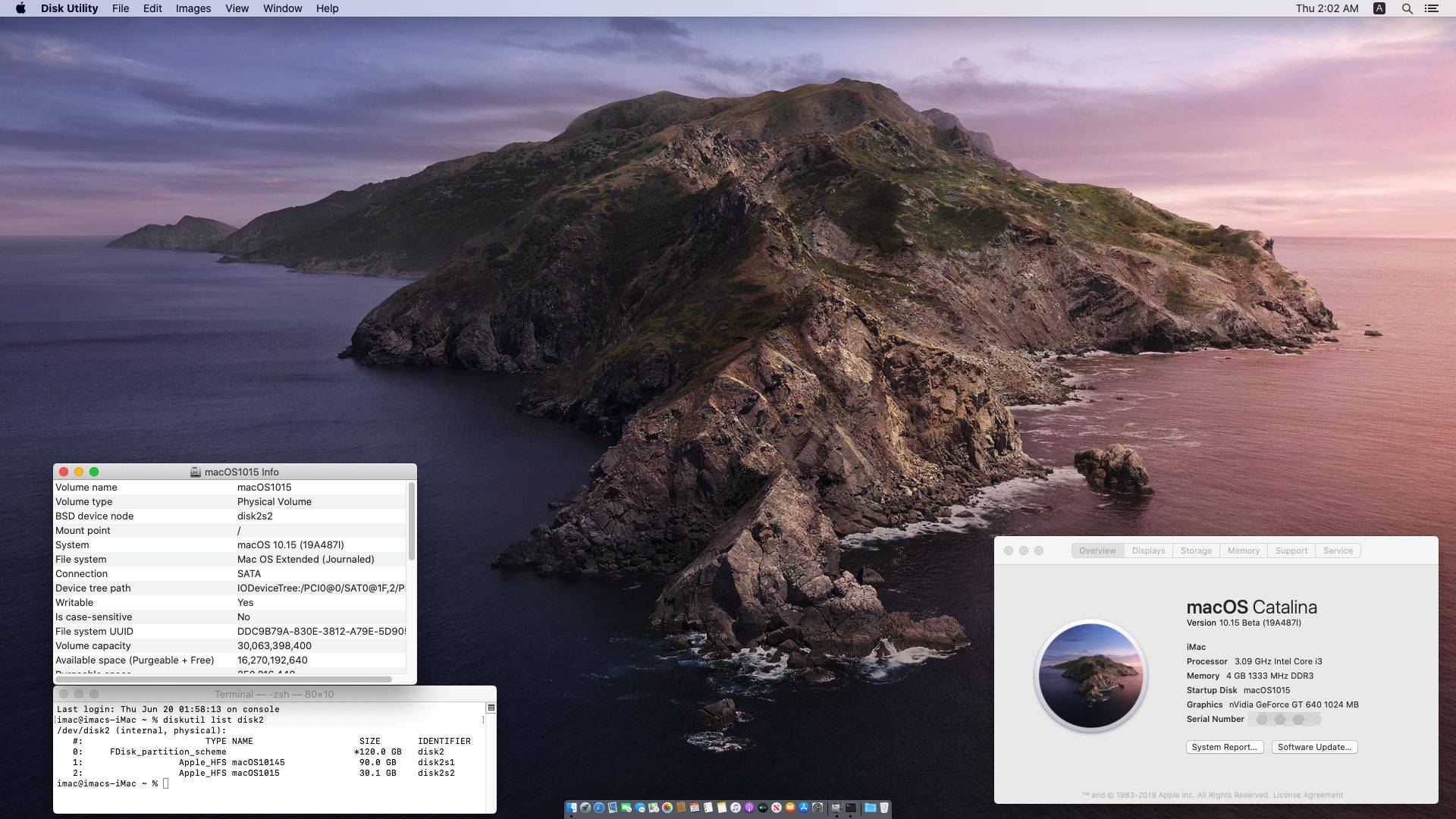

After trying so many times, I give up to clean install Catalina to MBR HFS+ for now.
By using @toru173's ditto method,
Finally, I got MBR HFS+ Catalina works perfectly now.:):)
(Hackintosh with Clover, BooterConfig=0x28, CsrActiveConfig=0x67)
This is what I do.
1. Use createinstallmedia to make an USB Catalina Installer.
2. Boot to USB Catalina Installer, and clean install Catalina to a blank APFS partition, and get "GPT1015", "GPT1015 - Data", two APFS partitions.
3. Boot to USB Catalina Installer, open Utilities -> Terminal, use ditto to copy files to MBR HFS+ partition "macOS1015":
DB1
ditto /Volumes/GPT1015/ /Volumes/macOS1015/
ditto /Volumes/GPT1015/System/Library/Templates/Data/Device/ /Volumes/macOS1015/
DB2
ditto /Volumes/GPT1015/System/Library/Templates/Data/ /Volumes/macOS1015/
4. Boot to "macOS1015" MBR HFS+ partition on single user mode:
/sbin/mount -uw /
update_dyld_shared_cache -force
kextcache -system-prelinked-kernel
reboot
5. Reboot to "macOS1015" MBR HFS+ partition, and setup a user and login, finish the installation.
(Got Writable=Yes. I don't know why?)
Then, after login to "macOS1015" MBR HFS+ partition, everything works perfectly without slow speed on SSD.
It's the only solution for me till now.:):)
