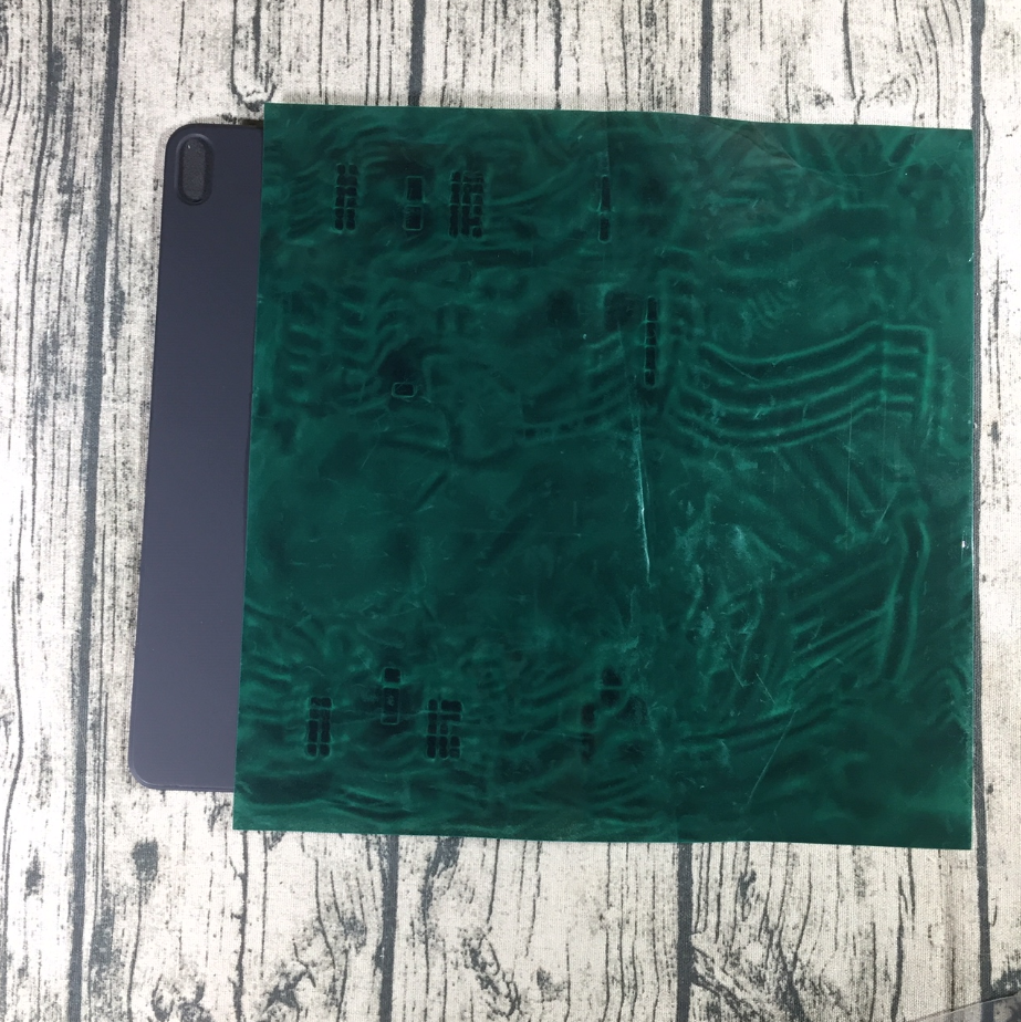

See attached this photo I just took, there are many dark black objects. That is how many magnets are in the back section of the Apple folio case (and there are more still in the uncovered area!). It's an incredibly complicated setup of alternating polarity magnets, and, unless Apple is trolling accessory companies to allow them to keep their own case sales high, there must be a reason for it.
I think it's a fair bet that the Chinese factories don't have the same magnet setup as Apple, firstly because it would be very hard to get this right before the device went on sale (they get their device information from blueprints and device chassis that get stolen from the factories and sold on to the highest bidders), and secondly, because most factories don't have a very long-term view and there's a lot they would be willing to do to reduce their cost pricing by e.g. $0.10-$0.20, because that's a huge amount of money when you're making tens of thousands of folio cases and it gets them more immediate sales and profits. Neodymium magnets are expensive, so there are much savings to be made.
