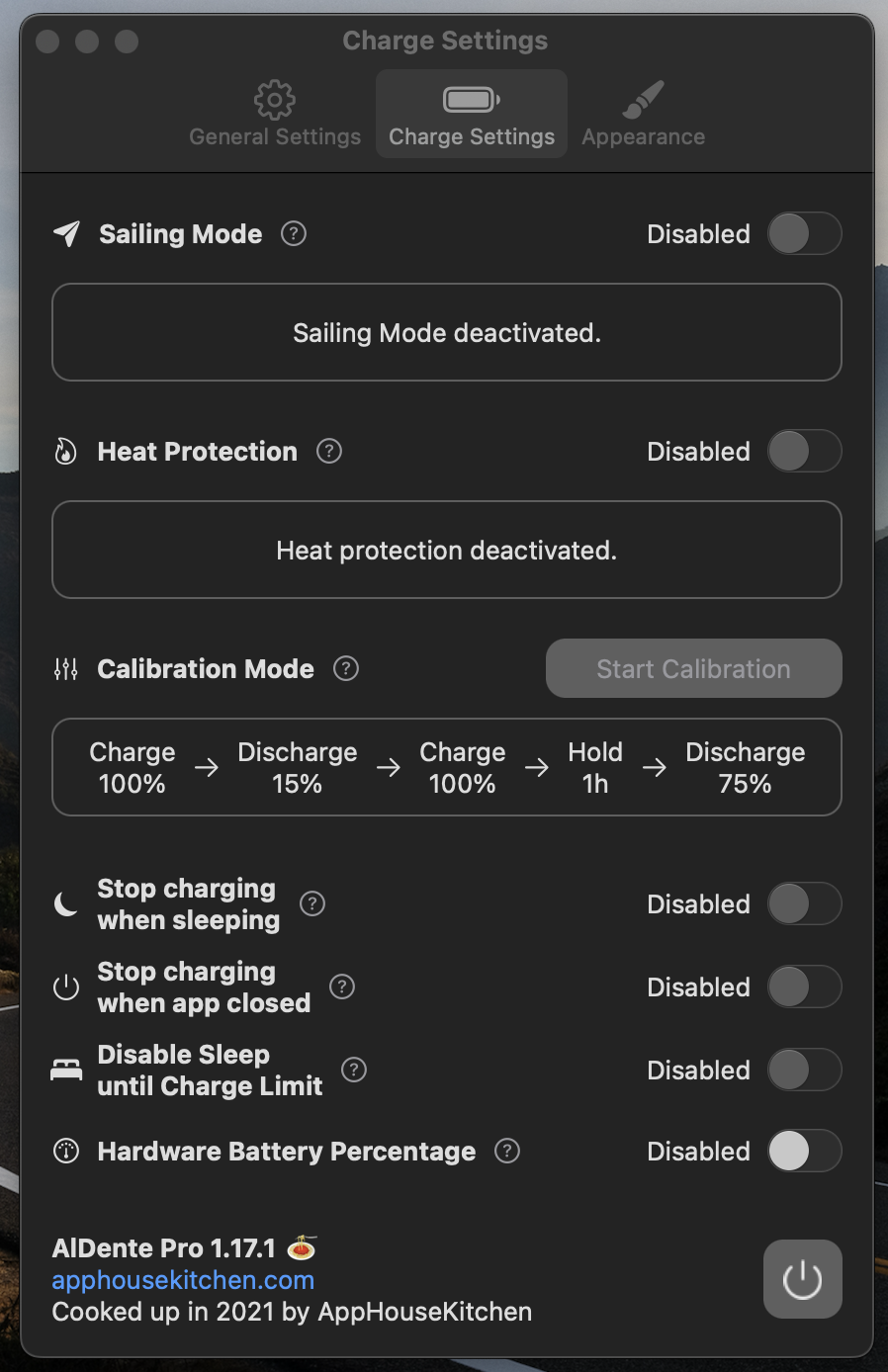

Doesn't seem to be working on my M2 air. I have the pro version if that matters.
Try reinstalling the helper. Also after updates, you'll have to reset the % for it to "take" again. That usually does it for me. Also if you're setting it lower than current charge, gotta hit discharge.
Tryin to help - hope it helps lol.
AndrewC89
macrumors regular
Mar 8, 2022
120
175
Tried the helper reinstall, didn't work. Reset my laptop, nothing. Uninstalled aldente pro and attempted to reinstall and cannot even open the app now. Keep getting error when trying to install helper app. I have a feeling this is due to the last mac os update (12.5).
Oh dang, that's not good. I'm using an M1 Max.
AlDente Pro 1.17.1
Mac OS 12.5 as well.
After the update I noticed my charge at 100% so I had to drop it back to 70% and it has stuck there since.
I have no idea why it wouldn't be working :/ Maybe an M2 thing?

It works on the M2. I had it working on mine for 12 days without any problems before returning it for a larger SSD (which is on order).
Weird, not sure what to make of my issue then.
Aldente will install but will not hold a charge at whatever % I set it to. I also can't seem to turn on any charge settings besides "Hardware Battery Percentage". Everything else is disabled by default and grayed out.
Aldente pro on the other hand will install but won't open and keeps asking me to install the helper. After installing it just asks again. No amount of resets or reinstalls seem to help.

I would try to “fully uninstall” AlDente - for example using AppCleaner - then reboot the Mac and install it again.
AndrewC89
macrumors regular
Mar 8, 2022
120
175

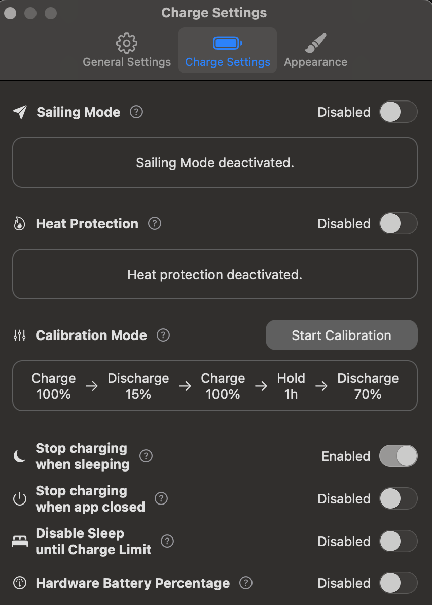

Okay, I was able to fully uninstall and reinstall, and now the app opens as normal. However, the charge limit I set is ignored still, and all options besides "Hardware battery %" are still grayed out.
Yeah if reinstalling the helper doesn't do anything I'd start thinking that Apple is doing something with that (probably unintentionally) in the latest update. I'd do the above and save debug file and (if you haven't already) send that off to apphousekitchen.
Thanks for keeping us updated!
