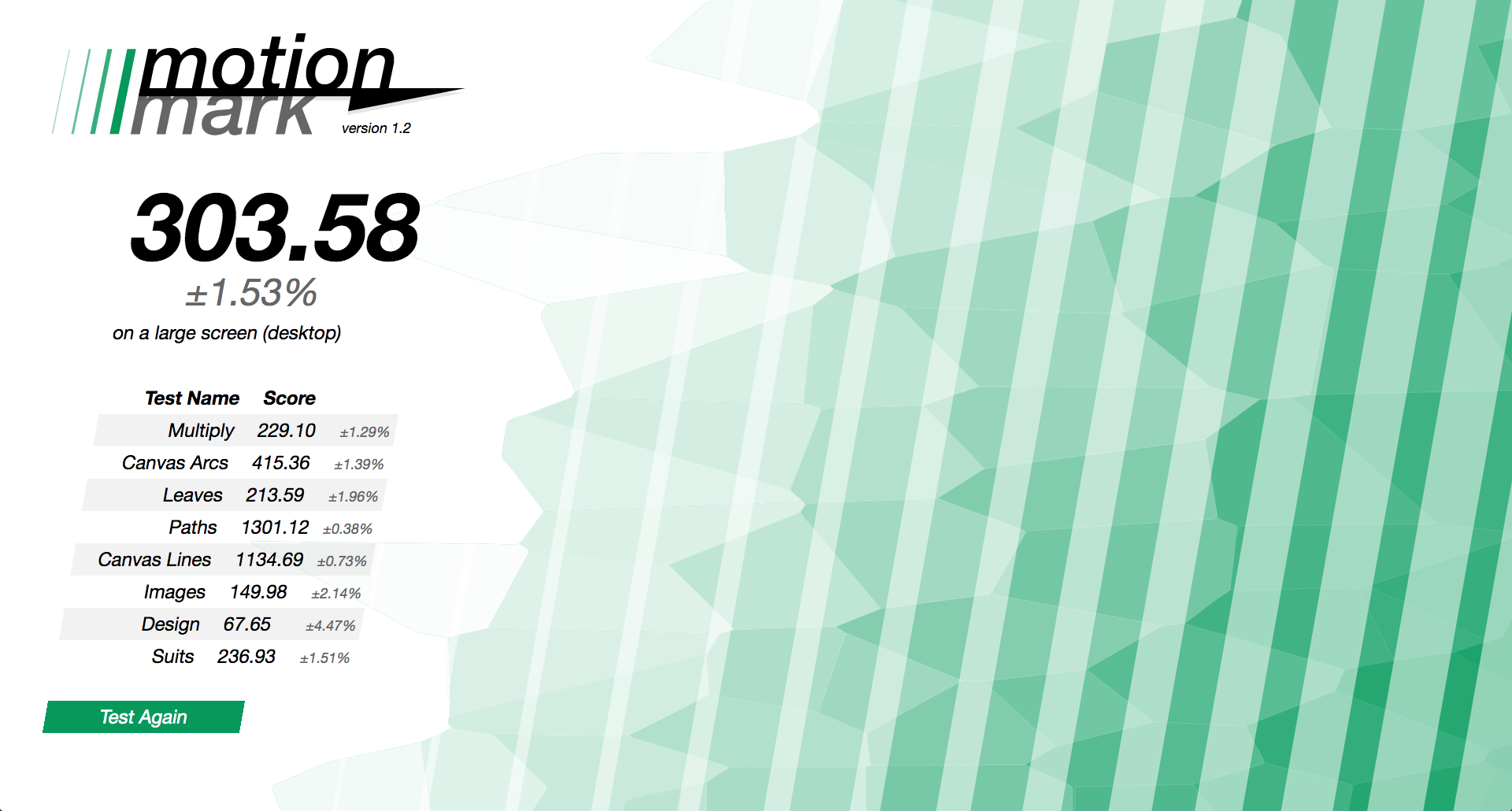

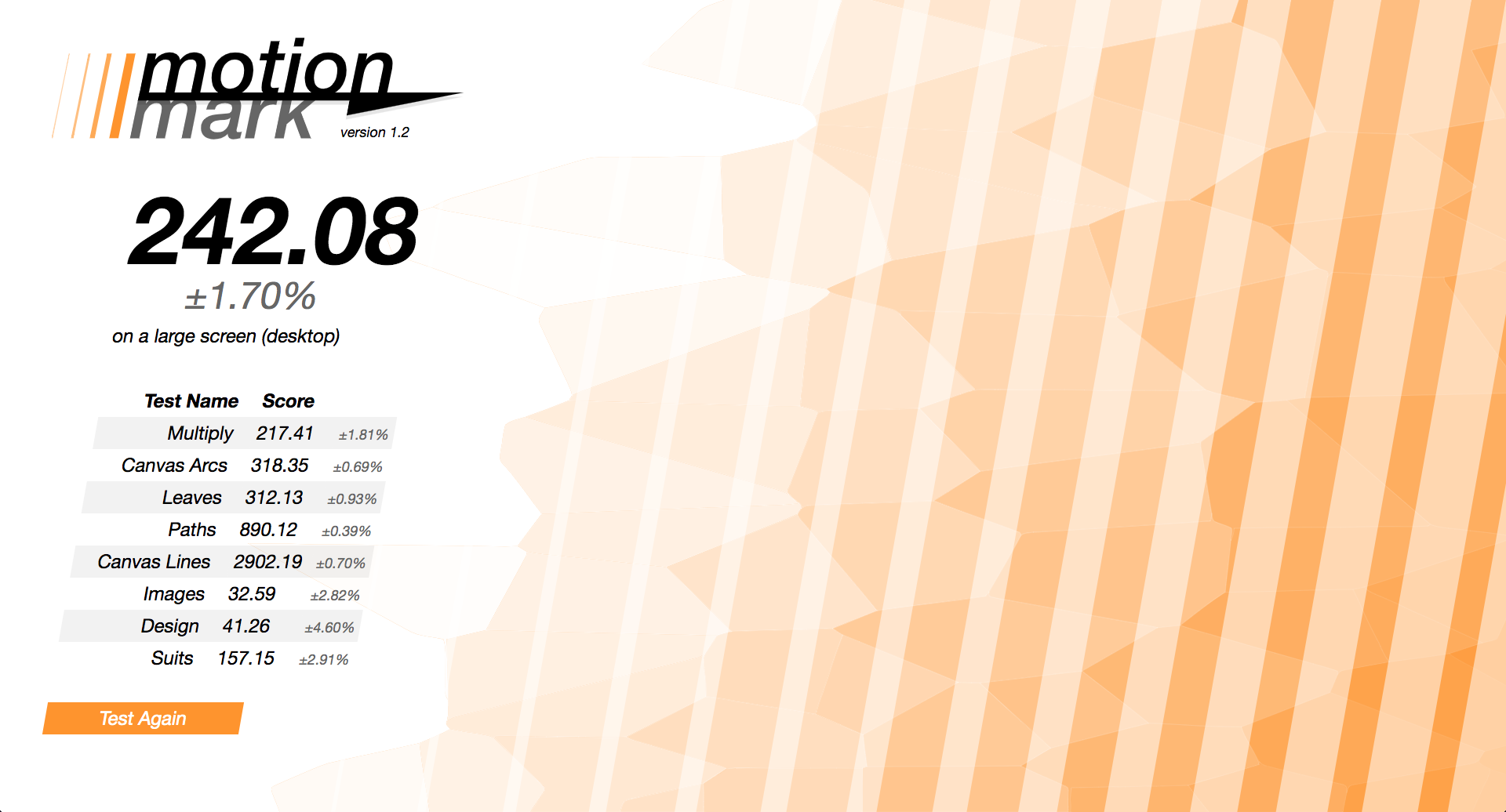

I read that but hadn't heard the expression foo before so was looking for files called foo haha. Got it to work though and can confirm gpu acceleration does not work and the browser does just feel way slower. The three tests on motionmark it seemed to have beat the up to date version of Chromium-legacy is on the Paths, leaves and Canvas Lines tests.
Image above - GPU_Compositing Off
Image above - GPU_Compositing on
Reactions: Wowfunhappy
