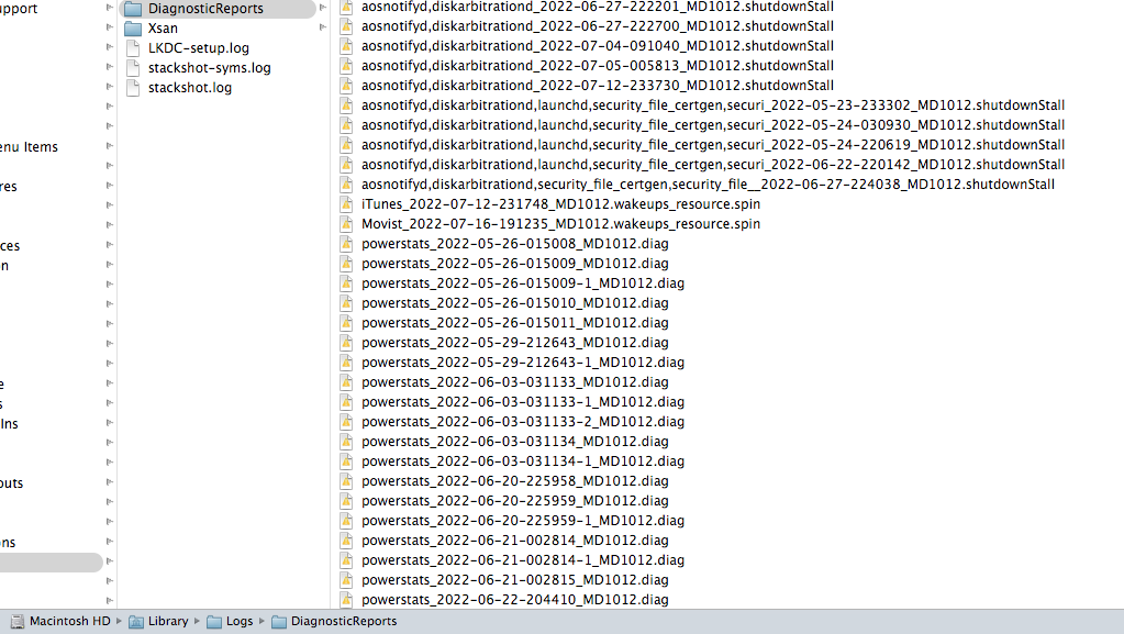

Look for a file with the extension ".panic" in /Library/Logs/DiagnosticReports.
Weird, there's none with .panic extension
MacBiter
macrumors 6502
Jun 2, 2021
264
45
It might not have been a kernel panic! A hard freeze is not necessary a panic. In fact, on Mavericks, a kernel panic triggers an automatic reboot.
Yes, that's what happens (happened!) when I got kernel panics - there was always a panic report in Console after the reboot. A freeze is very rare, and usually resulted from a memory issue.

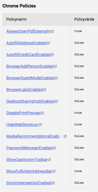

When I dig into this Chromium Legacy version I noticed that it is managed, what does that mean in practice?
Wowfunhappy
macrumors 68000
Mar 12, 2019
1,751
2,091
You're using my PrefPane, right? These are preferences it sets by default.
Some of these are my personal preference (I made the PrefPane for myself first and foremost). For example, I dislike how by default, if you're using Chromium and you sign into e.g. your gmail account, you automatically get signed into your Google account in the browser too. You can still enable this in the UI if you want (and in fact, you must enable it in order to e.g. sync bookmarks to your Google account), but the PrefPane turns it off by default.
Other settings are workarounds, or partial workarounds, for Chromium Legacy limitations. For example, some UI elements in Chromium Legacy lack a drop shadow, and so can be hard to see against a white background. One of those UI elements is the print preview dialog. To have one less UI element with this problem, I switch the print preview window to the native Apple print dialog instead of Chromium's custom one.
Reactions: AlixSPQR
AlixSPQR
macrumors 65816
Nov 16, 2020
1,078
5,466
Sweden
Some of these are my personal preference (I made the PrefPane for myself first and foremost). For example, I dislike how by default, if you're using Chromium and you sign into e.g. your gmail account, you automatically get signed into your Google account in your browser too. You can still enable this in the UI (and need to if you want to e.g. sync bookmarks), but the PrefPane sets it off by default.
Other settings are workarounds, or partial workarounds, for Chromium Legacy limitations. For example, some UI elements in Chromium Legacy lack a drop shadow, and so can be hard to see against a white background. One of those UI elements is the print preview dialog. To have one less UI element with this problem, I switch the print preview window to the native Apple print dialog instead of the built in Chromium one.
Thank you for your explanation! :)
Edit: I experience no UI problems in El Capitan without your PrefPane.
