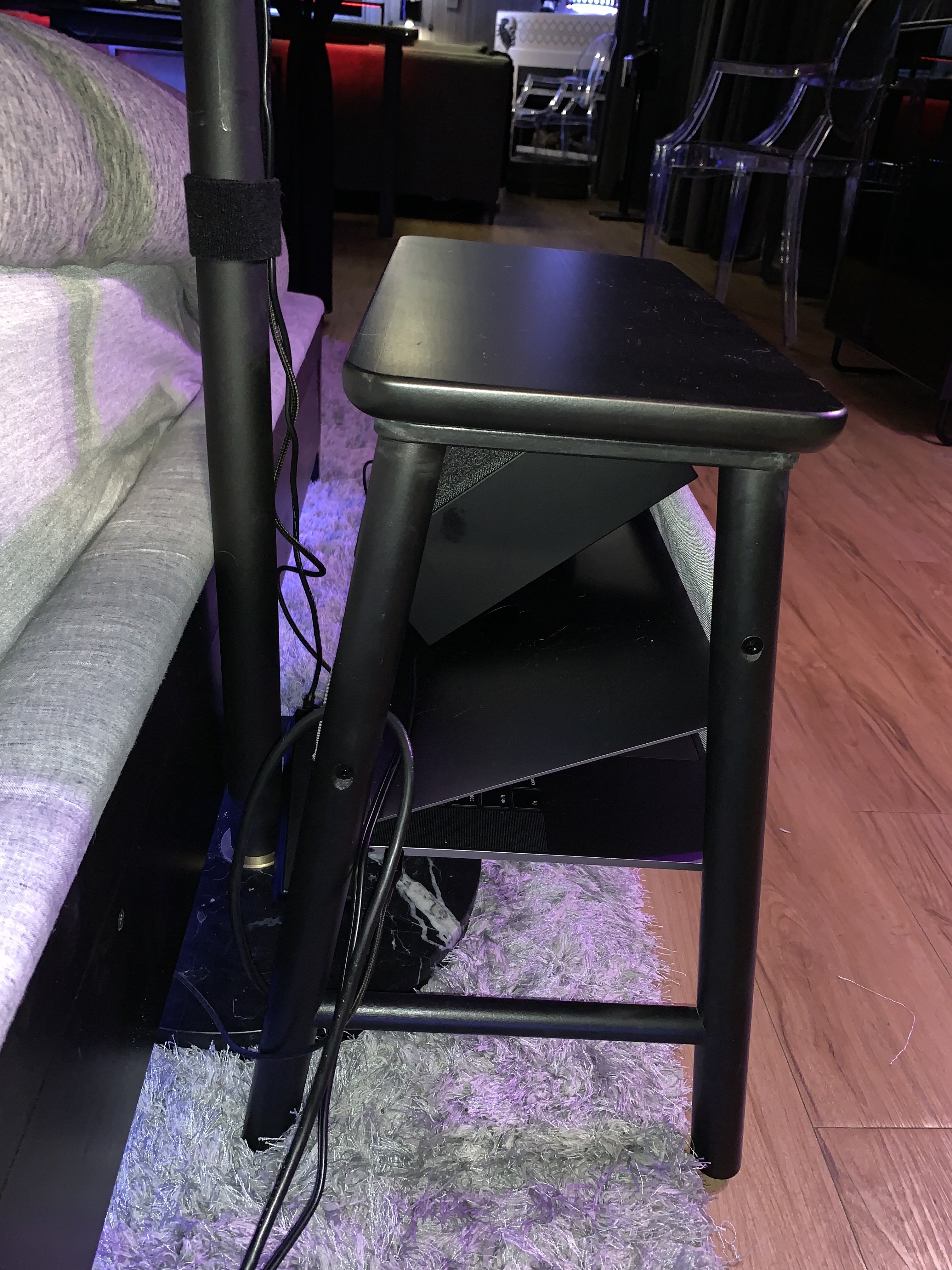

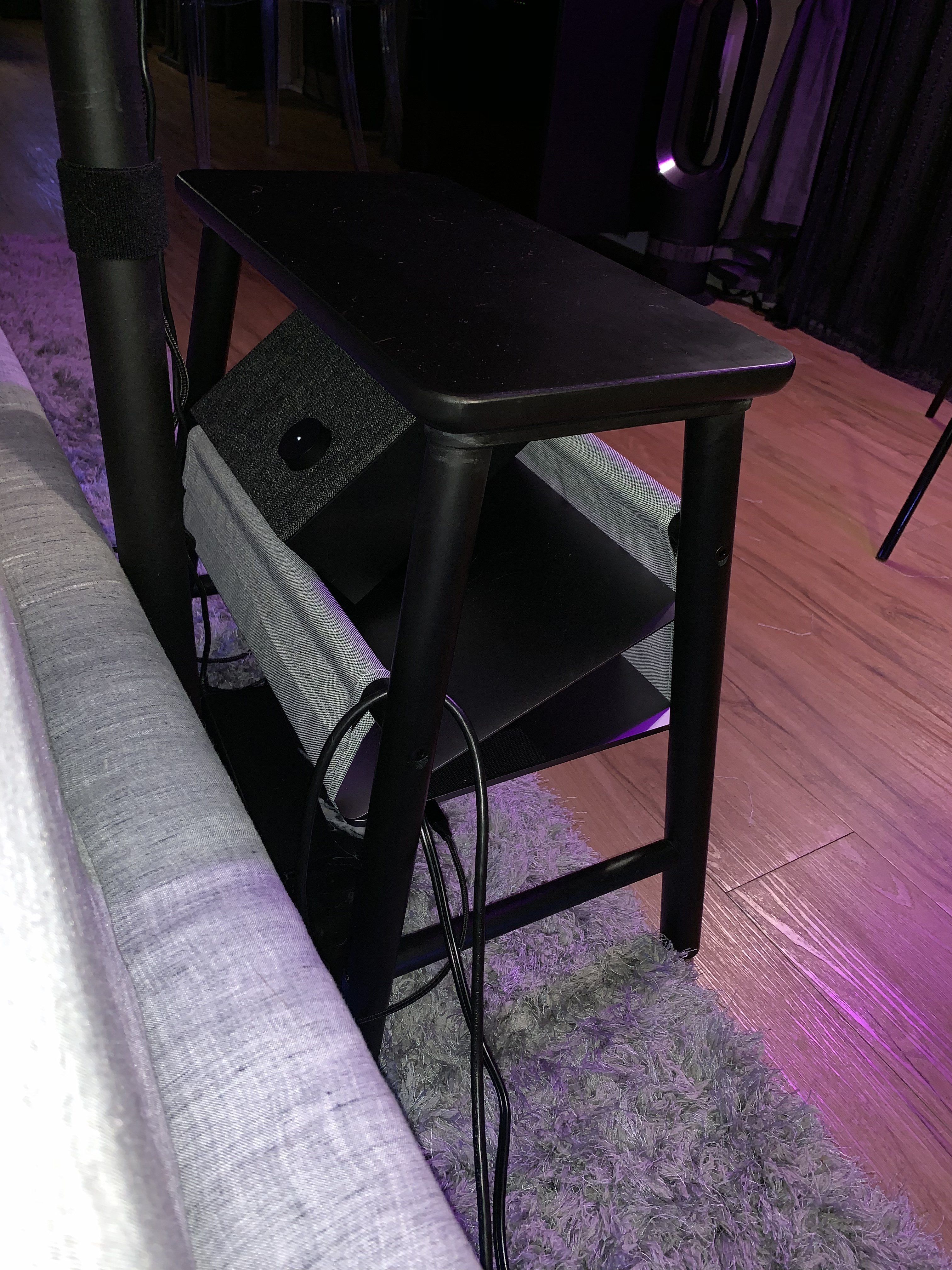

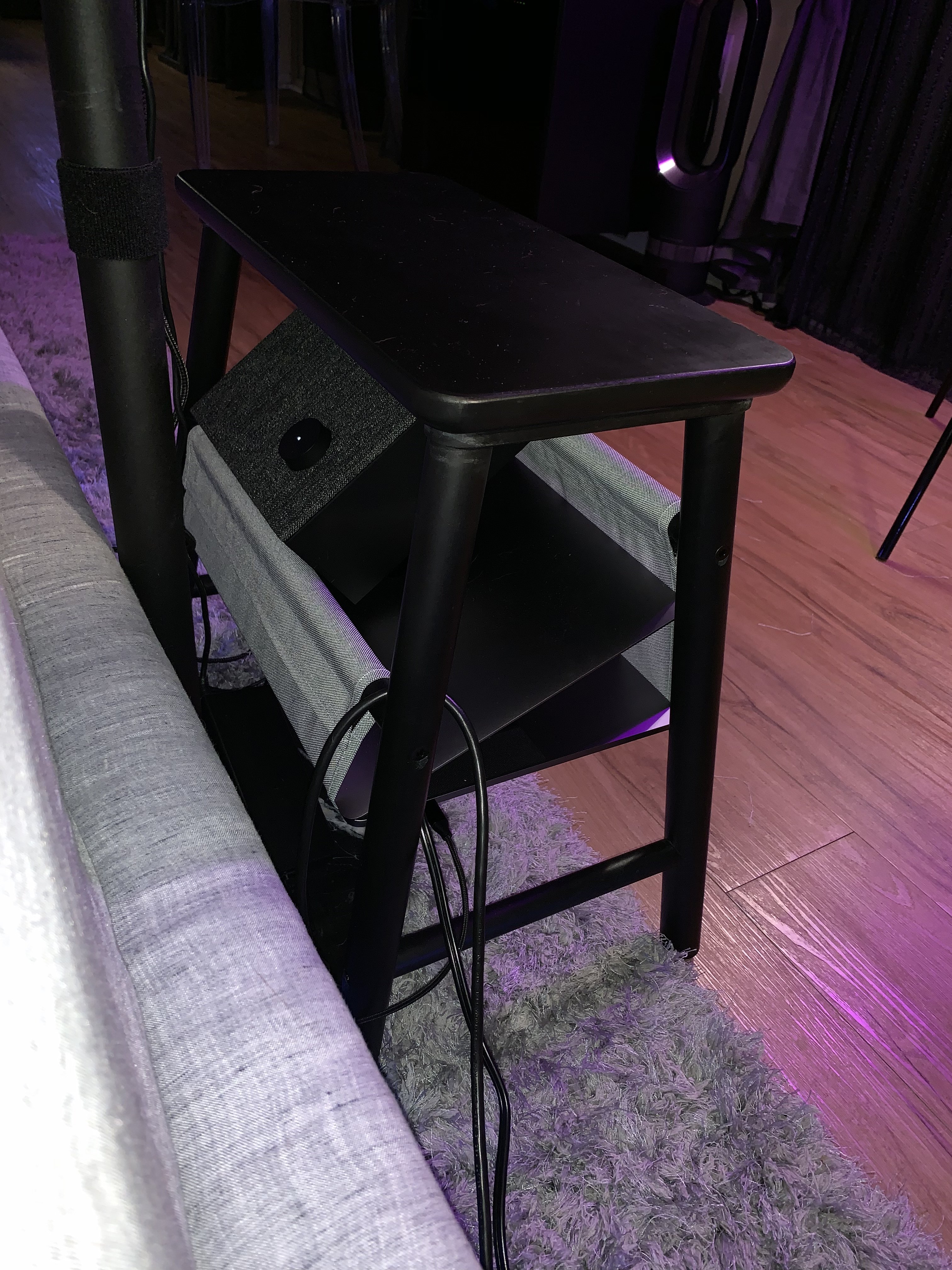

I definitely noticed the temperature increase when running the lid closed. Normally my 2016 15” runs around 98-99 degrees. With the lid closed it’s around 103-104 which seems like a huge jump In temperature. I keep it flat also not vertical. I’m probably going to start running the lid a quarter way open to dissipate more heat.
[QUOTE="x-evil-x, post: 27470047, member: 204600] I keep it flat also not vertical. I’m probably going to start running the lid a quarter way open to dissipate more heat.[/QUOTE]
Do you mean flat on a table? Why don’t you try placing a small spacer under both sides of the spine first to allow airflow underneath? I keep mine vertical. I’ll check the temp.
its open to the sides in a little holder under my monitor basically the same as being flat on a table. if its open its always under 100 degrees. Just tested out keeping it open a quarter amount and getting gems back in the 96-97 range. Does the keyboard backlight and screen stay on when you close the lid? No idea why the temp would be 6-8 degrees higher when shut.
I've always noticed higher temps in clamshell mode, so much so, I decided to forgo that option. I also noticed when opening the laptop up after being in clamshell mode the keyboard area to be significantly hotter. That is a layer of hot air just sat between the keyboard and the display. I opted not to subject my keyboard or display to that amount of heat. Personal preference but I opted to play it safe then sorry YMMV
yea ill be running mine slightly open from now on. runs 6-8 degrees cooler like that.
