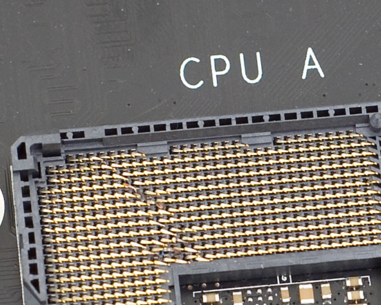

Oops. You’ve quite likely permanently damaged your cMP.
Delidding or washers are a must.
My preference is delidding without a doubt.

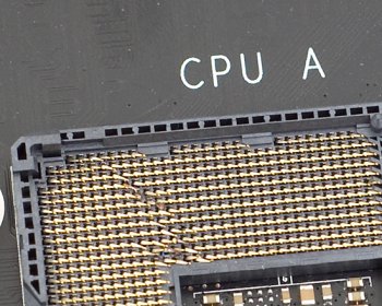

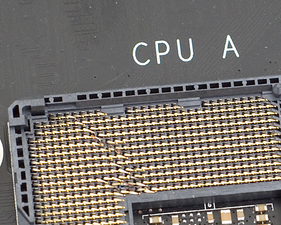

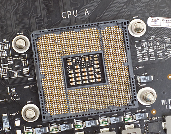

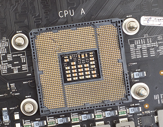

Check the CPU pins on the motherboard's socket for the bent ones.
Maybe you could try and straighten them if there are some that are bent.
https://www.anandtech.com/show/2800/upgrading-and-analyzing-apple-s-nehalem-mac-pro/11
Can you be more specific regarding the permanent damage? I assume you're referring to the RAM slot?
To be clear, I'm posting to you all now from the Mac Pro 4,1 and have been using it as my daily driver for the past month since the upgrade.
See owbp’s post above.
Your RAM issue is indicative of the above.

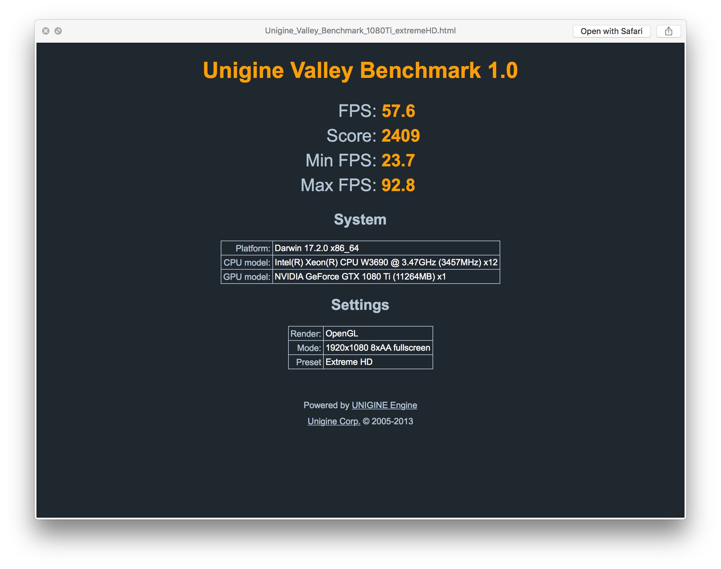

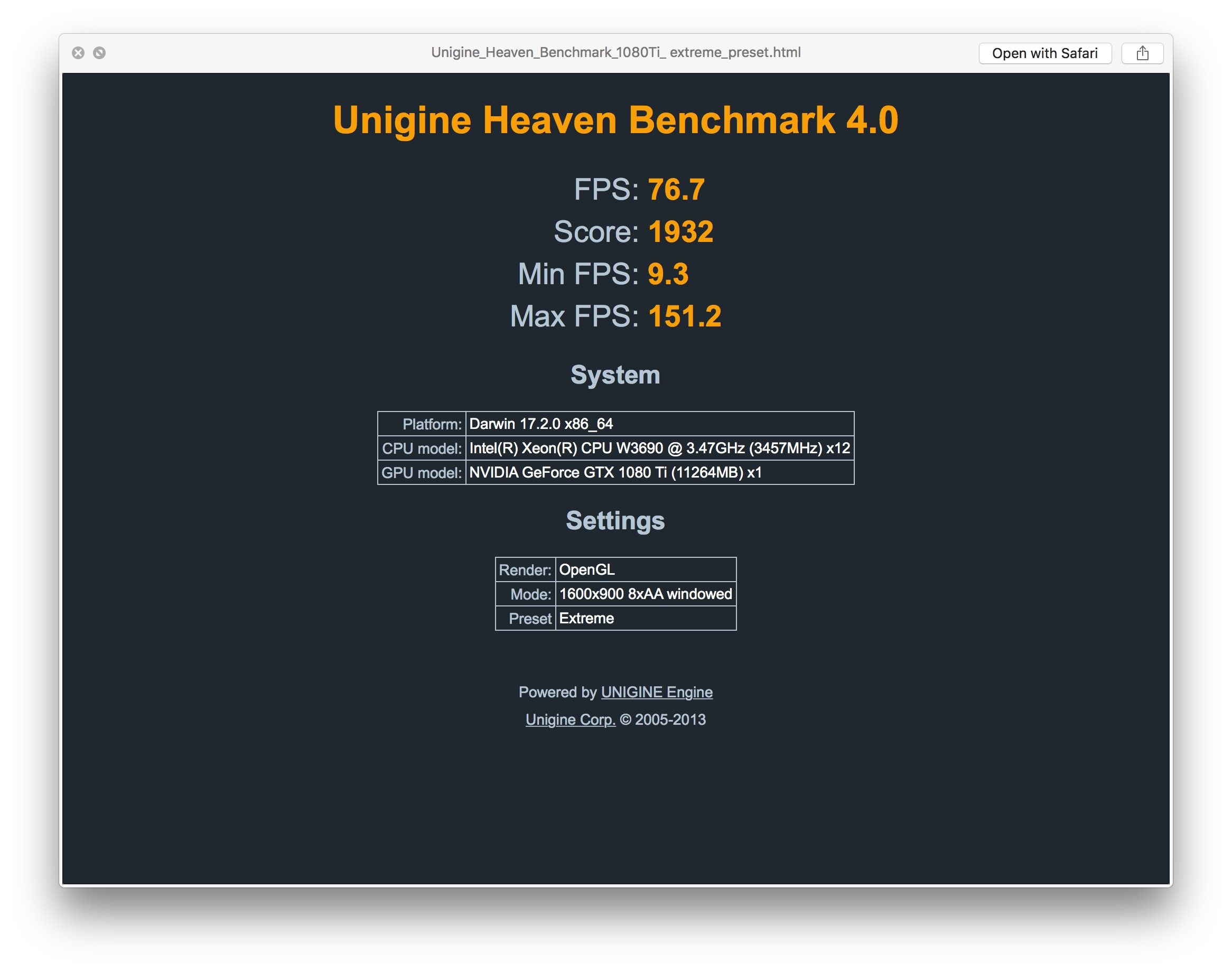

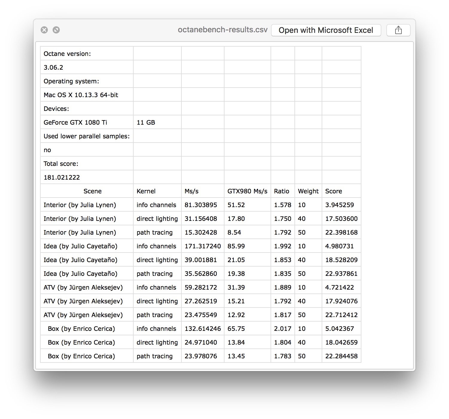

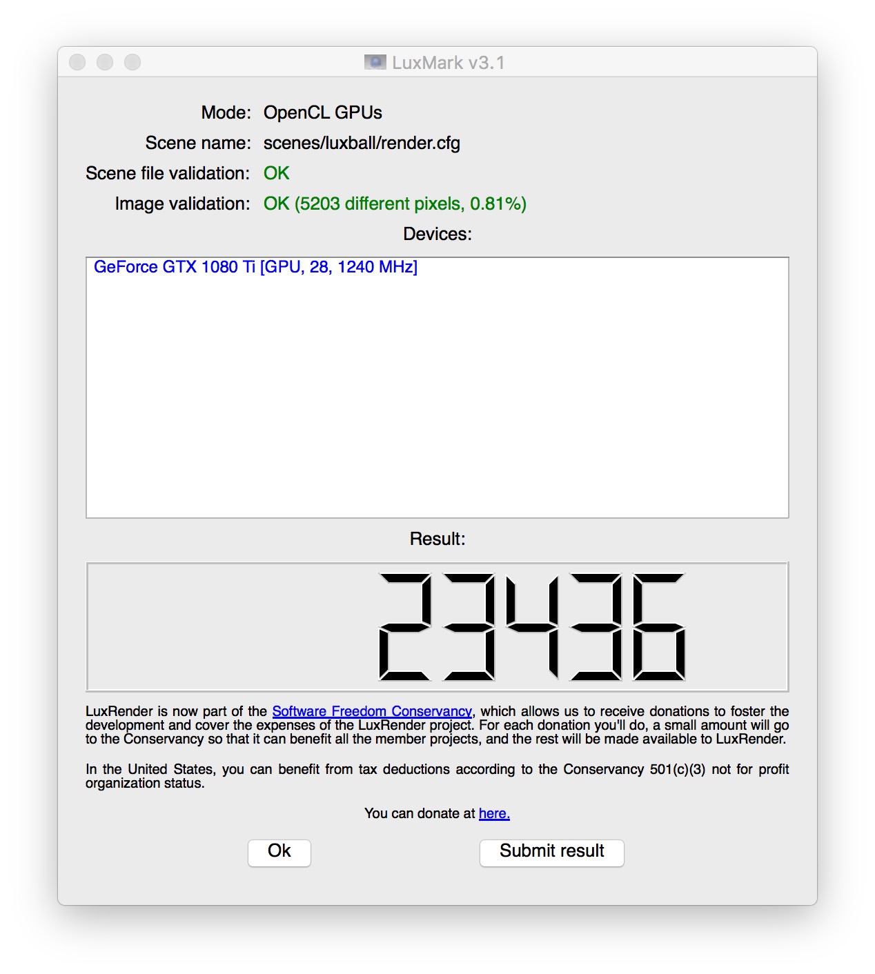

It really depends on how you use the GPU. If the software is very GPU bounded, PCIe 2.0 is not that limiting indeed. Here are some free benchmarks that you can run on your 980Ti, and than you can compare it to my 1080Ti's result, then decide if it's worth.
Octanebench (macOS)
Luxmark 3 (macOS)

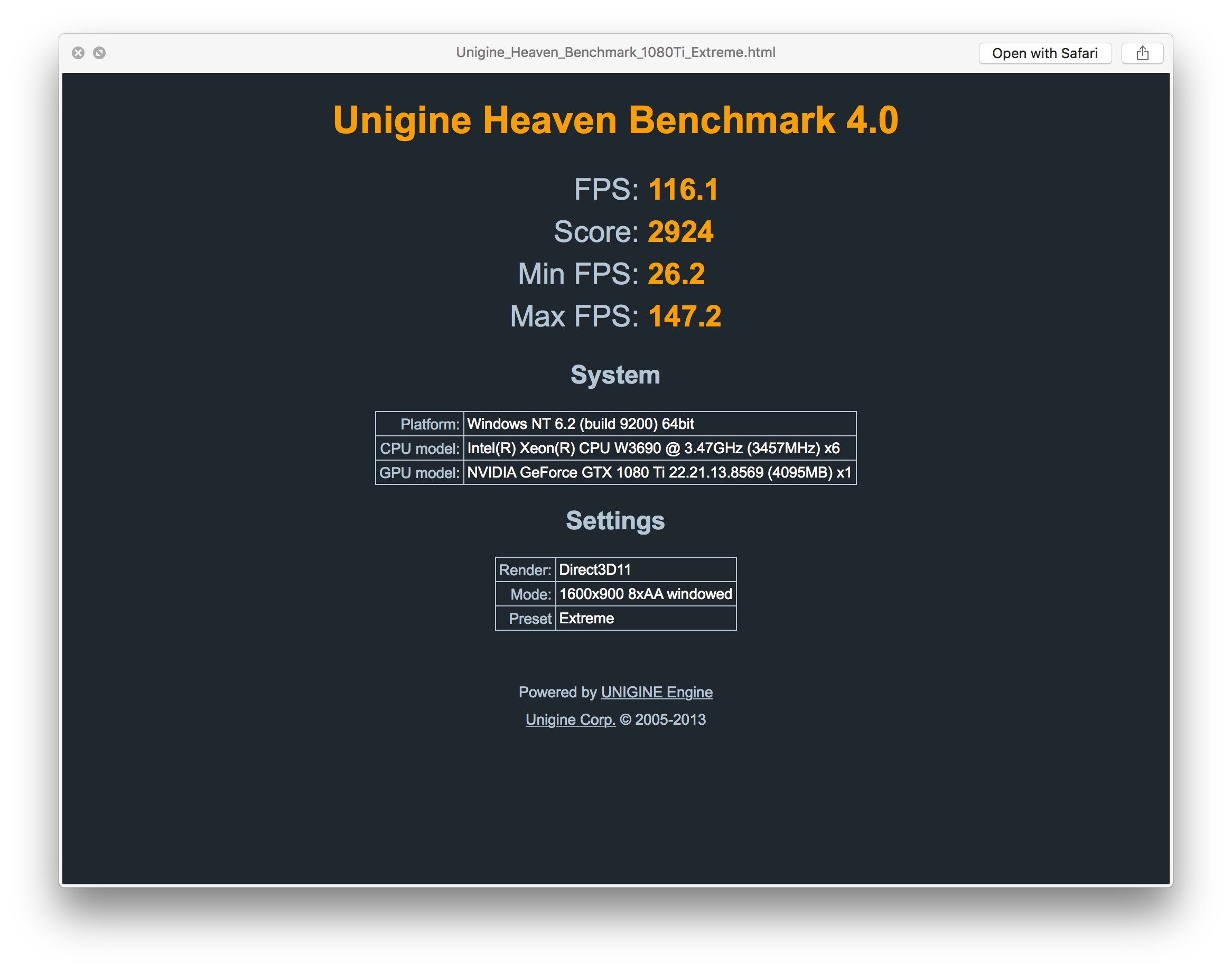

Unigine Heaven (macOS and Windows)
Unigine Valley (macOS and Windows)

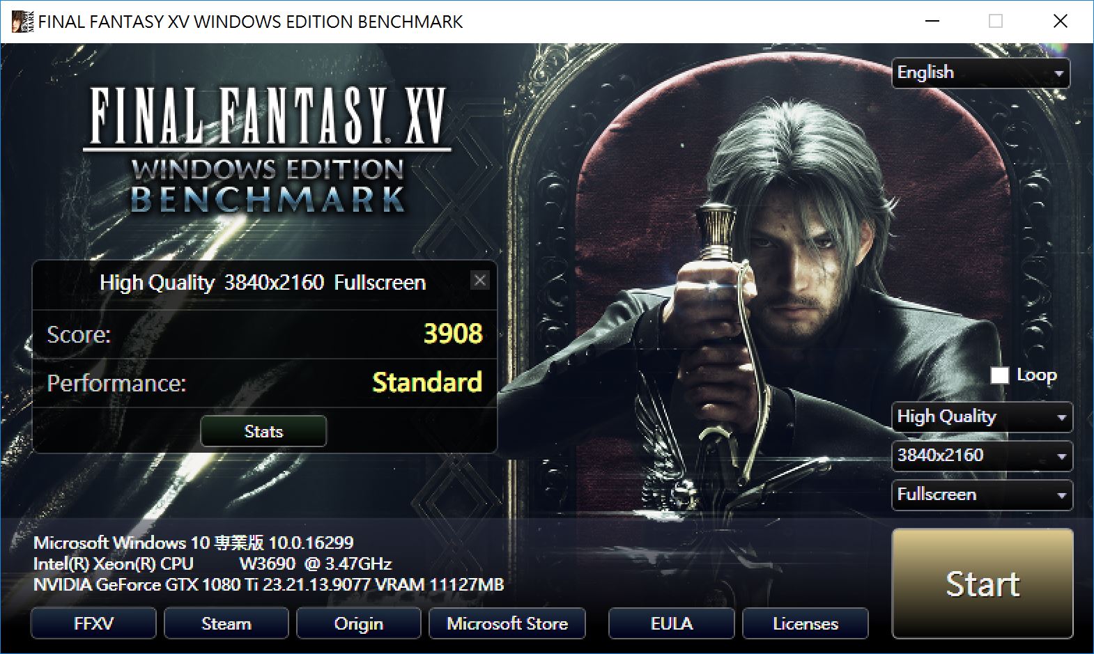

Final Fantasy XV Windows Edition Benchmark (Windows)
Interesting! We have the same CPU, so hopefully that should eliminate any variance and make it a straight comparison of GPUs.
I scored 60.1 FPS and 1515 in Unigine and 51.0 FPS and 2135 in Valley using the same presets as you. That makes the 1080 Ti 27.6% faster in Heaven and 12.9% faster in Valley.
I guess the caveats there are that the Unigine benchmarks run on OpenGL which are always going to look bad compared to Metal or DirectX in Windows.

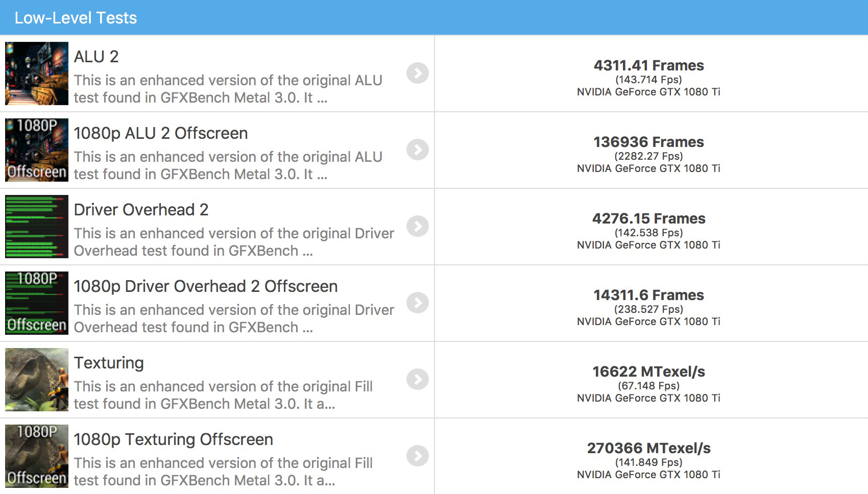

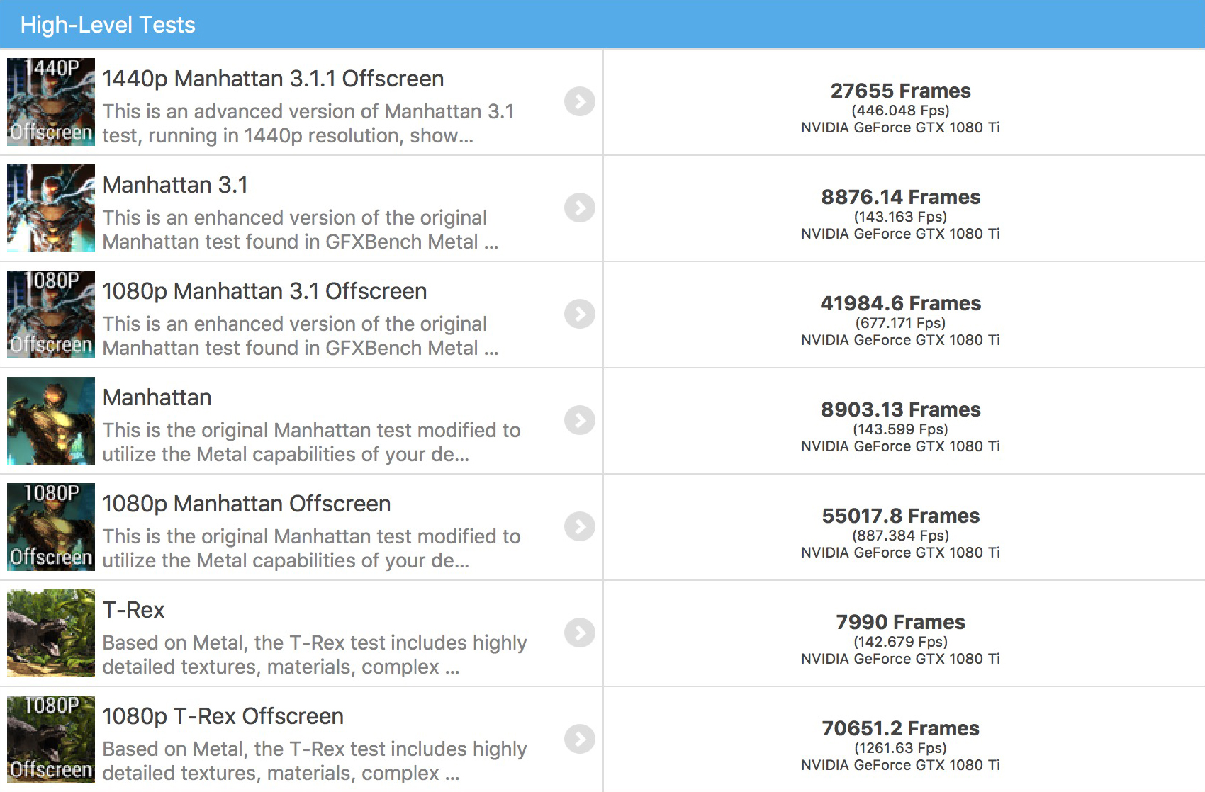

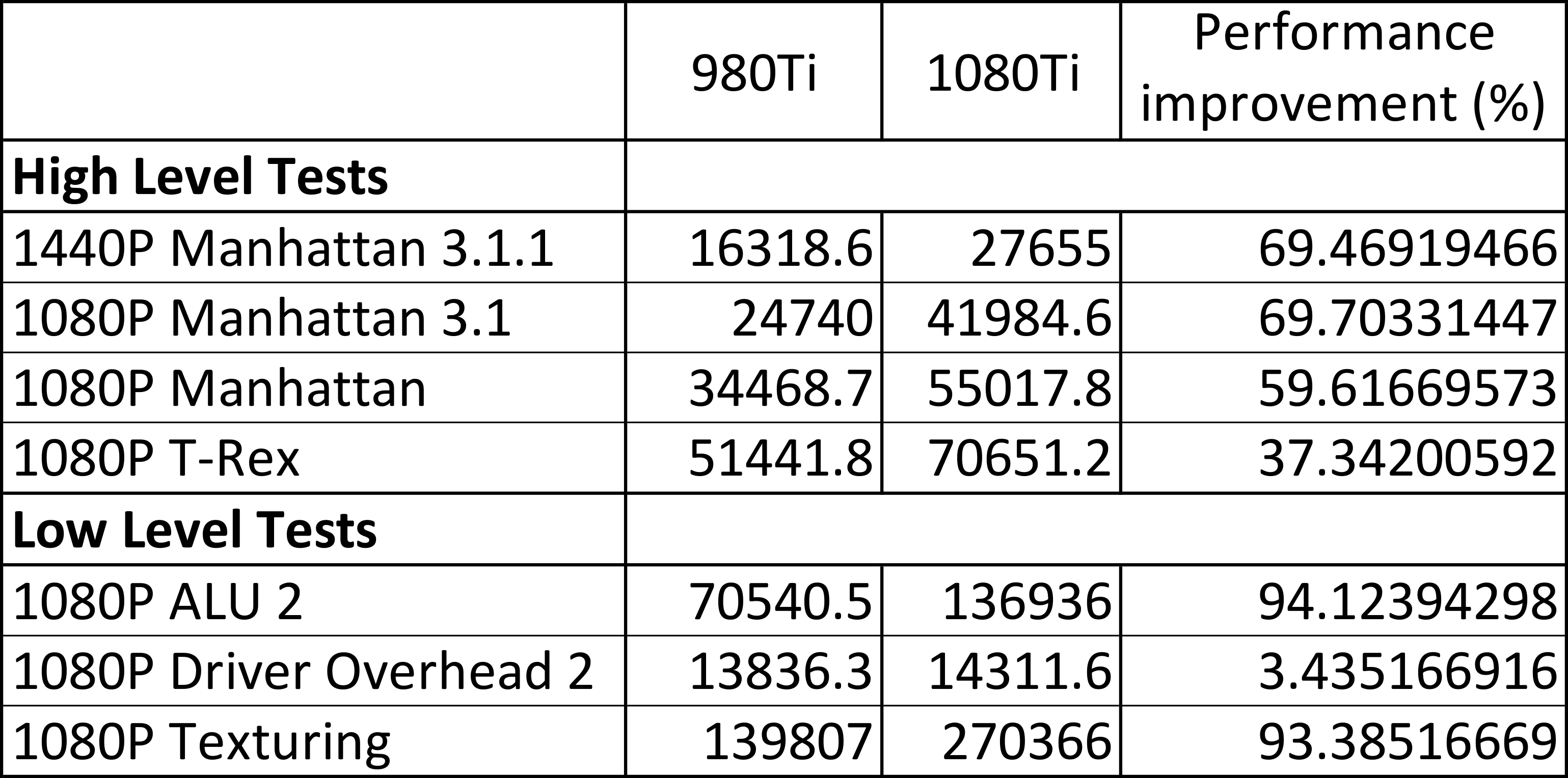

I did a run of GFXBench Metal too, which is free from the App Store and the results are below - ignore the 'onscreen' tests as these are run at native resolution, which for me is 3840x1600.

Here are the 1080Ti's results.
And I make a table for easy comparison (only consider the offscreen results)
So, it seems the 1080Ti still quite a bit faster than the 980Ti with the W3690.
It seems you are using a 75Hz screen, all onscreen results max at 75FPS. In my case, I am with a 144Hz screen, so all results are limited to 144FPS.
P.S. Computer spec as per my signature.

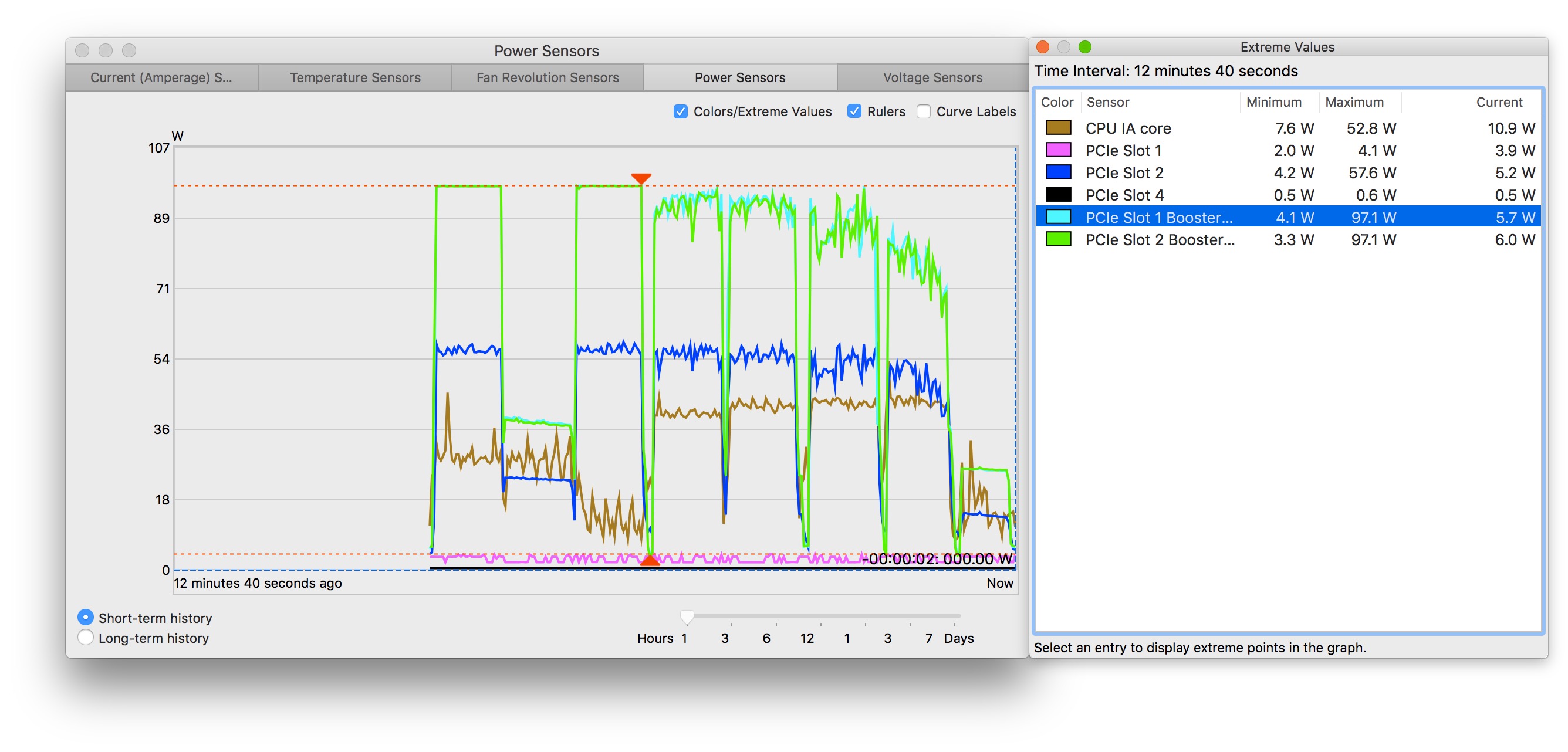

It's quite true indeed. I am sure you know the powering issue. So, the following info is mainly for others to understand why 1080Ti can be a problem.
I rerun the GFXBench Metal again to capture the power consumption (only run the 7 offscreen tests to maximise the power draw). And the result is like this.
97.1W is the monitoring limit. The actual power draw should be a bit above 100W (from each mini 6pins) for the 1st and 3rd test. And most other tests were drawing around 90W average.
This is definitely beyond the 75W official limit. And if I fail to balance the load between the two mini 6pins. The 1080Ti can easily shutdown the Mac by drawing too much power from one of the mini 6pin.
It seems you already done the Pixlas mod, so powering a highly customised OC 1080Ti should not be an issue.
But I personally still prefer a reference card. Simply to decrease the chance of having incompatibility issue. It's still unknown at this moment. However, from memory, I have't seen a case complaining about a reference 10xx card is buggy on the cMP. Almost all the "buggy reports" are with non reference card.
