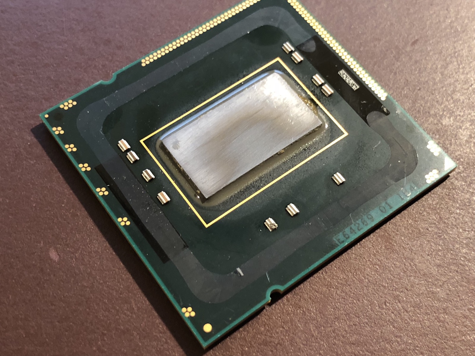

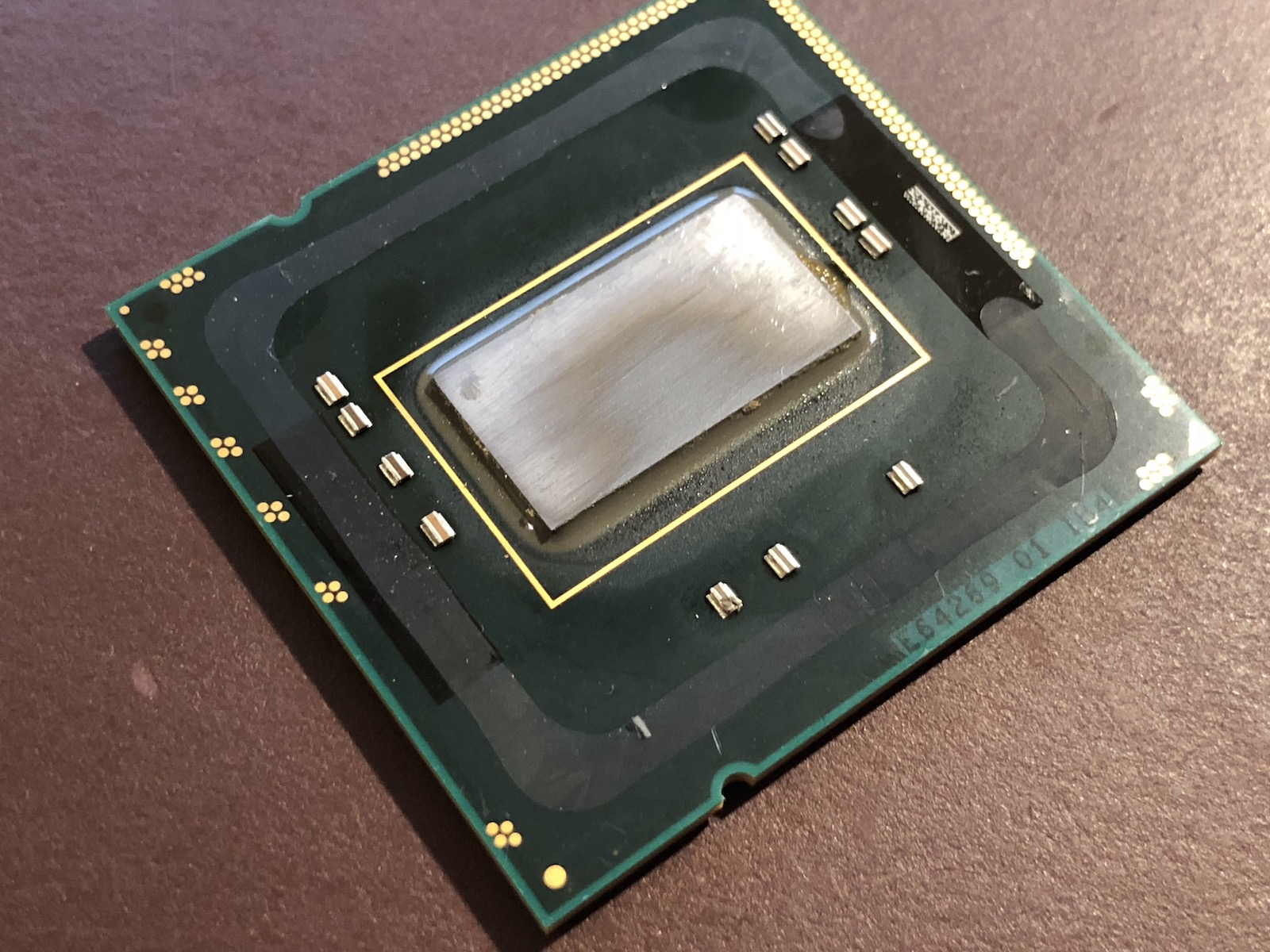

This is the first ever processor I delidded last night. I already sanded off all the solder, buffed the core to a shiny mirror, and installed this into my Mac Pro (along with the other processor that I delidded) and ran some tests. Seems to be working just fine.
However I want to get a replacement online… or am I fine?
The bottom capacity is a bit chipped.

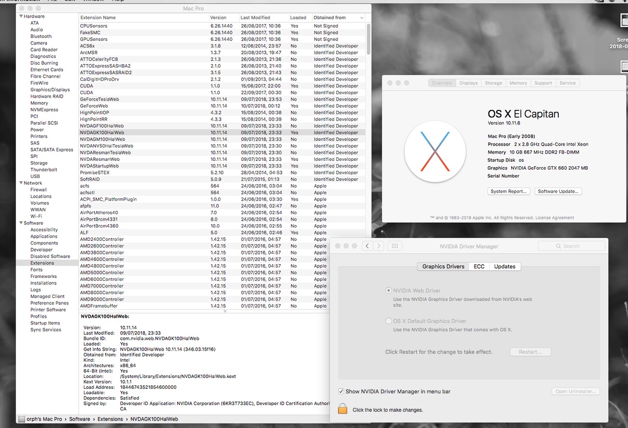

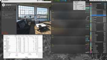

Thanks for the suggestion, I actually re-read that whole thread again. May I know if your case is on a 3,1 or 4,1/5,1?
on my 5.1 osx 12.6 gtx 770, looked at the post and noticed that i had no g-sync panel so ran the command line to install the driver and it worked (with SIP disabled).
last time i had tried to install the nvidia driver SIP was enabled (using normal web installer).
my 3.1 ruining osx 11 gtx660 also dose not have the g-sync panel so tonight ill check to see if it will update the same too.
in the past iv had lots of crashes when using the nvidia drivers so at the mo ruining them to see if i still hit the same problems, so far from light tests i see no speed change but atmonitor is correctly displaying GPU use for the first time since osx10.9? i think (used to display 50% use of gpu when it was at 100% use, now displays 100% odd bug?)
yep with SIP enabled i was not able to install the web driver on my 3.1 osx 10.11 GTX 660 (G-sync panel missing ect)
Was Gatekeeper also disabled?
With 10.13.6 and NVIDIA Web Drivers on authentic 5,1, the G-SYNC panel is available (but not active) with the GTX 1080 FE (not flashed) installed. Both SIP & Gatekeeper enabled.
hum now im not sure, there may not be a G-sync panel on osx10.11 or it's not installing even with sip and gatekeeper disabled.
as a plus with hardware monitor and fake SMC installed i can see all the info from my GTX660 temp, fan speed and core clock

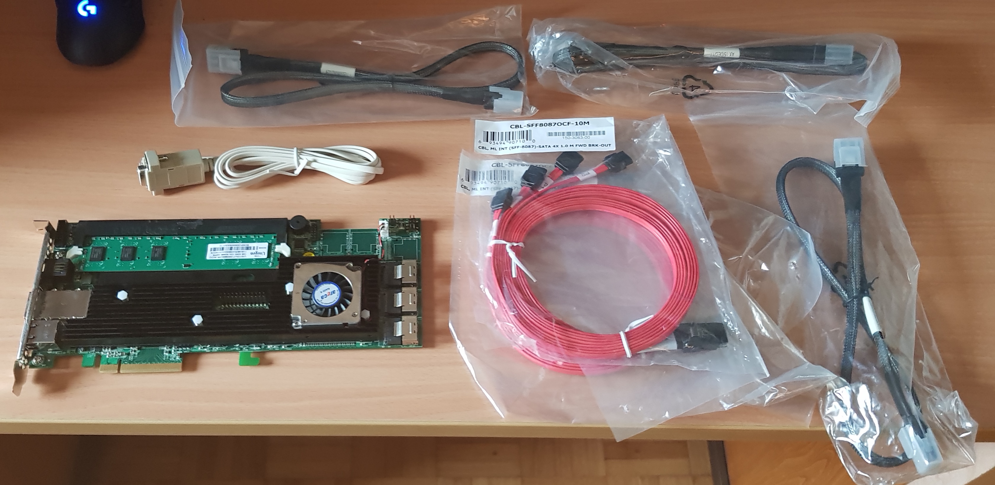

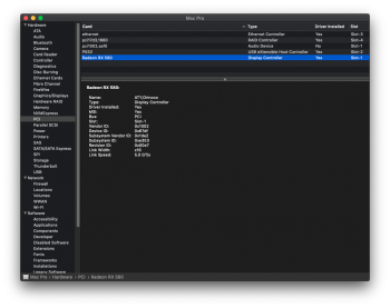

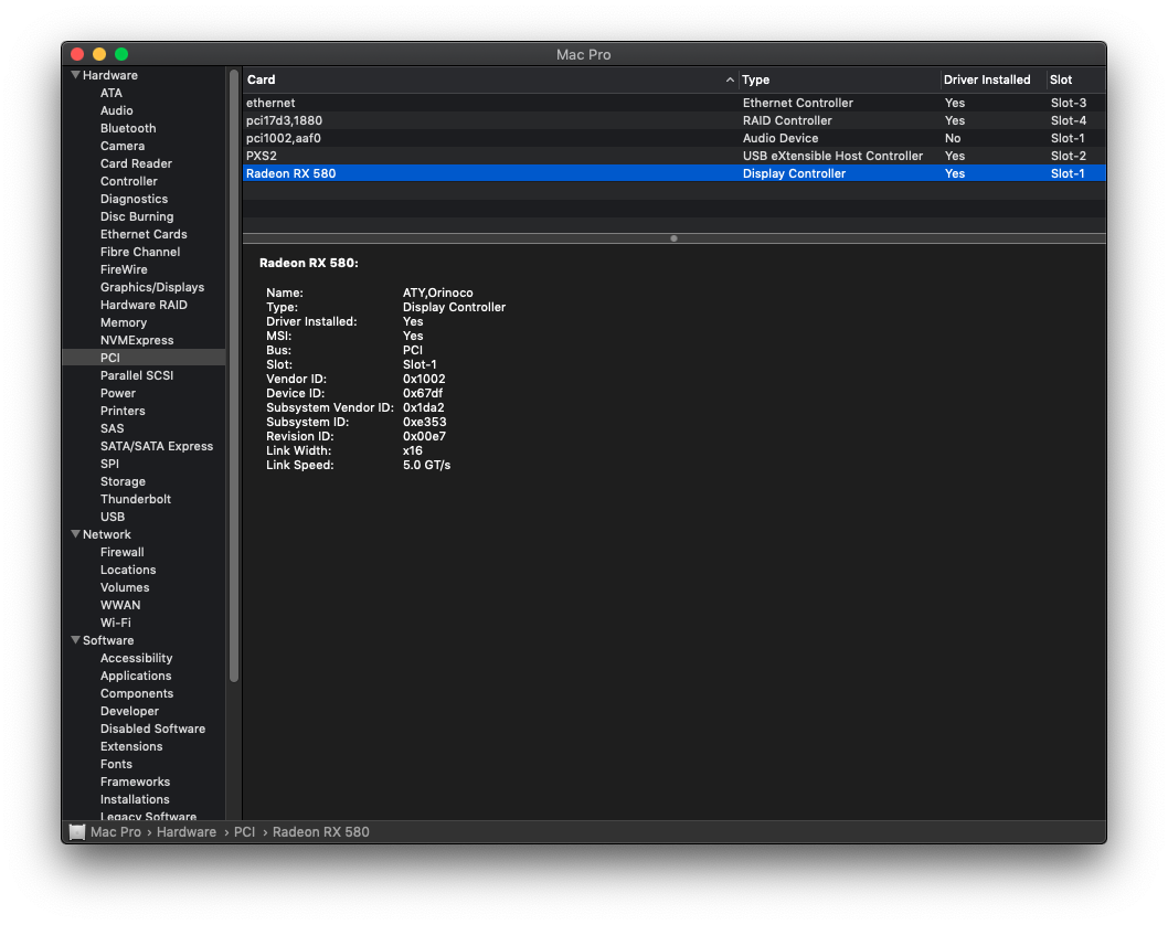

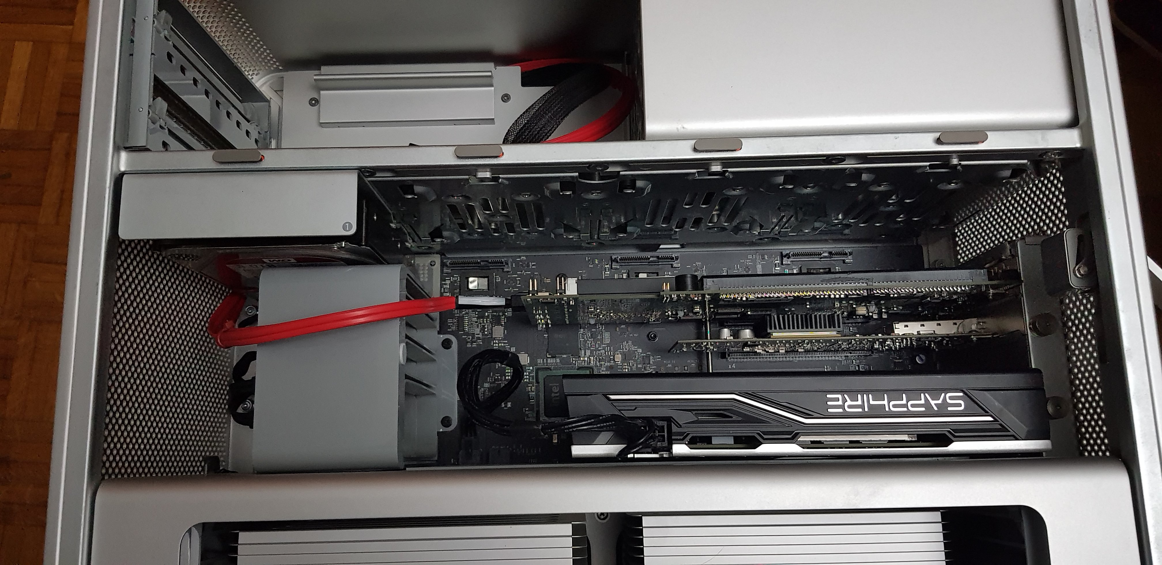

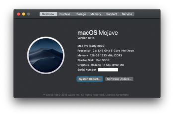

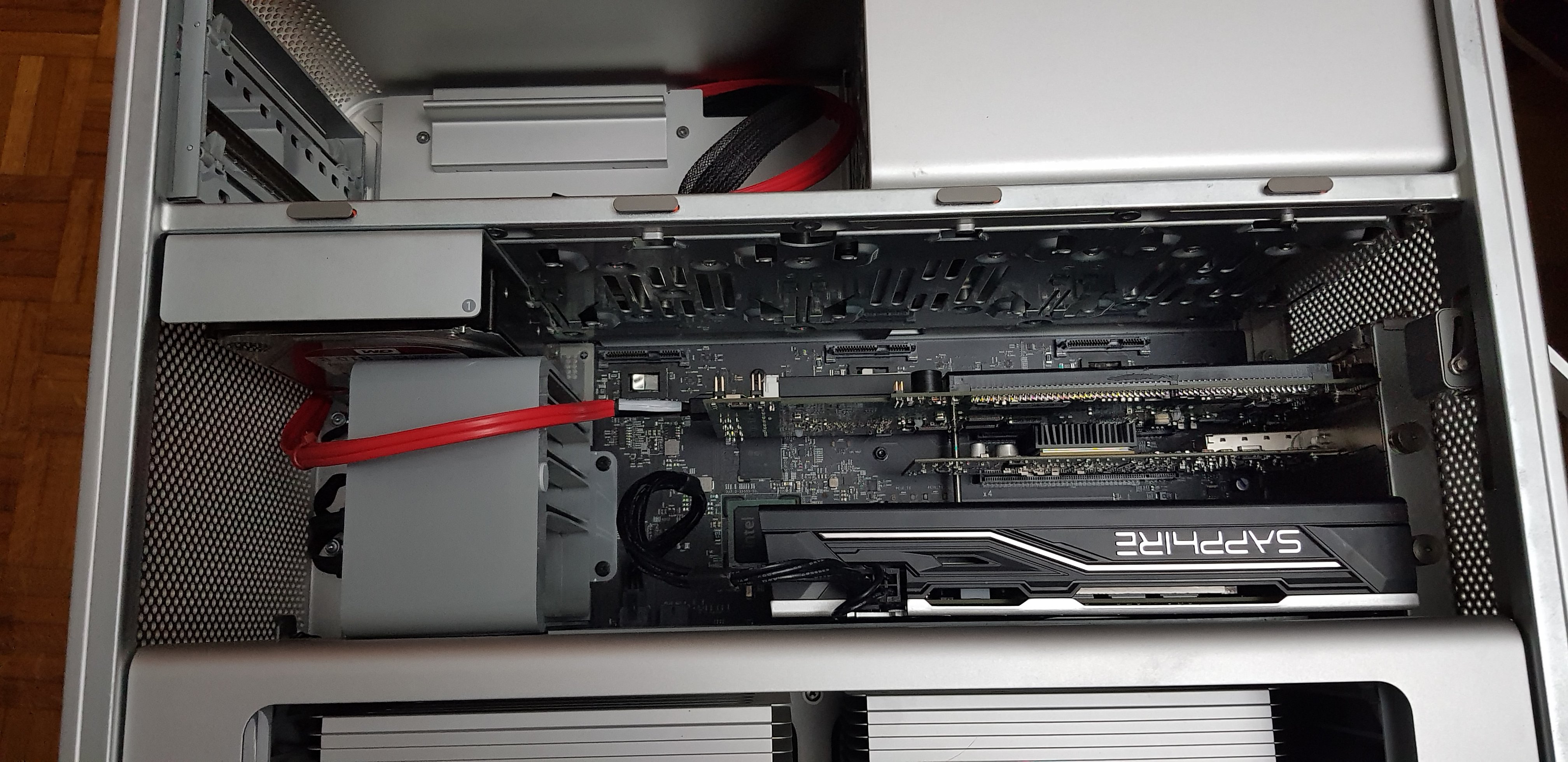

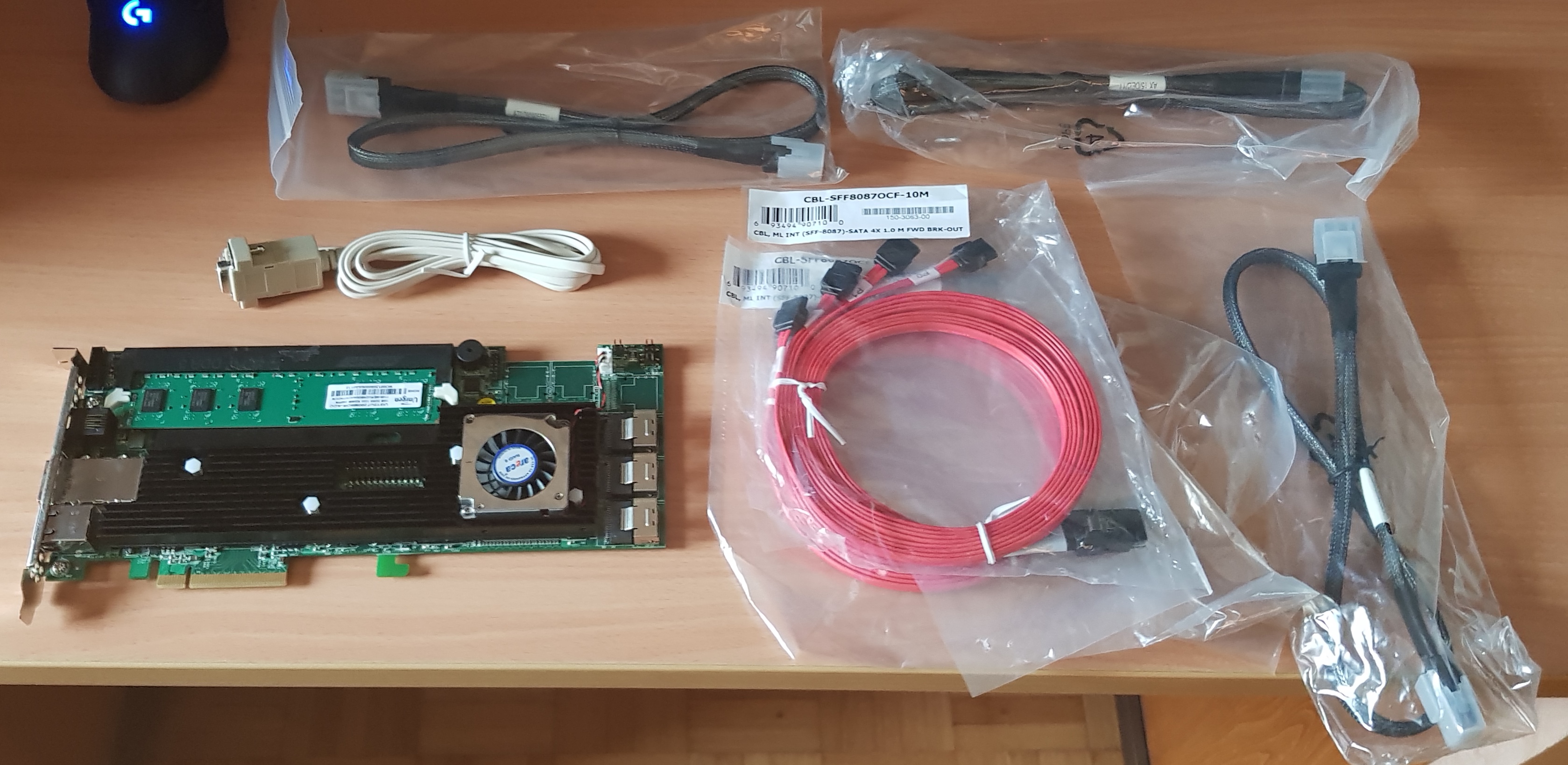

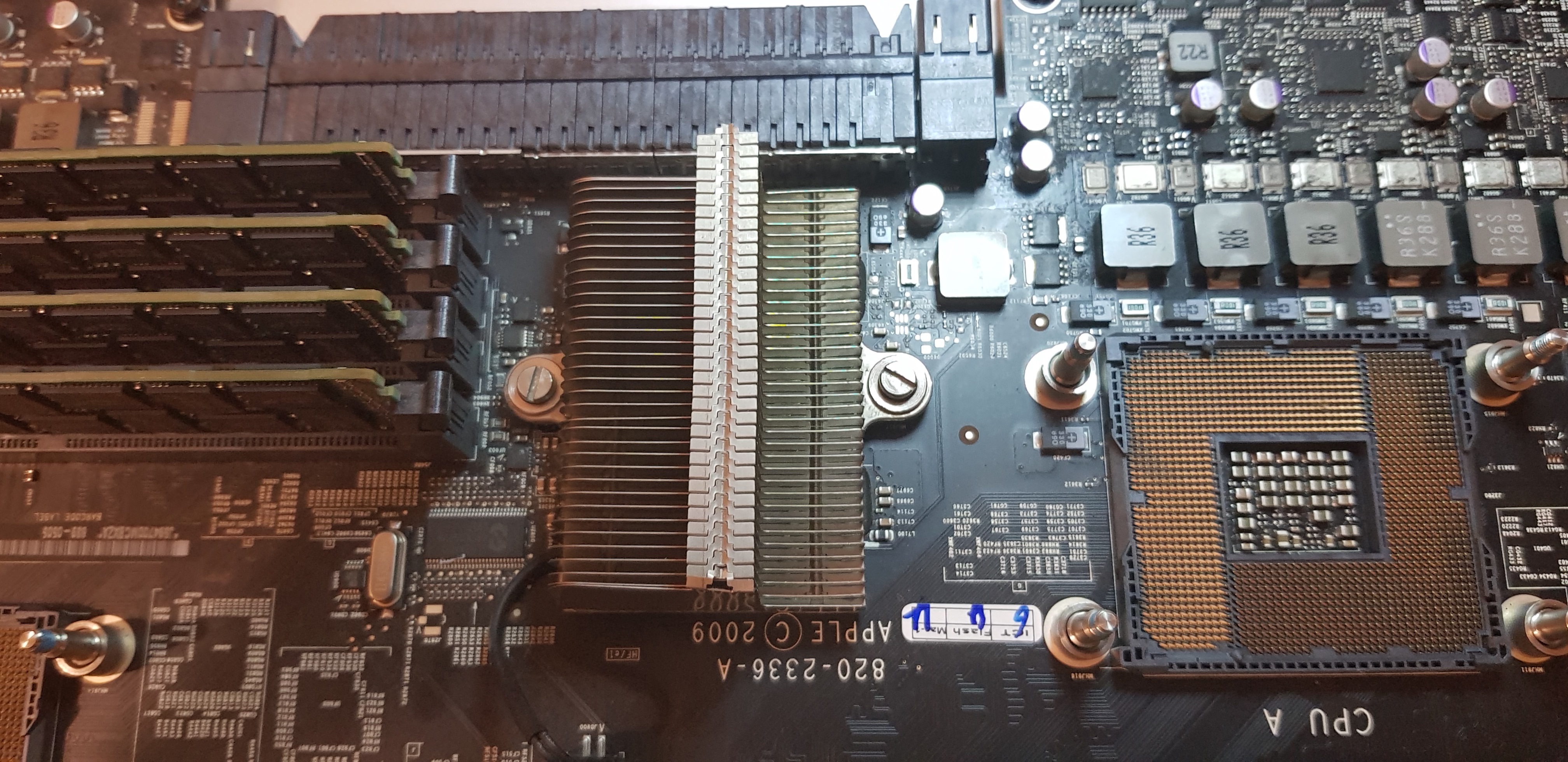

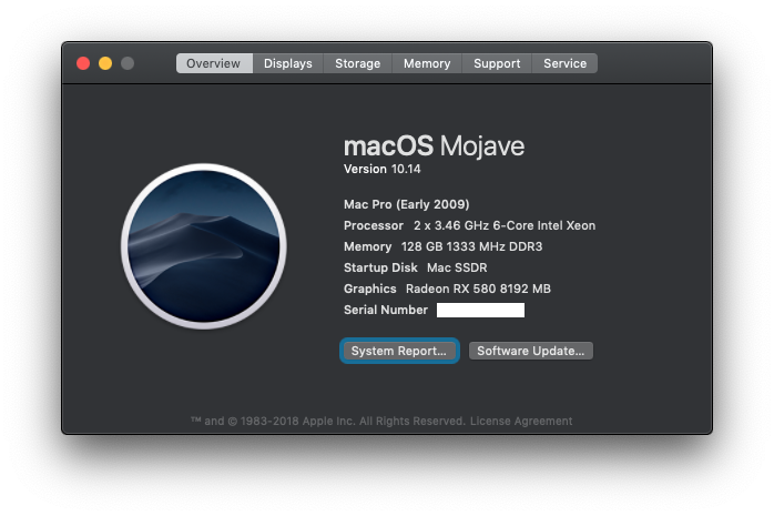

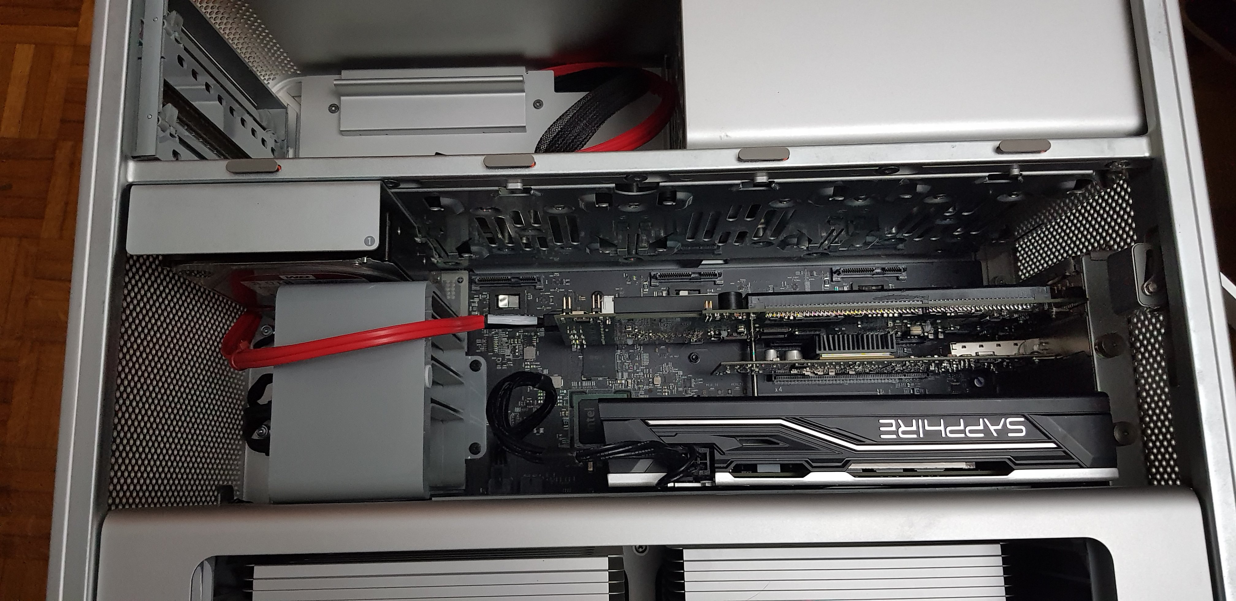

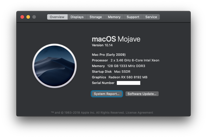

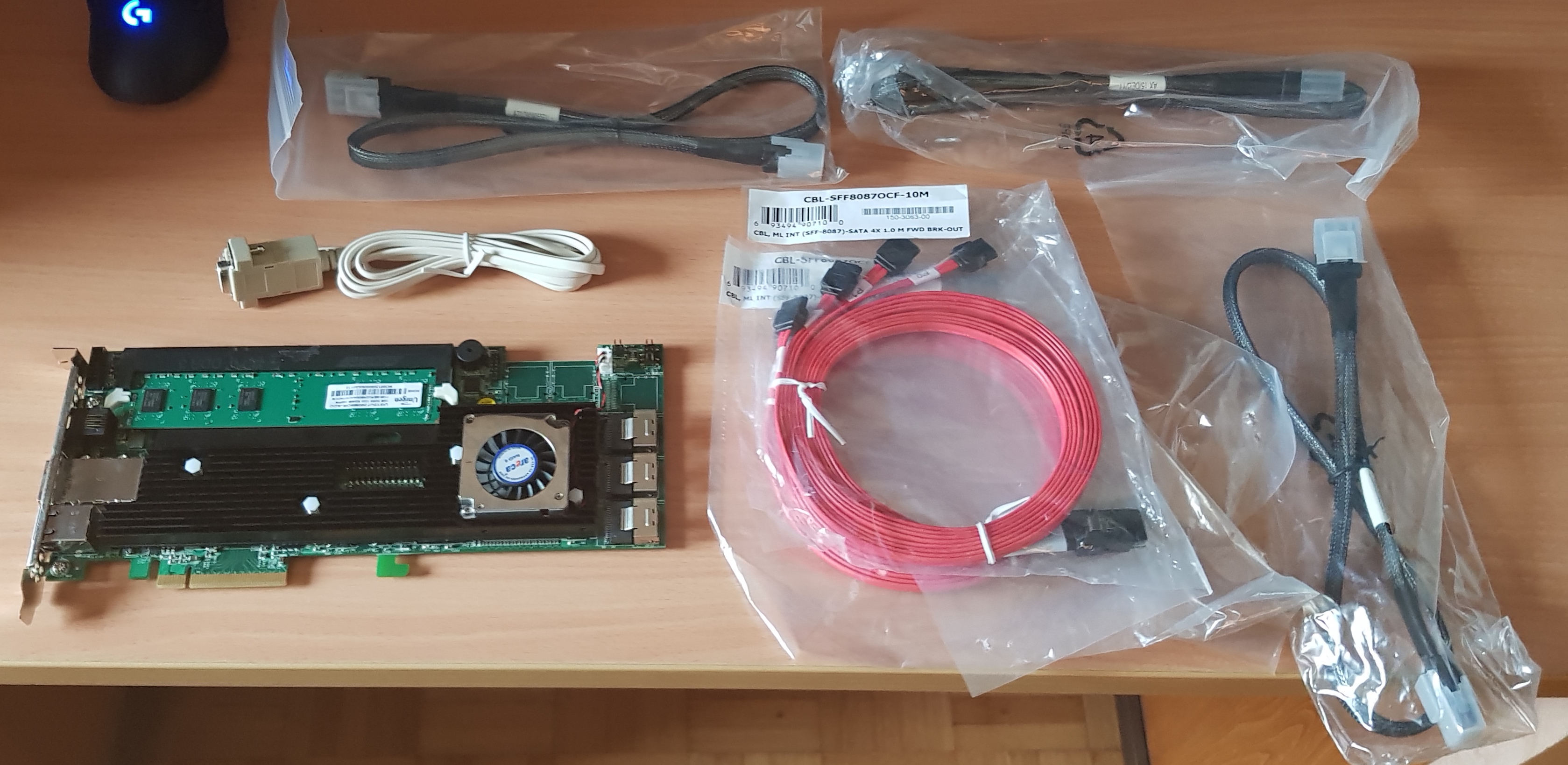

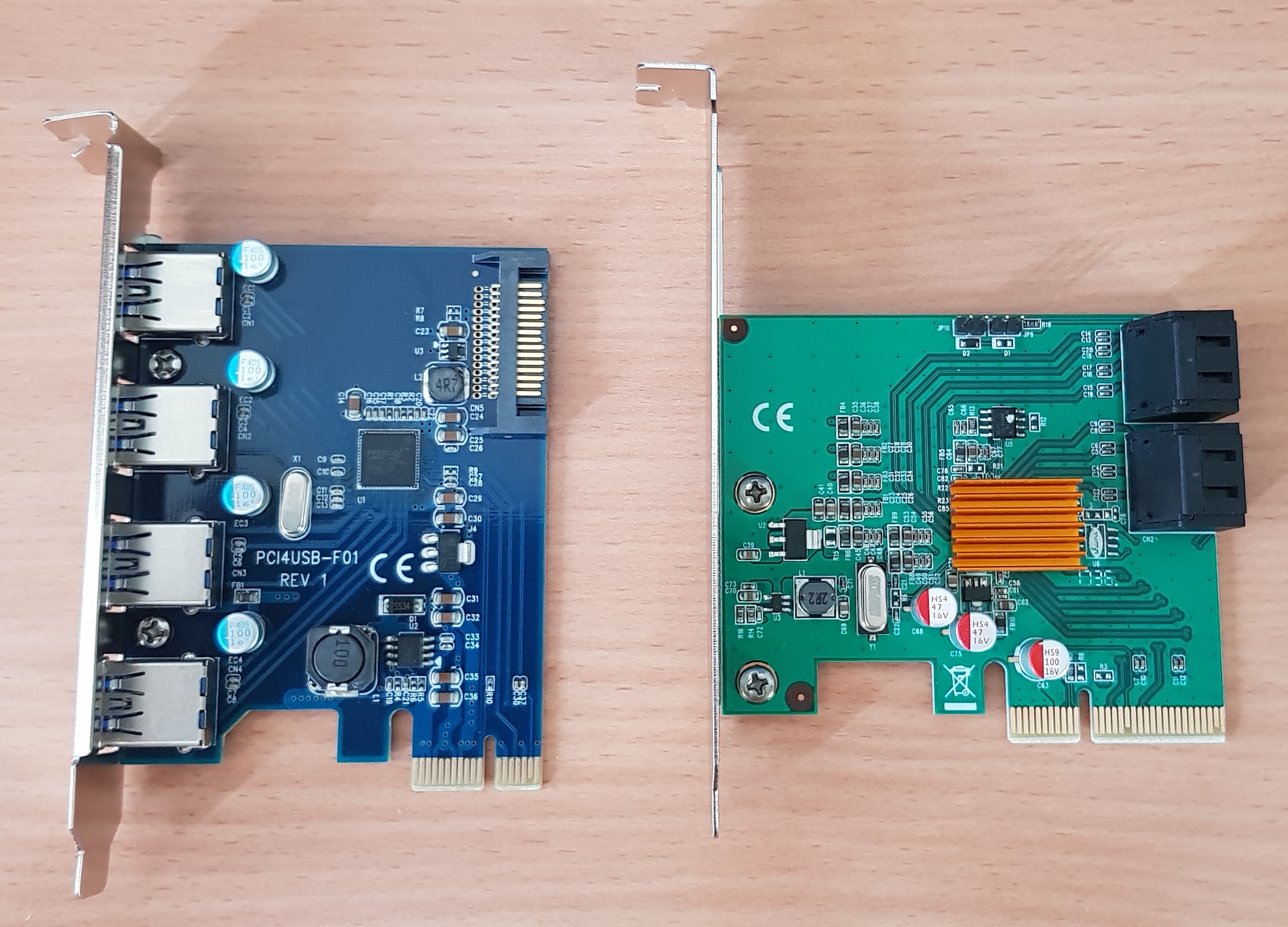

This is my current Mac Pro configuration:
Mac Pro (8c) 4.1 -> 5.1
CPU: 2x 3.46GHz
RAM: 128GB DDR3 ECC (8x 16GB Micron MT36KSF2G72PZ-1G6P1KF)
GPU: Sapphire Radeon RX 580 Pulse 8GB
Boot Drive: 2x Samsung EVO 860 250GB in RAID0 (saving PCIe slots)

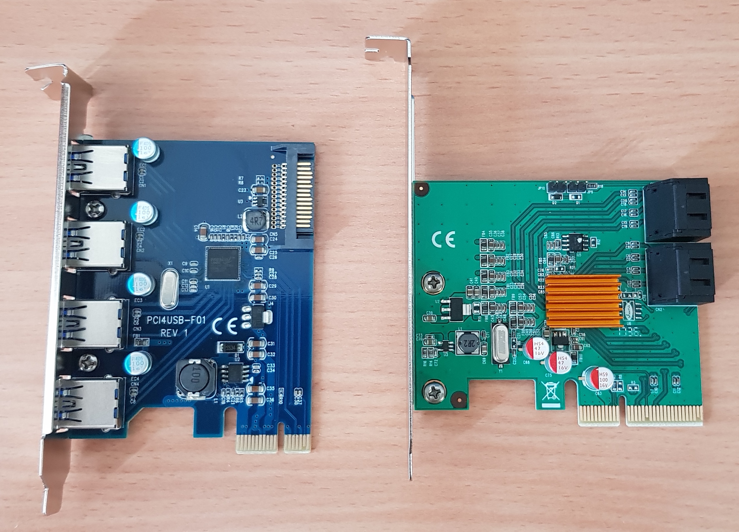

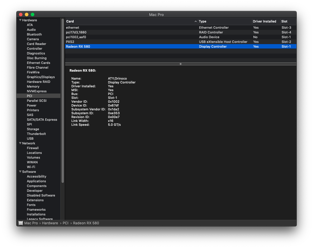

PCIe Cards: (tested)
Areca ARC-1882ix-12 (EFI Bootable)
Chelsio N320E 10GbE connected via Direct Attach Twinax Cable to NAS
Marvell 88SE9230 4-port AHCI controller (EFI Bootable)
ASM1142 USB-C card
Fresco Logic FL1100 4-port USB 3.0 card

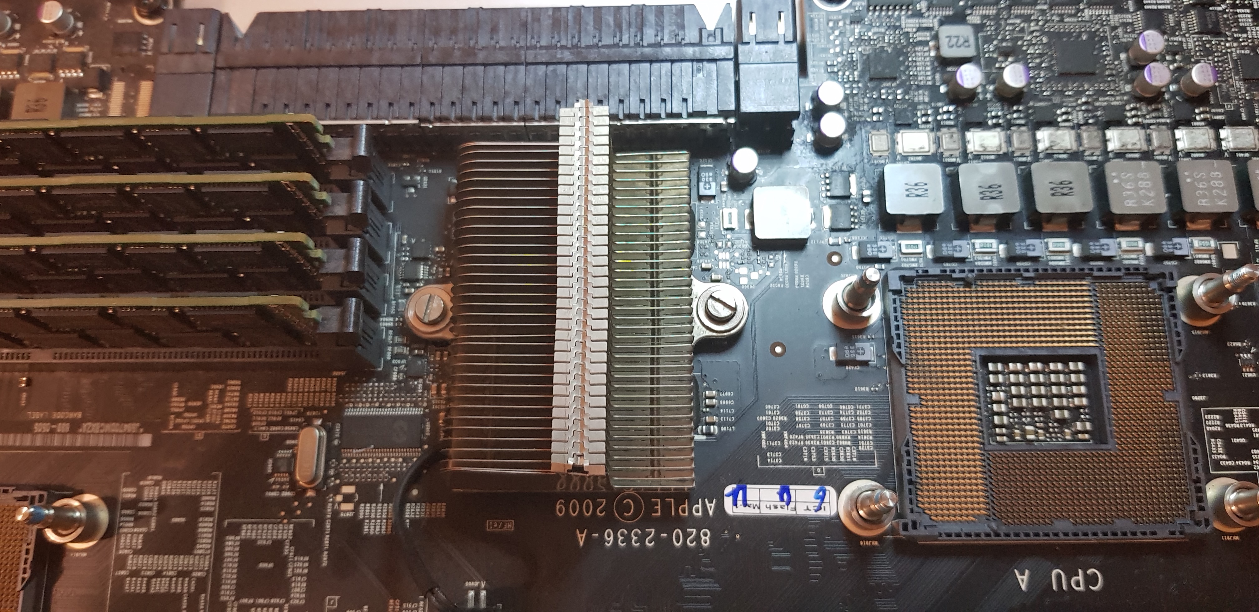

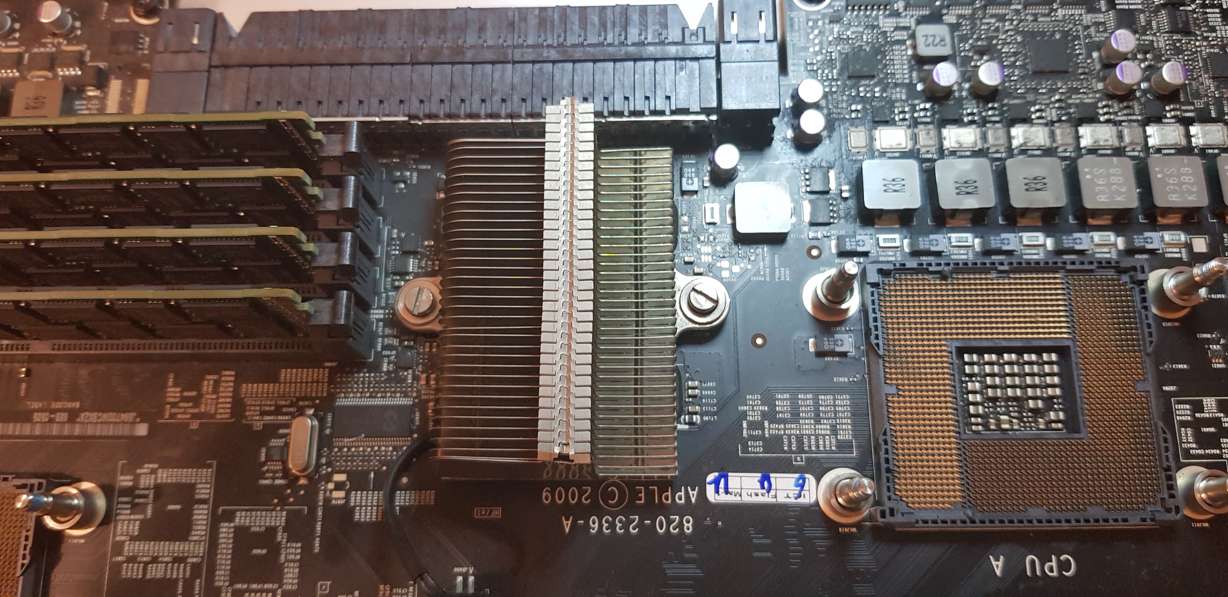

*Replaced plastic chipset rivets with screws
