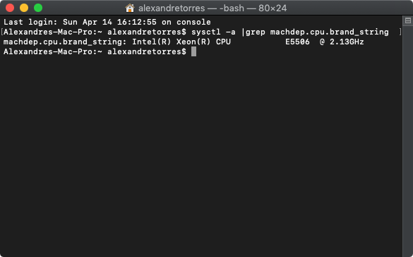

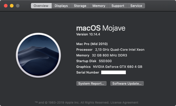

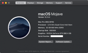

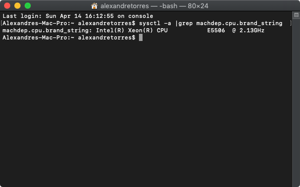

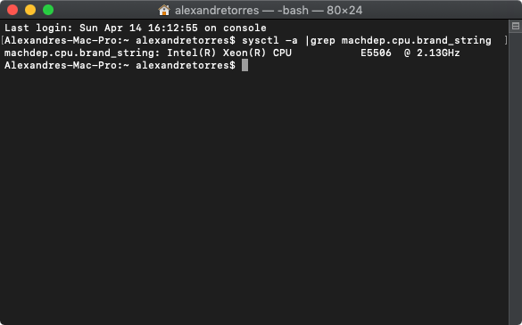

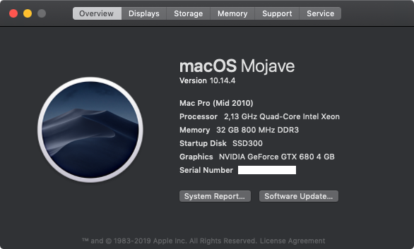

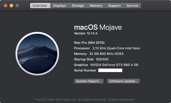

Slowest MP5,1 "upgrade" to date?
It's so slow to start POST that I thought that I bricked my MP5,1.
Note: I did this insane processor change to try to more easily find the 10.14.4 audio stuttering problem.
[doublepost=1555271004][/doublepost]It's this one: https://ark.intel.com/content/www/u...06-4m-cache-2-13-ghz-4-80-gt-s-intel-qpi.html
