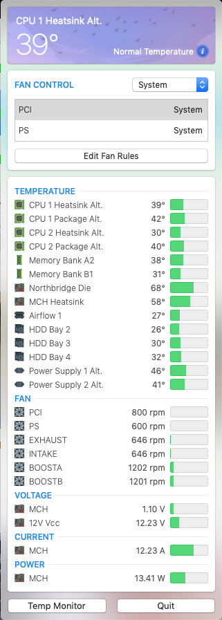

Northbridge temps are stable during light use (65C-75C). When the fans go into overdrive during video transcoding operations, the "Northbridge Die" temps actually plummet to ~40C.

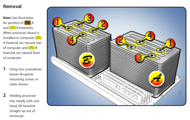

Aren't they called CPU A and CPU B normally (and by Apple too)?
What is the software used in above screenshots? It's calling those CPU 1 & 2, and all this is a little bit confusing now because of that. What do they correspond to? If A=1 and B=2 then the temperatures are the opposite from most other users experiences and measurements.

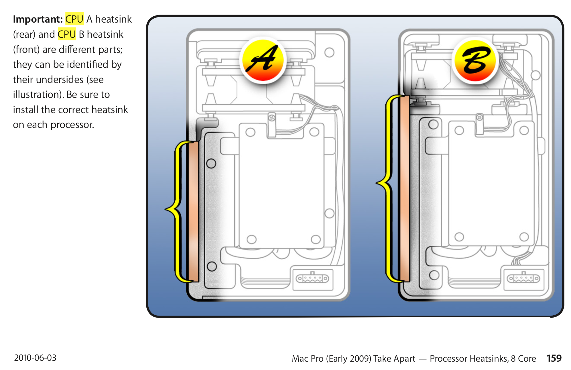

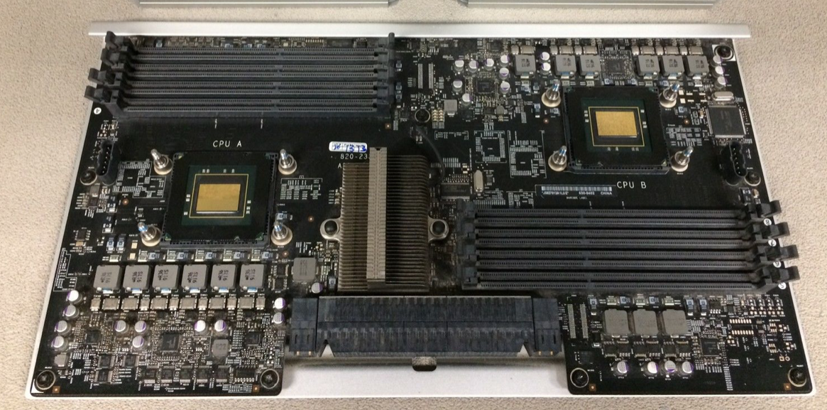

CPU A gets hot air from ram sticks installed in the front of it and from north bridge at the middle of the board, in front of CPU A, and it gets a little bit hot from CPU B too because of their placement in there (see pic). So the board installed in it's place inside the Mac Pro, CPU B is the one in front of the machine, and CPU A is at the rear side of the case.
Please see pics.
Reactions: zoltm

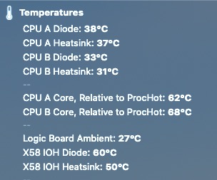

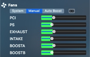

dual X5690 + 6 x 16GB RAM
coldboot:
after 30 min idle (manual fans!):
fan setting:

I think it's the opposite way (A versus B). Please see pics in post #190 .
Reactions: tsialex
You are right, had to open my dual CPU Mac Pro to confirm it. CPU B is the one nearer the front of the case, my idea of how CPU B is warmer was totally wrong.
