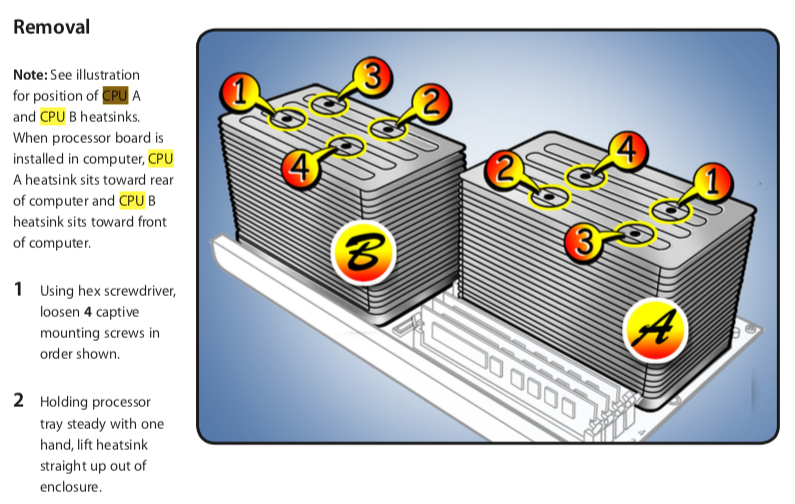

One can remember:
The CPU on a Single CPU Board is more in rear position
on a Dual Board the 2nd CPU is near the front of the case.
I do not think of delta CPU A - CPU B
I think of the deltas between diode and heatsink, the OP had a larger delta of diode and heatsink on one of the Xeons.
Maybe because of a too high Rth caused by bad thermal contact between CPU die and heatsink

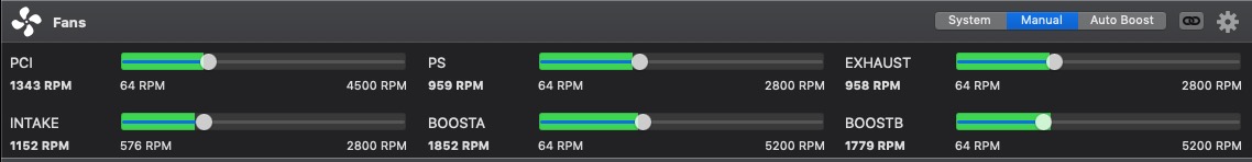

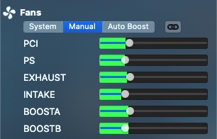

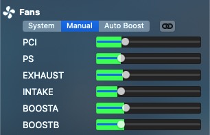

this is TGpro (50% off now)
and i have set the fans manually to assume a low temperature when used and therefore the computer gets into temperature problems much later or not at all.
this has also proved to be a good solution for room temperatures of 35 degrees and more in summer.

One can remember:
Yes, I see this now.
I've played with my fan speeds and I cannot narrow that 10C gap.
Since my CPUs are delidded (No spellcheck! Not "deluded"!) I'll try tightening the CPU B heatsink 1/8th of a turn or so on each screw. If that doesn't help, I'll re-apply the thermal paste. I still have some from the kit I used to upgrade the CPUs last summer. How long does that stuff keep? Does it go bad after its been opened?
Sound like a plan? Or is this much ado about nothing?

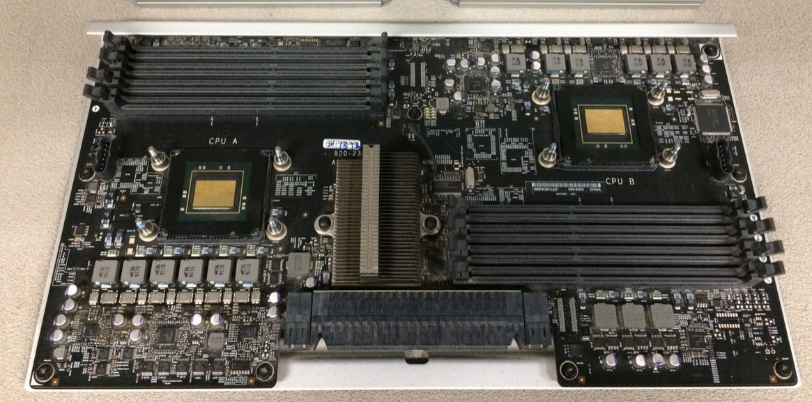

Aren't they called CPU A and CPU B normally (and by Apple too)?
What is the software used in above screenshots? It's calling those CPU 1 & 2, and all this is a little bit confusing now because of that. What do they correspond to? If A=1 and B=2 then the temperatures are the opposite from most other users experiences and measurements.
CPU A gets hot air from ram sticks installed in the front of it and from north bridge at the middle of the board, in front of CPU A, and it gets a little bit hot from CPU B too because of their placement in there (see pic). So the board installed in it's place inside the Mac Pro, CPU B is the one in front of the machine, and CPU A is at the rear side of the case.
Please see pics.
Remove the black plastic retainer.

For self delidded CPU, the silicon seal residual may lift the plastic retainer a bit, which increase the gap between the die and the heatsink, significantly decrease the cooling performance (heat cannot transfer to the heatsink. That's why there is a large temperature difference between you CPU diode and heatsink)
