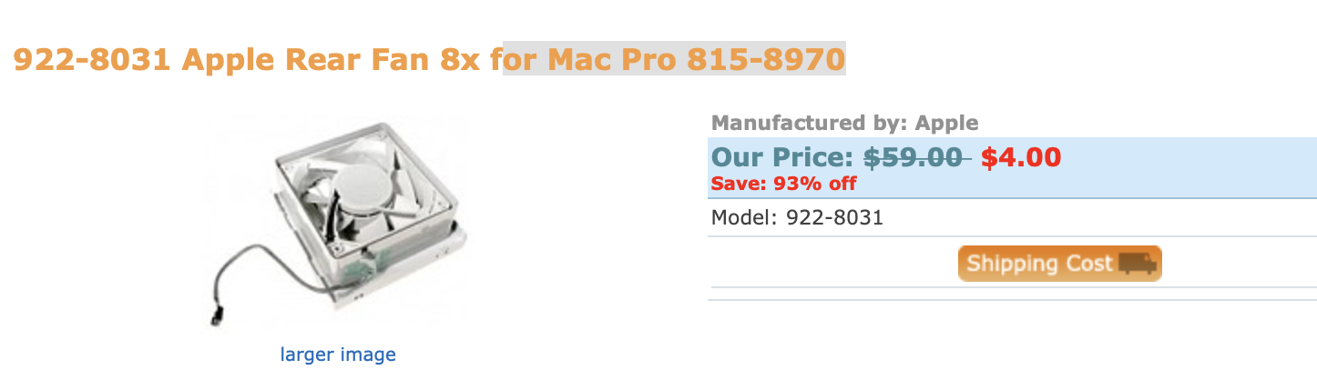

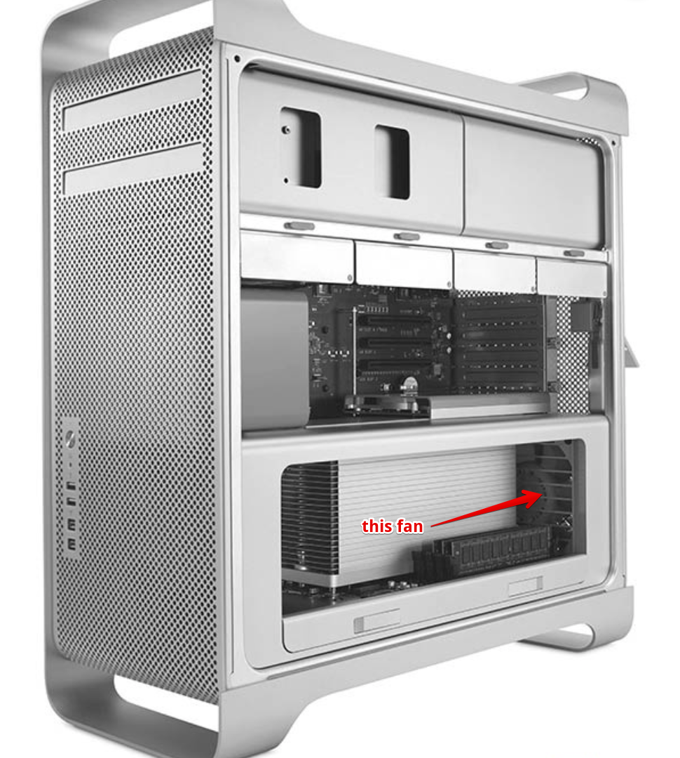

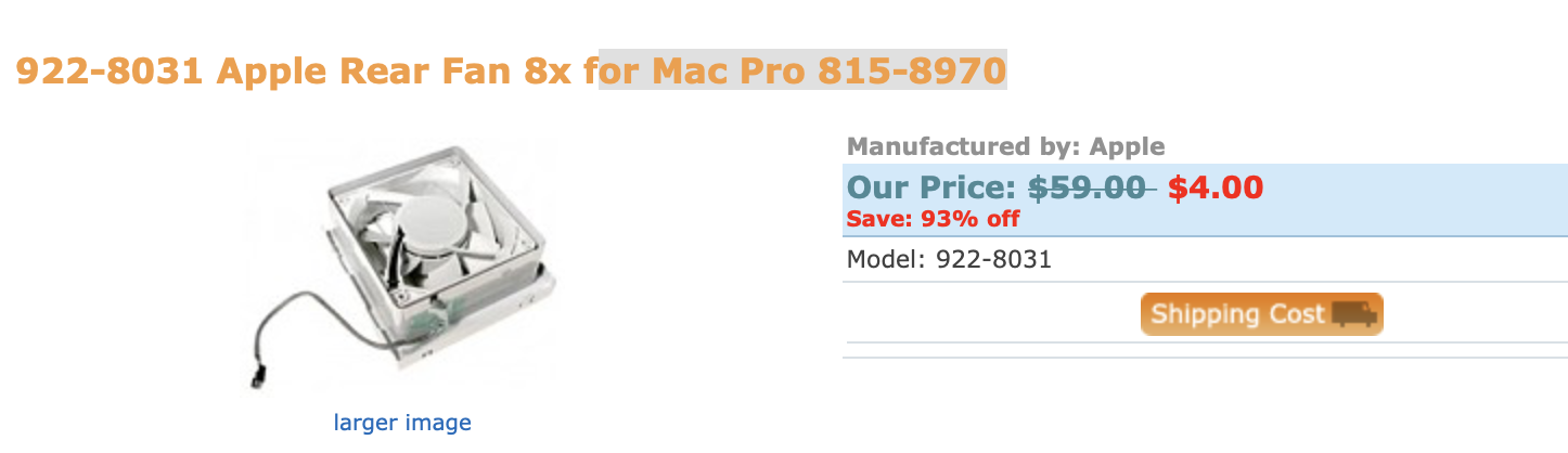

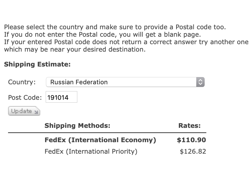

guys. the fan began to rustle (knock). showed in the picture what. What is it called to find and buy it? Or are there non-original fans that are suitable?
and I can not find instructions on how to remove it. I will be very grateful
wrote here so as not to create a new topic. fan replacement is also an upgrade Снимок экрана 2019-08-28 в 9.19.52.png

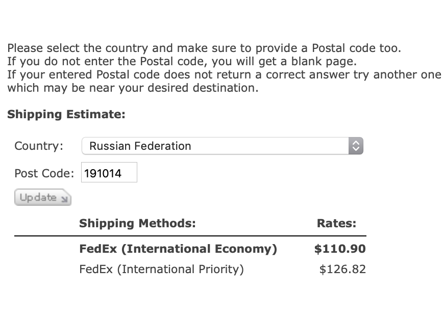

It does seem too high. I order things from time to time from Asia (to California) and it's nothing nearly as expensive as this. Usually USD$10-sh, if that. To me the high delivery charge is an indication that the seller doesn't want to do it, or a program glitch. Perhaps an inquiry to the seller, and a follow-on question if needed: is there another local supplier that can be recommended?
dustwashere
macrumors member
May 27, 2019
59
6
Russia
Yes, that is a tad over the top, sorry but I hadn't checked that.
Bet they don't sell a lot of fans internationally.
the main thing is that you gave the part number
[doublepost=1567060481][/doublepost]
I did not find on Aliexpress (this is Asia), of course, there it is much cheaper. but I'm not sure that I can remove the fan normally (without damaging the clips for the fan) in order to put the original one in the same place. therefore I am looking at ebay (or in stores in the US) original fans

guys. maybe someone changed the fans to non-original ones and knows the required size (both the name of the company and the fan model with the correct pin so that the fan speed is read in the system) I saw a video somewhere on YouTube, but I can’t find it. maybe someone here has experience or a link to a discussion about this
bsbeamer
macrumors 601
Sep 19, 2012
4,313
2,713
You may find this thread helpful and the video linked on the first page:
https://forums.macrumors.com/threads/mac-pro-5-1-replace-fans.2102852/

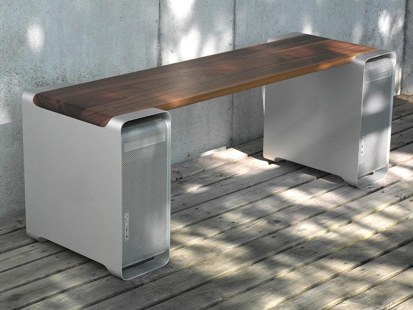

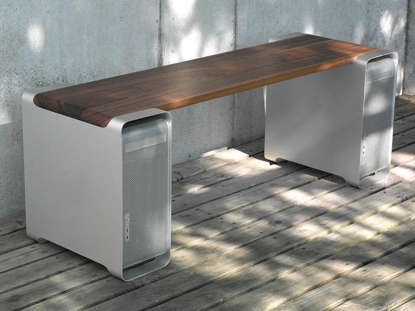

My question is more of a classic MacPro 4,1 or 5,1 mod. Has anyone posted photos of building other things with just the case of a cMP? We could do Hackintosh mod box for maybe an uninterruptible power supply, or a huge case for just a whole case RAID of HDD, a server box, air filter, a network router or something but the external case seems to be too gorgeous for me to be the only one we could rewire or lightly cut the internals to suit an alternate need.
Quite a few on the net, you can even find table / chair build by the cMP case.
Anyway, why this related cMP "upgrade"?
