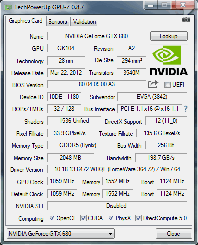

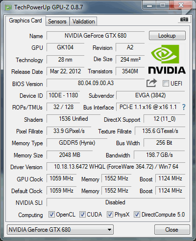

Alright, I was finally able to score an EVGA GTX 680 2GB card. Part# is 02G-P4-2680-KR. I am running it on the Bootcamp side right now and the only thing that looks odd is the reported PCI-e bus (1.1 instead of 2.0). Speed is x16 so at least that is correct. Shouldn't it be PCI-e 2.0 on a Mac Pro 2009 (hacked to 5,1)? I do have it in slot 1.
Looks like my FreeDOS USB stick is not bootable on this Mac (I know, not firmware supported) so I will be flashing under Windows 7 64bit. Feels more risky but I know many have had success this way.
Okay to use the latest NVFlash tool for Windows though?
You won't get PCI-e 2.0 in Windows until after it is flashed. That's one of the benefits of flashing.
Others have reported that the latest NVFlash doesn't work. (Doesn't hurt, but doesn't work either.) See just a few posts up in the thread.
