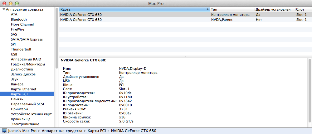

I confirm
EVGA GeForce GTX 680 SuperClocked SIGNATURE == 02G-P4-2683-KR ==
Work fine.
