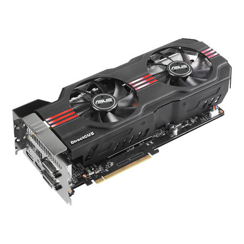

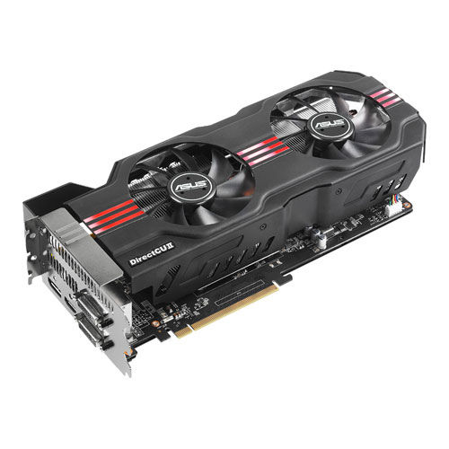

Asus gtx680-dc2o-2gd5
Has anyone had success using an ASUS GTX680-DC2O-2GD5 in a MacPro 3,1? I know there was someone who tried it, but it was not too clear if he got the card working or started using another card. I know it has a 6 and an 8 pin connectors. I was thinking of using two 6pin to 6pin contectors off the motherboard to power it.
Is this card flashable or are there isues with this card?
I can get my hands on one for cheap so i have to know!
Thanks
