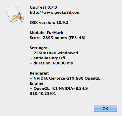

I also ran Furmark in OSX using the same settings that pastrychief used and pulled a score over 2500. One thing I am going to look into is the power draw from each of the ports. Running iStat, I noticed that the power draw appeared to be uneven across the PCIe slot and the two PCIe BoostA and BoostB connections. I did use two SATA power ports to convert to one 6pin Molex, but unfortunately I was not able to see the power draw off those connection points.

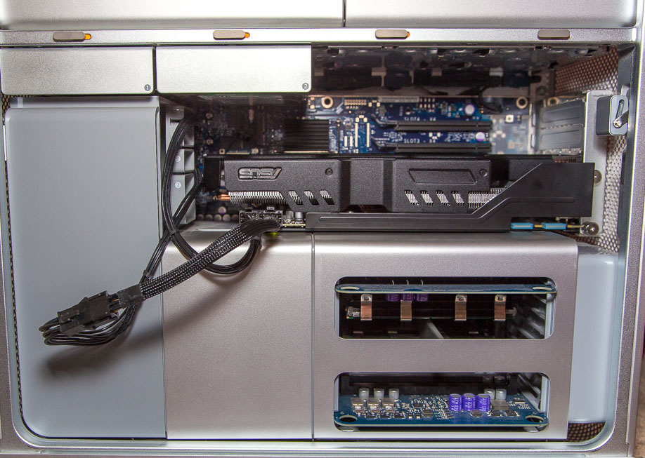

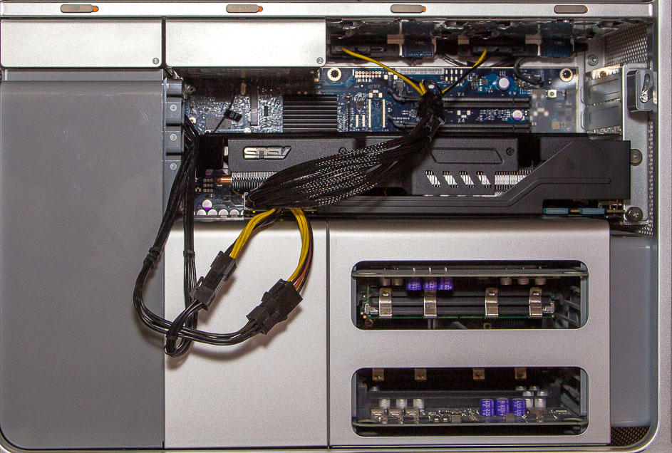

To be clear how I powered the card:
- One 6 to 6 pin cord from the MB connector to a 6 to 8 pin adapter and to the 8 pin connector on the gfx card.
- One 6 to 6 pin cord from the second MB connector to the GFX cards 6 pin connector.

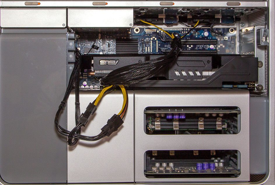

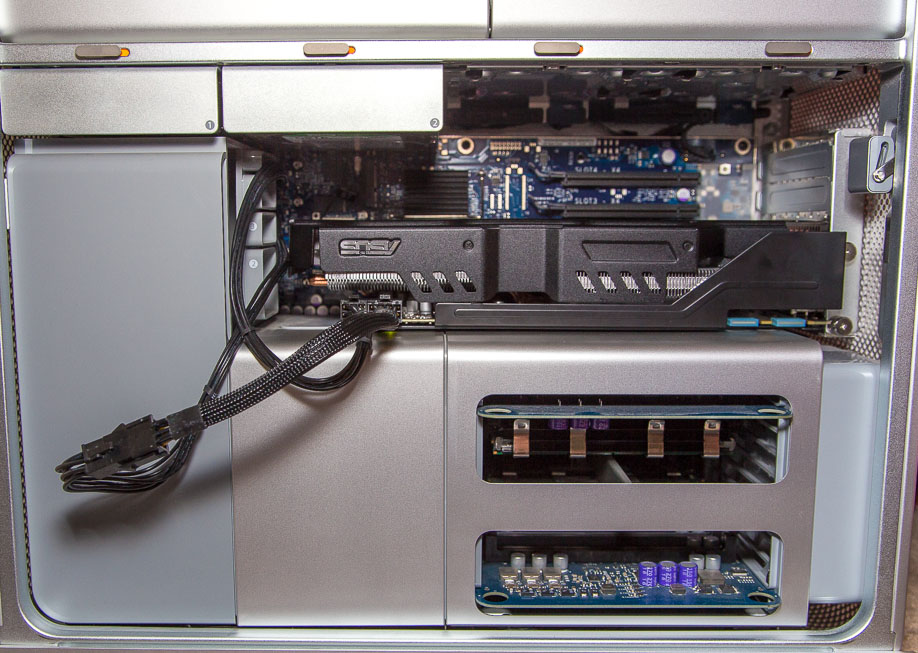

ASUS GTX680-DC2O-2GD5 Tests
So, I decided to run a few tests just out of curiosity using Furmark. I thought I would share my findings with you for reference. This test is using an ASUS GTX680-DC2O-2GD5 flashed with the EVGA GTX680 Mac rom image.
Test 1: (2x) SATA power to 6-pin molex to 6-pin card connection. Both 6-pin molex of the motherboard powered the 8-pin connection using an adaptor.
This test showed a total power draw of 52.80+52.12 = 104.92W under load on the 8 pin connection. The one thing that I noticed was that this configuration pulled power extremely even across both PCIe Slot Boost ports as you can see from the attached power readings (I also ran the Unigine Heaven benchmark in this configuration on extreme and it followed this theory as well - ~42.44+41.97=84.41W).
Total power draw minus the SATA power was 133.73W. I would estimate the power drawn from the two SATA power connections was ~ a combined 50W.
Test 2: 6-pin molex to 6-pin molex card and 6-pin molex to 8-pin molex using the adaptor.
This test showed a total power draw of 101.75W from the 8-pin connection. This is ~136% of max designed power draw from this connection. Total power consumption for the card was ~183W.
