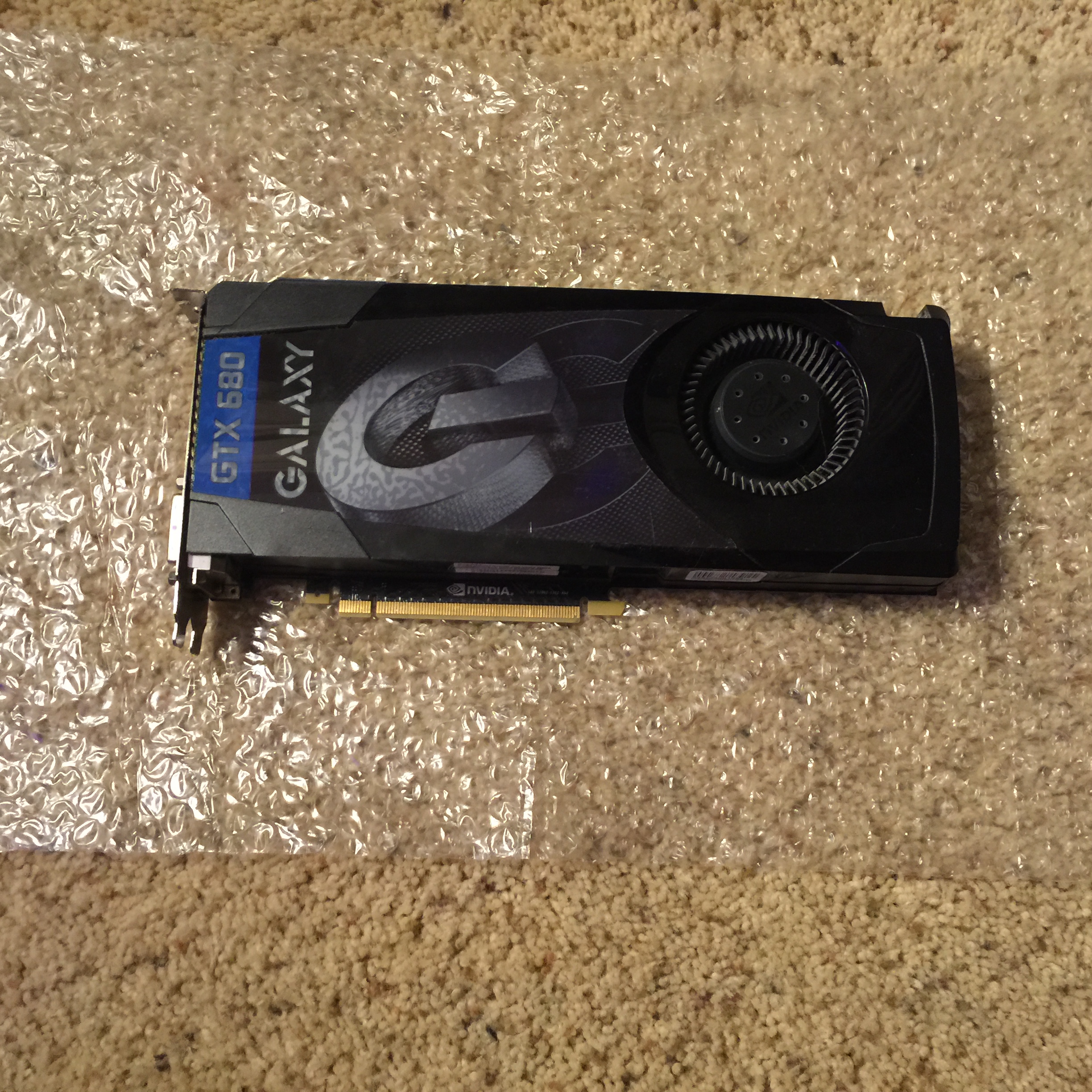

I just got a used 2009 Mac pro, and I have the Galaxy 68NPH6DV5ZGV GTX 680 from my old build... Has it been CONFIRMED that this thing can be flashed over? I on't know whether or not to try and flash it (possible brick?) or just sell it and purchase a pre-flashed one off of ebay. :/
Well, I went ahead and tried flashing it (after backing up the original rom) and had no issues after overriding the board ID mismatch. Booting in a windows machine functioned fine, and gpu-z showed it as an EVGA card. The cables I need to actually power the GPU in my mac is coming today via mail. I'll update on how it goes.
It will work, this is the exact card I flashed and it works great in my 2010 Mac Pro
