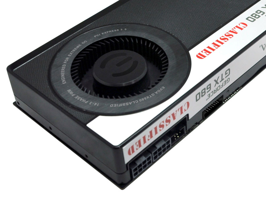

Is this card flashable or are there isues with this card?
You probably want to read this link before buying this card for flashing, especially pay attention to the following quote:
Further to the right we find EVGA’s BIOS selection switch, which has 3 states: Normal, OC, and LN2. The latter 2 BIOSes are in fact identical and exist to disable the card’s power target to enable extreme overclocking.
If I'm not mistaken, this card is not compatible with the reference design with 3 different BIOS states, and has a default power target of 250W-330W with 2 8-pin connectors. If you are still interested after considering all the potential risks, be sure to use the 4GB ROM from another thread.

I vaguely remember one or two people trying the GTX 680 Classified over in the 4GB thread, but this post was all I could dig up. I cannot find Durex's post-flash report of success or failure.
I only looked for a minute or two. You might want to do a more thorough search yourself, or better yet just PM him.
