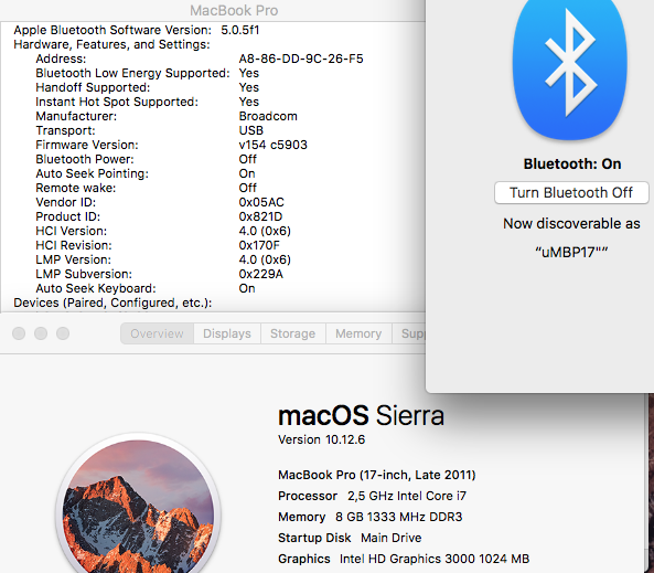

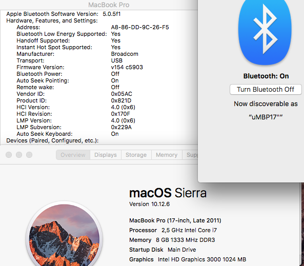

Got it to work on my late 2011 MBP 17".
1, Replaced original wifi/BT card with BCM94331PCIEBT4CAX
2, Disabled SIP (actually had it disabled since before)
3, Ran CAT beta iaw the readme file **
4, Admired what I've just done
**After first replacing the card and booting I didn't have any active AirPort card iaw CAT pre-diagnostics (and menu bar WIFI didn't recognize any WIFI at all)
Took it all apart and discovered that the -CAX card and the AirPort connector wasn't seated propely. Gave it a little push/squeeze from both sides of the hole AirPort module and felt a distinct snap/click and realized that the card now was seated/connected properly.
Satified, I reassmbled it all, and re-ran the CAT with success! 🙂
See attached snap for "proof"
