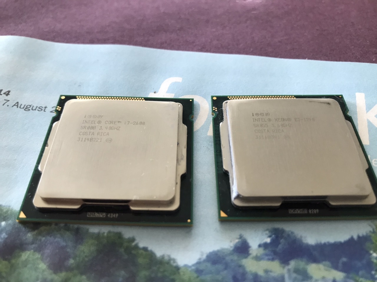

I just went through a Xeon install in my 2011 iMac.
Few notes:
  1. I used the 1240, which does not have the iGPU and it works great. Multi-core performance is up 30% from my old i5 2500s
  2. I used a chip that does not have the igpu. So that should open up everything from the 1230 on up to the 1290 for usage in a 2011 imac.
  3. I am running into the sleep bug that impacts Sandy Bridge chips because of their HD3000 igpu... but my chip doesn't have an igpu!
  4. Outside of the sleep bug (I just have my computer turn off every day) the performance is fantastic going to a cheaper alternative to the i7 2600.
Re-flash the original firmware, I had similar results when swapping Microcode for Core 2 quad
