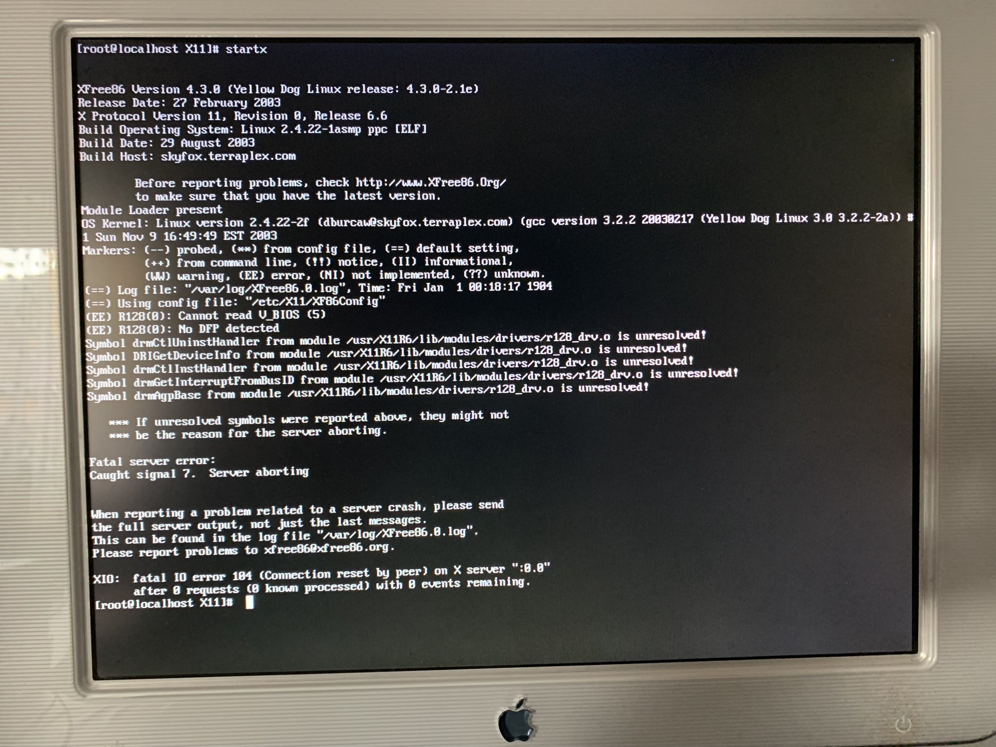

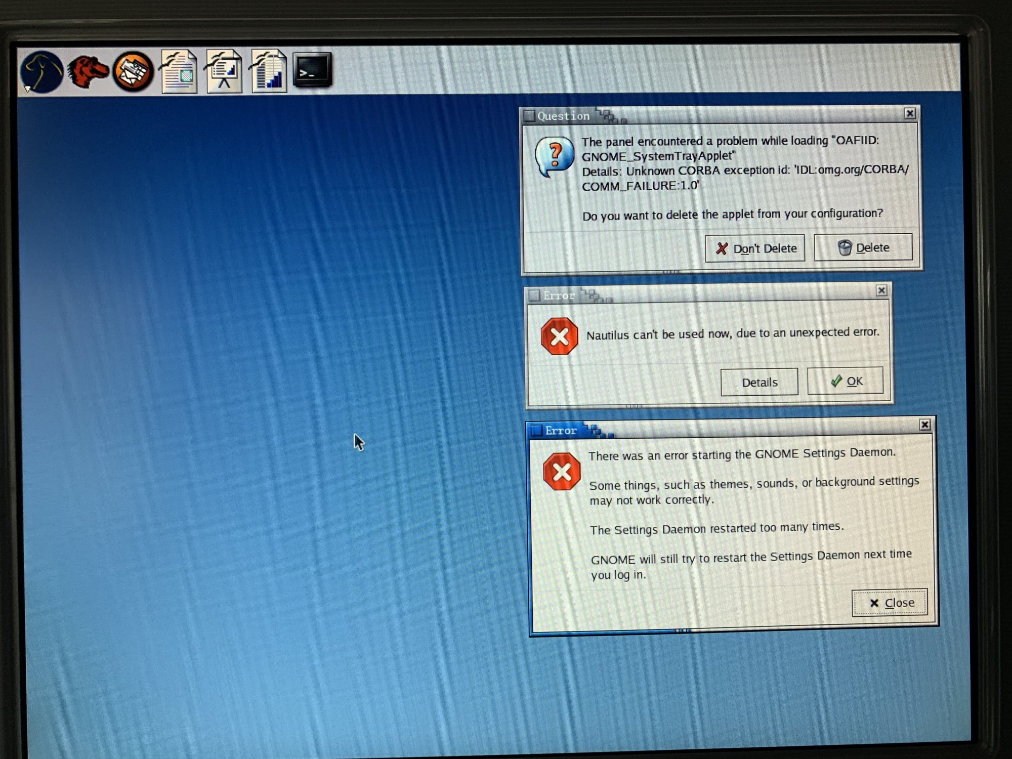

Because YDL3 is driving me nut's with many different errors no 3D-acc and nautilus error, I will try to install debian sarge 3.1 on my cube. hopefully it will work with my existing OS9.0.4 and OSX 10.2.x installation. Currently I have multiboot in YDL3 with yaboot, but I think I have to switch to grub. Can grub start OS9/OSX as well as yaboot does?
Thx!
Thx!
Hey man, why would you install a super old version of Debian?
You can install the latest Debian using the Sid branch.
I like it fast and slim...newer linux tend to suckup the performance and the kernel will most likely not support R128pro and USB-Audio anymore...or am I wrong here?
