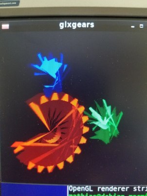

I installed with success Debian sid (2022-03-28 snapshot) on Mac Mini with no problem, with Mate.
The desktop was really slow, I had to disable compositing in System/Preferences/Appearance/Windows.
The Xorg log mentions "Acceleration enabled" but then also "AIGLX error: dlopen of /usr/lib/powerpc-linux-gnu/dri/r200_dri.so failed". r200 support was dropped in Mesa 22 and the current Mesa version in Debian sid is ... 22.0.2! :-(
Do you know if there is a solution? I had a look to see if it was possible to downgrade to version 21 but it seems that no other version is available in the package repository.

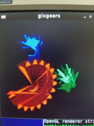

So, to share my results: I have now hardware acceleration enabled (drivers, Xorg) but with glxinfo, the OpenGL renderer string is "llvmpipe" under Mate, while it is "Mesa DRI R200 (RV280 5692) DRI2" under LXDE ... How is it possible to have the renderer depending on the desktop?
Note that as usual, that does not fully work. glxgears rendering is corrupted:
I don't know what could be the reason: a package that I missed to downgrade, the MESA version that is no the best, an Xorg option that is wrong ...

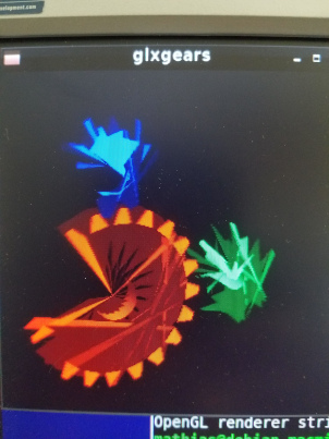

@rkmugen.linux It seems that you MAC model is not really Linux friendly :-(
@borph Thank you so much! That was exactly the kind of expected answer. I didn't even know if these packages were kept for sid and where.
Did you also do that on a MacMini?
