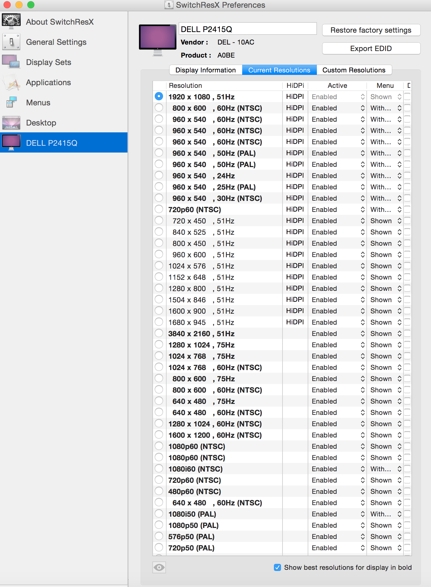

I received a P2715Q yesterday to be used with my rMBP 13". The 1080p mode (@51Mhz) looks nice but I was really after the scaled 1440p mode which OSX will not let me choose.
Do people with a 15" rMBP have this scaling option?
Could you try holding the option key while clicking "Scaled" and seeing if it comes up? As per this thread https://discussions.apple.com/thread/5485930
The scaled 1440p does not show up :mad:

I can't get swirchresx to do custom hidpi on my Samsung either. If I set the display to 52hz I get 1080p at 52hz but no other scaled resolutions.
this is what's available in hidpi for the 13" macbook pro retina...

And just for comparison, here's the same shot with my preferred 3008x1690 HiDPI desktop on the 4K display... It's just as sharp at normal viewing distances and only slightly more jagged with your nose to the screen as in this shot. This setting provides the perfect balance of sharpness, legibility, and real-estate on a 27" 4K display. YMMV.

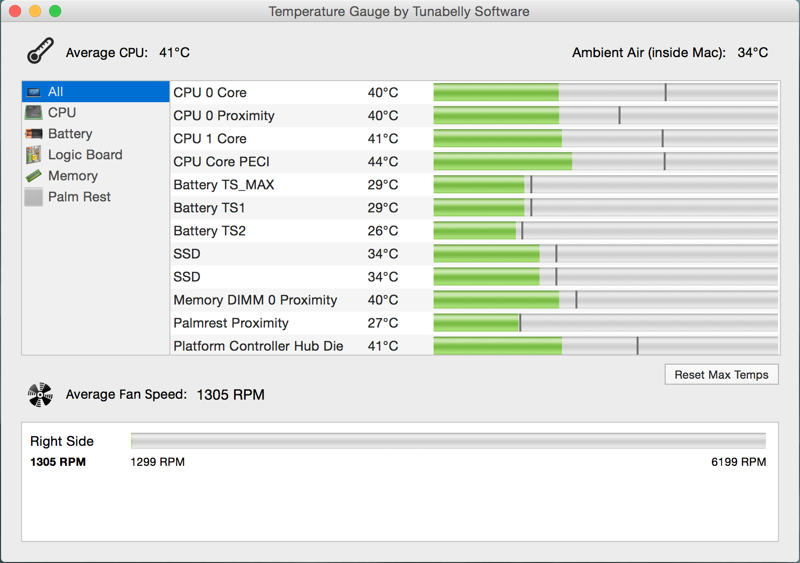

Could you tell me how stable your Macbook 13" Retina works with the Switch ResX on the DELL 2415Q and how it perfoms with 50Hz ? Any crashes ?
Does the fan work at high rpm ? / Does it make loud sounds much more then without external monitor ?

I'm not sure what revision the monitor is, I imagine it's one of the first since I've had it since the December. It runs stable, and the macbook runs about 10* C warmer when driving the display. The fans run at the lowest speed (1300) most of the time, unless I'm doing something heavily processor intensive. Overall the monitor will bring system temps up a little, but that would be expected since the SwitchResX is keeping the GPU overlocked by by about 150Hrz from what the native retina display is driven at. Response seems very similar to the native display. I purchased this display for the added size and to run it at a HiDPi setting (1080P), so for my needs it works great.
screen shot of current temps after using the monitor for an hour or so web browsing and email checking...
