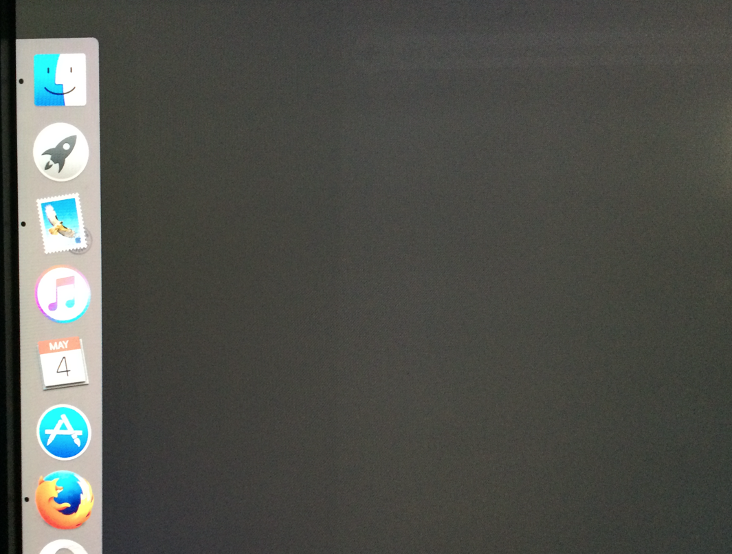

Is anyone else having 'burn in' issues with the P2715Q?
