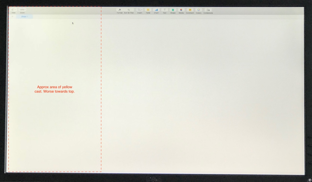

I have got my P2415Q monitor now and am happy, but not delighted with it. In most ways it is better than I expected, but screen uniformity is average with a very slight yellow tint on the left third. It is not noticeable in use unless I look for it, and sometimes I think I am imagining it. I have seen other comments about this on the P2415Q and other monitors in this price range, so I am not going to return it.
Did you buy it from Dell? Their return process is pretty great. They’ll ship you a new one before you send the old one back, and they’ll arrange for UPS to pick it up. No downtime.
I didn’t have the yellow tint, but I had faint lines in the middle of the screen. Took me a few returns to get a perfect unit. Didn’t notice yellow on any of them, just the lines.
I have decided to request a return. Here is a screenshot (unedited) of the monitor showing how a plain white page looks. What do you think?
Same issue with mine. It tried it for 3 days. Couldn't get over the difference in color profile between the dell and macbook pro, the orange whites on left side, and the matte screen looks awful compared to a glossy one. I tested the LG ultrafine 4k with my laptop in the store today, and caved and bought one. Returning the dell.
