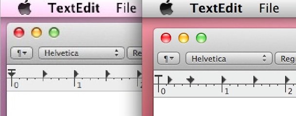

Wrong. HiDPI uses all the pixels. Here is more info: Retina Display - Wikipedia, Enable HiDPI Display Modes in Mac OS X Lion with Quartz Debug
2560x1440 scaled on my P2715Q looks better than 2560x1600 native on my old Dell 30" because of HiDPI. Not just for videos or Photoshop, for everything.

I have a question:
I own one of those "wrong" 4K 27"'monitors, and like most people I run it scaled at 1440p because that's the most sensible font size for 27" in my opinion.
When the monitor is running scaled at 1440p, does it still behave like its native 4K with respect to desktop background and photos? So, if I use a 4K photo as background, does it get rendered in 1440p?
Hope this makes sense.
I have a question:
As far as I understand it, in HiDPI mode, everything will get up sampled, then down sampled to the chosen resolution.
