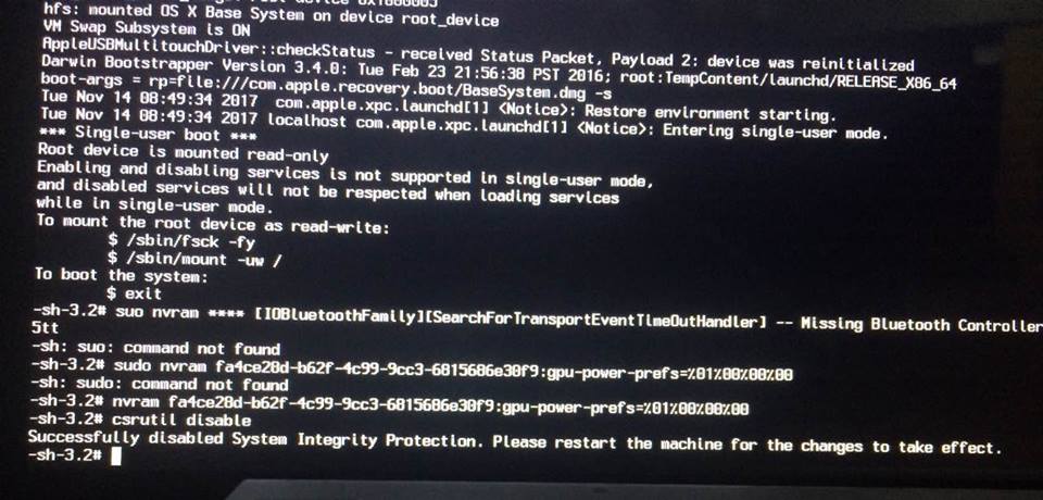

Now, I couldn't start into recovery mode to use Terminal, I tried changing the gpu-power-prefs and the disabling the SIP via Single User Recovery (CMD+S+R) instead of using rEFInd to disable the SIP I've read the steps a few times, but, the process of creating the rEFInd USB drive is too confusing to me. Maybe you have a simpler way to make one without having to go through the steps in the link, which jumps from one point to another.
It seemed to have worked, and it said that the SIP was disabled. I was able to boot into Ubuntu, took note of my UUID, but after pressing fn F10, the screen just went black, with the light on the USB drive steadily on. I waited for several minutes, but there's no activity on the drive and the MBP didn't boot as expected.
I'm not sure where I went wrong (or, maybe I didn't wait long enough), since I the SIP was disabled, and there was no error message when I changed the gpu-power-prefs setting.

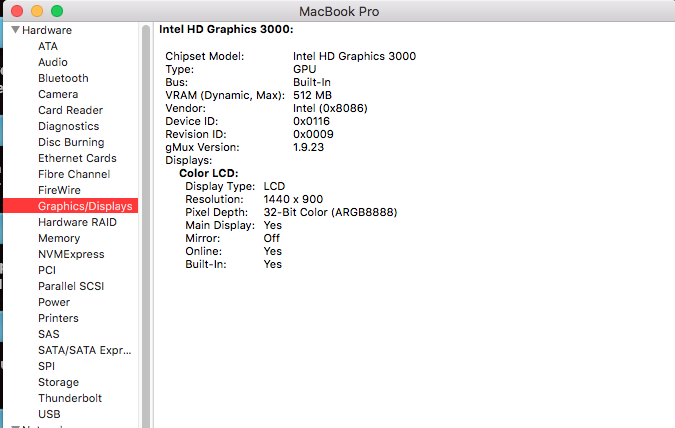

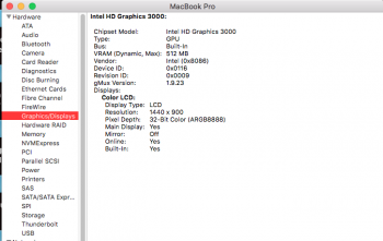

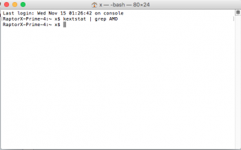

SUCCESS, in just one try after braindshutdown's most recent reply before this one!
The dGPU no longer appears in System Profile, and the kext are no longer listed with grep in Terminal. Since the MBP was crashing by just opening Facebook (and other pages), I tested it right away and Facebook loaded without a hitch (so far, I haven't opened a chat window yet, which crashed the MBP as well).

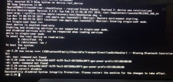

C. Disabling the SIP in Recovery Mode> Terminal wasn't working, and my brain felt like scrambled eggs after reading all the MacOS-specific material regarding rEFInd, how to create a USB disk with it, and use it to disable SIP.
But, having scoured AMF's thread and other sources, I tried booting into Single User Recovery Mode (CMD+S+R), and did steps 1 (changing the gpu-power-prefs variable) and 2 (disabling the SIP) consecutively from within SURM before rebooting. Also, you can drop "sudo" in SURM (as you can see in the screenshot).
Like I mentioned earlier, this went without a hitch.

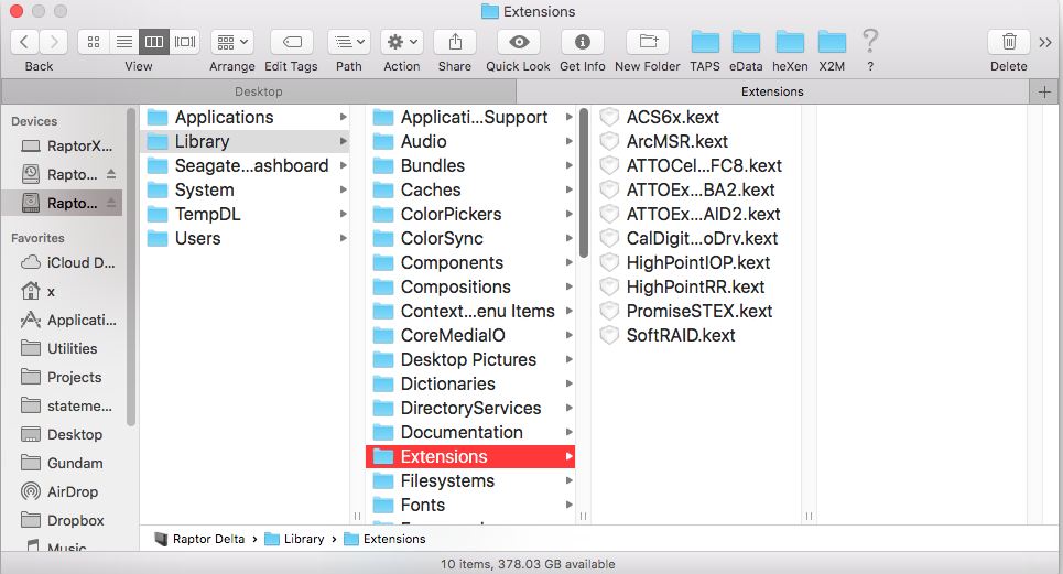

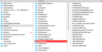

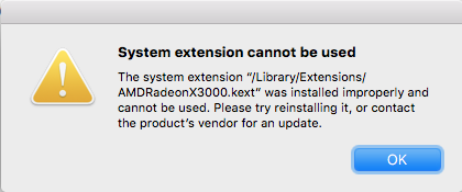

One thing weird though, I'm pretty sure that my last attempt before yesterday to move the AMD kexts (in AMF's guide) failed. I checked the /System/Library/Extensions/ folder, and all the kexts were there before I even started whacking my brain trying to understand rEFInd (I basically just parrot the instructions here, though I do have a little idea how the commands work). When I checked the /Extensions folder after my earlier reply, the AMD kexts are not there.
Now, I have two disabled AMD Folders in my /Library, AMD_Kext, to which I earlier copied the AMD kexts into via Mac OS GUI (just to be safe), then created the AMDdisabled, which is blank, created in a second attempt to move the kexts (SIP wasn't disabled). The Mac was <kinda> working with a few hiccups, so I didn't bother moving them.
But, when I checked earlier, all the AMD kexts aren't there. Should I move them back into the /Extensions folder via Terminal? What would be the syntax?
No dice (an all kexts).

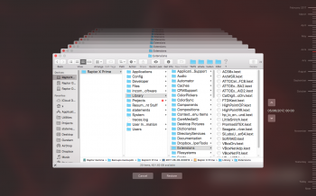

Can I go back to a Time Machine backup and copy and paste that?
Edit: Went back a few days, weeks and months via Time Machine. The kexts aren't there.

You shouldn't move those extensions there. Those extensions belong to /System/Library/Extensions. It seems that the copies you made have lost the permissions. You can move them to /System/Library/Extensions and then fix the permissions by doing:
Code:
sudo chmod -R 755 /System/Library/Extensions/AMD*.kext
sudo chown -R root:wheel /System/Library/Extensions/AMD*.kext
sudo touch /System/Library/Extensions
Code:
Got it! Thanks!

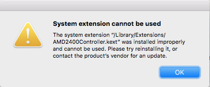

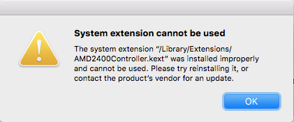

No worries. BTW, I tried it a couple of times, but, I still get the same error message re: AMD kexts which I posted earlier. Not worried about that now, it's finally working, though, as per your discussion with tmanx on the other thread, it's a bit on the warm side, though I'm not sure if it's just as warm as before when I first got it and starting using it. I'm currently on battery power, and with just Firefox on I'm down to just 3 hours or less. I tried shutting the lid on my way to class, restarting and shutting down, and it restarted without a hitch. It does take a while for the grub to come up, around 10 seconds or so.
I'll try the AMDwakeuphandler kext in a little while.
Edit: Still running on battery power, and it's slightly improved, now at 4 hours.

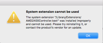

Addt'l Edit: Tried the wakeup handler. I also got the same error message across all kexts, except the wakeup handler.
OK, it must be the permissions. Did you try rerunning the chown and then doing the kextload?
If it still doesn't work try this:
Code:
sudo chmod -R 755 /System/Library/Extensions/AMDGPUWakeHandler.kext
sudo chown -R root:wheel /System/Library/Extensions/AMDGPUWakeHandler.kext
sudo kextload /System/Library/Extensions/AMDGPUWakeHandler.kext

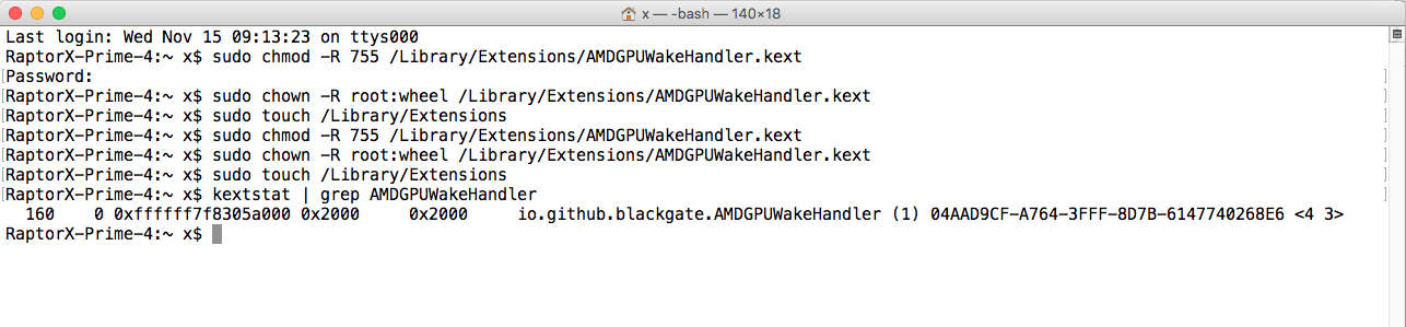

Hi @brainshutdown
I tried -
Code:
Password:
and at that point got an error dialogue.
So then I tried
Code:
And didn't get any errors.
On wake from sleep:
GPU VCore is 0.00,
GPU Die Analogue is -
and battery time on iStat is 5:30 (from charged @ 95%) - it was 3 or so hours before.
I do believe you've cracked it!!!!!!!
Thank you so much for everything :)
